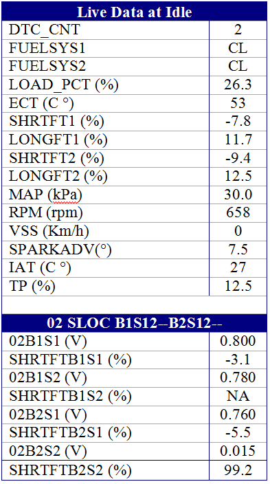

      I plugged in my basic scan tool after the battery had been disconnected. This was at idle. It appears short term is negative and long term is positive.

      You need to watch these numbers. I think your still in cold start which is why you have opposing numbers. If you don't already know, this is how these adaptive's work. The NGC controller has the ability to increase or decrease fuel 66%. This is to compensate for engine wear, altitude, etc. Short term is the immediate "fix". These numbers should bounce between -5% to +5% under normal circumstances. If the engine is lean, the numbers go positive to reflect the percentage of fuel being added and vice versa for rich. Once short term "sees" a constant change over a certain amount of time, it considers the engine always needs this increase or decrease in fueling and saves it to long term. Long term actually changes the fuel map to whatever short term ask for, this then lets short term drop back to zero and start the small corrections again. Short term is for minor corrections and is not saved to memory, only long term. Fuel adaptive's are a great thing for diagnosing an engine issue, just remember they only work when the engine is in closed loop.
      For example: Say you have an EGR valve stuck open. Your diluting the fresh air intake, requiring less fuel. Longterm will be zero, and short term will decrease to it's maximum of -33%, and after a few seconds, will store to longterm. Longterm will now show -33% and then short term starts decreasing again until it maxes at -33%. Both long and short will show -33%. If you had a fuel pump regulator with a pressure too low or a pump with insufficient volume, then the opposite will happen. Short term will add fuel, to a maximum of +33%, and once stored to longterm, will add up to an additional +33%.
      Hope that makes sense. So I want you to watch these numbers when it starts to stumble. See if it's adding or subtracting, and by how much. This will give you a better idea of where to start looking.

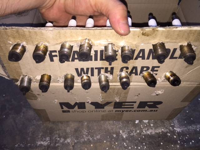

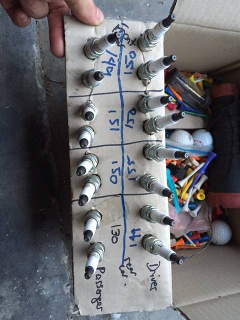

      Well I did a compression check and the results were as below:
      Appears number 7 cylinder has a drop in compression compared to the other cylinders. Being a 9.6:1 factroy compression engine this would be what you'd expect to see compression wise 150-160psi?

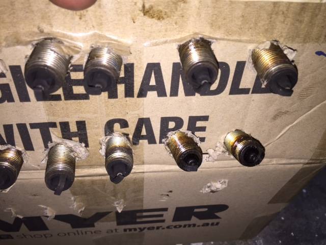

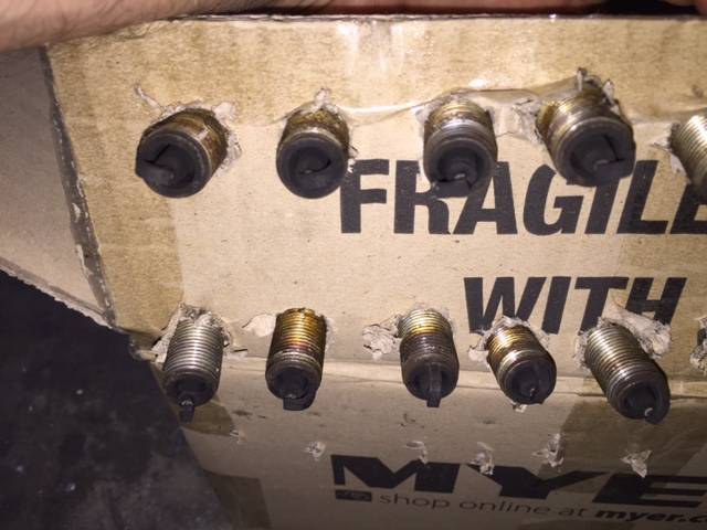

      The spark plugs were also very black:

      You may have a fuel washed cylinder. Leave the plugs out and let it dry. Do a cold compression check tomorrow and see if it evens out and comes up.
      The first "hit" is as important as peak as is the quality of the gauge! Record what each cylinder "hits" on the first stroke, and then the peak. I usually like to count to 10 while spinning it. After you've run through them, go back and do just the first one again to see how it compares to the initial recording. Again, the quality of the gauge is important. If everyone is within 10%, I wouldn't be too concerned with it being lower than the spec, could just be the gauge not reading accurate. If that cylinder stays low, I'd leak it down. If you don't have the tester, bring it up on TDC, take the Shrader valve out of the hose on your compression tester, and using a breaker bar on the crankshaft bolt, hold the engine to prevent turning. Hook your shop air on the the compression tester hose and listen for the air. If you hear it at the exhaust pipe, throttle body, or dipstick, that will let you know where your losing compression from. May have an exhaust valve seat "falling".
      Your fuel pressure bleed off numbers are with spec. Leave the gauge on overnight, and then key it on while watching the gauge. It should hit 50-ish instantly. If it hits mid 20's, then another key cycle hits 50-ish, you have a leak, either an injector, regulator, etc...

      The gauge is brand new from SP Tools (Australian brand) I had the coil packs resting in overnight, it was pretty much the same, went to about 135, injected a little oil and it came up to 150. Saying that, so did the good one next to it that was 150 and went to 170 i think. I didn't do the rest at this stage.
      I couldn't do a leak down test as I didn't have a fitting to thread in to the compression gauge hose, I'll try sort that tomorrow. What sort of pressure should you be trying to put in with the compressor?

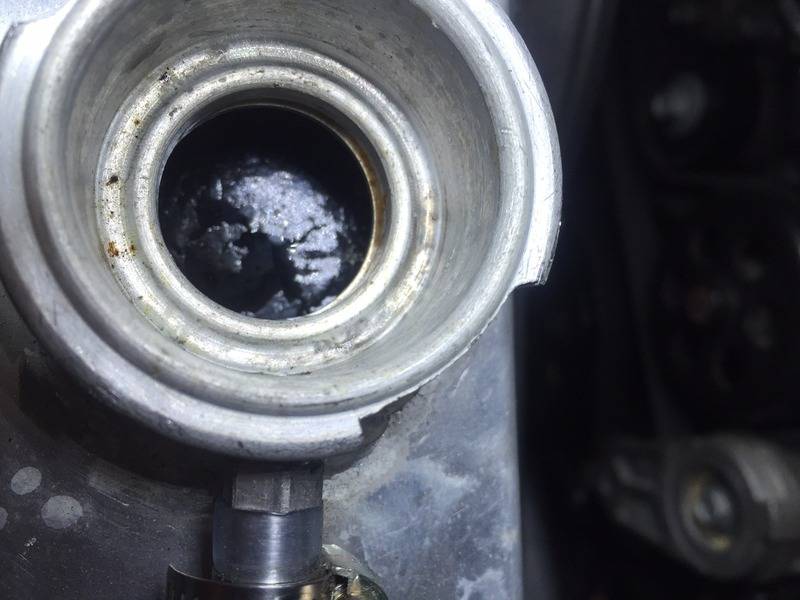

      Inside the radiator it appears as though there may be some oil or something, scaley on top and looks a little oil like. Not sure if it is or not.
