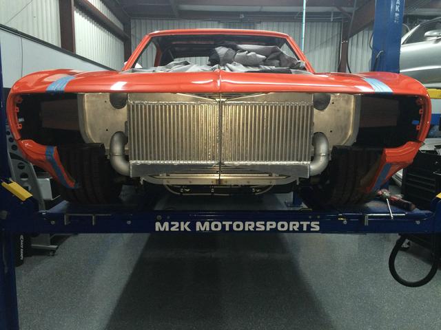

      Just took this picture this past weekend after re-installing the hot side...This is why i went turbo. Hard to get this look from a SC setup...
      THAT is the wow factor for me.

      Quote Originally Posted by will69camaro View Post
      I think you need to sensor that! Wow! Just wow!
      I am still adding on to my list... oh blow through turbo system will be cheaper... hahahaha here buy a 500 dollar msd box that controls timing... and, i hope you don't need to change your gauge setup... i am 1300 for changing my gauges .... SMH!!!!
      Nothin like yours Will But when I pop the hood... well it should be an eye popper with a sleeper feel, since i am not running an intercooler

      Quote Originally Posted by rfalker1 View Post
      Not sure what you mean that setup looks awesome so far. Like the turbo placement!
