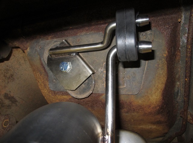

      I try few things , when i assemble the exhaust on the floor every hanger braquet are parralel, the passenger side seem fine
      On the driver side i think the hanger was weld the wrong way and should be the mirror of the other side ,like the black marker line.

      I can post some photos up for you on Monday if someone hasn't already done so by then...your muffler hangers that attach to the seat belt gussets seem to be on the wrong sides of the car, try flipping them one for the other.

      Here's a photo of the passenger side muffler hanger in its correct orientation on the seat belt gusset...the driver side sits on top of the gusset with the hanger rod pointing to the outside of the car in the same way.Name:  42504HKR-11.JPG

      Thanks for the picture , i install the bracket with the black sharpie line on the driver side like you mention and its the same as your pics so i try the other bracket on the driver side

      If the angle in the bracket go on the top of the seat belt gusset , the rod should be weld like the green tape on the bracket thanks again for the support

      thanks again for the support[/QUOTE]I just realized that the angular position of your gusset on the driver side is opposite of the gusset on the car that is depicted in the development file. Because of that, the possibility exists that the gusset on the other side of your car is also located with a slightly different location and I'm thinking it is due to the hanger rod angling upward slightly in your last photo. Is your car a Canadian built car? Here's the photo of the driver side hanger, which shows the opposite angle orientation of the gusset...Name:  hanger.JPG

      Thanks for the pics and the answer, i change everything under with Autometaldirect product, maybe the seat belt gusset from AMD are different angle from factory , with your pics ,i can cut and reweld the bracket to fit my car . Thanks for your time

      Yep, that's the difference I believe...thanks for identifying the source of your floors, I'll have to send out a notice to the guys in Tech Service.
