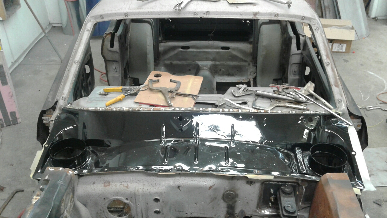

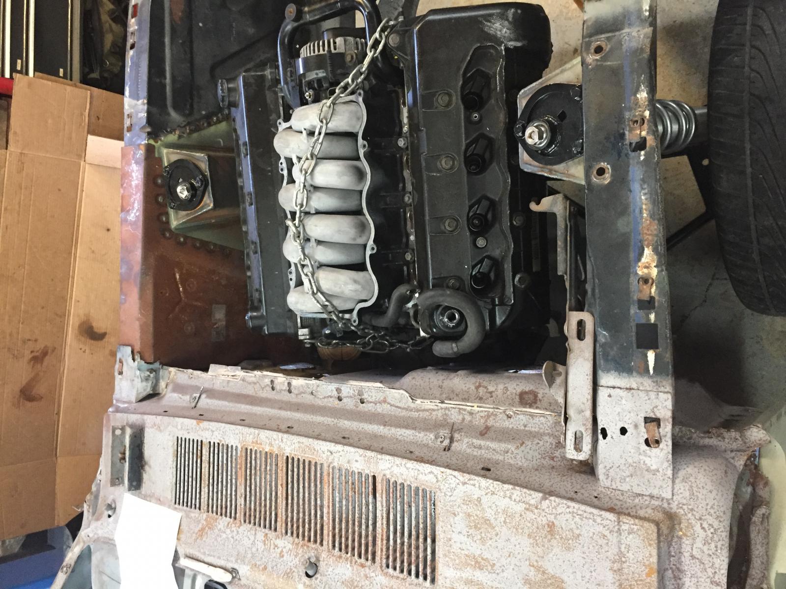

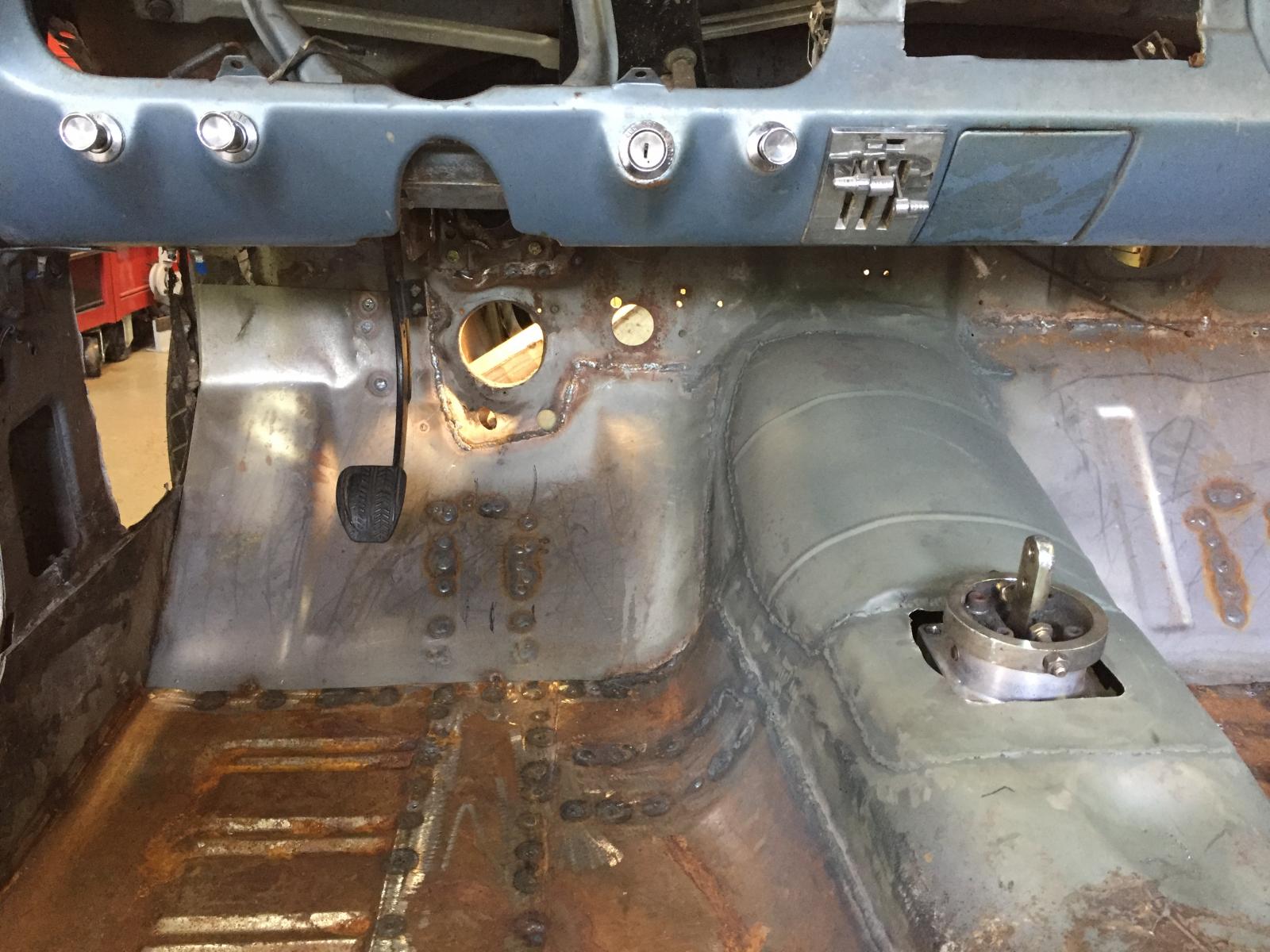

Size:  273.4 KBIf it fits it ships... gotta do a custom engine compartment bracing to keep the walls from caving in but it's coming together. Right fit on the brake master cylinder and mocking up the cobra Manuel pedal box

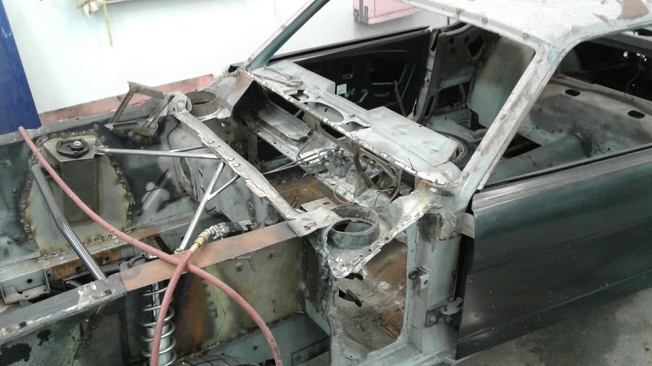

Size:  216.7 KBEngine compartment bracing and cobra pedals mounted

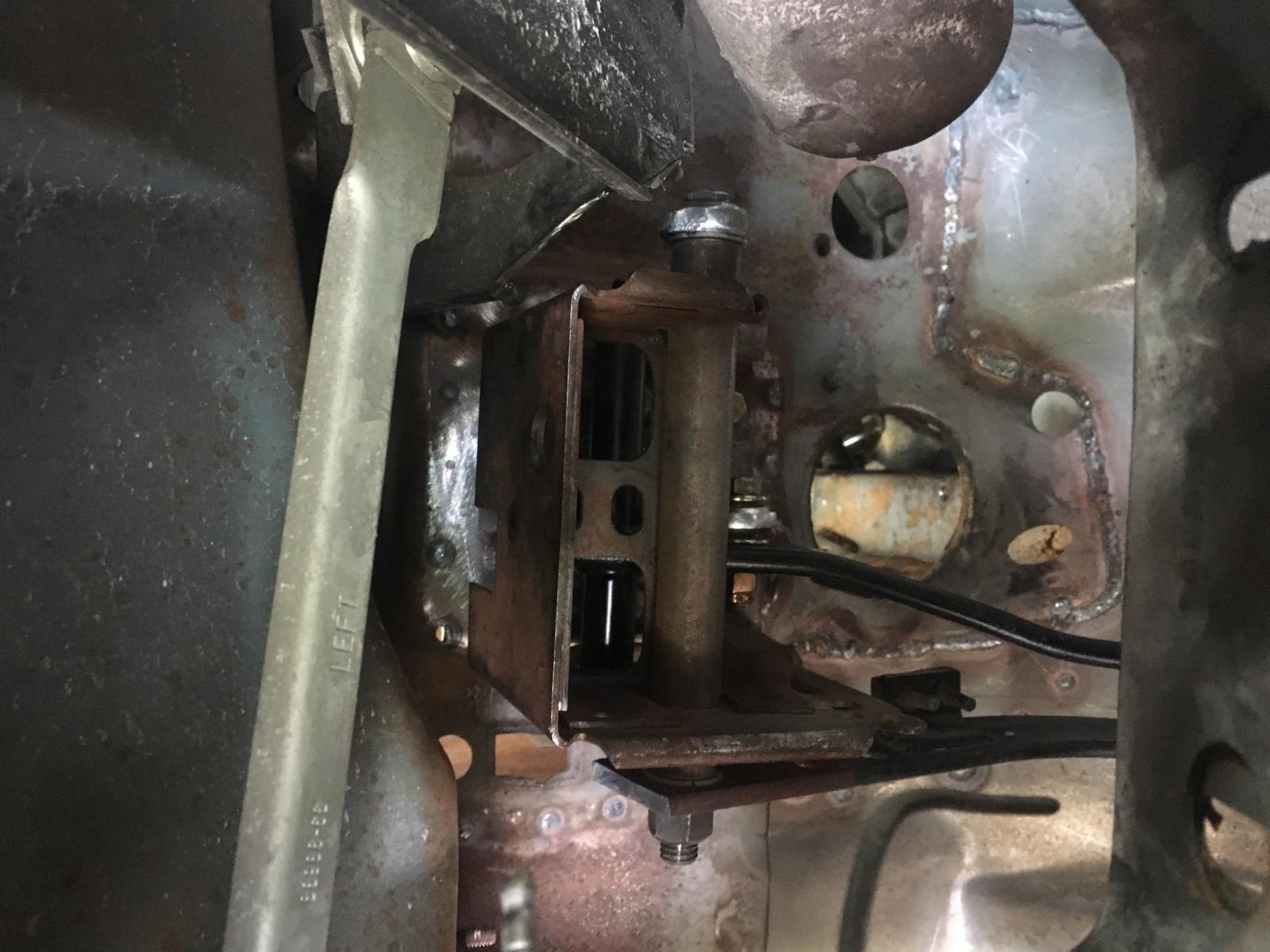

      Any more pics of the pedals mounted?
      I plan to run the cobra pedals and hydroboost

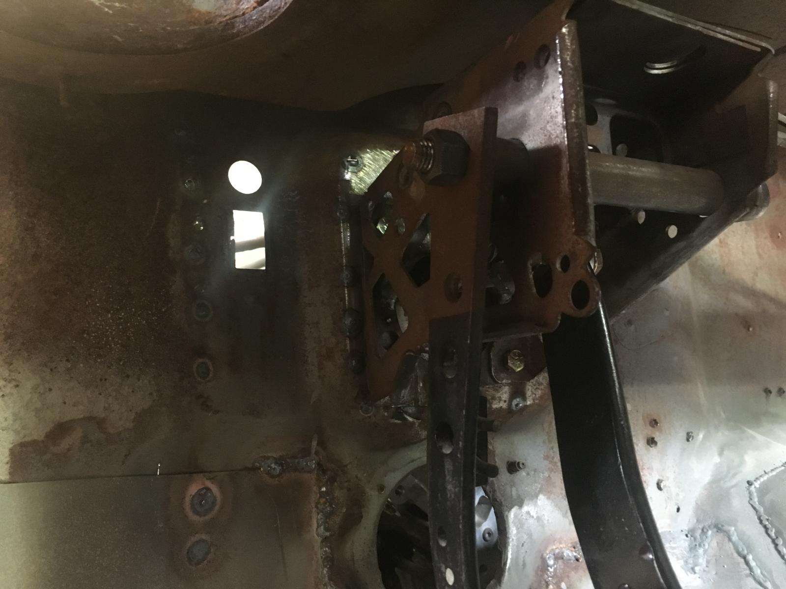

      I'll try soon. Had to do a lot of Fab work the quadrant needed to be moved to the left side I should have better pics when all the parts come in

      Looks like the t56 didn't fit in the stock tunnel. Did you have to raise the tunnel?
      Yeah it needed to be raised about 2in in the front section to get the drive shaft angle right

      Pedal mounts
Size:  187.7 KBName:  IMG_9927.jpg

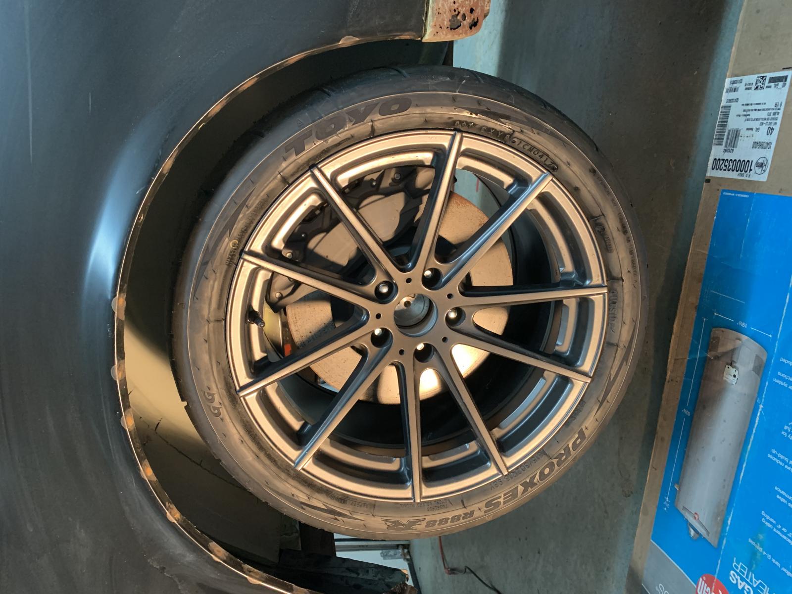

Size:  171.7 KBHad to re fan the front A arm cause the aje kit makes it sit to far foward but now it's right in the middle

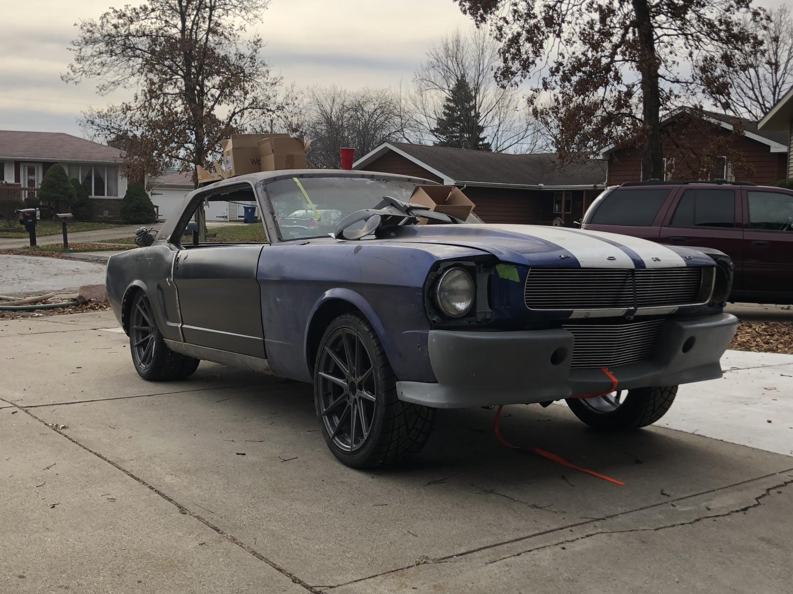

      More progress
Size:  690.3 KBName:  IMG_1650.JPG
Size:  705.0 KBName:  IMG_1616.JPG
Size:  633.1 KBName:  IMG_1573.JPG
Size:  686.7 KBName:  IMG_1492.jpg
Size:  127.2 KBName:  IMG_1445.jpg

      Feb 2016
      52
      Tsw Bathurst. Closest to the Shelby super snake wheels I could find w the right options on back spacing and rim size w out spending 1500 a wheel
