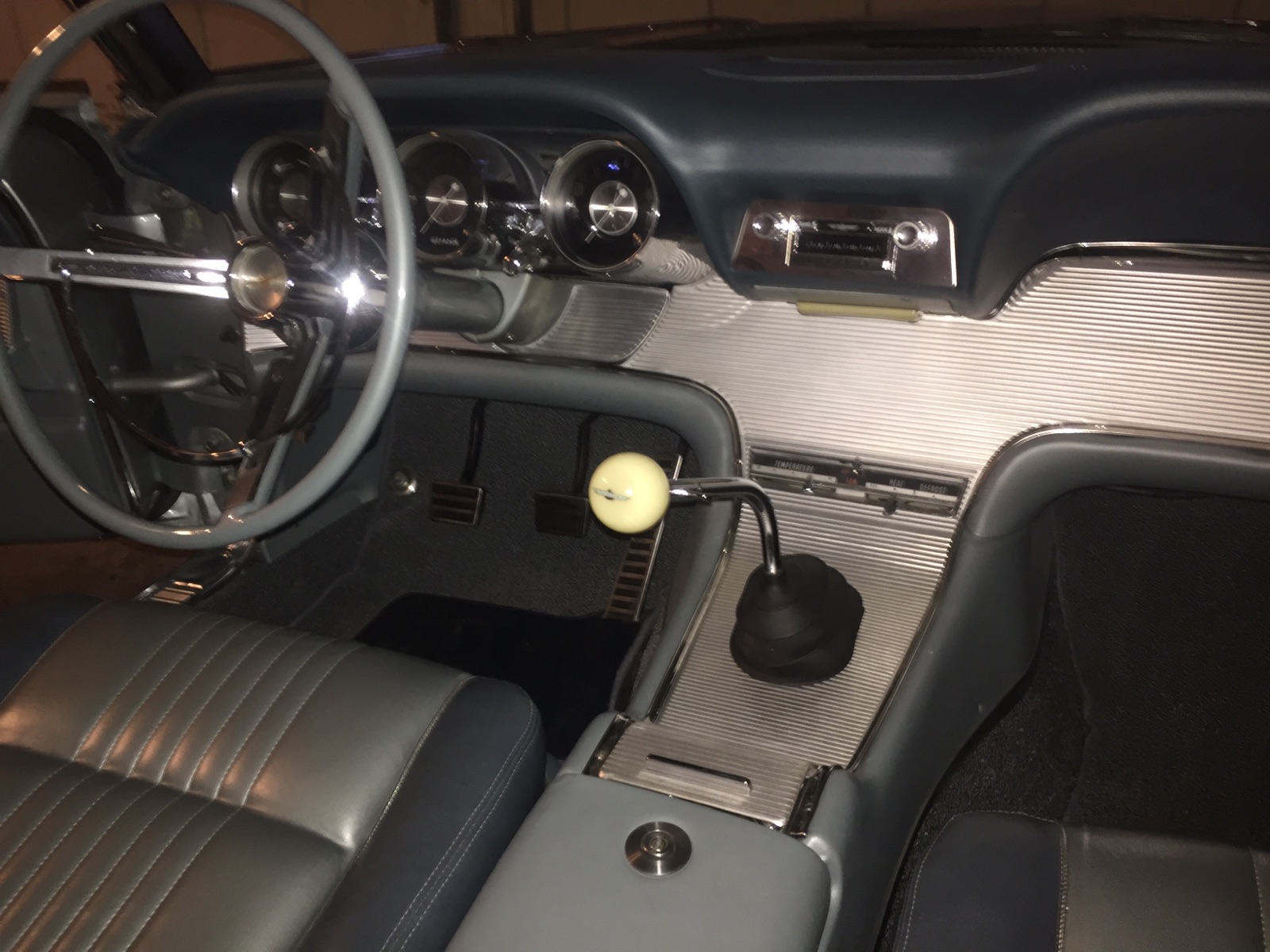

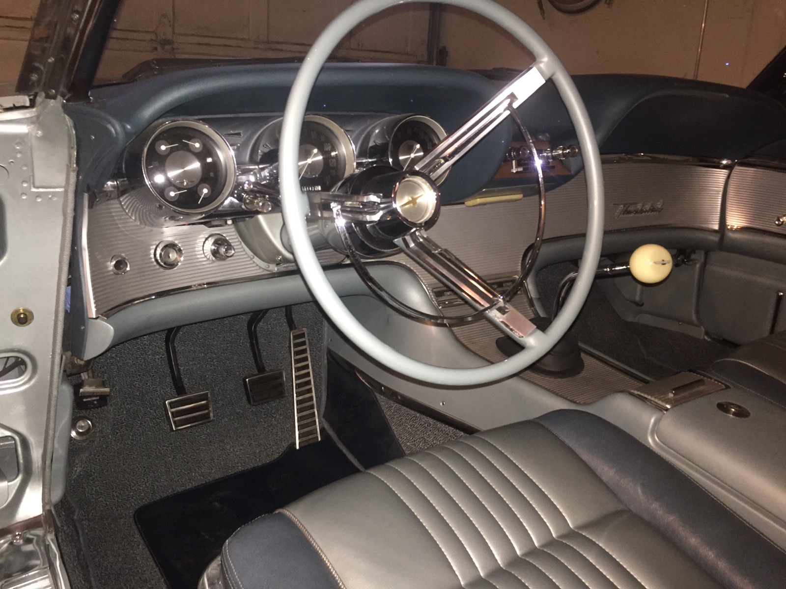

      Very clean, something to aim for! The packaging issue I'm having/had was that the 64 has a swiveling steering column to assist in exiting the car, so I had to move the pedals around. I'm also going to try and put in some new gauges where the stocks were (for me it's just easier to retrofit than it would be to get them rebuild and adapted to whatever signal the new sender sends).

      same for him he got his from Faria and they even come as a four in one with a very similar Thunderbird logo I will get you the exact info tomorrow. he also maintained the swing out steering column but converted it to work with electric solinoid, the silver push button was put on the side of the driver's seat, you would never know it was there,

      Sorry, gauges came from classic industries.

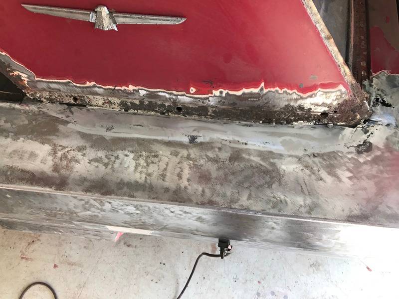

      Tried stripping the paint off the quarter panel, but the grinder took it down better, there was a lot of bondo in there for no reason at all that I could tell. I welded up the big hole by the roof panel, but uncovered a couple smaller ones while I was sanding the paint off

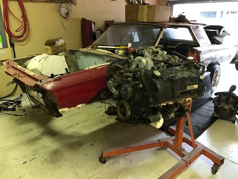

      Not sure if his was a sound decision, but I bought another engine...this project started around the drivetrain out of an 02 mustang GT, but after looking at other builds and threads if become more interested in the DOHC motors. This is from a 98 mark viii, so it should be a 'Teksid' block and ran when I pulled it, I think it'll look a lot better in the engine compartment than the SOHC and will be a better platform for any future mods. my goal is to have the underbody painted this week, order the body paint, and have the new engine installed for good by the end of the month.

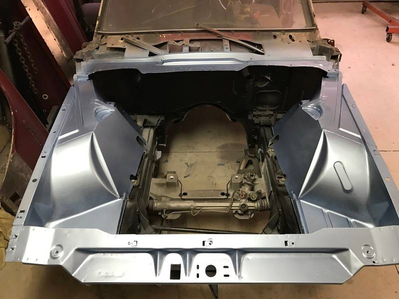

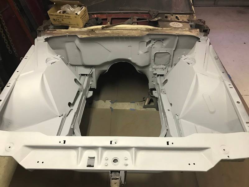

      Things look better when they're painted all the same color! Still a lot of work to do, I've already sanded these panels since the pics, I'm hoping to paint the frame rails and firewall black this week. I ordered the paint for the body-it's going to be 'Arctic blue'!

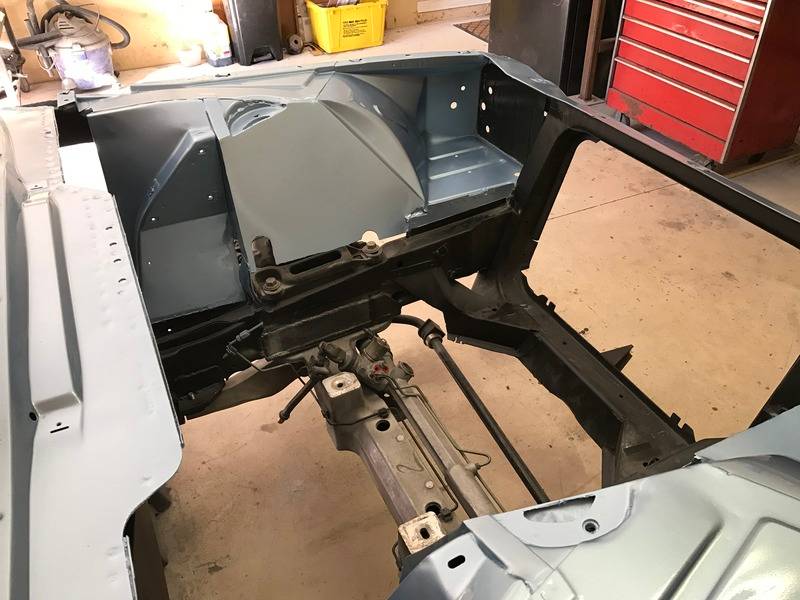

      516

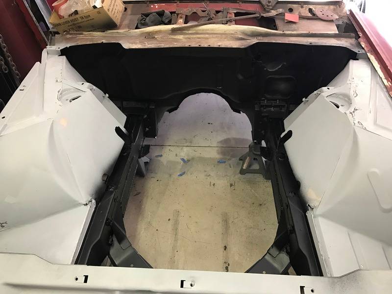

      It's hard to get a good picture of the black, but the frame rails, underbody, and firewall are painted with raptor bedliner, I'm really happy with how it's turned out. It's texture is very fine and has a satin finish (we've used it a couple other times on underbodies and stuff...). The rest of the engine compartment will be body color after a couple weeks of sanding.

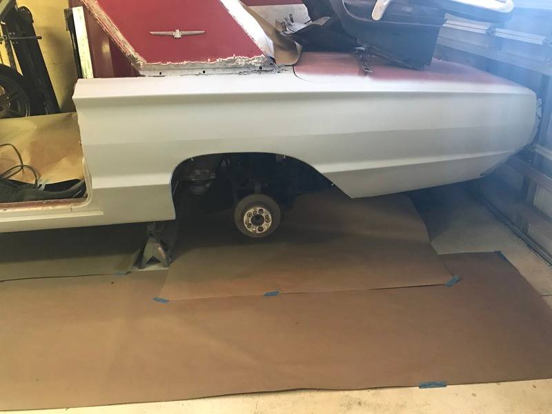

      Finally got to open the paint can and see what this paint looks like on the car. I've never sprayed anything other than primer before (my dads painted at least a dozen cars, so I never had to worry about it before), so I've learned a few things about what not to do next time...when I was spraying the base coat I realized that in the front corners I was blowing dried paint chunks off of the masking and into the paint. But overall I'm very happy with how things turned out

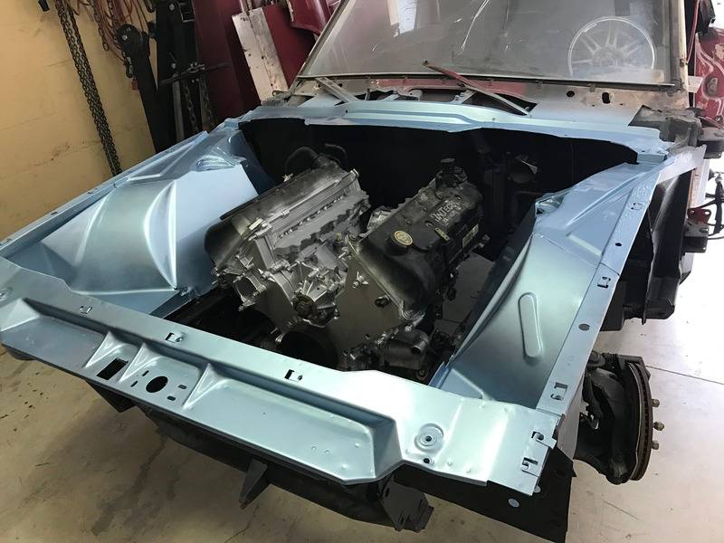

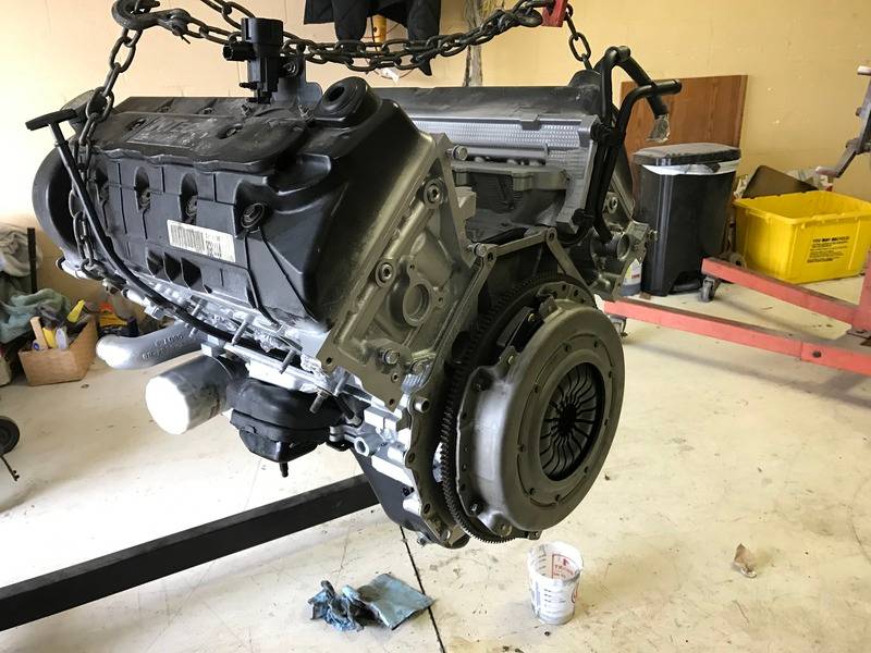

      516
      I think that this was the most gratifying day of this build yet. I replaced the rear main seal, oil pan gasket and installed new motor mounts and a new stock clutch before getting to see the transmission bolted to the DOHC engine for the first time. The engines finally installed, hopefully for good, now I have more space in the garage and can (re)turn my attentions to bodywork.
      The engine looked clean inside when I took the oil pan off; I also had sent an oil sample out to get analyzed.

      2,996
      The motor looks great installed. I will be honest, there is a lot more room for headers/manifolds than I thought there would be. Looks great, keep up the progress.

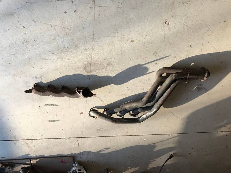

      Thanks! I was going to wait to put the exhaust manifolds on before installing the engine but I'm holding out on finding a good craigslist deal on some headers...I only have one exhaust manifold bc the engine's seller wanted to keep the drivers side since the mark viii manifold is integral to that sides catylitic converter. With the engine in I feel better about the space I have to play with

      Not much new, just boring bodywork except I found a good deal on a set of headers, should be a good improvement over the stock logs...I also got an H pipe, an electric fan and underdrive pulley setup for a chunk less than a new set of headers
