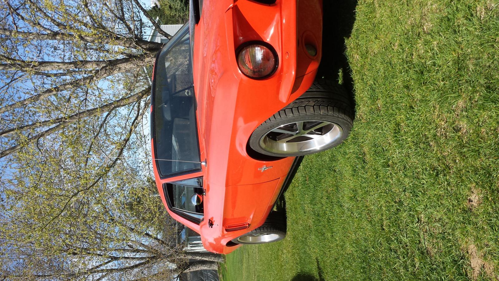

      This is what it looked like about 3 years ago after about a 3 to 4 year restoration. At this point I was satisfied with how the car looked but I really felt as if the car fit perfectly into the satisfactory category. First things that popped out at me was the stance, too high in the back. Another thing that stood out to me was I really didn't stick with a good theme. Blacked out bumpers and everything but then Chrome mirrors and antenna. So I am getting rid of the antenna and most likely mirrors. Let's see some suggestions!

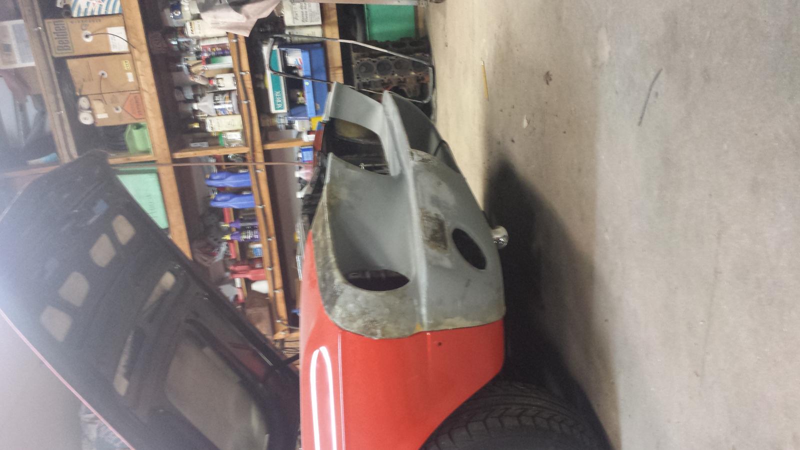

      So I managed to find a Shelby front nose off ebay for $40. What can you do when nobody else is bidding? Bad part is that it fit so terribly that I had to cut it in half. I have made metal brackets and welded studs to fasten it to the fenders. After that I glassed over it to make sure it is sturdy.

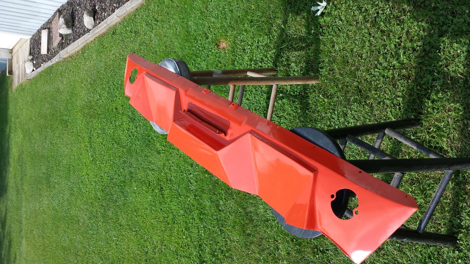

      This is the valance I made, not sure if it looks as good on the car as it did in my head

      I forgot the image of the valance with the previous quote... sorry

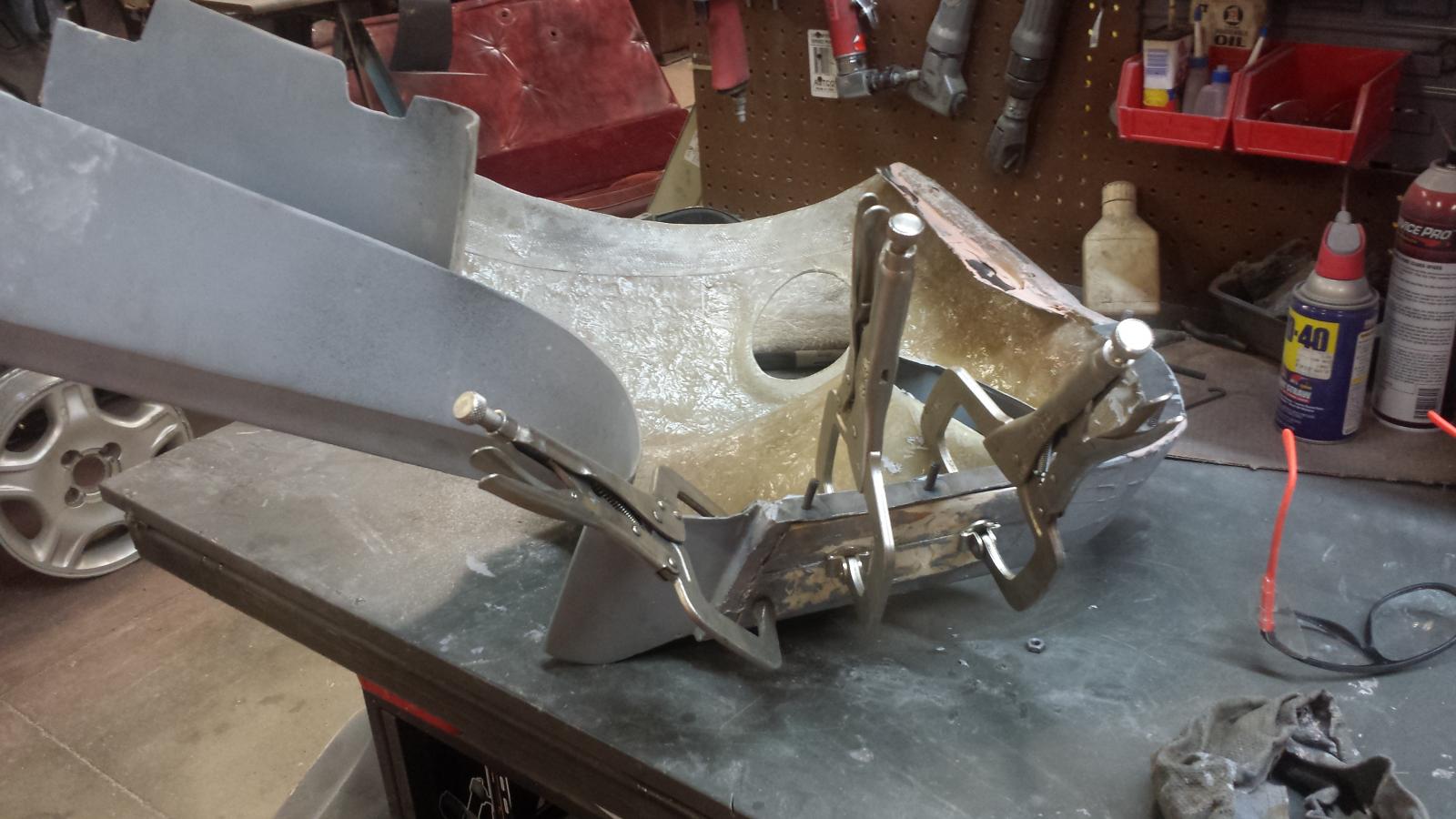

      I made a template for the fiberglass to mold onto the nose, I laid aluminum foil over the hood then glassed over it. Now I have the template and same shape that I need tgat looks like the hood but will actually be a part of nose. I will cut the hood back and so it will have the boxed in hood look that I love so much. The z28s did it, and the new ford Mustangs have the boxed in hood.

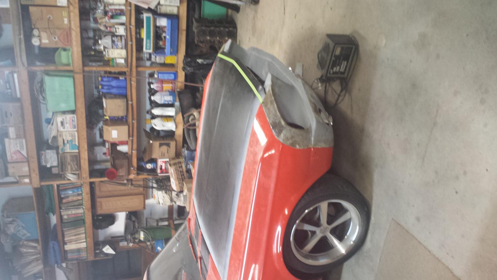

      Here is another look at the car before the mods began this winter. Basically I am just working my way back. Once I get the front end looking the way I want it, I will move to possibly removing the mirrors (they serve no purpose except for looking very standout-ish). Then I want to remove the stock door handles and replace them with ones that are flush with the body. I like the shaved look but I don't want to deal with the dead battery --> smash windows --> "why didn't I make a safety cable?" Route. So this way will take on both looks, safety of door handle reliability and the look of clean shaved doors. Then I will make a custom center counsel. New back seats to match the front. And possibly... possibly... a spoiler. They are the biggest make or break on a car. That's why I will tackle it last. And I have a 4.6L DOHC engine and trans ready to go in it with my custom suspension up front. If any one has suggestions on how to lower the rear it would be much appreciated. I have 5 leaf springs, too bouncy on these Michigan roads, and it is wayyyy too high in the back. Would love to drop it 2.5 inches.Name:  20150501_171158.jpg

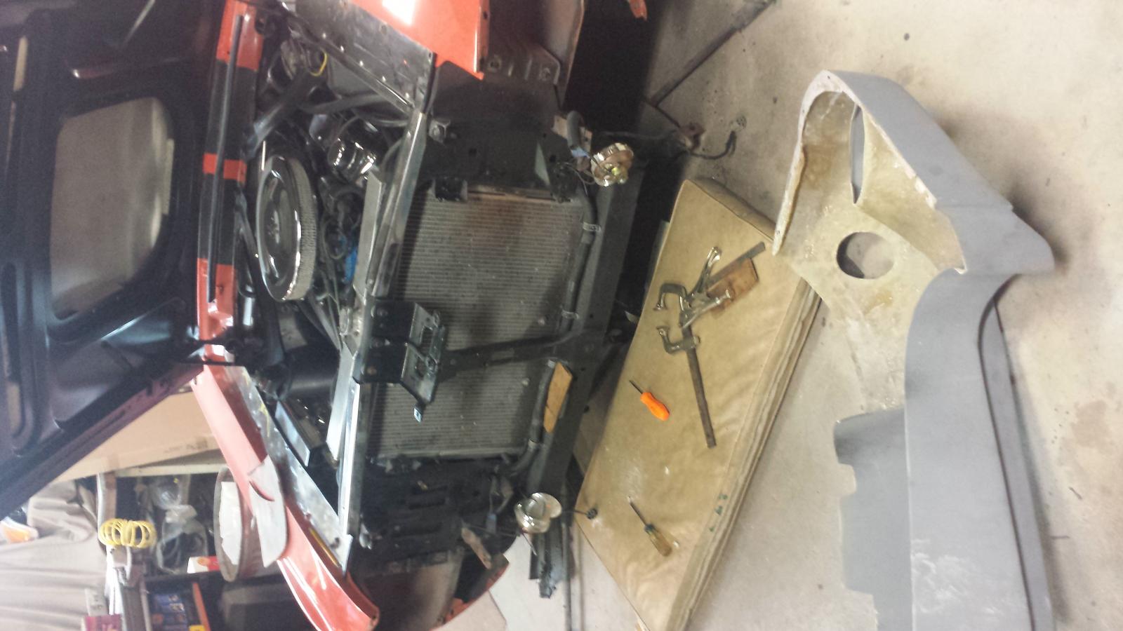

      I made more progress on my front shelby nose. I hope I can get more feedback on the nose and the project. So far I reinforced the center piece. I then will glass the two sections together.
