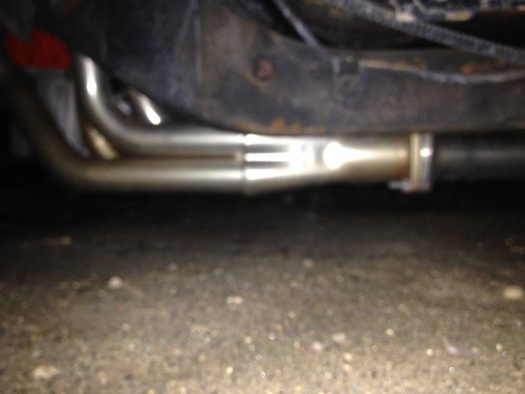

      Ok sorry guess I should of been more clear....my nova is lsx powered. And am also using powersteering and ride tech truturn. Here's a pic my bud sent me last night of his nova with a ls motor and his dynatech headers....and his car is stock suspension, my car sits significantly lower.

      The hookers don't hang down bad like that, same with the Stainless Works if your budget allows (around $900).

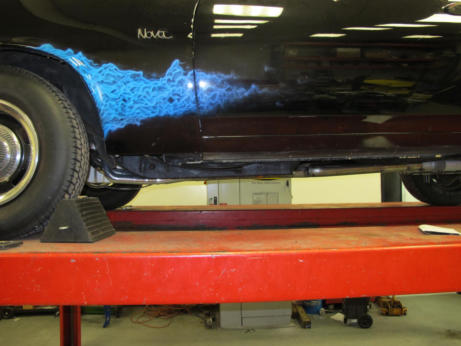

      I wouldn't describe the ground clearance of the newer Hooker 1st-gen F-body/ 3rd-gen X-body LS swap headers as "don't hang down too bad" by the evidence given in the photo below. The ground clearance is awesome, but you have to use the Hooker engine brackets and transmission crossmember to achieve the same results. In addition to stainless steel, you can also buy the Hooker headers in mild steel with black paint or ceramic coating finish options, so pricing is suitable to a wide range of users. Name:  2276-1HKR-on 72 Nova-2.jpg

      that's not to bad .... but im running carb shop mounts. what they run you??
      Mar 2013
      372
      The 12618HKR Hooker swap bracket kit is currently $127 on Summit's site as an example.
