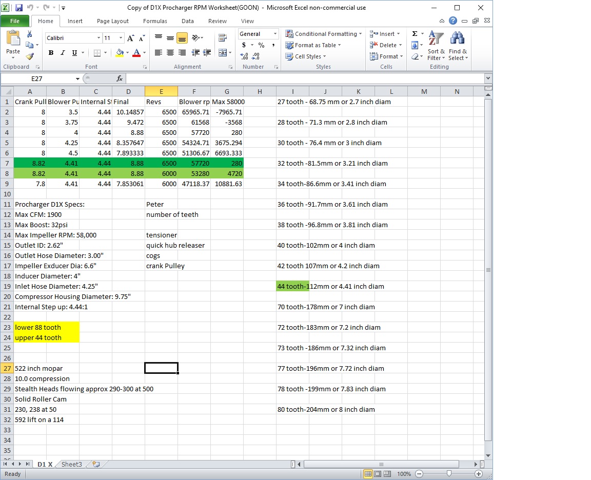

      I'm trying to determine what pulley sizes I need. FOr the sake of keeping this easy let's just use cog/gilmer as the reference point. Is there any way to determine what size crank and blower pulleys to start with to coincide with my intended boost level?? I have this worksheet to use as a reference point if it helps??
      I know that the The smaller the crank cog the slower procharger turns and the lower the boost
      The smaller the procharger head cog the faster the procharger turns – more boost.
      But what size do I start with or is it all trial and error?? I really don't want to have to buy 6 sets of pulleys.

      Thanks badbet. I do agree with you and understand that much.
      Here's where my head is at,
      I believe 8" is the standard rib style crank pulley I have not seen a larger one. With your D1X I would need to run about a 3.4 supercharger pulley to get the boost level up on my engine.3.4 is one of the smallest for my head unit and I will need to put a lot of tension on the belt so it doesn't slip.that should make around 10-12 psi of max boost due to the size of your engine maybe less. I think with my set up having high compression even with less boost you will have good performance
      If I can obtain 10 psi of boost, that is a PR of 1.68. My Engine N/A dyno sheet indicates I achieved 526HP @ 4900rpm, so 884 Hp, minus the hp to drive my blower, and other ineffieciency's. The smaller blower could put out a lot of heat and be less effiecient, something I need to be aware of and make sure my water/meth nozzles are sized accordingly

      I already have the serp pulleys but would need to fabricate a good tensioner so I may just change to cog anyways to get the positive contact and not worry about slippage.
