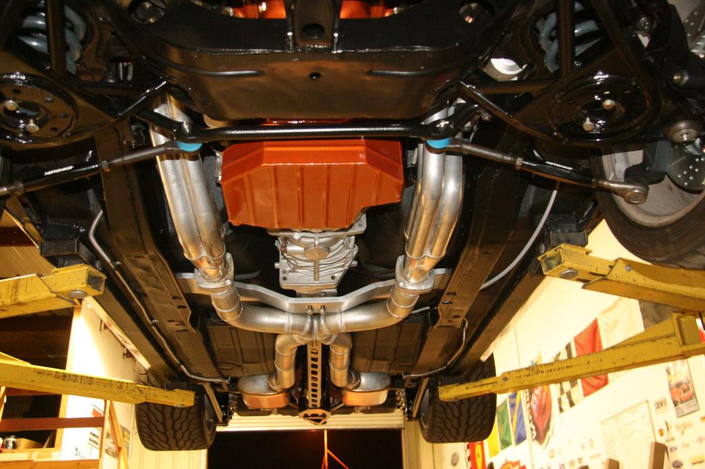

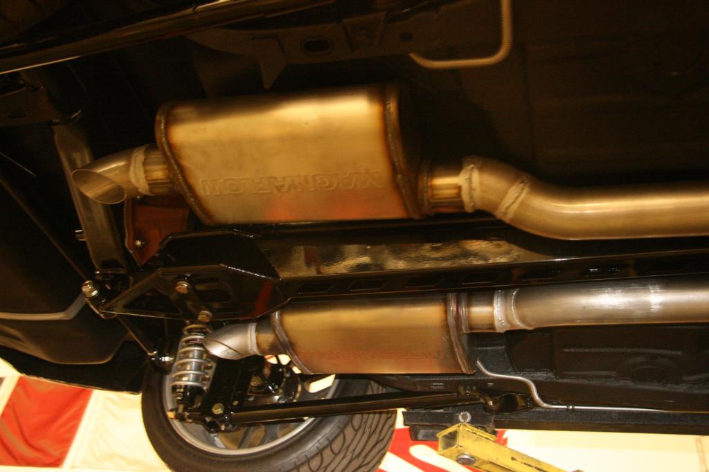

      Here are some pictures
      These are pictures that V8TV sent me during the install. If you need more or different angle let me know.
      Scott

      Thanks Scott! Very helpful. I can see how nicely the tailpipes fit in the area created by the shocked being layed over at the top. Side question, looks like you started with the Ram Air Restorations exhaust system? Or possibly the Spintech set up? Sounds great!
      Thanks again!

      you CAN run an X pipe with the Speedtech Torque arm, We have built many.
      the Second Gen is Tight down the tunnel for sure. although we have not built on I think a merged single 3" oval down the tunnel may work then a single muffler?? just ideas
      on our set up you have the MOST room available for tail pipes the pan hard bar will work just fine for your expected application with no extra set up and also allows more exhaust clearance, when you consider the rear suspension travel is about 2 - 3 " max the lateral movement of the rear end with the panhard bar is approx. .080 and the roll center is adjustable as well.

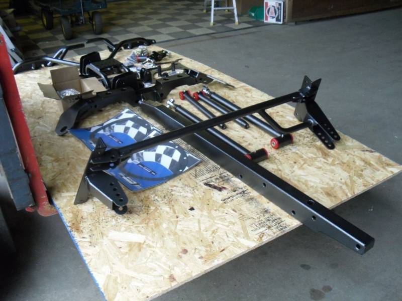

      Speedtech Torque Arm
      This is a buddies ride (Kevin Mahler) installed at Road Touring Customs

      I am going with the Speedtech torque are myself.. should have it in this month.
