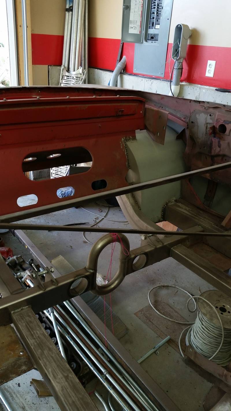

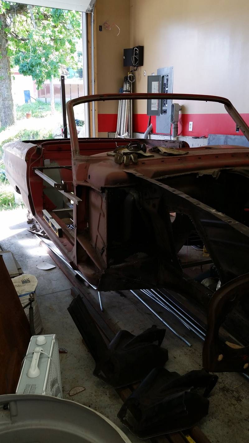

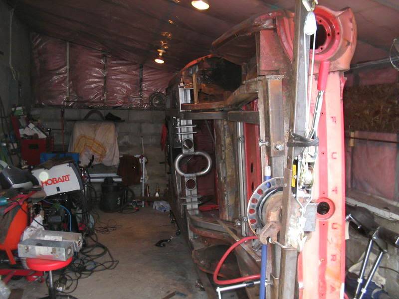

      The car was certainly rough but we were up to the challenge, and because a lot of the trim and mouldings were beat, floors gone, torque boxes on drivers side gone, rear right frame rail bent from a rear hit, it wasn't hard to decide to go custom with the car and avoid an original restoration.
      First we built the rotisserie and dismantled the car..

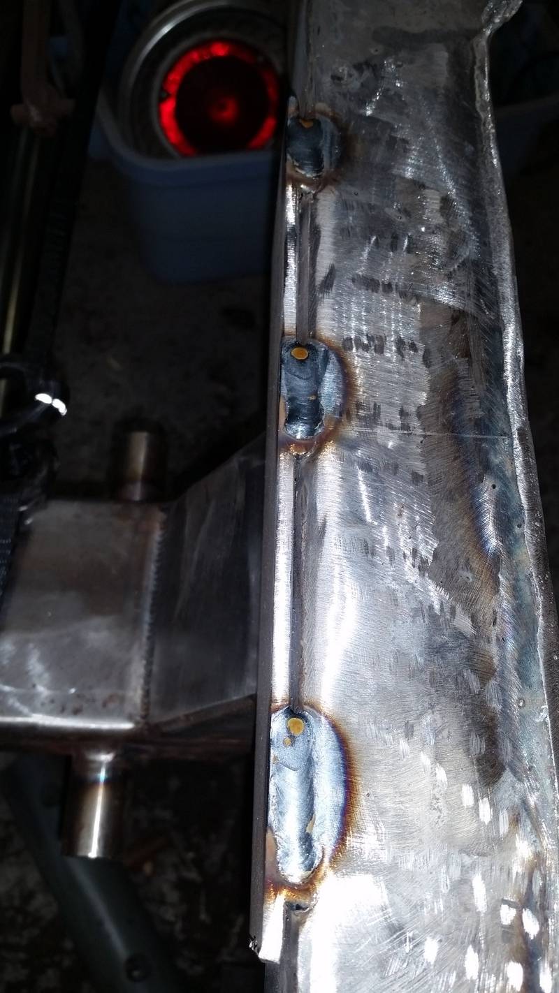

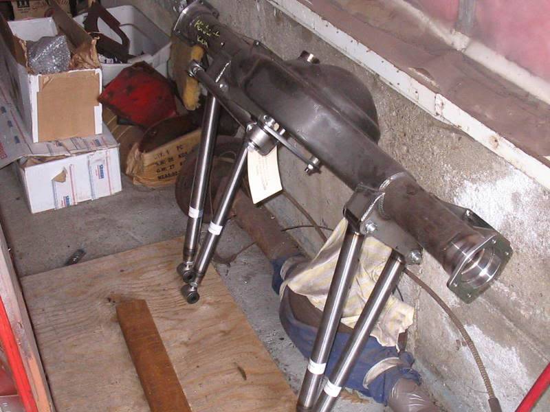

      We rebuilt the drivers side torque boxes and To deal with the rear frame rail and fit a decent tire we had Art Morrison put together a parallel 4 Bar rear suspension. It was all tied together with 2x3 x .125 wall tube subframe connectors relieved into the torque boxes and welded in.

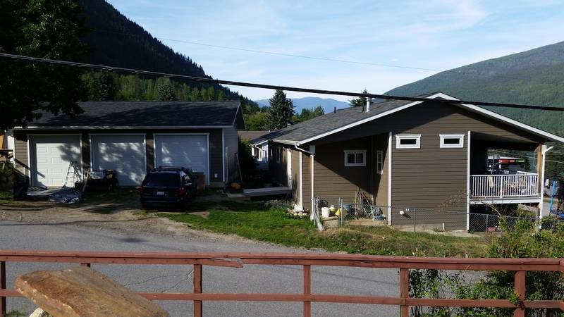

      In the spring of 2009 my wife and I decided our house was too small for our growing family so we had to renovate and add on to the house......problem is the car was in the tiny attached garage...
      So the decision was made.....a negotiation with the wife...and I built a garage in the backyard before the house....a man garage....when the garage was complete the Falcon moved into its new nest and I destroyed the house...
      I started building the garage June 2009 and we moved into the mostly complete house, unfinished daylight basement, in September 2011..still gotta pour the rear parking slab and rear deck..

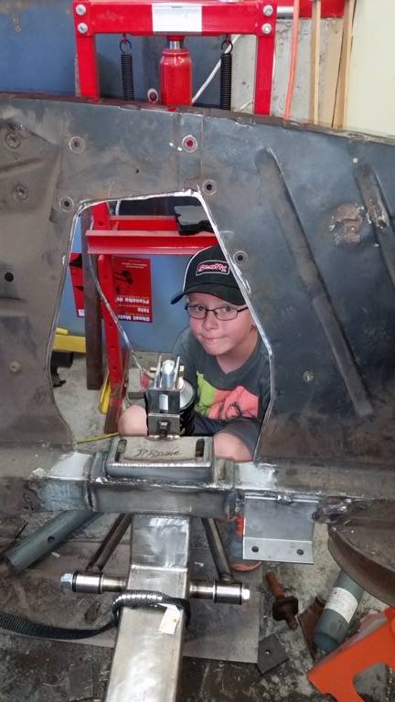

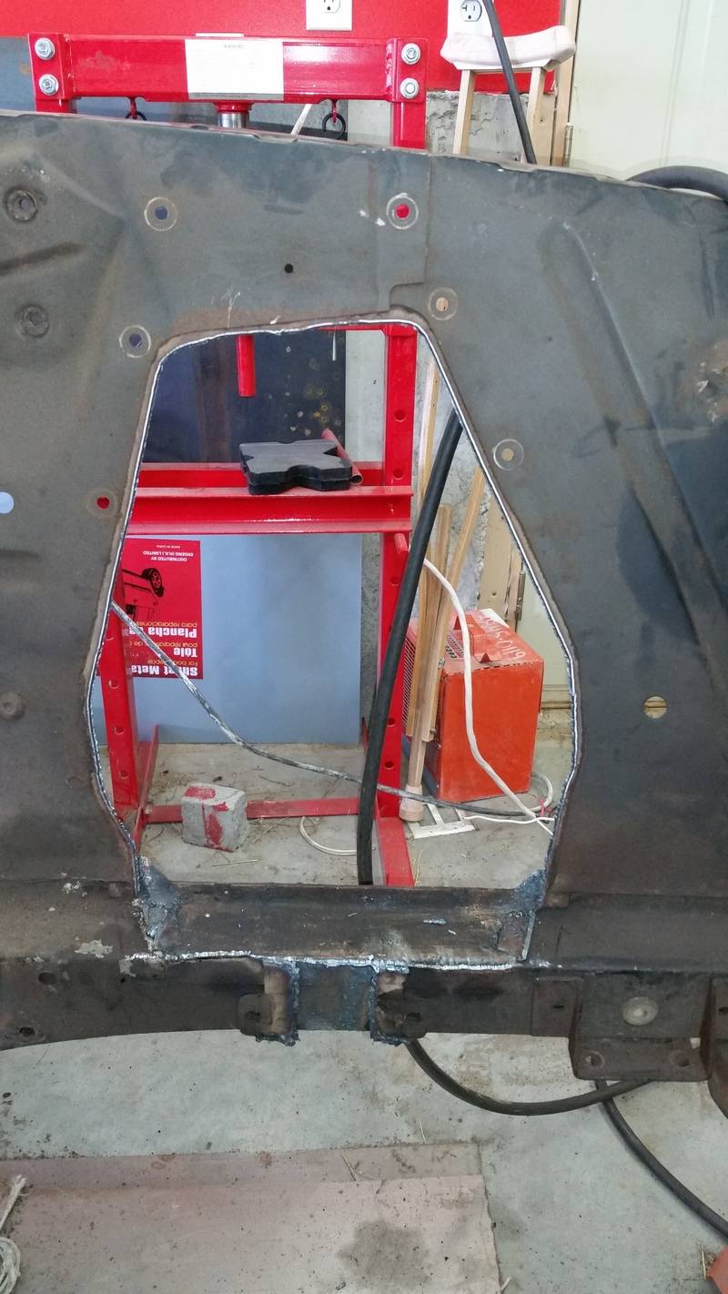

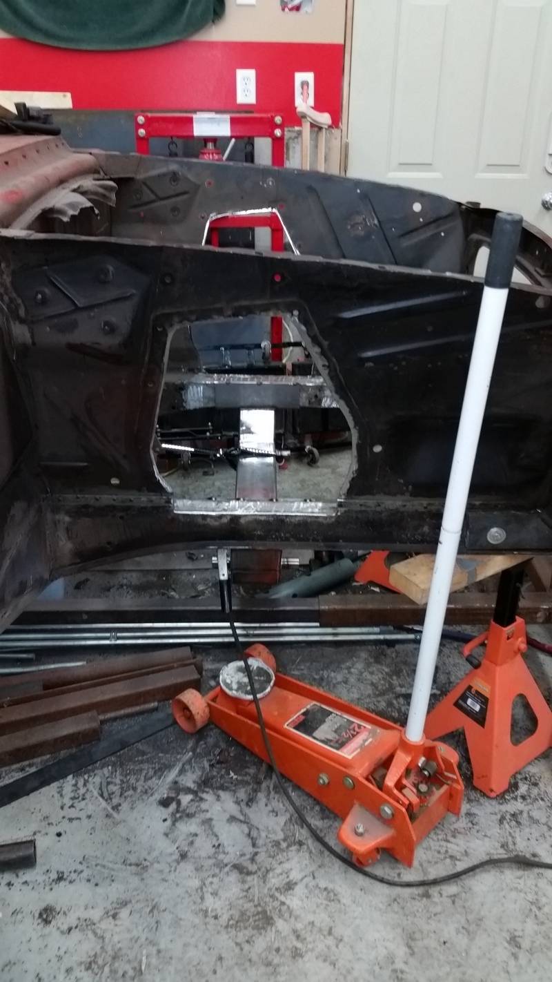

      Summer of 2015 had me itching to work on the car, although with 2 kids and a big mortgage there's never much money left at the end of the month but I had the Rod & Custom front suspension on the shelf since dad passed.....so I cut out the shock towers and installed the crossmember

      Plasma cutter, thanks Dad, made quick work of the towers

      My oldest son helping mock up the front suspension...

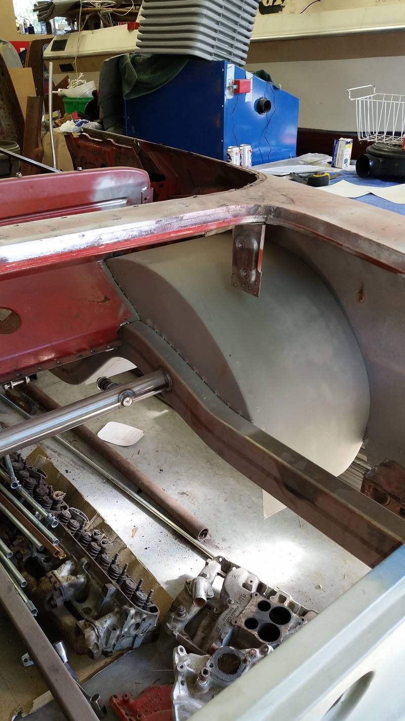

      When we ordered the Art Morrison frame we spec'd out 15x10 w/4" backspace...to fit a 295/50-15 tire.
      I still have 2-2.5" between the tire and the frame so I was thinking of running a 17" wheel and a 315 or wider tire but I am unable to find any off the shelf 17" wheels that will fit with proper backspace.....and the pricing on custom offset wheels was $1000 each.....ummmmm.....ouch
