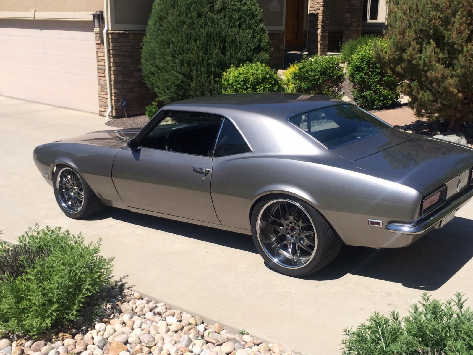

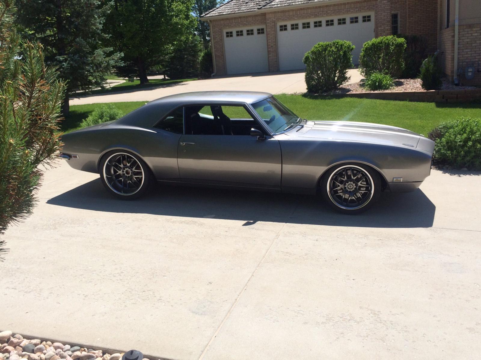

      I have a speedtech torque arm (and chicane kit up front) with viking coilovers and could not be happier and I truly believe it's the best bang for the buck out there. I personally like it way more than my lowered leaf setup (3" lowered) but as I have said before I like my car low. However, if you don't want to go any lower than 3", have a completely custom stance, and do not plan to go wider than what fits in a stock tub there is no reason to spend more money on anything other than leafs in my opinion.
      Here is a picture of my car with my speedtech setup for reference. (20" wheel w/ 315's rear and 18" wheel w/265's front with DSE mini tubs)

      Car looks Awesome, thanks for the props as well, Glad your enjoying the car!! that is what it is all about
