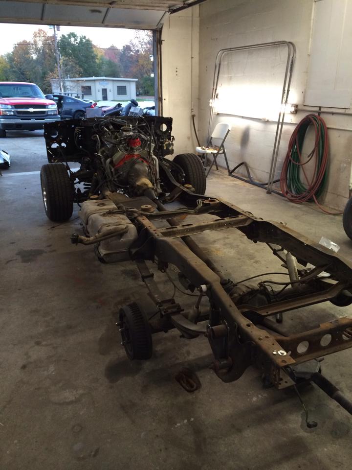

      So I have been lurking this site for years now looking at everyone else's builds as I slowly work on my own. I haven't started my own thread for some time just due to lack of pictures during the process as I always forget to take some as I go and of course school, life in general and work we all contend with. I finally believe though I have enough to post up and start showing my progress as I put this thing together and make changes. This project started for me years ago when I was just graduating high school and going to college. I bought the truck (1985 C10 Short box) with the original intent of using it as a hunting truck and maybe one day just building a hot motor for it when I found a better truck to use around the farm. Well as all these kind of projects go one thing led to another and the gear head in me built a sweet little engine and started driving it daily until hitting a deer one morning while ironically headed to help a friend pick up a deer he had just shot. That was the excuse I needed to start from scratch with the truck and build it from the frame up into a Pro Touring truck build which was really always just a dream but now reality. The truck even once "complete" will see many suspension changes as these projects are never really complete. For now I just want it back on the road as a good handling truck I can take to a few auto crosses each year and cruise around in on the weekends when I'm home. At that point I will start saving for more suspension upgrades I have planned when I decide to start competing more than cruising not that it wont be set up decent to begin with. Ill post some pictures I have taken here and there, this is my first ever post so I may screw it up so just bear with me.
      As it stands now the truck: Is in a million pieces but has turned the corner to assembling it again instead of tearing it apart and soon I will have a full rolling chassis and then I will start the body work.

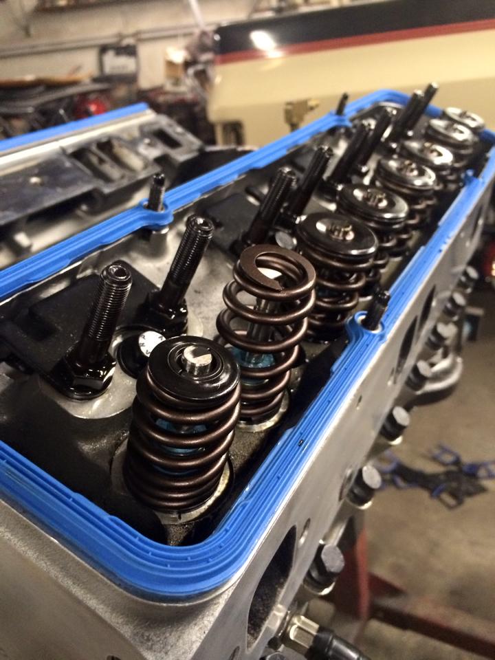

      - 350 bored 40 over- now a 357, full hydraulic roller set-up, aluminum heads, 10.5:1 compression, just tons of goodies inside. Just ask if you want to know more.

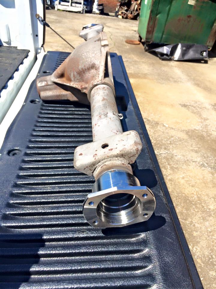

      -12 bolt rear end, narrowed 6 inches, Detroit limited slip, 3.42 gear U.S Gear, moser axles, big ford ends, disk brakes, and lots more.

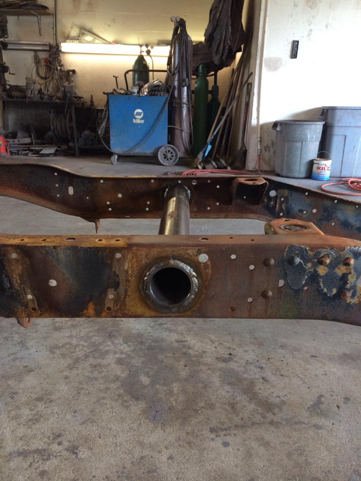

      -New to me/ the truck frame that I had a very good family friend of ours put on his frame rack and check it for laser straightness then cut and put tubes through frame like modern pick-ups/ cars.

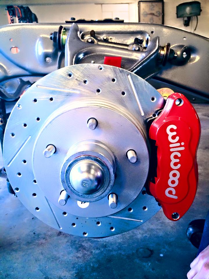

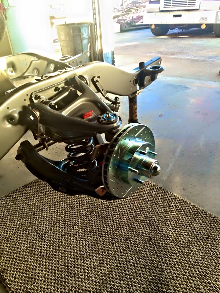

      -BAER Rotors with Wilwood calipers up front
      -Eibach 2 inch drop pro touring truck spring, progressive rate spring

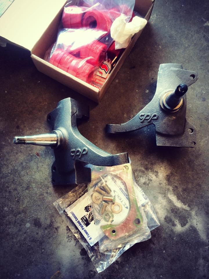

      -CPP 2 inch drop spindles/ 1 inch narrowing spindles to help tuck the big front tires

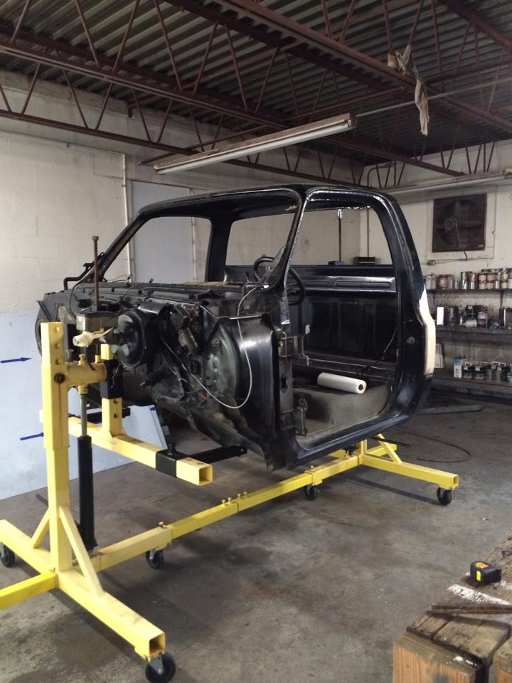

      Name:  truck 6 ex helper.jpg
      Help from the lady is always appreciated

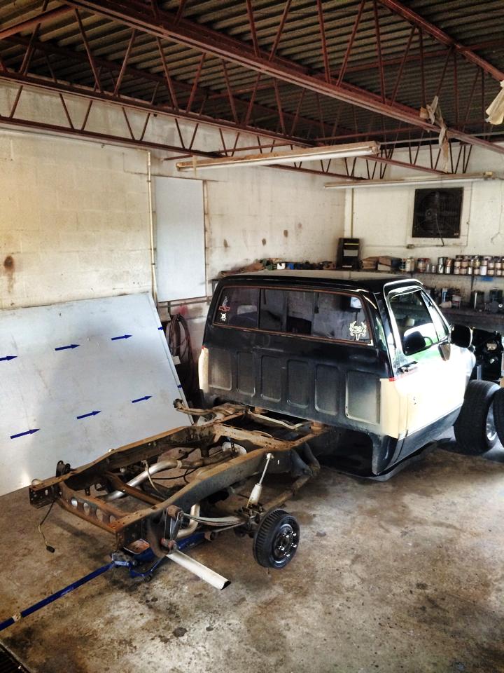

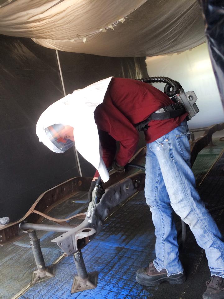

      Soon to be homemade blasting booth
      Name:  truck and  booth 8.jpg

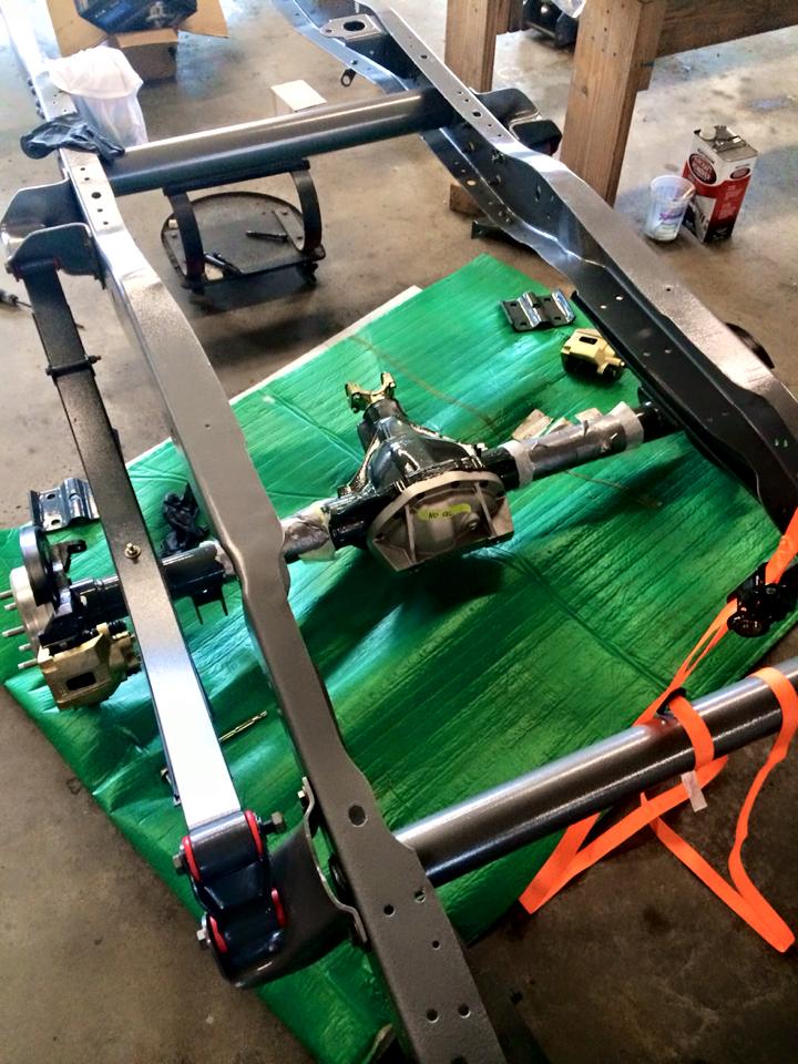

      Frame Coated by me in a Hammered texture grey tone along with all suspension/ frame components.
      Front Suspension Mock Up
      Name:  Front suspension.jpg
      Always nice to have friends helping. This is one of my very best friends who happens to be an accomplished engine builder and he and I are the ones who built the current engine for the truck.

      All New parts for my 12 bolt rear end!!
      Name:  12 bolt 2.jpg
      Name:  12 bolt 3.jpg
      Just deal with the leaf springs for now- I know lots of auto cross events have been run with cars/ trucks and leafs and while not ideal/ what I wanted money is restricting my budget and time since I need to be getting this things back on the road and out of my shop. ( it is monopolizing a lot of room) Soon enough it will be getting that 4 link from Rob at No Limit

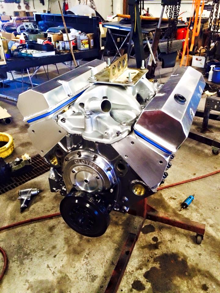

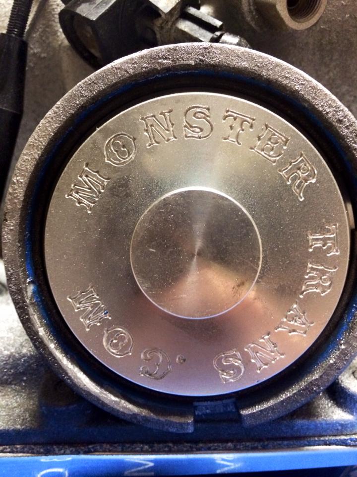

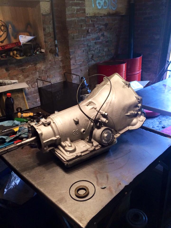

      The engine is getting a few upgrades ;)
