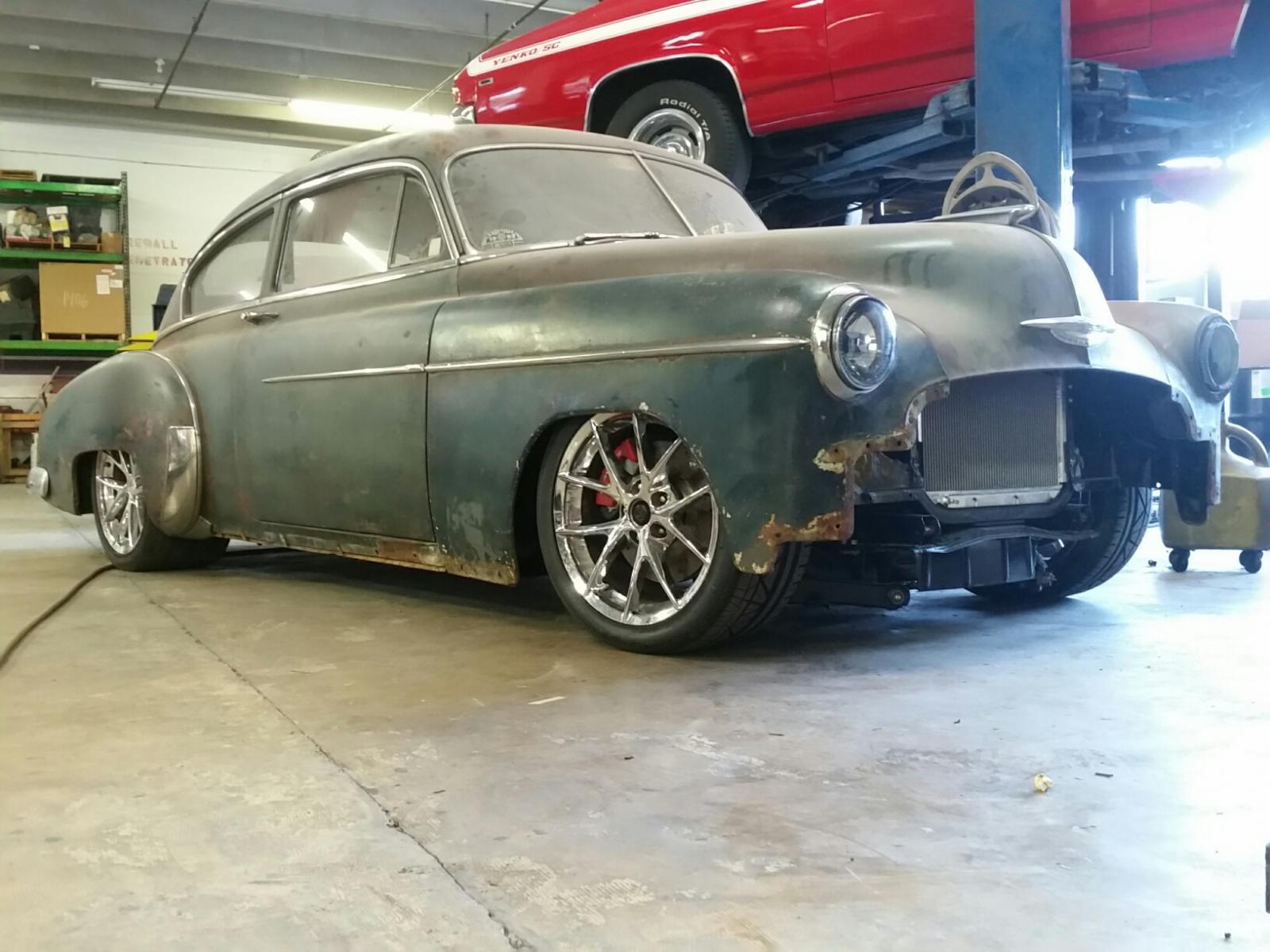

      on the ground
      Well she is off of the lift and on the ground . Also ran it acrossed the scales! I was pleasantly suprised. Now it still has some more parts to be installed, but looks like I should be able to keep it under 3,100 lbs. which is my goal! Balance looks pretty good front to rear also.

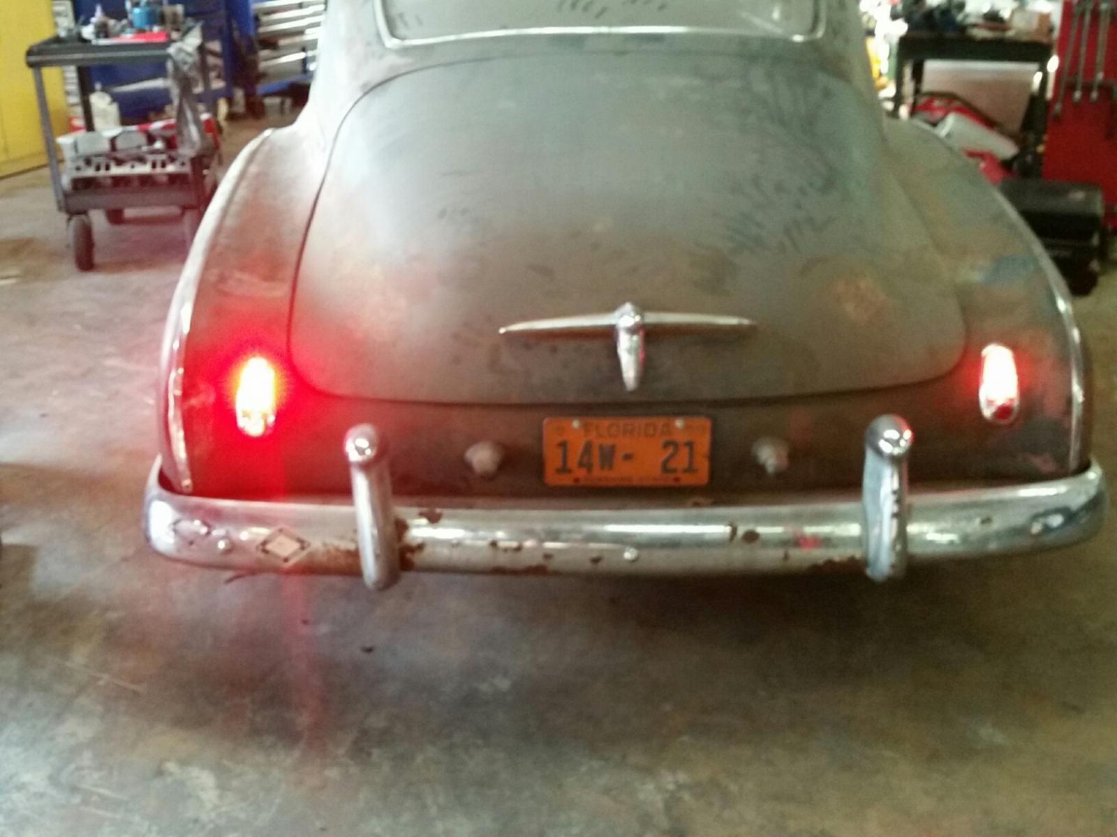

      Daytona Rod Run
      Went to the Daytona Rod Run and ordered smoothie bumpers from the BumperBoyz.com, and bought some LED lights from Rodworkz.com Here is some test pictures, of the tail lights. Driverside is LED, passenger side is stock lens with 12v standard lights

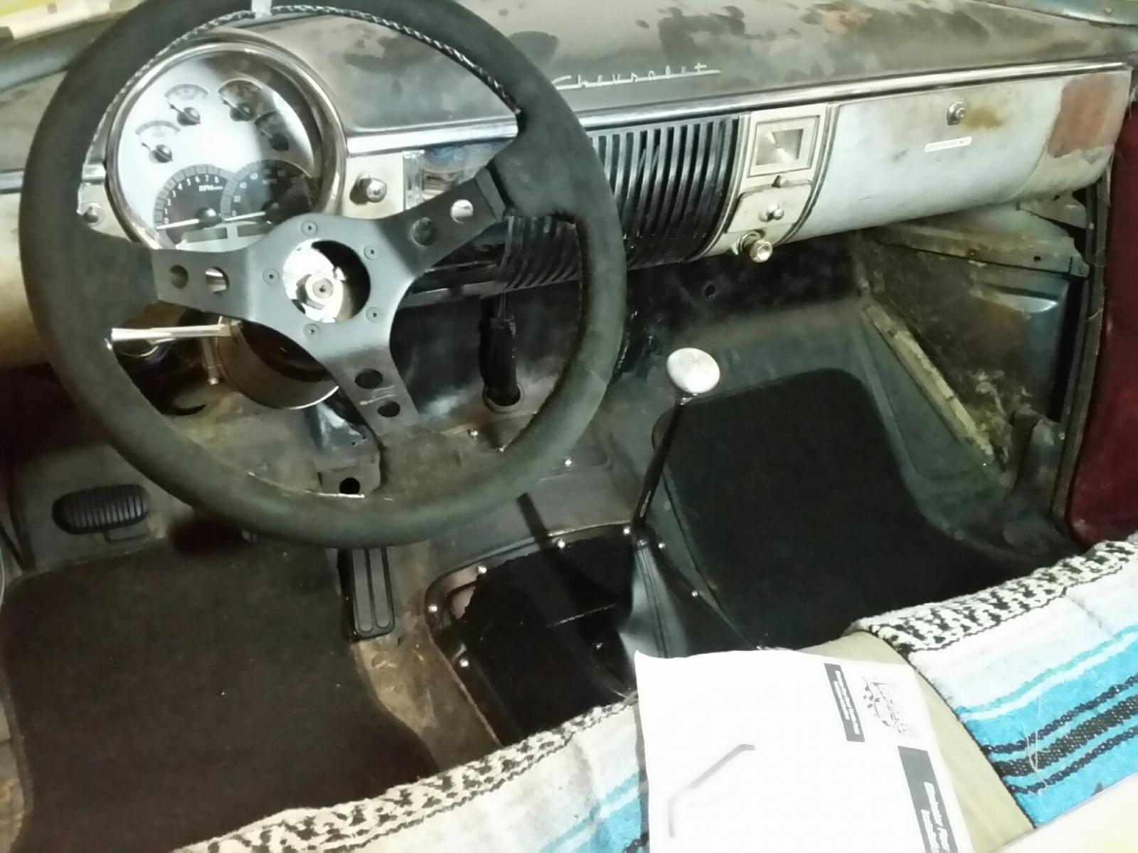

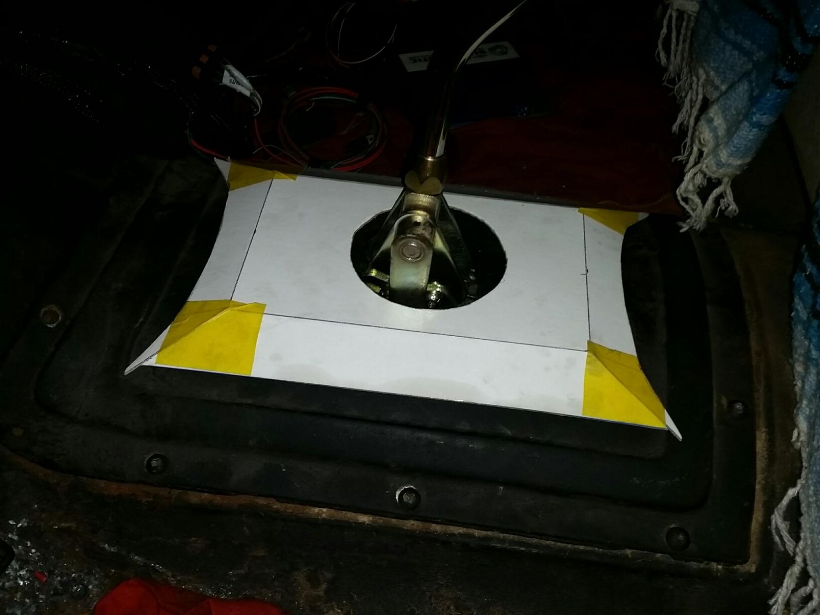

      shifter cover
      Had to modify the transmission tunnel to clear the 4L60E and Lokar shifter assembly. Fits great now!

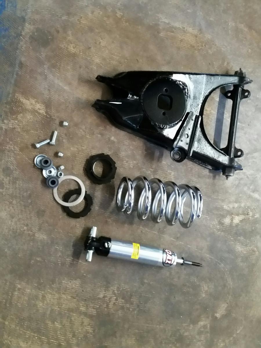

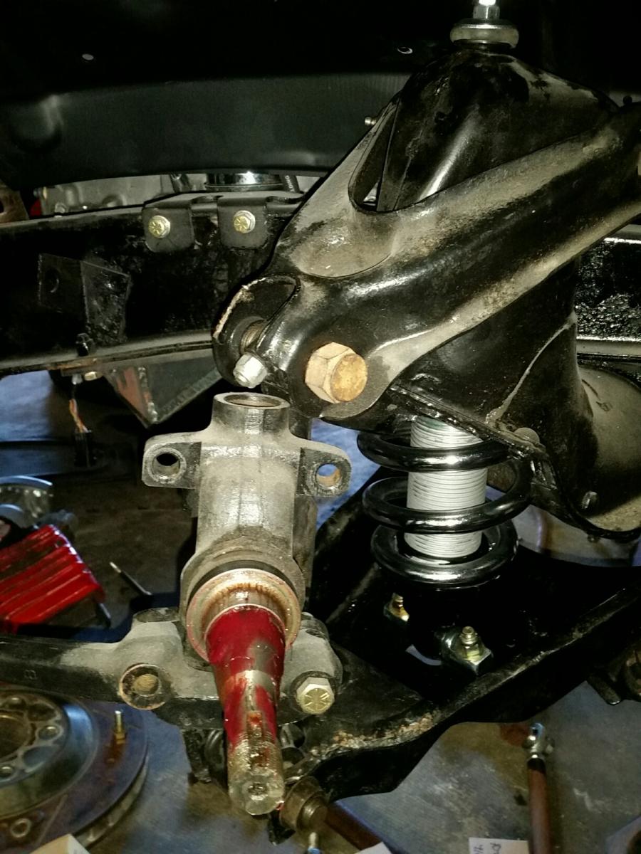

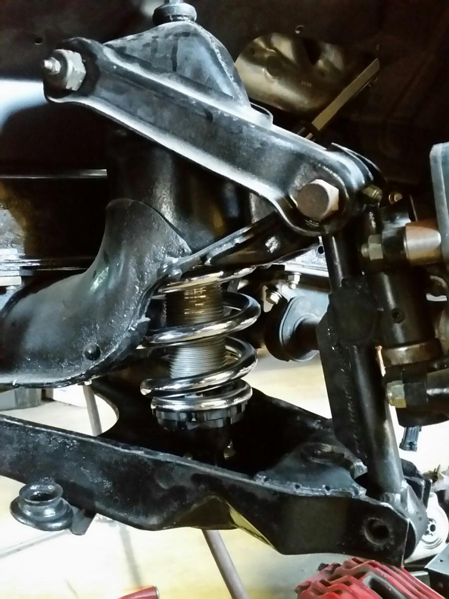

      LCA and coil overs
      Modified my stock lower control arms to work with the new QA1 coil overs, and a small notch to clear the wheel on hard turns. First picture is a stock arm and the modified next to each other. I made new 1/4" plates and sandwiched the stock control arm, after cutting out the old spring locator. With the 2 plates sandwiching the stock LCA, they should be able to handle the stress of hard cornering.

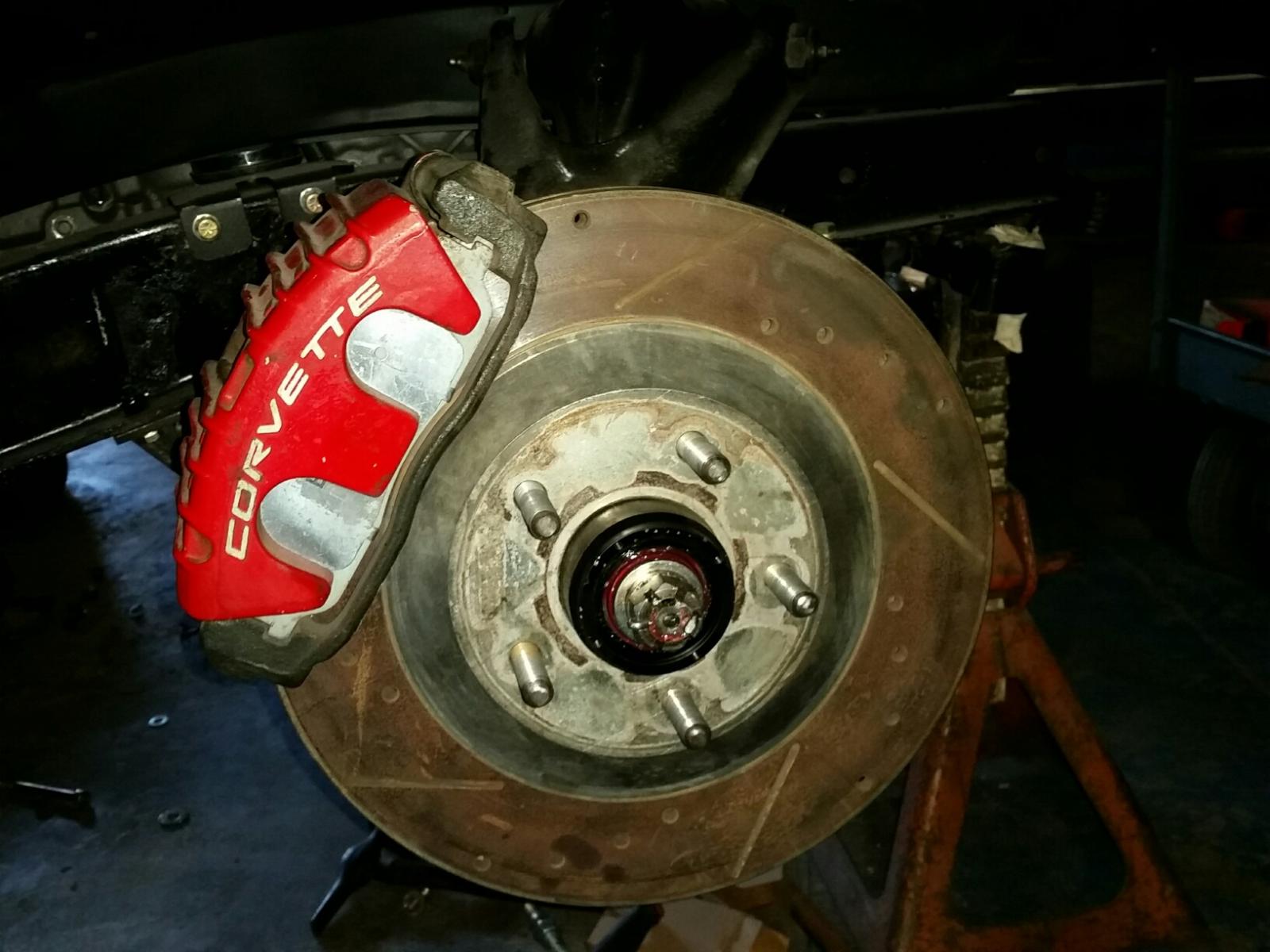

      finalized the front brake mounts
      Finished the front brake caliper mounts to the original spindles. Now the C5 ZO6 brakes should be ready to do work! Just have bleeding brakes left. Another thing off of the list.
