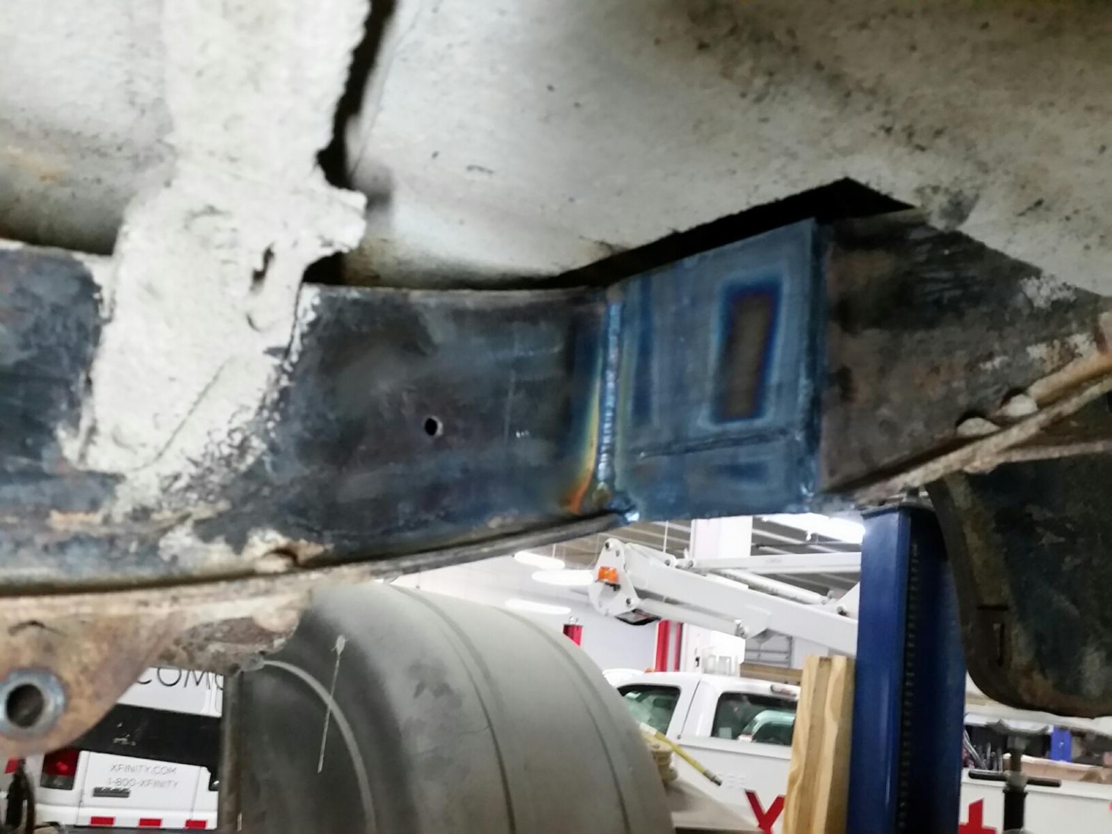

      started to box the steps in the rear frame. Didn't finish today, ran out of material and Argon...

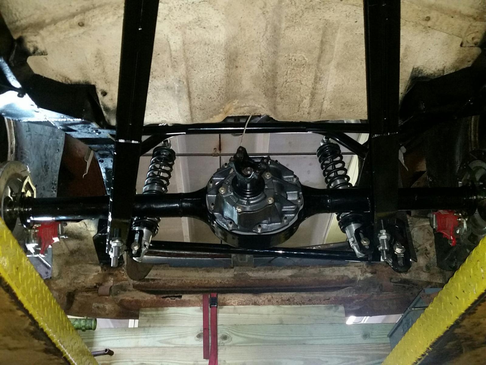

      Started a rough mock up of the rear suspension. 9" ford with 45" truck arms.

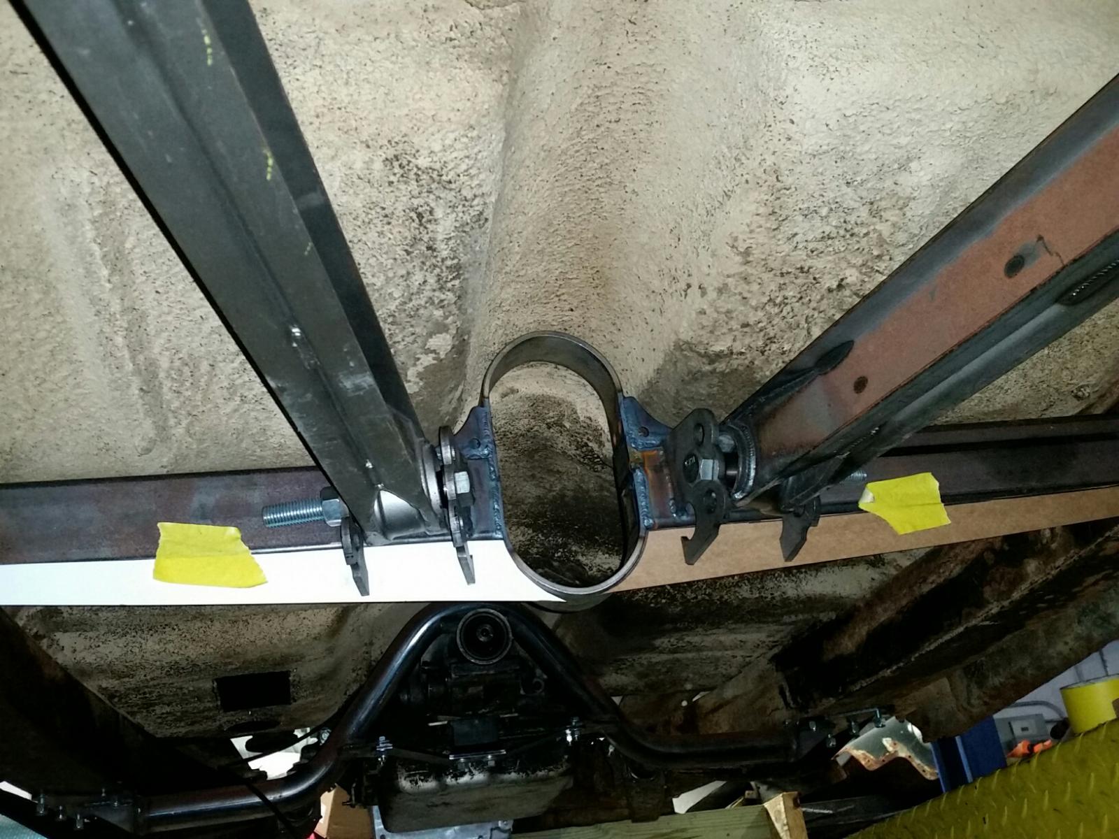

      crossmember
      Started to build the truck arm cross member.

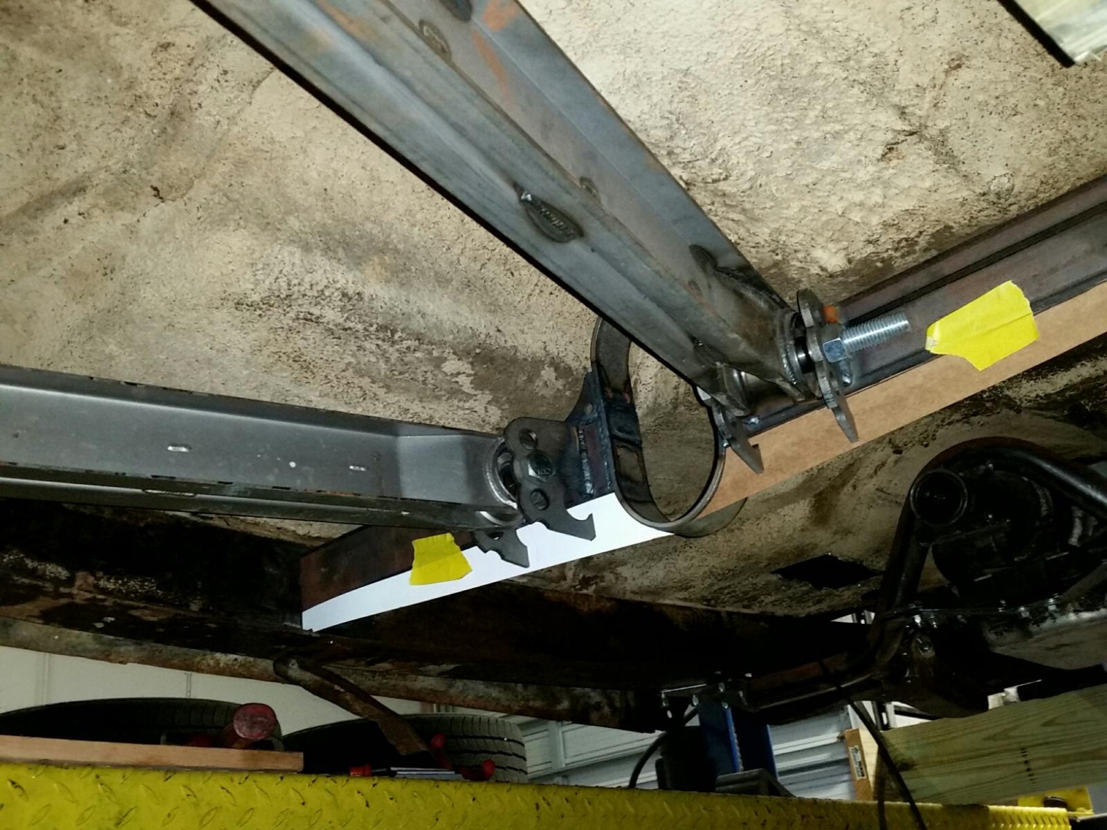

      200
      Still have to finish boxing the crossmember, the next pieces will go where the card board templates are.

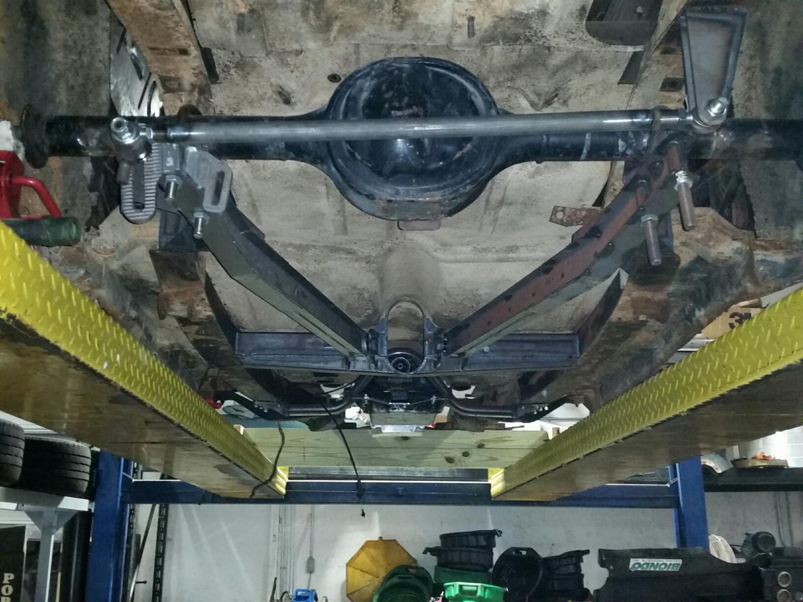

      200
      been busy
      Well, I've been working on the car, and my internet was down at the house, so I haven't posted any up dates, but I will try to catch this thread up. Rear frame welded in, painted and final install. 31 spline Moser axles, G Force posi unit, and Strange nodular case, check.

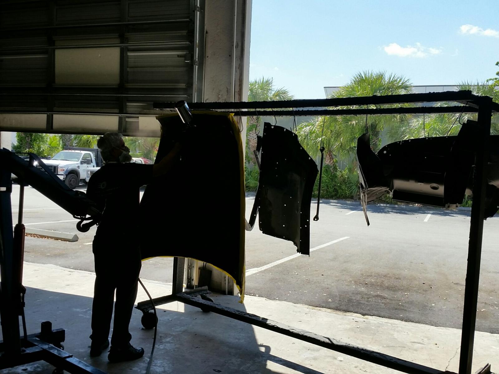

      firewall
      Now it is time to get the engine bay ready to get the power installed. Holes in firewall welded shut, sections of firewall hammered and dollied for engine clearance, and paint

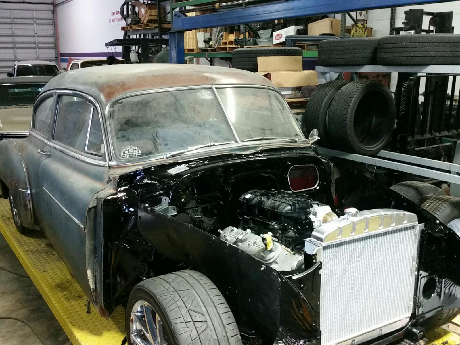

      Engine sitting in the engine bay, finally....

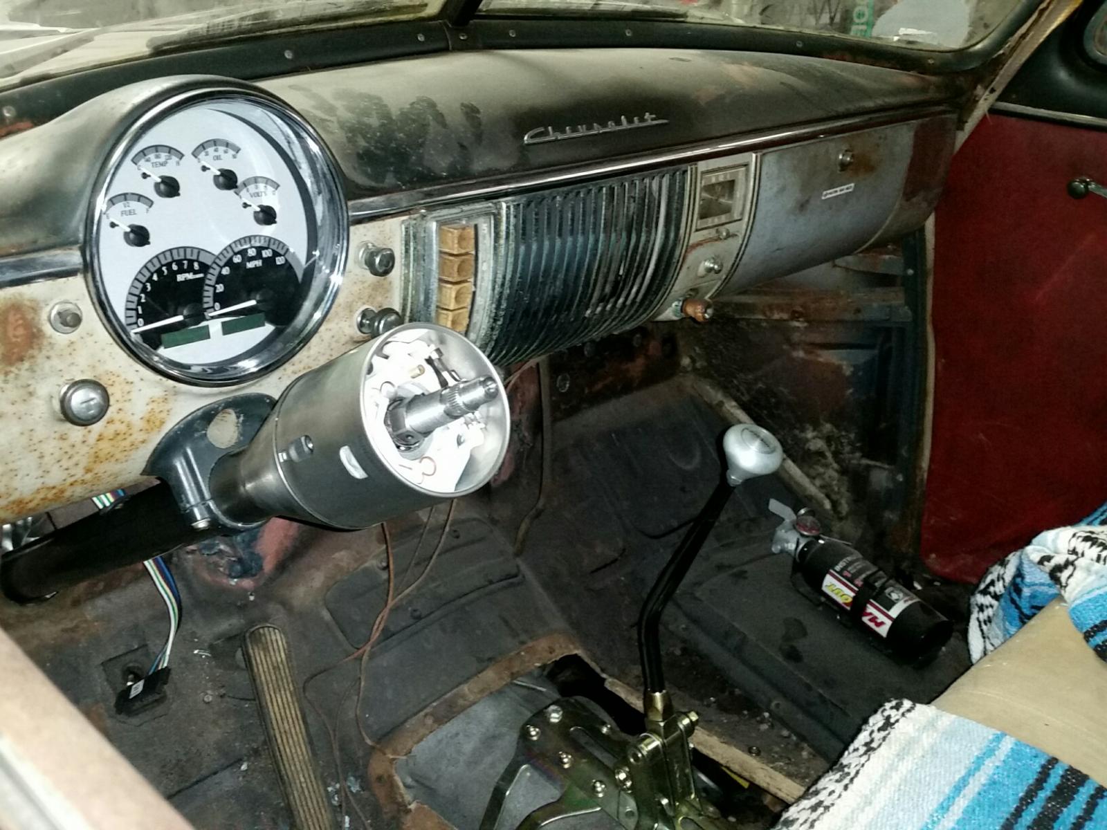

      Dakota Digital VHX instrument cluster, Flaming River tilt column, and Lokar shifter installed.

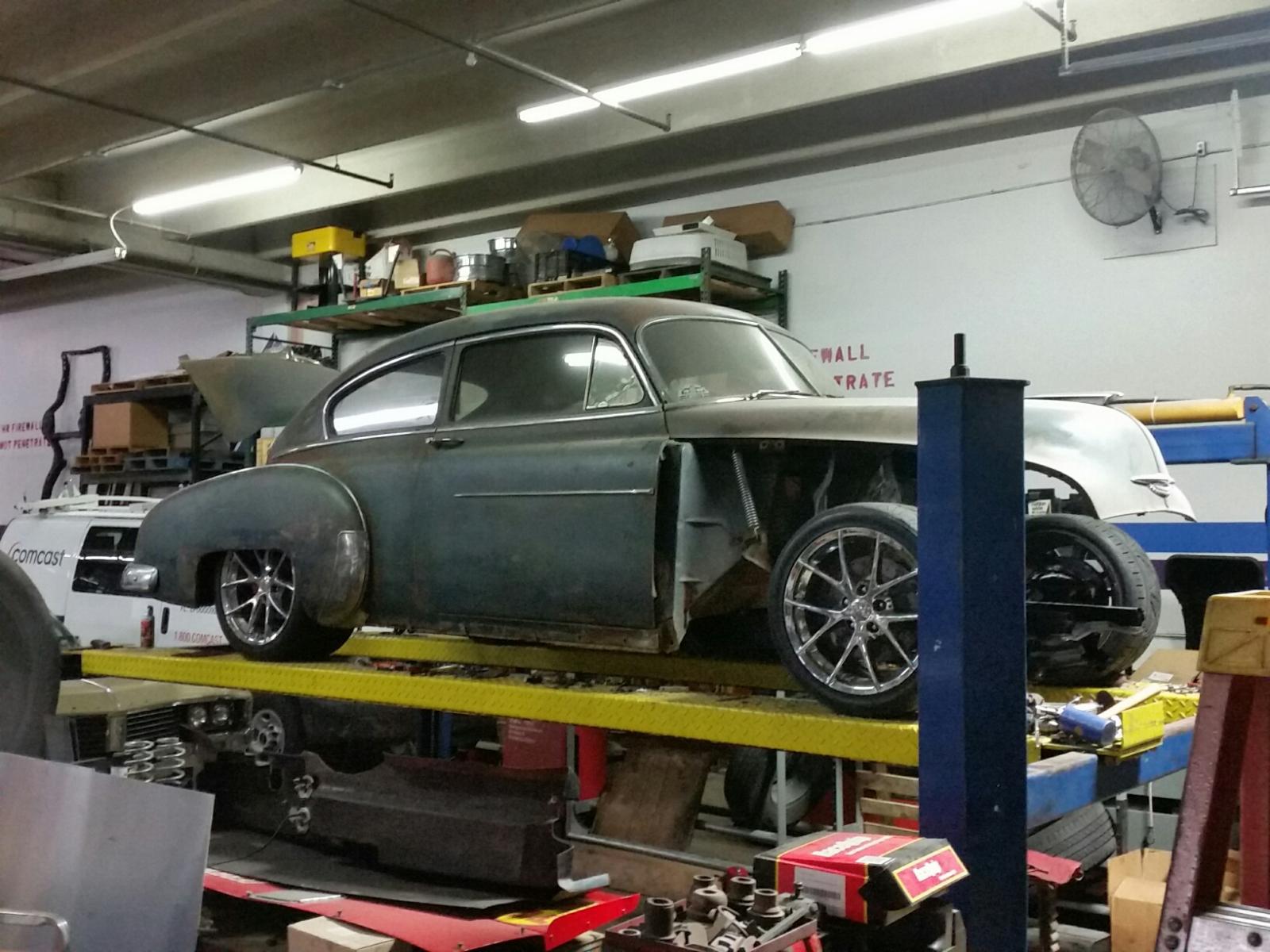

      it's all about the stance
      Well, getting closer, finally on all 4 wheels, and most of the front sheet metal back on! Love the stance!!
