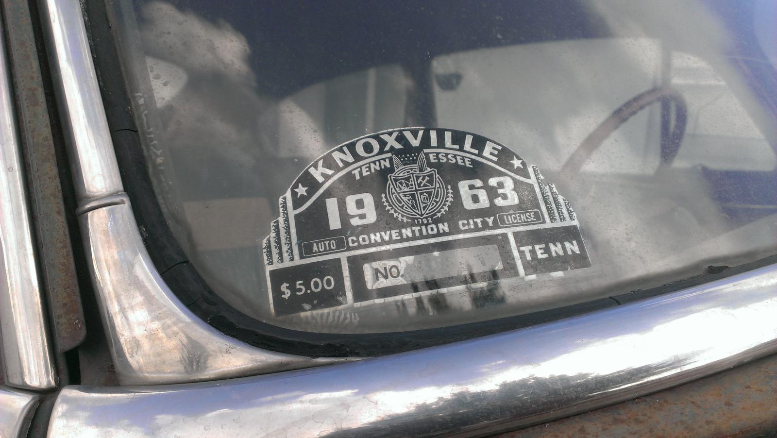

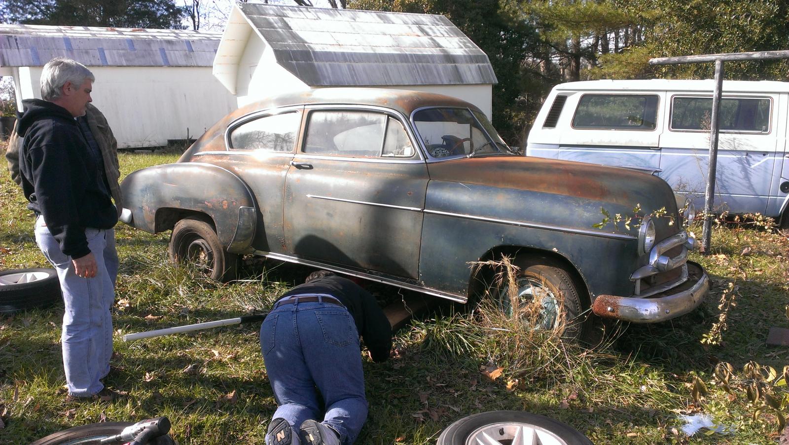

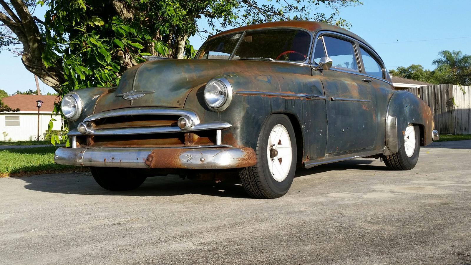

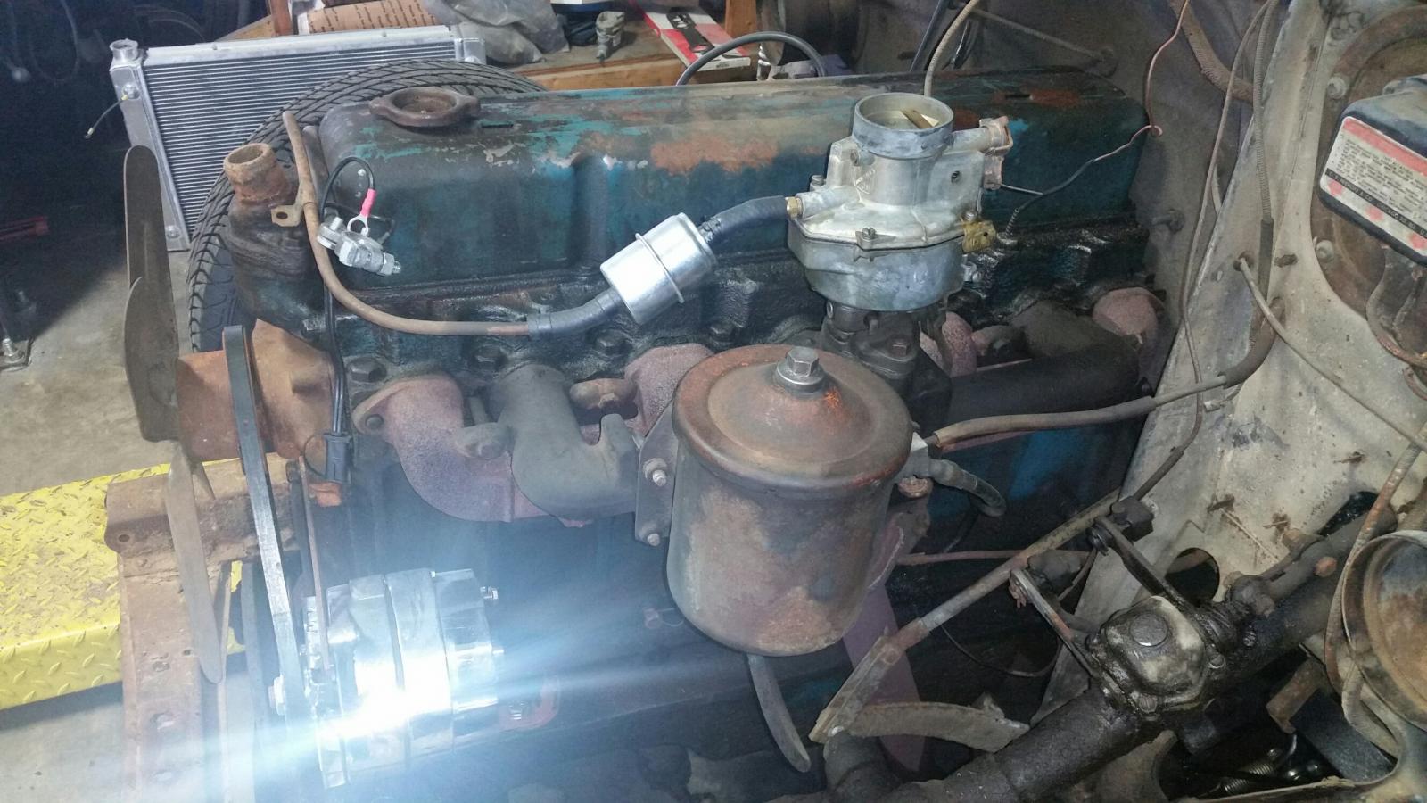

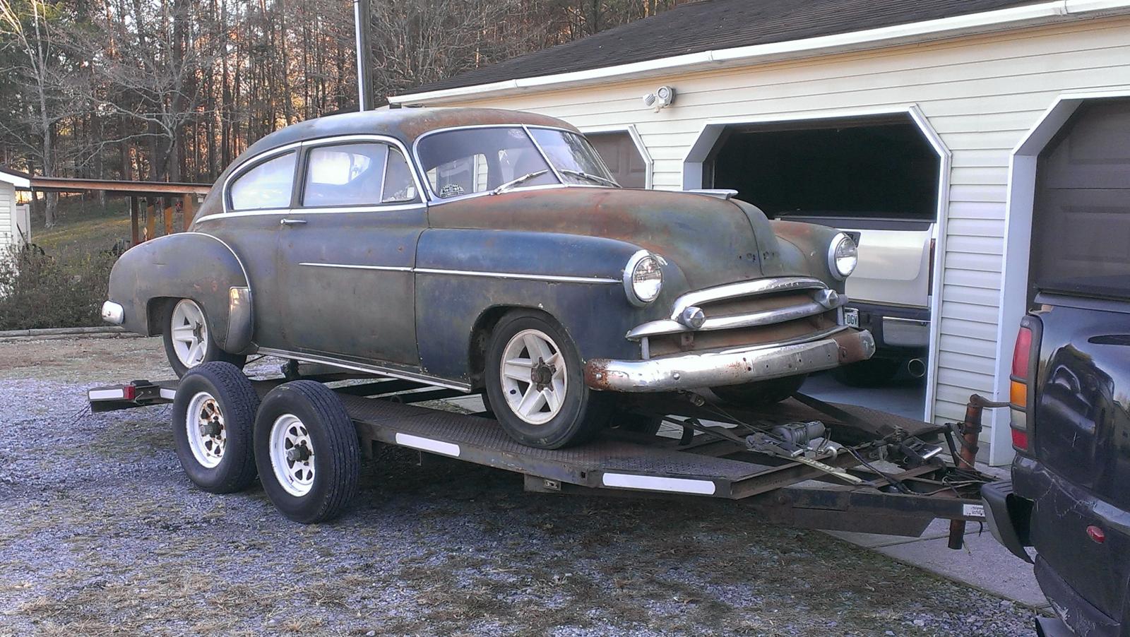

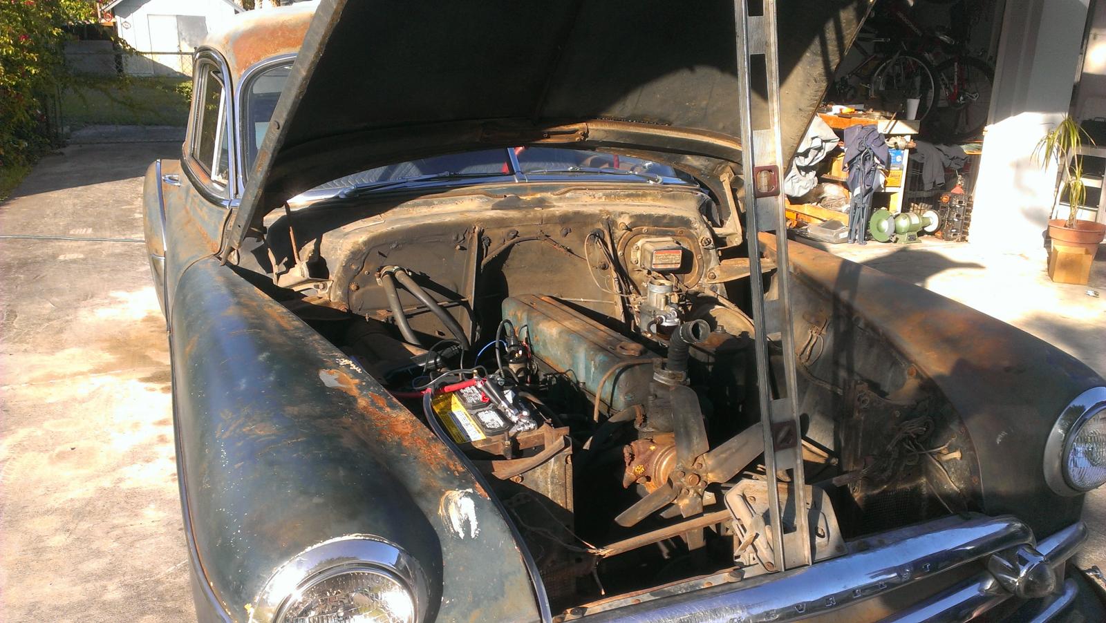

      Here is a couple pictures of the 1950 Fleetline, I picked up in Knoxville, Tn. 1 family car, sat in a barn from 1975ish to summer of 2013. I picked it up in Nov. 2014, got the engine un frozen, rebuilt the front suspension and added disc brakes and 12 volt conversion. Drove it to some local shows why I gathered parts for "part 1" of it's Pro-Touring build.

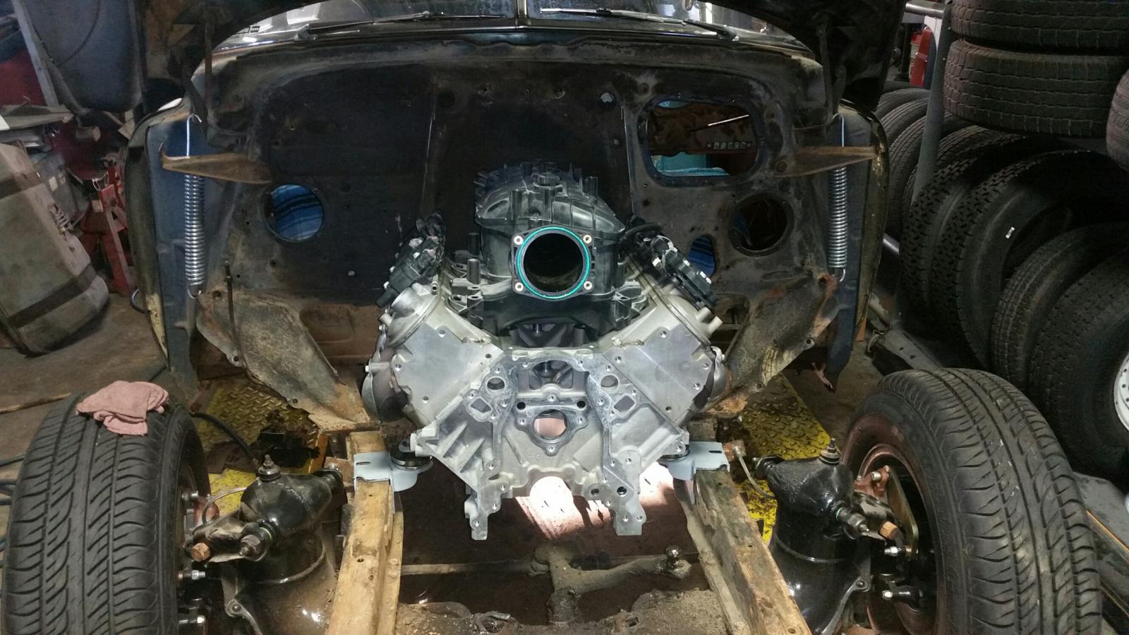

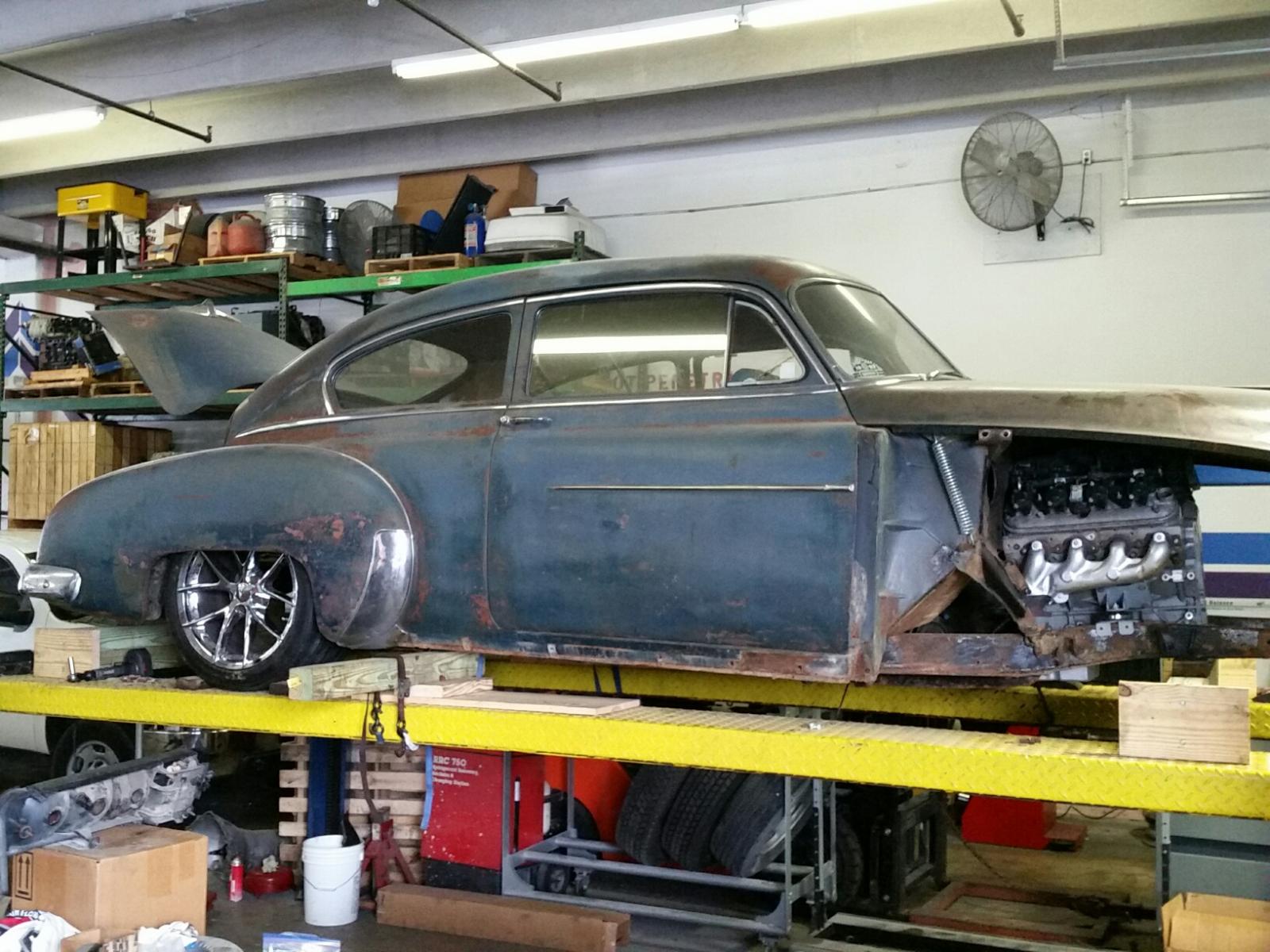

      Now in precess with "part 1" of the Pro-Touring build. 6 cylinder engine, 3 speed transmission,, and leaf springs out torque tube, rear differential and leaf springs out. LS1 with 4L60E trans in for mock up, 9" rear axle with 3.50 gears, and 45" truck arms and coil overs going in.

      Nice upgrades! That cross member looks sturdy with the tube over and the mount under it. Does this have a split drive shaft?

      This car originally had a closed driveshaft (torque tube) it will be a single aluminum driveshaft when I am finished.

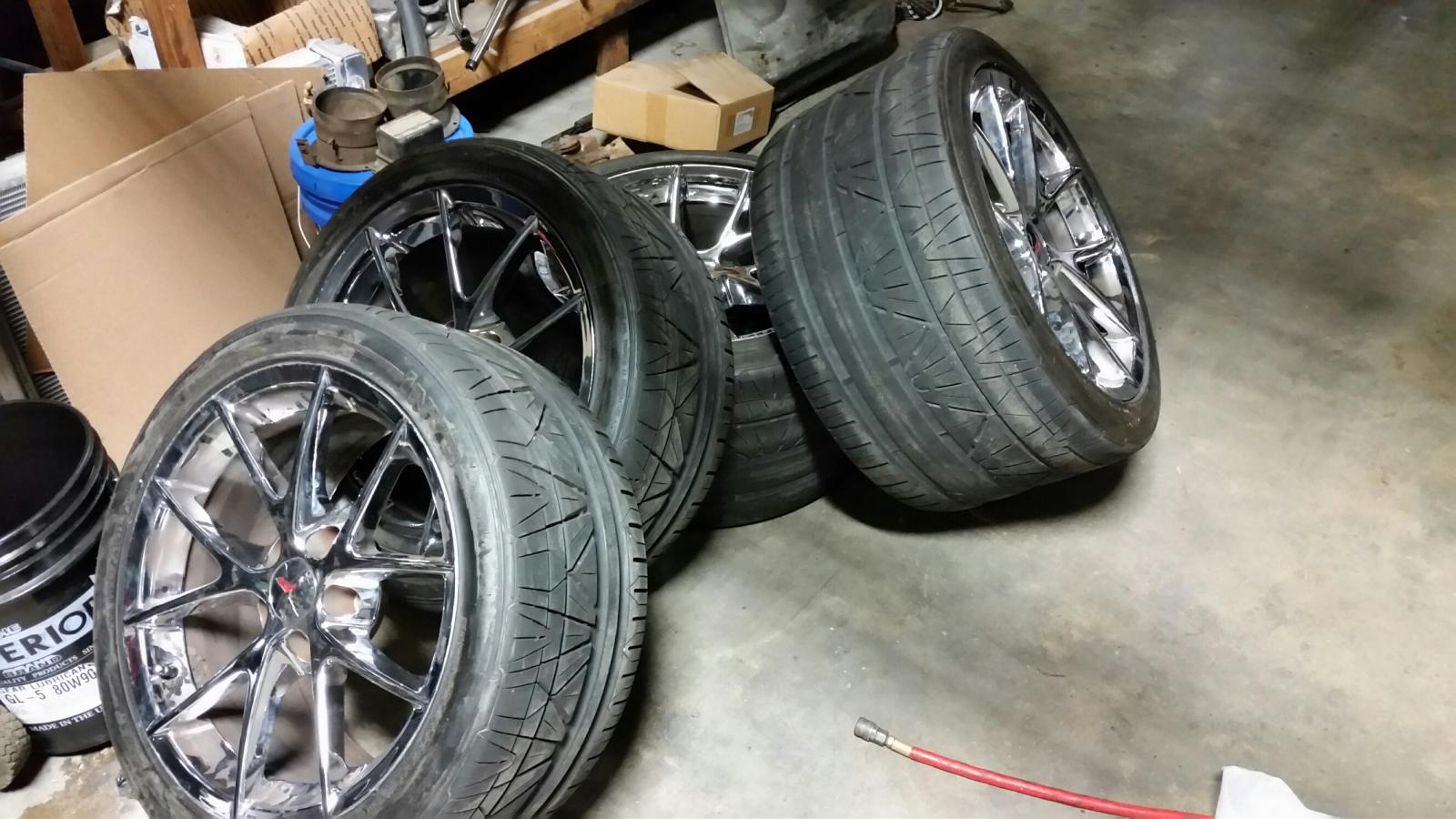

      Tires and wheels. 18 x 9.5 fronts with Nitto Invo 275/35-18 and 19 x 12 rear with 345/30-19 Nitto Invo

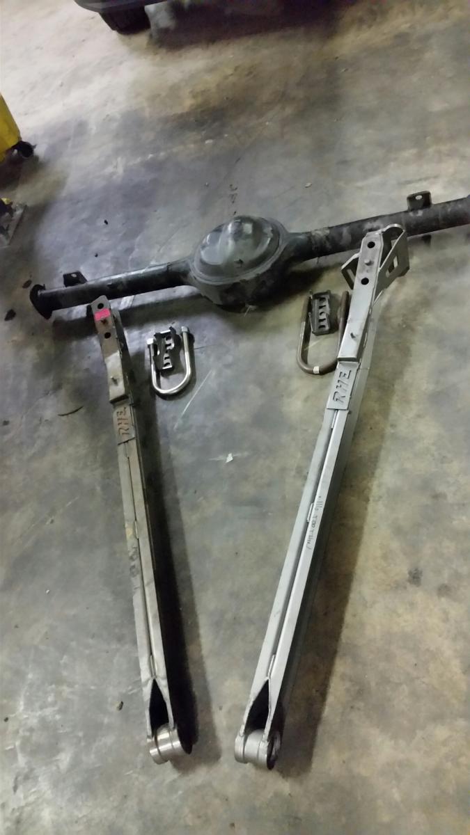

      HRE truck arms, and 9" housing. Going to start building the cross member today. C5 brakes should be delivered on Tuesday

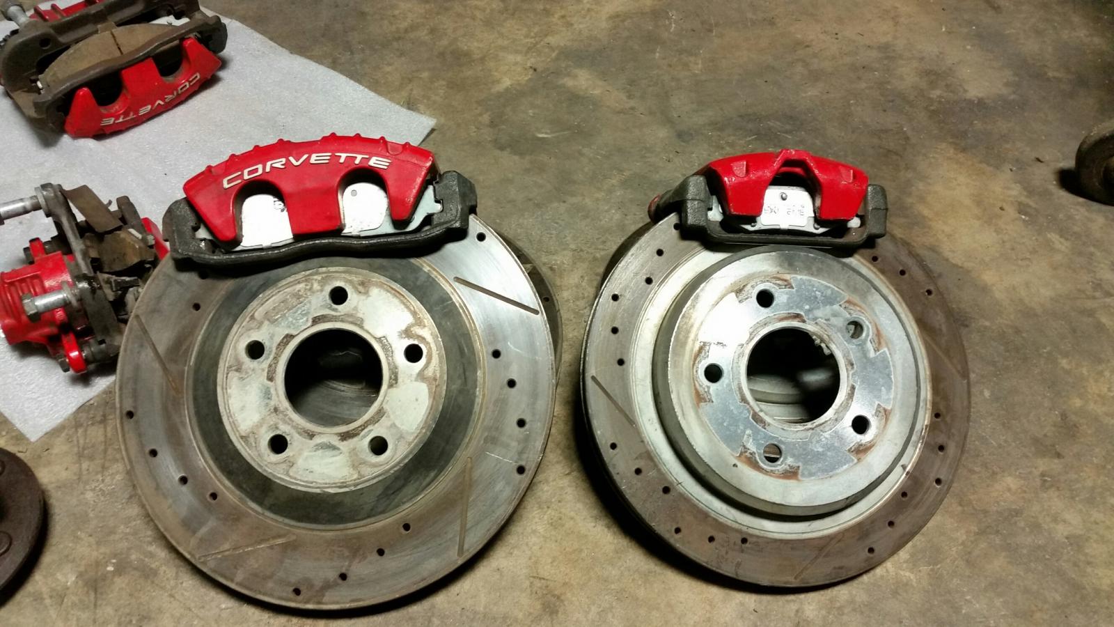

      update 12/15/15
      Brakes can in today, time to get back to work!!

      You're off to a good start. The nice thing about the c5 brakes is if you ever want to upgrade just go to c6 z06 brakes. They bolt right up.

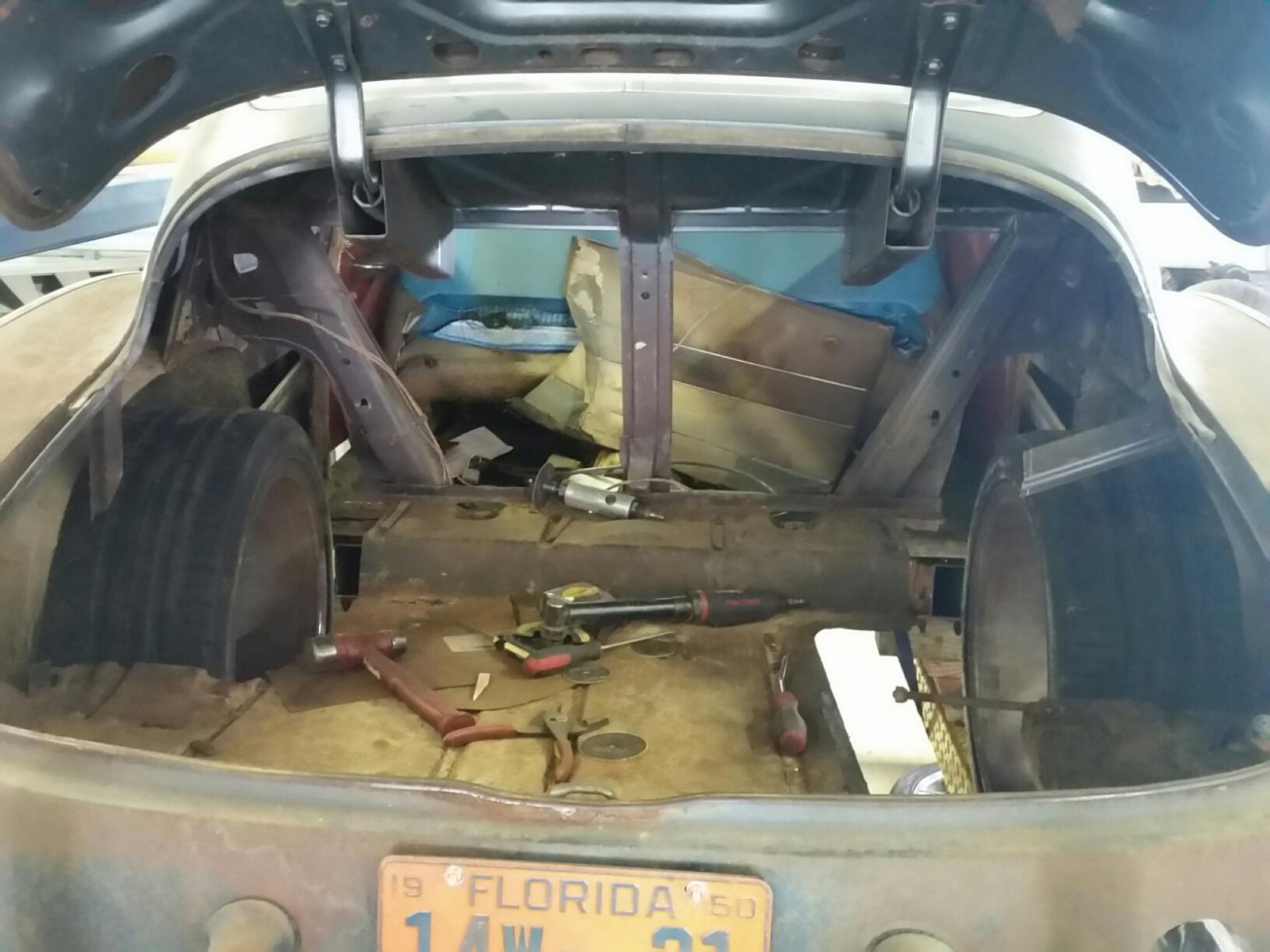

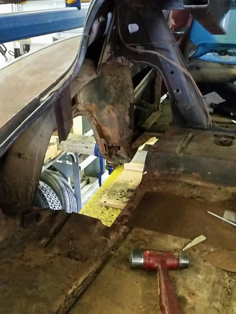

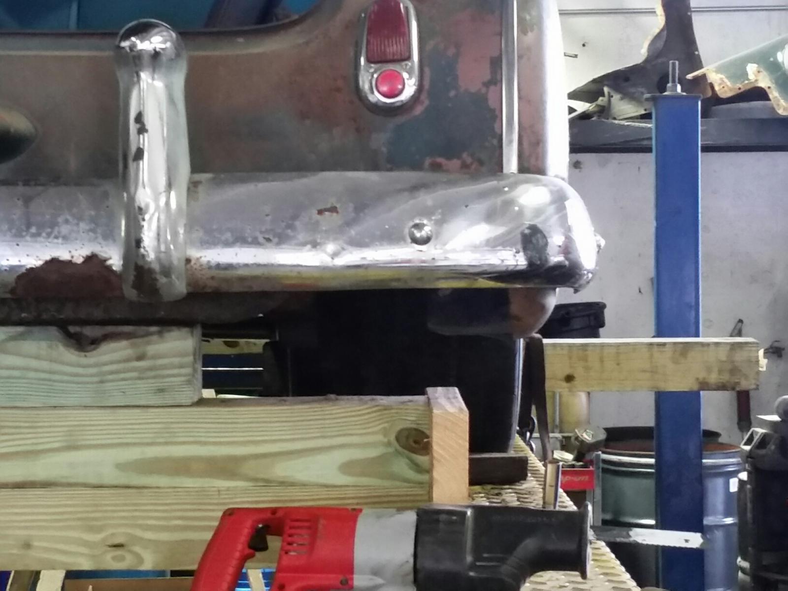

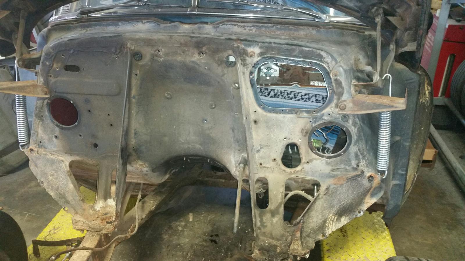

      Making more progress. Going after the rear frame narrowing for the 305/35R19 tires on the 19x12 wheels. Got car sitting on wooden blocks close to ride height.

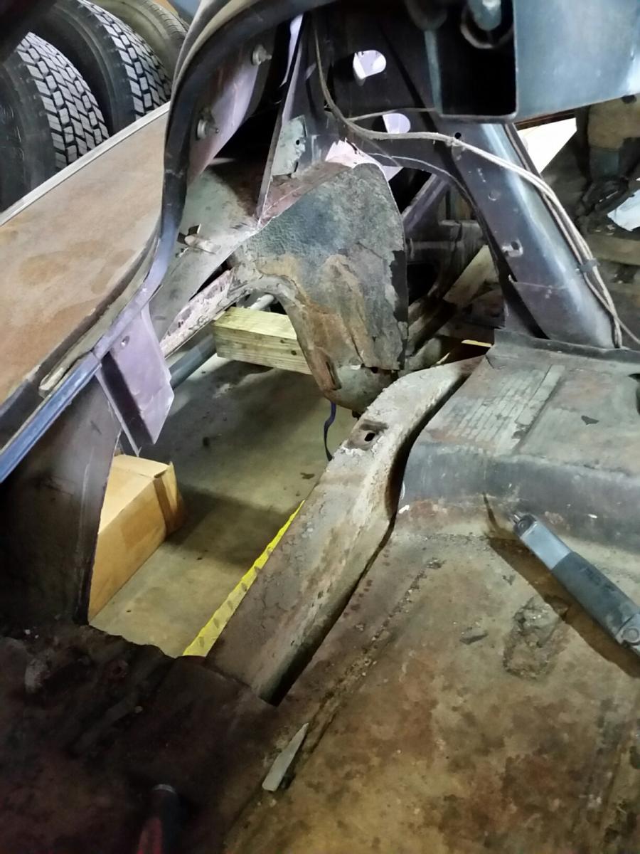

      cut inner fender wells out, and removing a portion of the frame rails.

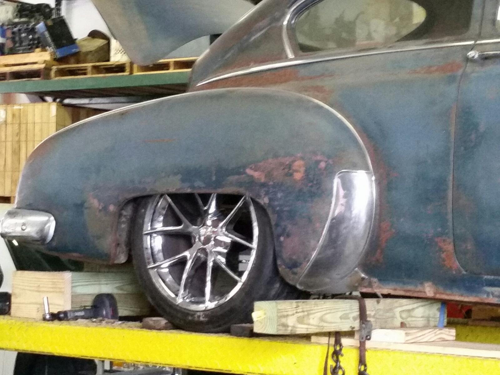

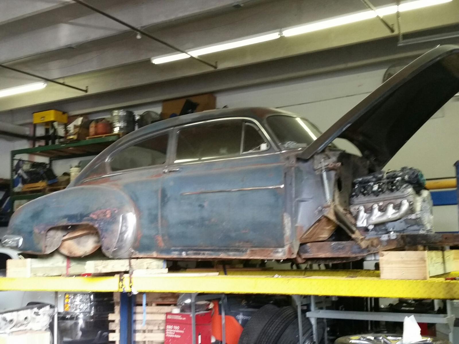

      set new tire and wheels in place to see how it will look.

      Trunk view of the new tire/wheel package.

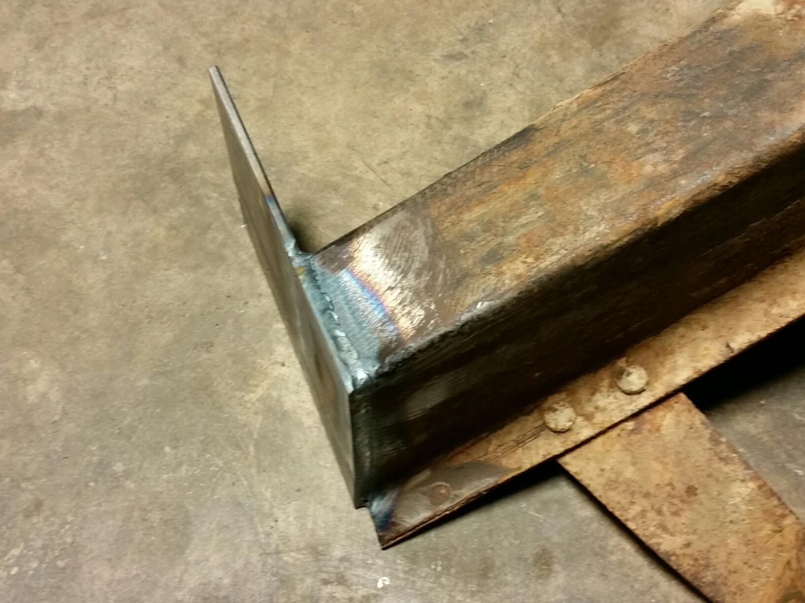

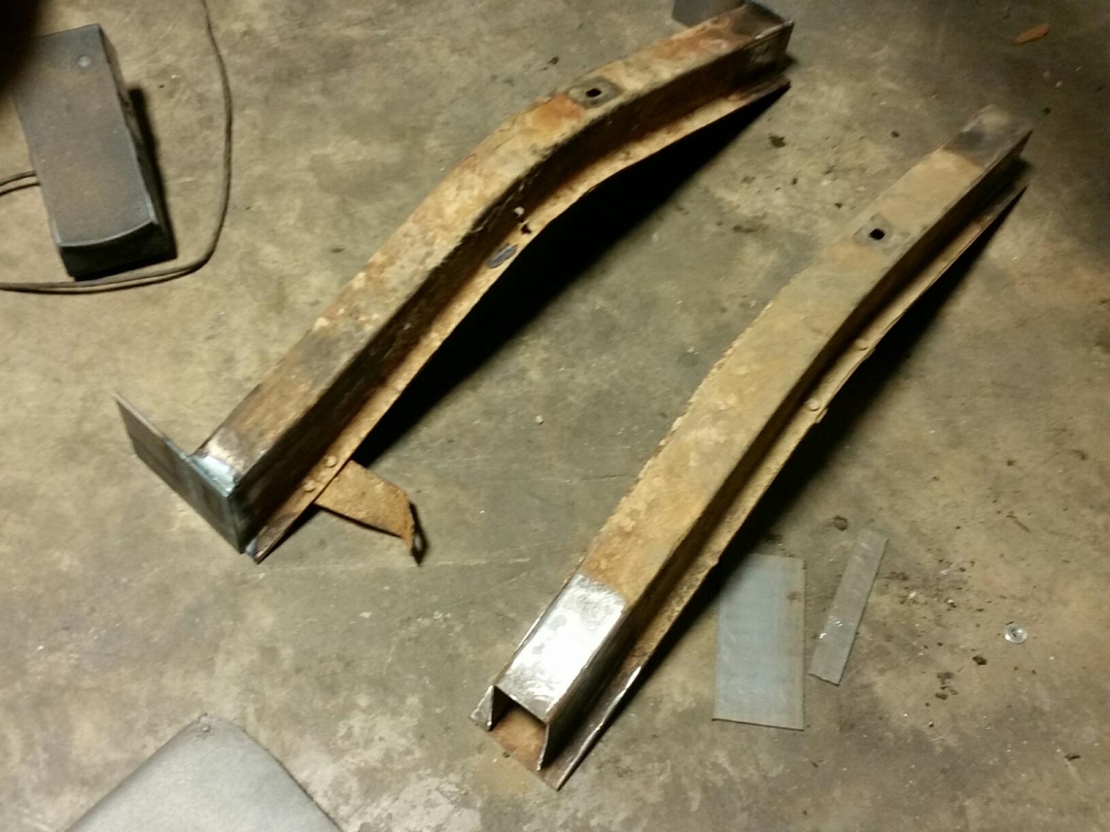

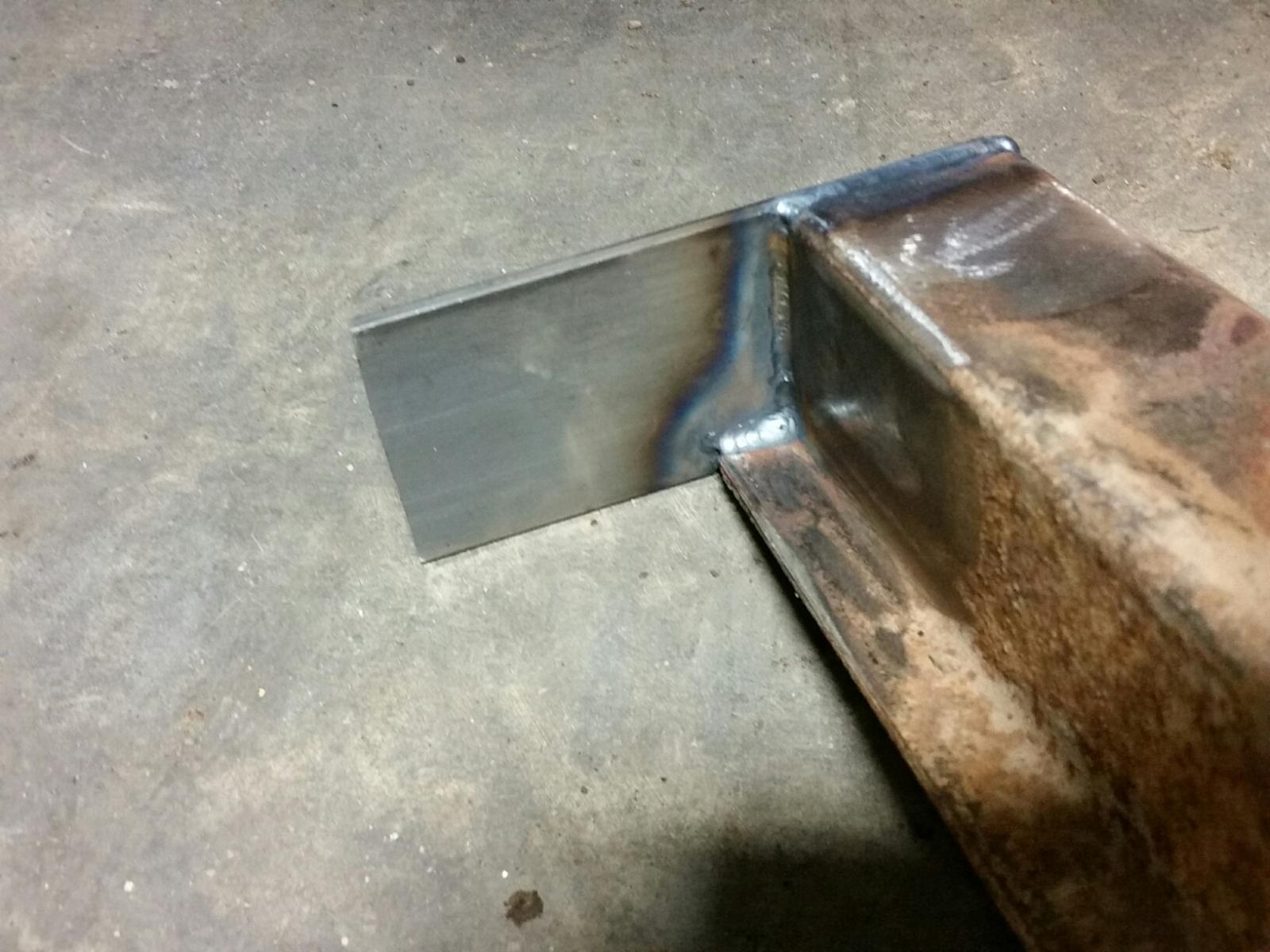

      getting the removed frame rails prepared to go back in place 4" inboard.
