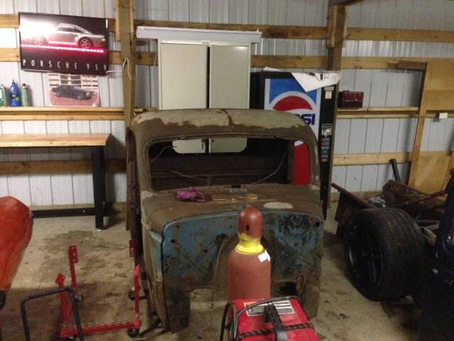

      Hello, it's been along time since I've posted here but I've been busy on my project. I need a vehicle that I can beat on and not worry about wrecking or even scratching. So this might not be an extreme Budget build, but body work and paint are not a concern. Lots more pics in my photobucket too.

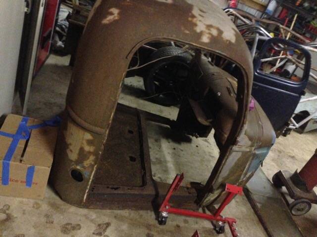

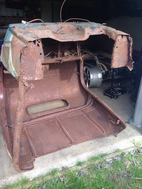

      I bought a complete 1941 or 46 body off craigslist (no vin or title)for $150

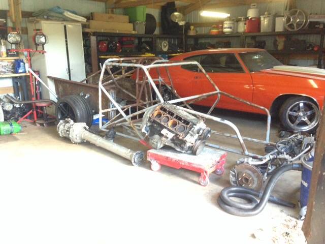

      I also found an almost finished pro street tube chassis that had been left outside for a few years when the owner died. Paid$ 200 for that off craigslist too.
      /s79.photobucket.com/user/383chevelle/media/image_zps3utqwey4.jpeg.html][/URL]

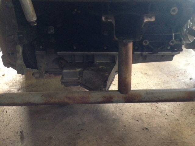

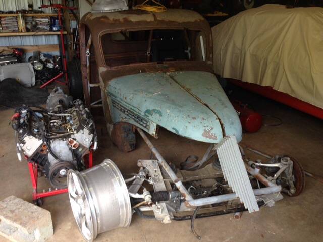

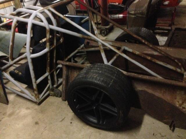

      I already had a 2000 5.3 that I didnt have a use for. I started mocking everything up and realized the the tube chassis would have to be cat apart way more than I thought to make it fit the cab.

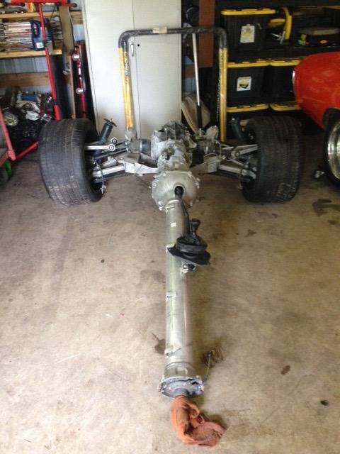

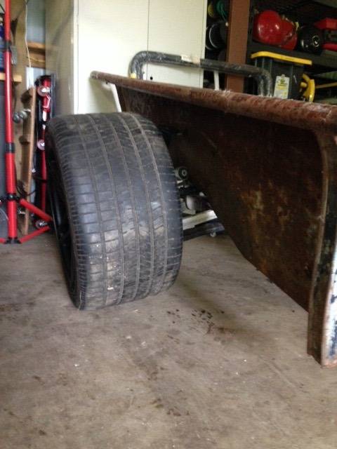

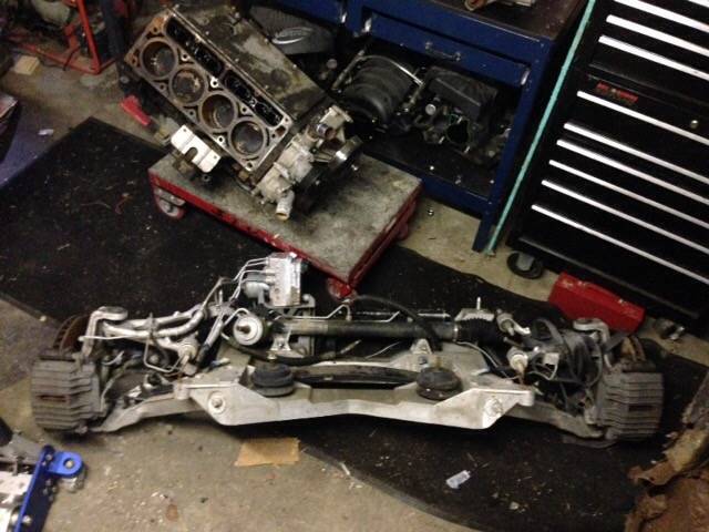

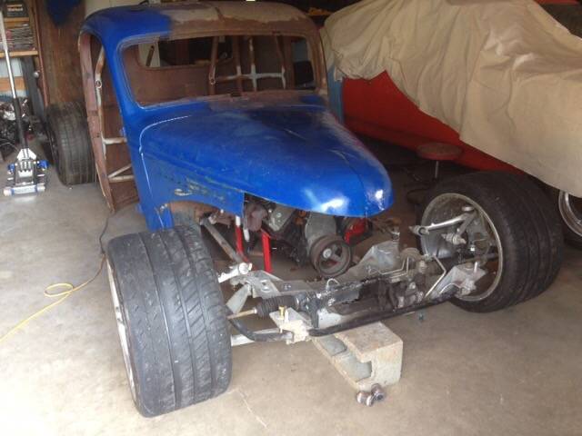

      Another craigslist score: 2004 c5 corvette running gear( brakes, suspension, trans and torque tube) paid $1800
      The 5.3 in the pics was not the motor I used. I had a spare block sitting around.

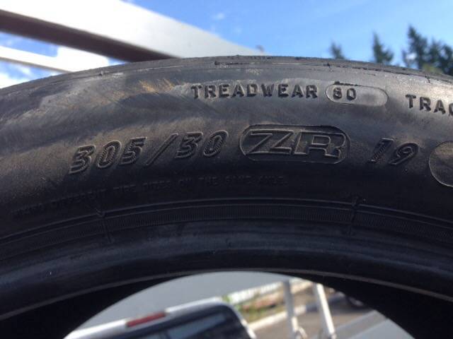

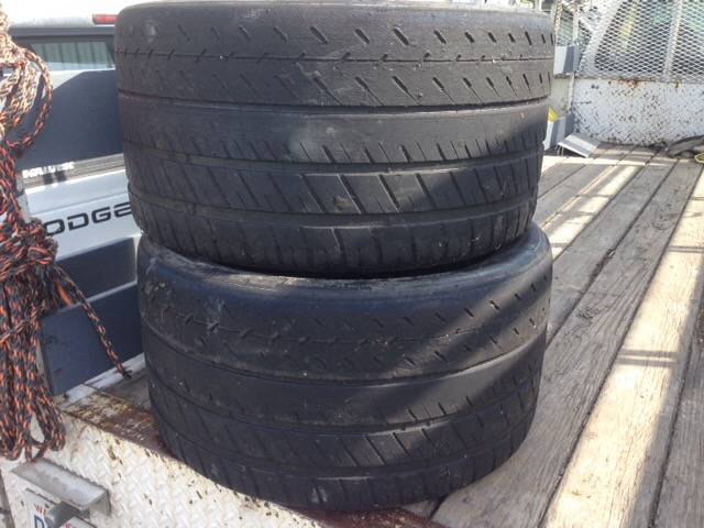

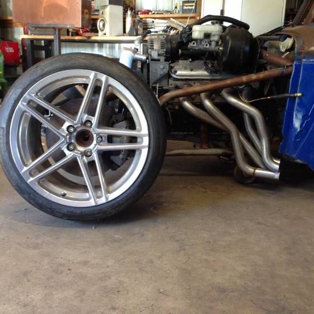

      Picked up some real 19x12 z06 wheels, eBay this time

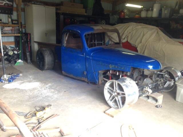

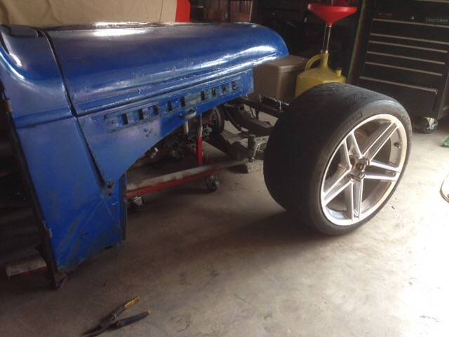

      Rattle canned it blue just to see if I liked the color.

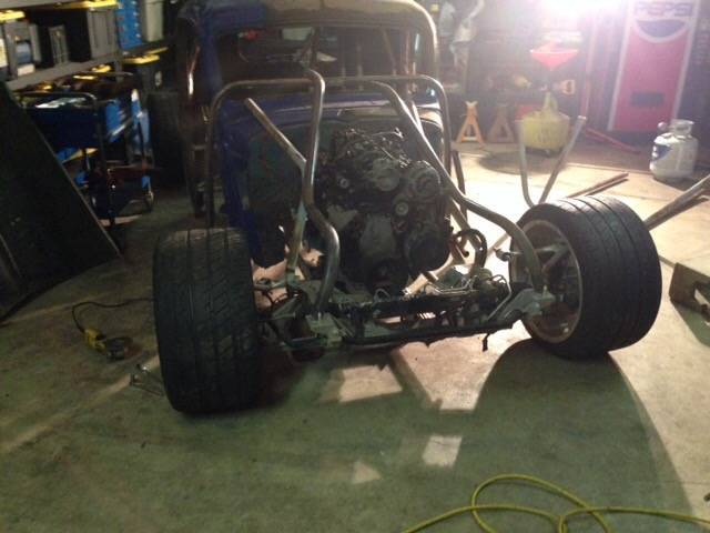

      Sitting on rubber all the way around.

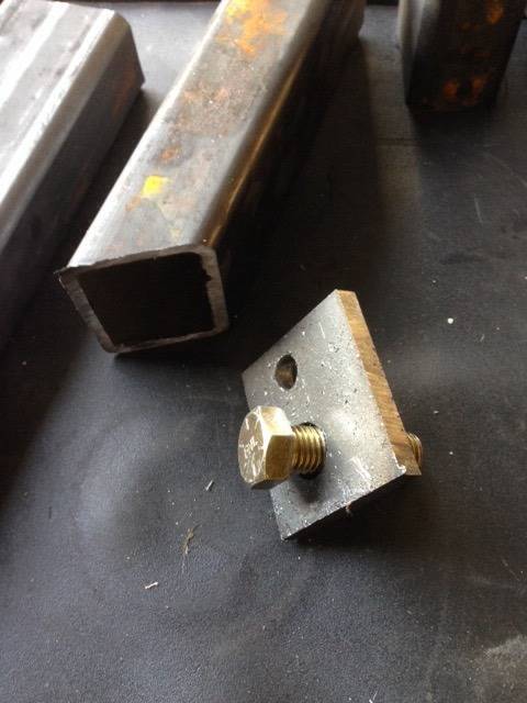

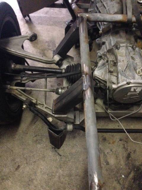

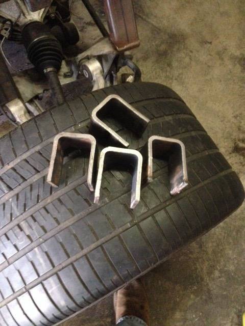

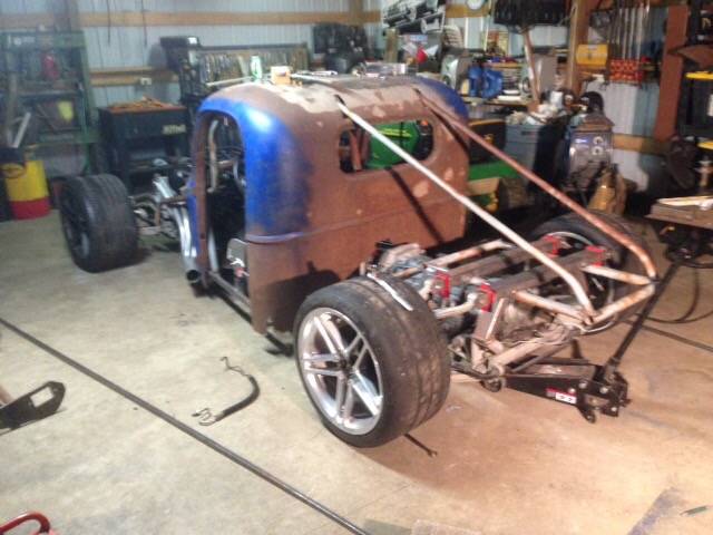

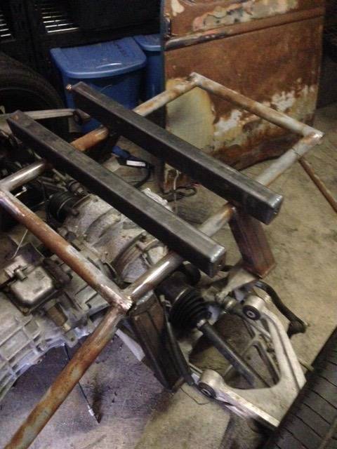

      Building the mounts for the rear cradle
      Motor stand
      Rear upper control arm mounts

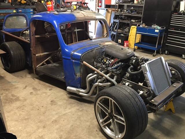

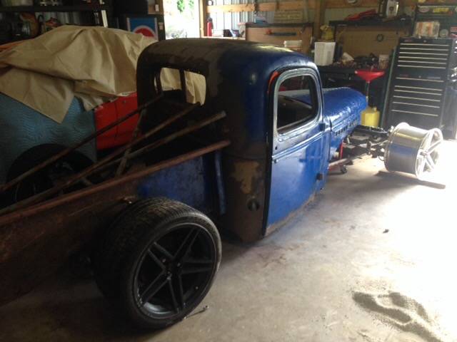

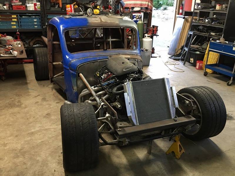

      eBay aluminum radiator

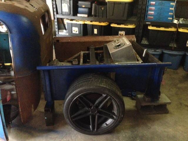

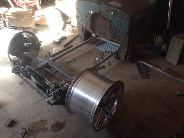

      Mocking up the bed

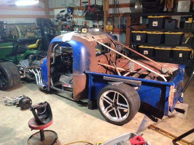

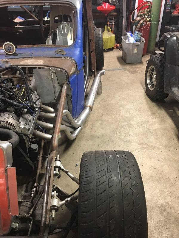

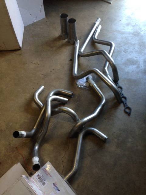

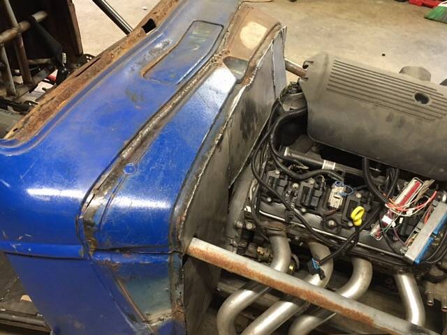

      Bought an 1 7/8 header kit

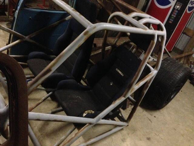

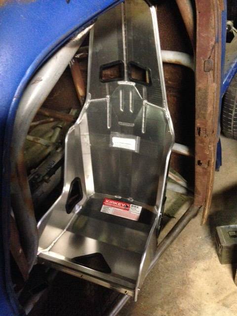

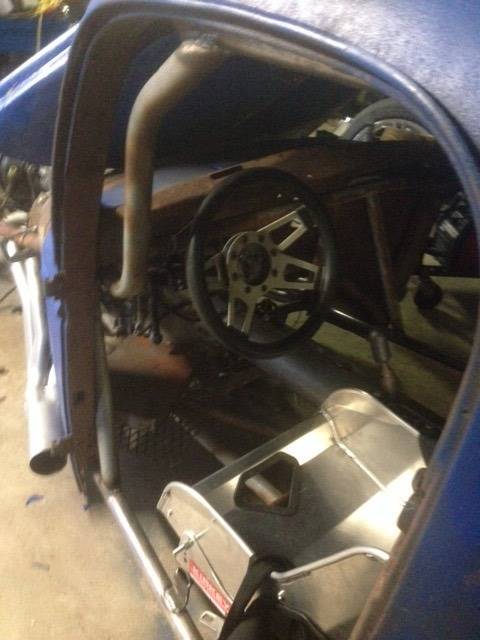

      The corbeau seats are too thick and took up way too much room, so kirkey.

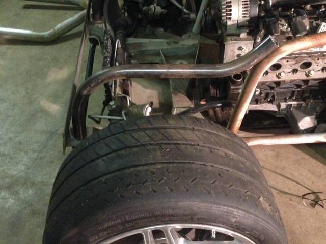

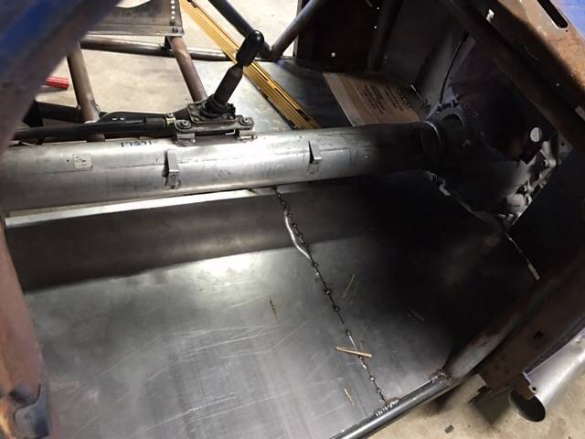

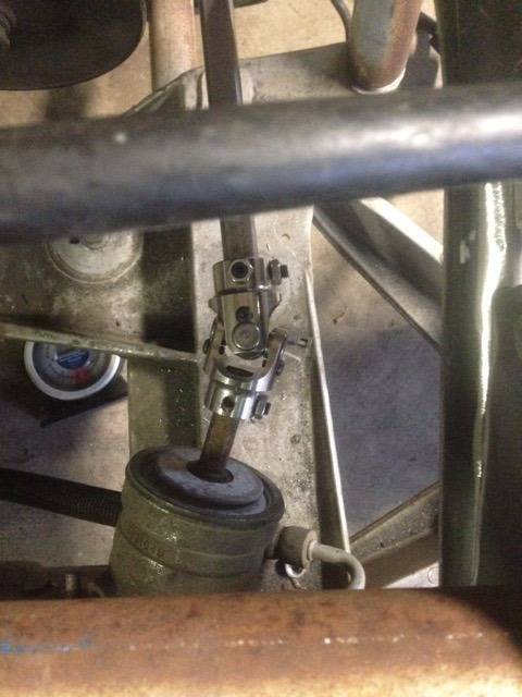

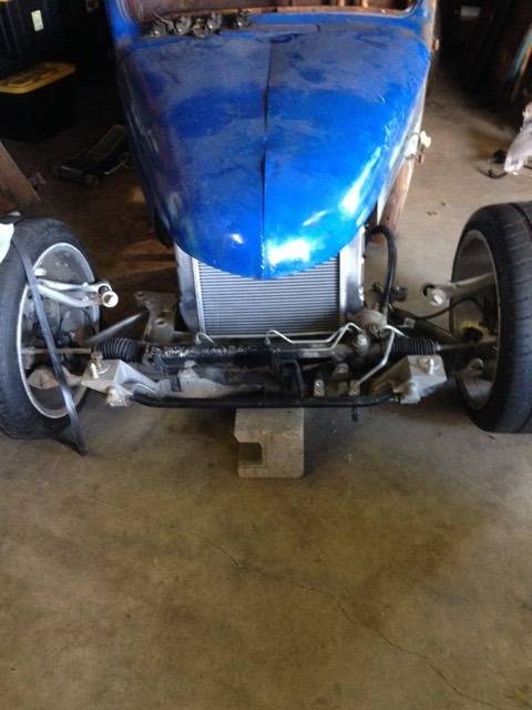

      Steering is mostly done

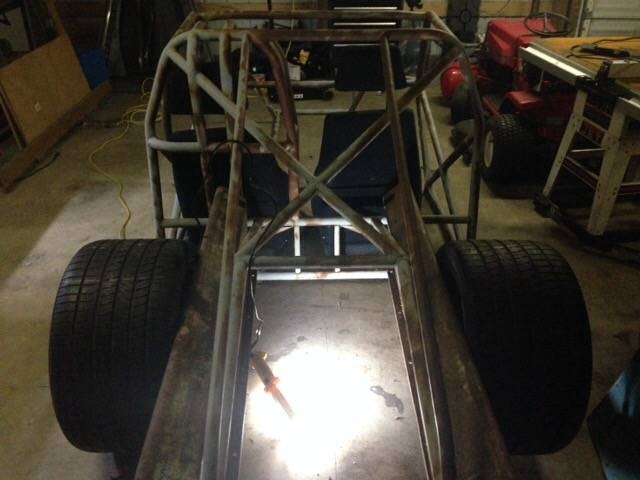

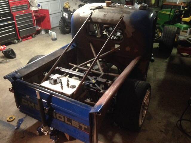

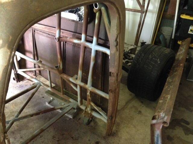

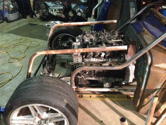

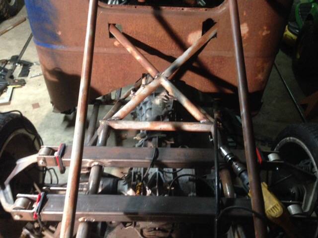

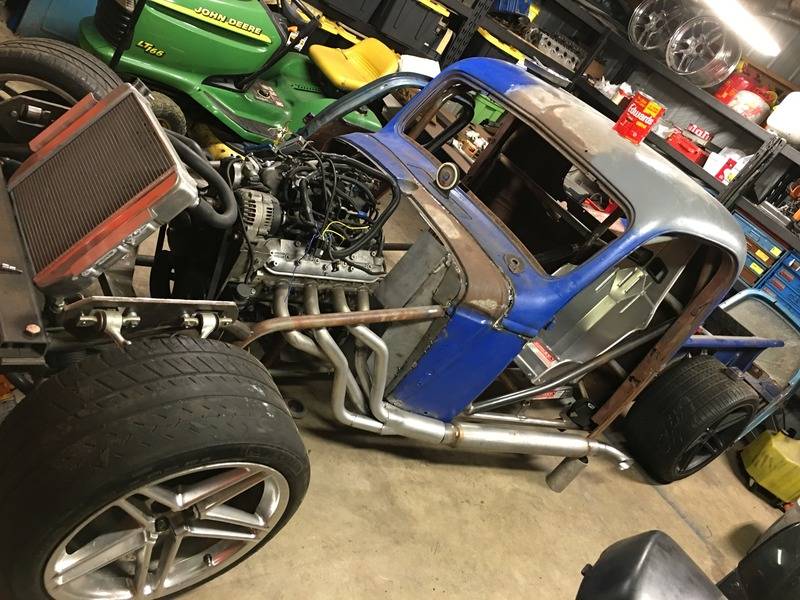

      Running the tube frame through the cab
      Almost there!!! Currently all that's left to do is wiring, fuel lines, exhaust, coilovers and a floor.

      I know!!! I'm tall(6'2) and the hardest part of this build is trying to setup the steering and pedals with out having my knees up to my chest.

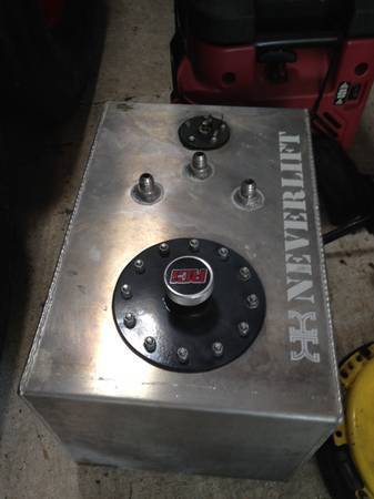

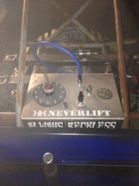

      Thanks everybody for the great feedback. Just a small update: bed is mounted and I'm now running the fuel lines. I will keep everybody updated.
