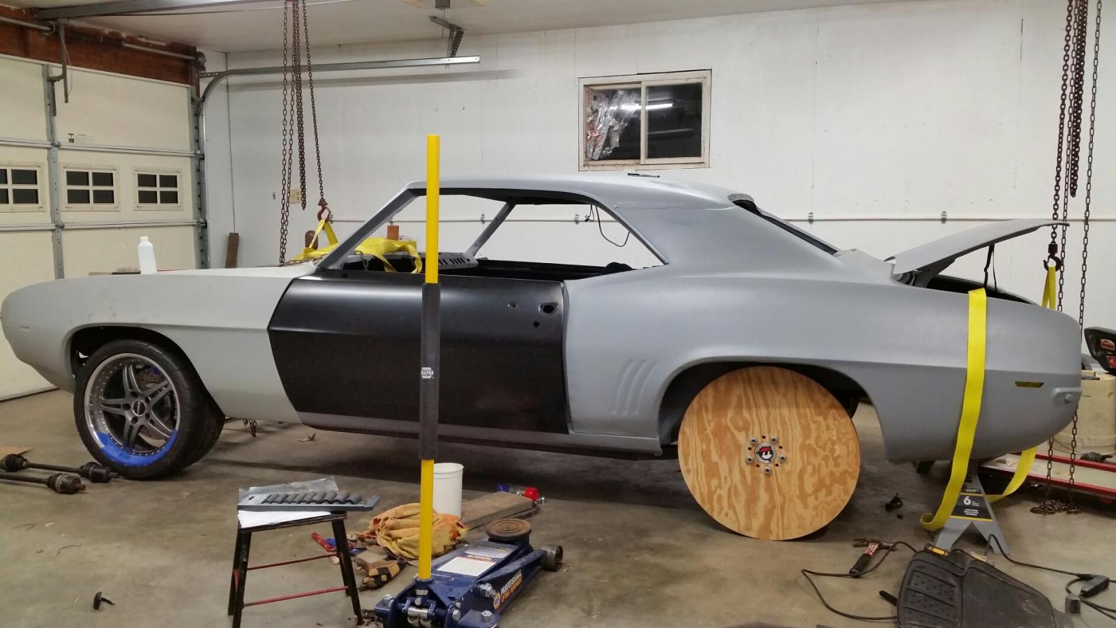

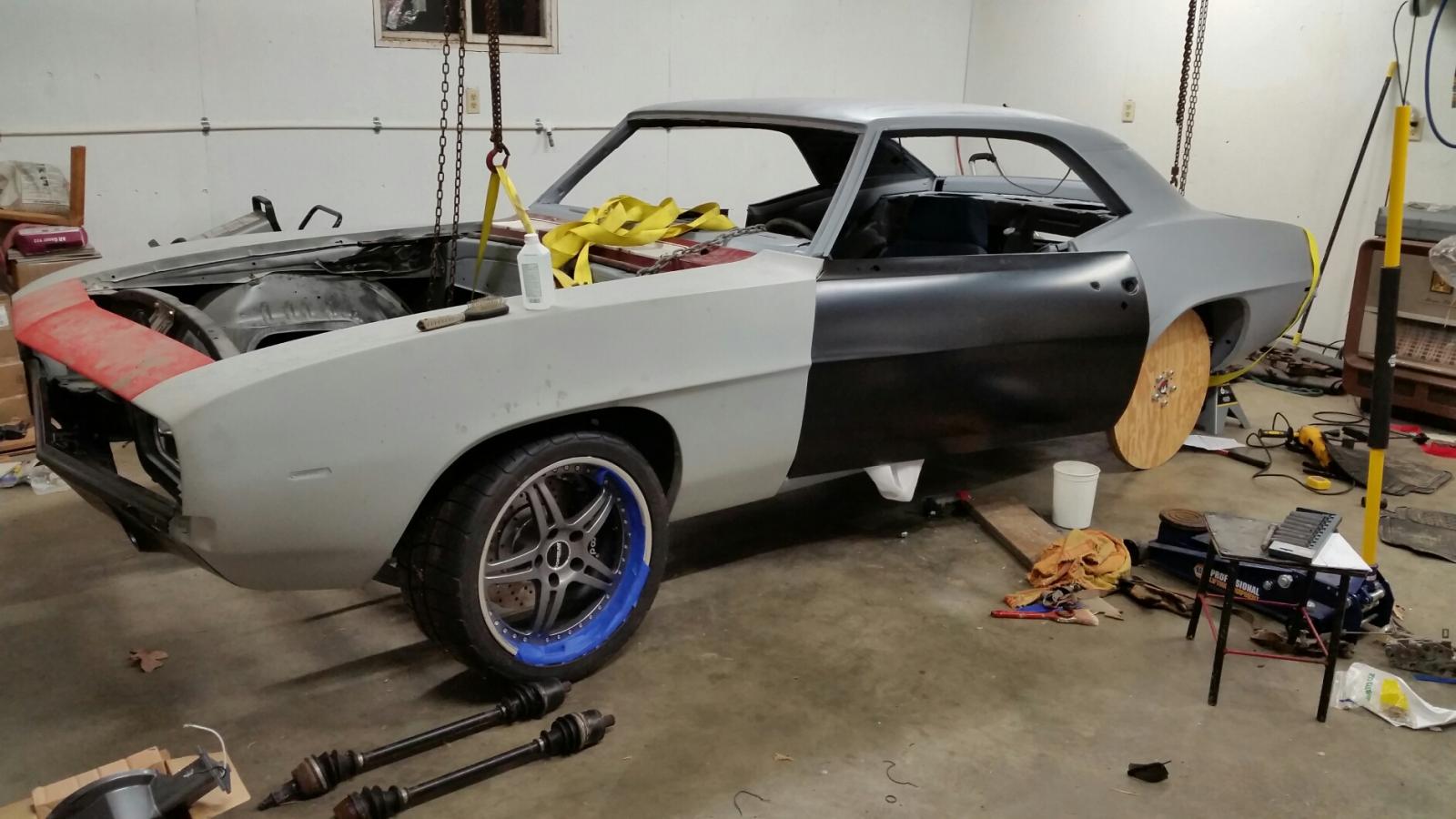

      Ride height question
      I know, another ride height question..
      I couldn't find much for measurements from other people that used this chassis, and didn't measure when the stock subframe was under.
      I have a Schwartz chassis with the ridetech single adjustable coilovers. I can out find what spring rate are on them. With only a bare shell on it, right now I'm at 27" front from floor to bottom of fender lip. Rear is around 26.25". I'm trying to judge what my ride height may get down to when the engine (ls7), trans (t56 magnum), interior, fuel tank etc etc are all in there. I haven't pinned the body to the chassis yet. It will take a decent amount to get it lower than it is currently.
      Any ideas?
      My tires are 265/35/18fr, 335/30/18rr. The plywood is same height as my rears I believe.
      Thank you in advance.

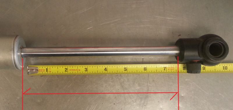

      Your welcome! As for the Schwartz chassis, I don’t know for a fact what stroke shocks it comes with. I think what you have is correct but the only way to be sure is to measure your shocks.
      The way to get stroke is to measure from the top of the dust cap (where the shaft goes into the shock body) to the bottom of the eyelet (do not include the rubber bumper).
      Name:  stroke measure.jpg
      Stroke – Ride Height
      2.9 – 10.5
      3.6 – 11.5
      4.1 – 12.5
      5.2 – 14.5
      6.3 – 16
      6.9 – 17.25
