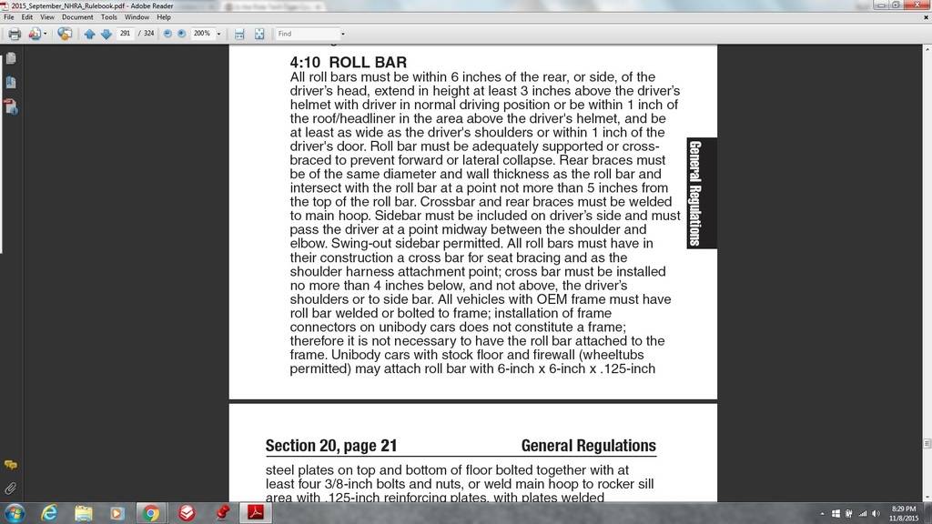

      Hope you can expand these enough to see Donny -
      Anything is possible, but I don't see NHRA changing the rule book for this particular cage. Not all tracks will scrutinize at these et levels, but there is always that possibility. I would guess the other sanctioning bodies might be easier to convince.

      Thanks so much for posting those pages!!
      Couple more questions...so obviously the stainless steel (on the tiger cage) isn't an approved material correct? Asking because if it would work as a material..could you then use it if you weld in the back seat brace bar? It says swing out door bars acceptable..?
      The bar that goes behind the seat MUST be FULLY welded correct? I mean, basically to go to a 5 pt or 6 pt cage...there is no way to have a usable back seat correct?
      Now my next question...do I need the 5 point at 10.99 or 11.49? I'm reading conflicting information..

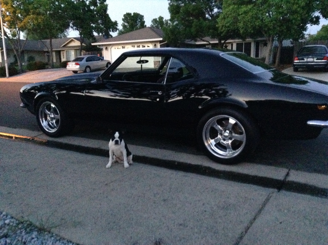

      Donnie - I'd like to see some pictures of your car if you can post them. I'm guessing from what you have said previously it is producing 500hp as a low estimate...betting it too nice a car to be chasing ultimate et's on the drag strip. To do that would take away overall the great driving package you already have in place. I was in the same place with my current project which is a '67 El Camino. Originally had planned putting it on the strip, but the more I thought about it the less appealing it became. The roll bar was a big sticking point for me as well...could not bring myself to punch two bars out the back window into the bed with such a nice vehicle. It is currently under construction as a pro tour/daily driver which I am confident I will enjoy more over the years.

      http://www.camaros.net/forums/showth...61#post3319961 Check out post #10.. NHRA legal to 10.00
      The 500 HP is probably a little low..maybe more like 540ish

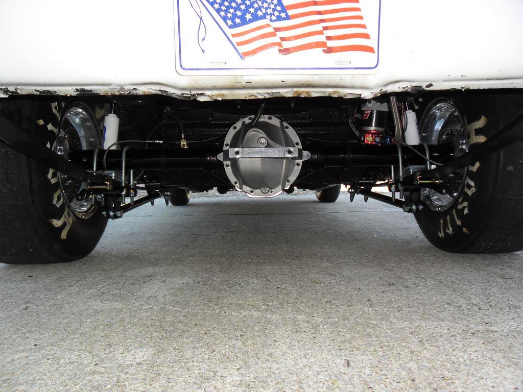

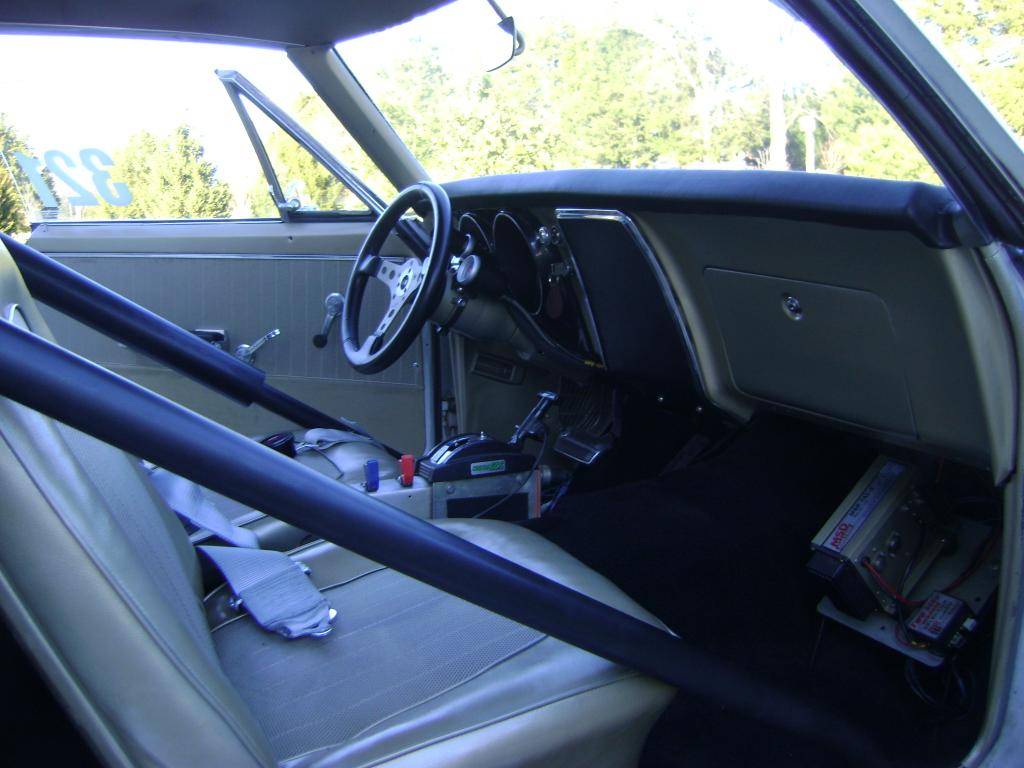

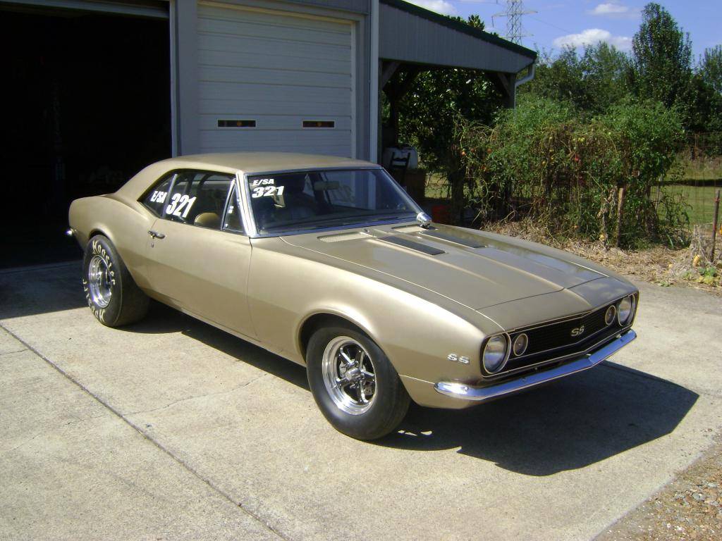

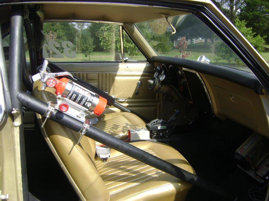

      Gorgeous car Donnie...about what I envisioned. As far as your pal "Fred" goes on that forum, I think both you and he both need to order a NHRA rule book before making any decisions. You have a decision to make regarding the ultimate use of your car...be glad to offer any advice where I have experience.

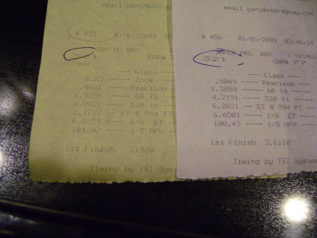

      My '67 does 60' times as low as 1.45 with about 200 less hp than you have...then again it only weighs 3030 pounds with me aboard.

      Nice car man! What size tires you running on the rear? What width wheels and how much backspacing? What rear leafs are those? Is your car gutted interior or fiberglass front end?

      It's all steel with factory interior minus the rear seat. Tires are typical Stock Eliminator fare being 30 x 9 radial Hoosiers. Wheels are 10" wide with 5"BS. Rear suspension uses the CalTrac split-leaf set-up.
      Recently put a little more hp in the bay just for giggles (383) coupled to a powerglide. I've only ran it a couple of times thus far and only on a 1/8-mile track.

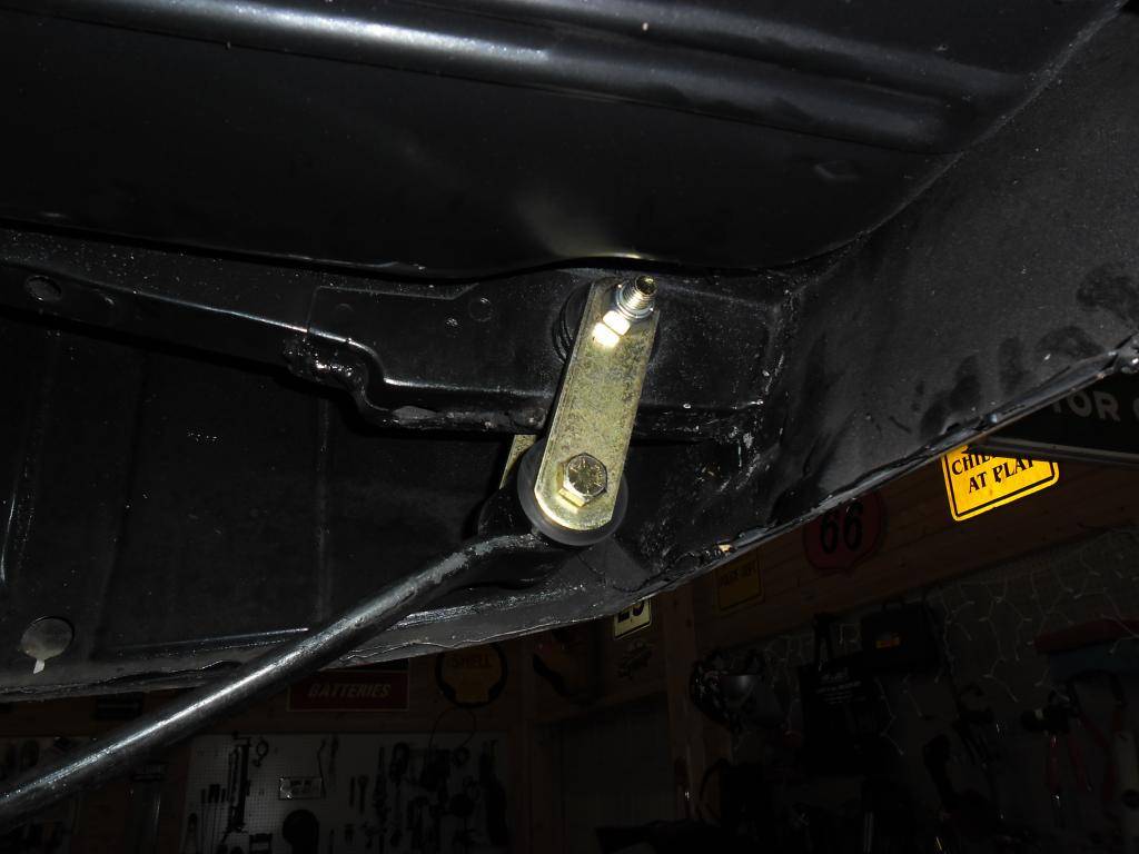

      If you want to hit the strip again then by all means release that front sway bar. The wheels won't net you much...it's all about the convertor and getting the suspension unbound. Are you running the factory shackles out back? If so, chuck them in the trash and buy/make your own side plates. You don't want the shackles/bolts to rotate inside the bushings...the plates should swing freely on the bolts and only tighten them enough to retain, not bind. Bushing material makes no difference.

      Right on! The springs are the hotchkis springs with the shackles they came with. No that you say that I'm going to try and see how tight those bolts are back there...the wheels won't net much but I just figured being unsprung weight...even 20 lbs should make a little difference. It'll be dark by the time I get off work tonight but will take a photo tomorrow of my shackles and see what you think.

      You should be able to muster at least a 1.60 60' with minimal changes if the suspension is working correctly. Have someone video or watch the car at the start line and observe if the rear fender is separating from the tire as you come up on the convertor and at launch...if it is then it is working properly. Actually, some old worn out shocks on the rear will work nearly as well as any. Cheap Lakewood 90/10's up front work well enough for most cars. 3 degree down pinion is good enough.
