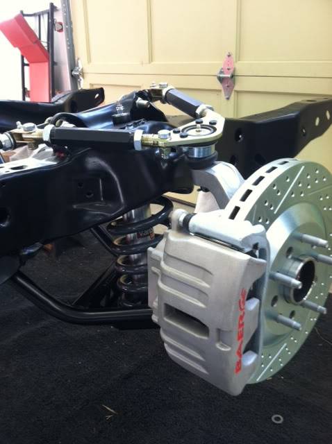

      So on my 72 Elk, I roughed out the alignment when I built the suspension. Yesterday I was finalizing the alignment specs, I only needed 1.5 deg of caster. Had to go back and forth a couple times, then two aluminum adjusters froze up. Had to remove the ca and use a three foot bar just to get the adjuster sleeve off, obviously the threads are trashed.
      Anyone run run into this before, should I switch to the steel sleeves and should I have been using anti seize in the aluminum ones? They would be out of warranty since I've had them about two years but they were in the box most of that time.
      Not looking to change c/a's btw.
