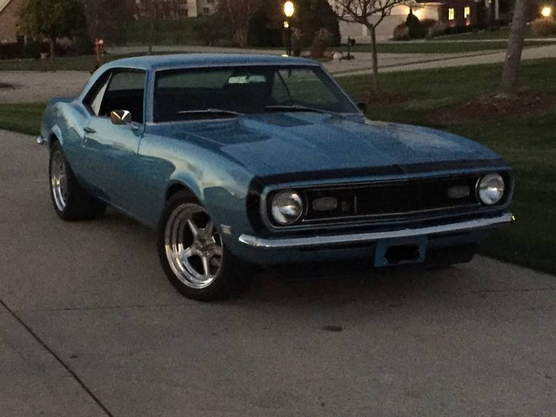

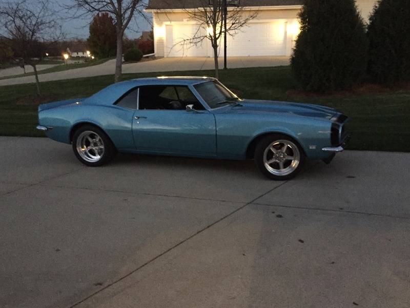

      And a car pic for good measure since I'm proud of my pops for his effort in doing this swap in his garage. Pardon the cheap phone pic he sent me

      Nice car by the way!!
