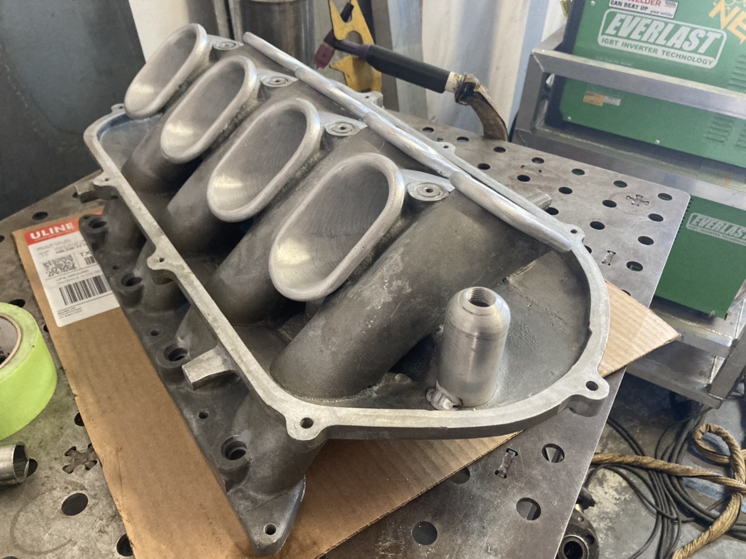

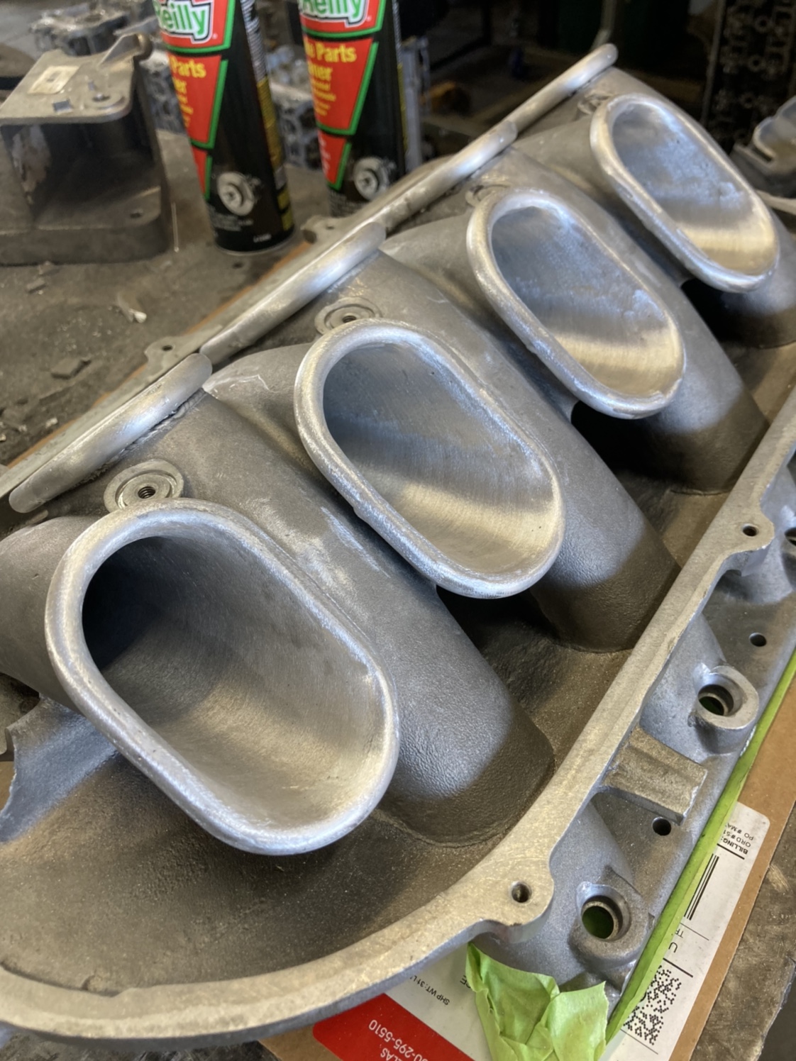

      Matt Hayes really porting and opening the intake up. Also removing factory o-ring gaskets. He does good work!!

      Getting closer to matching the Fox Lake CNC heads. This is the last piece of the puzzle to the 397” all aluminum blower motor that will replace the 2000 Cobra R motor. I will be selling the 237 mile 2000 Cobra R motor once this motor is finished.

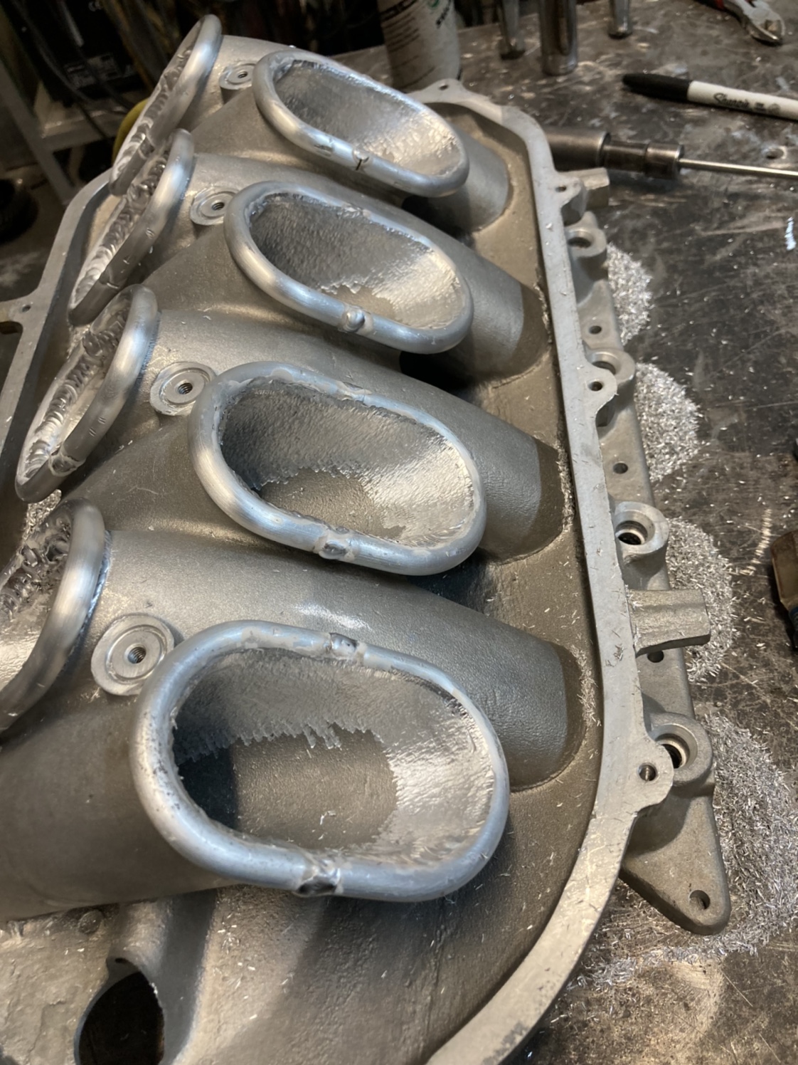

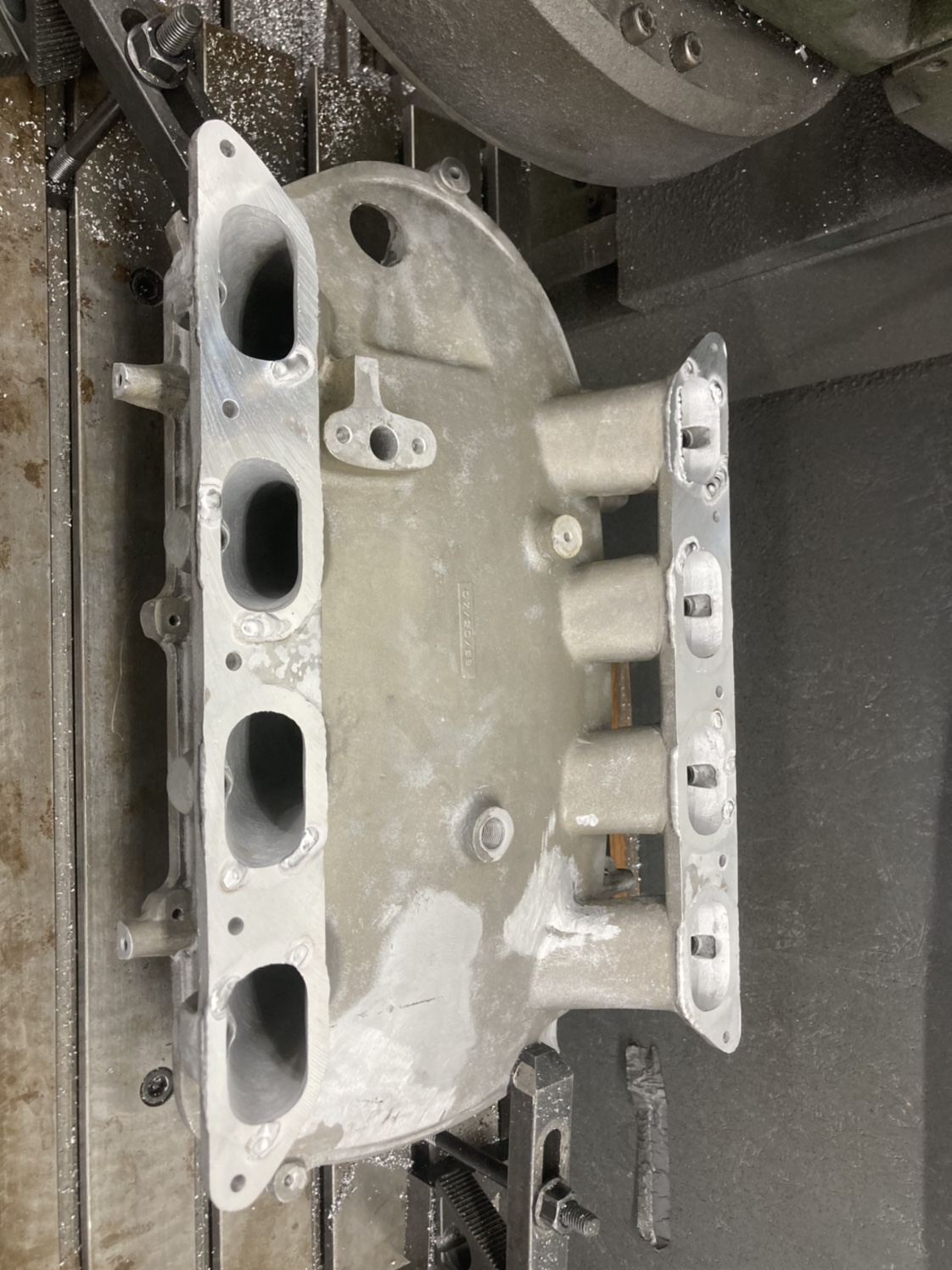

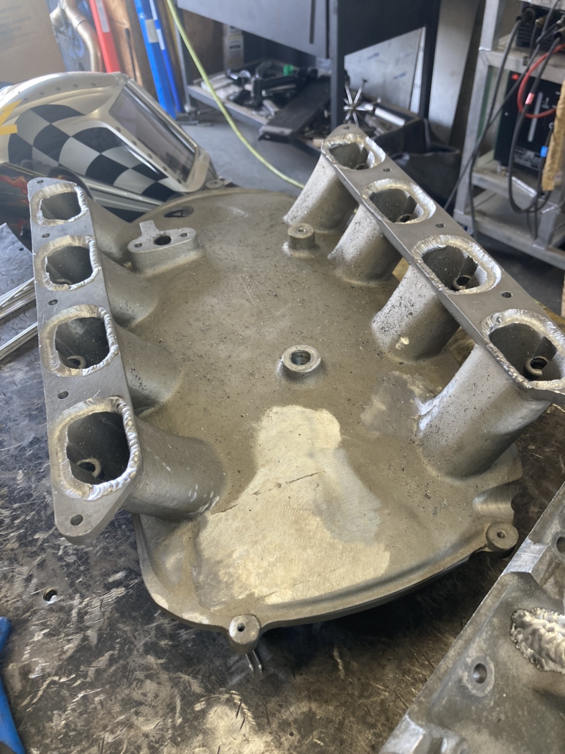

      Runners shortening.

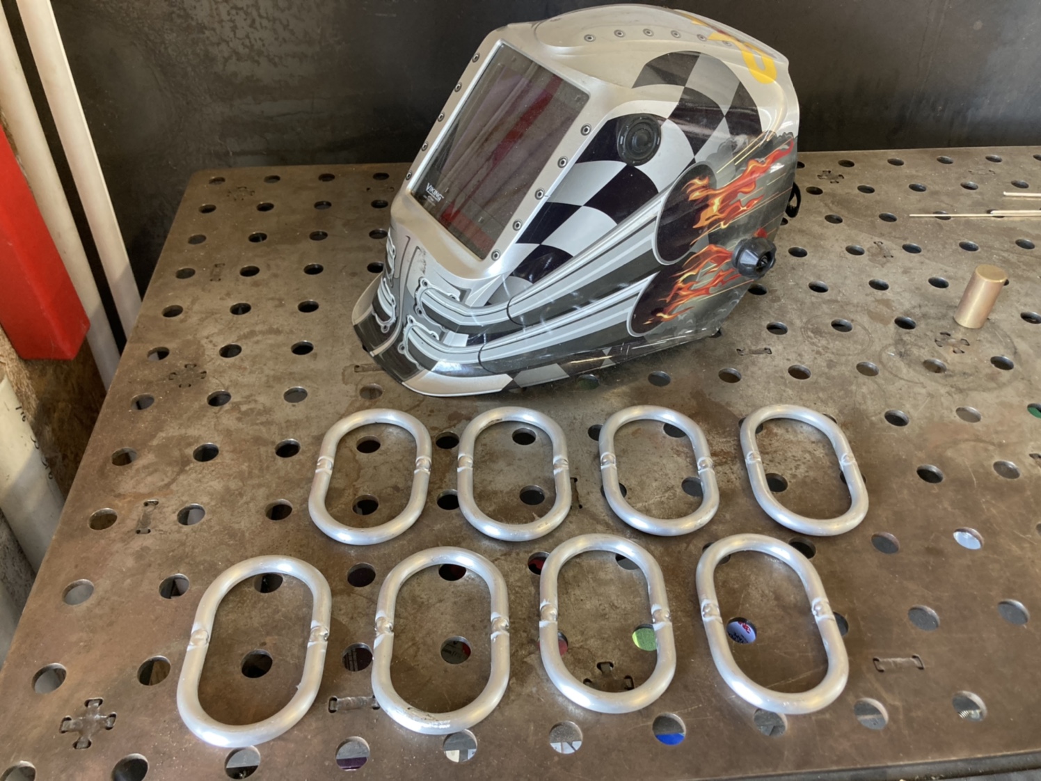

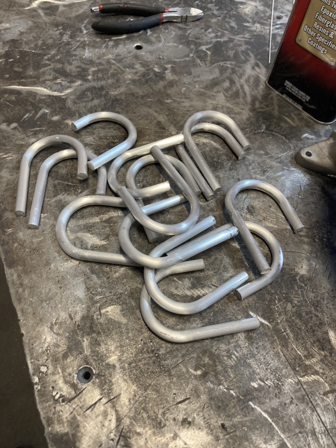

      Bell mouths being built

      Bell mouths installed. Next comes blending, porting and polishing.

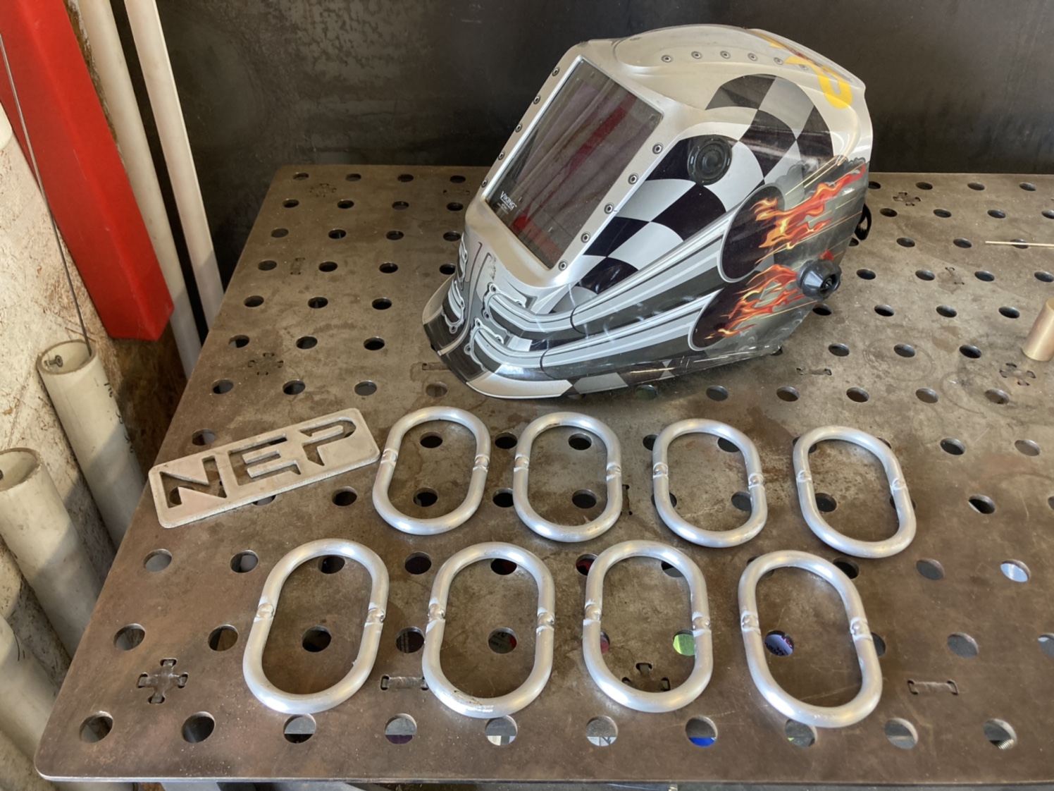

      All done by hand.

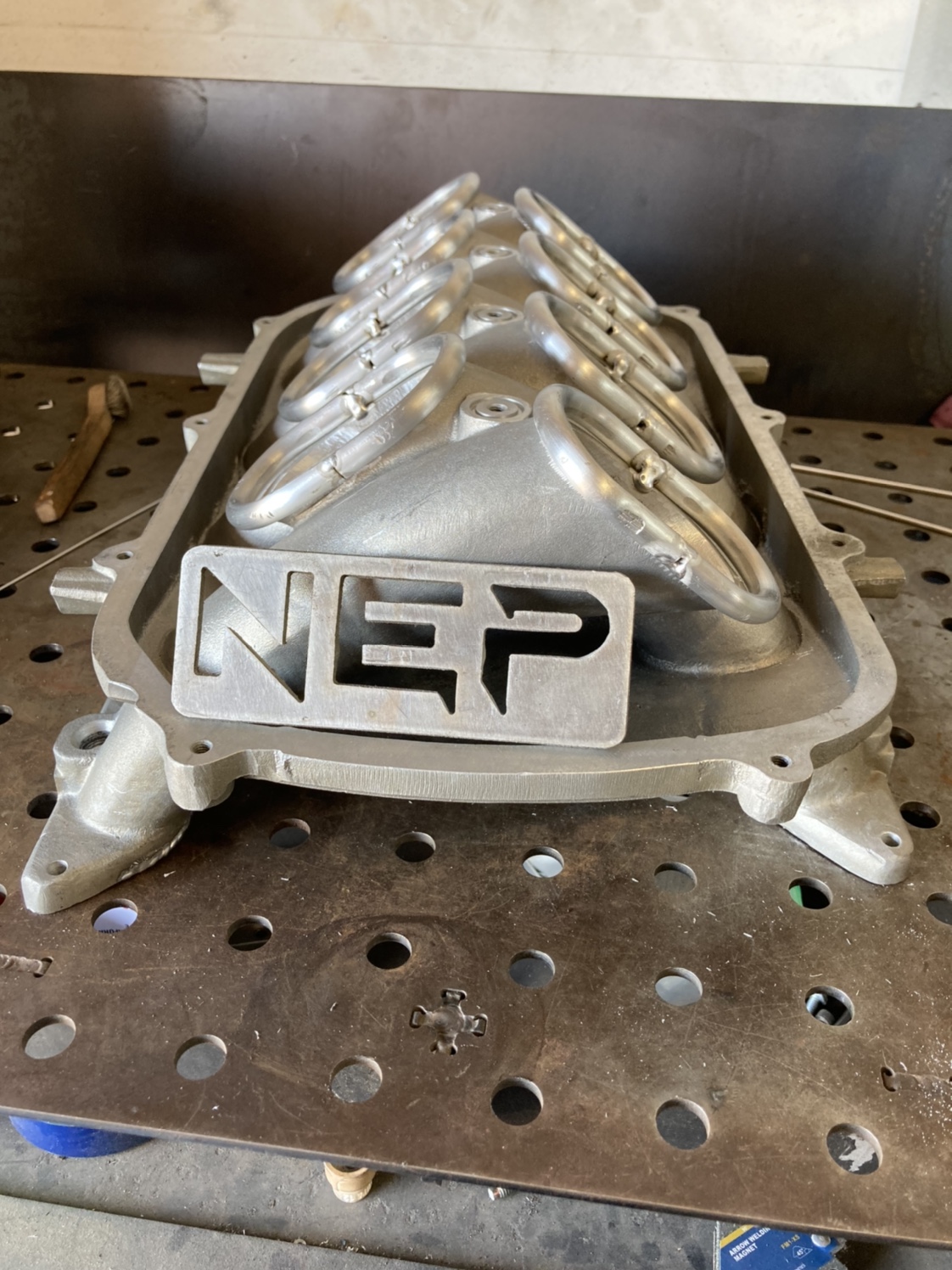

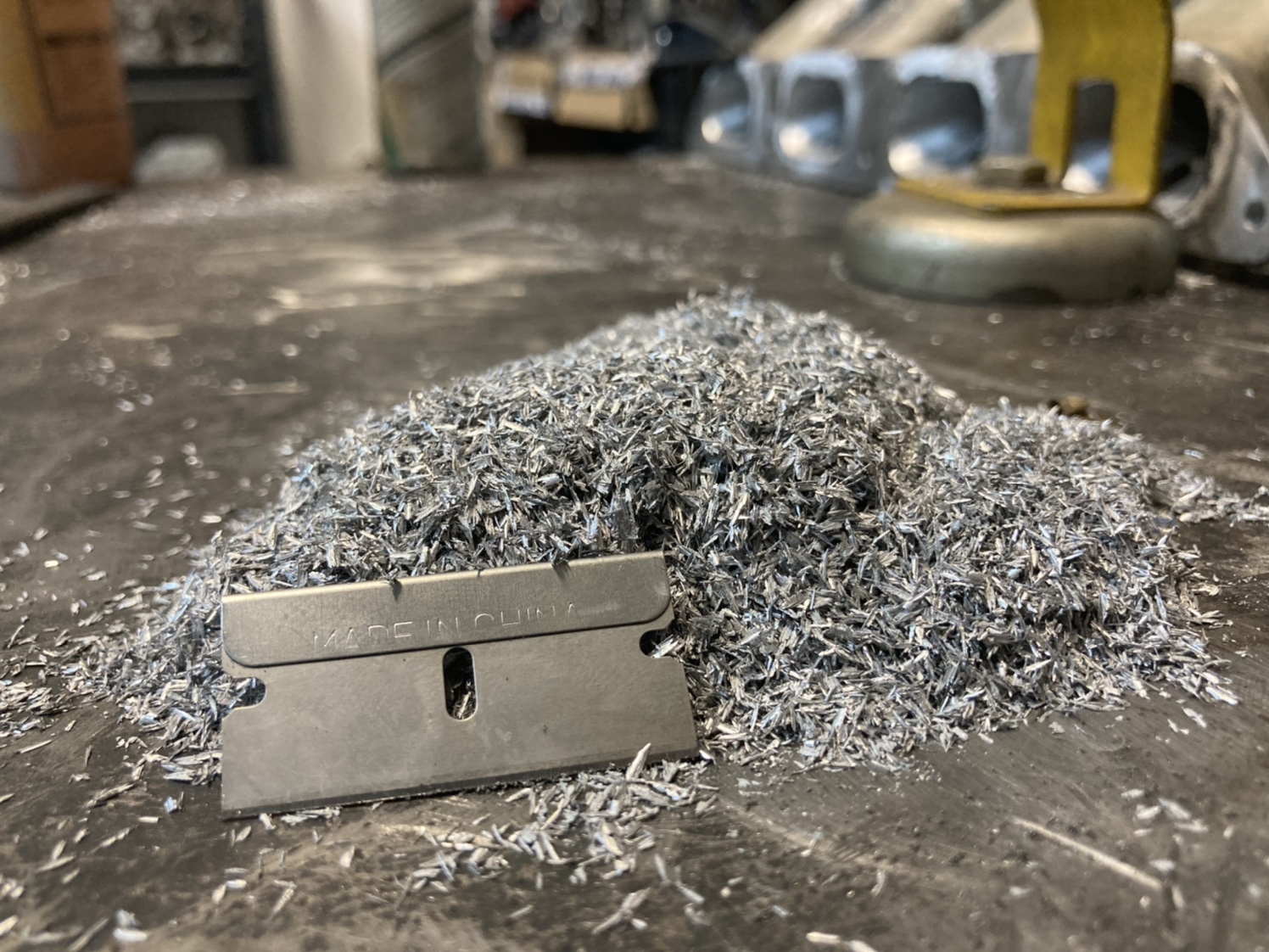

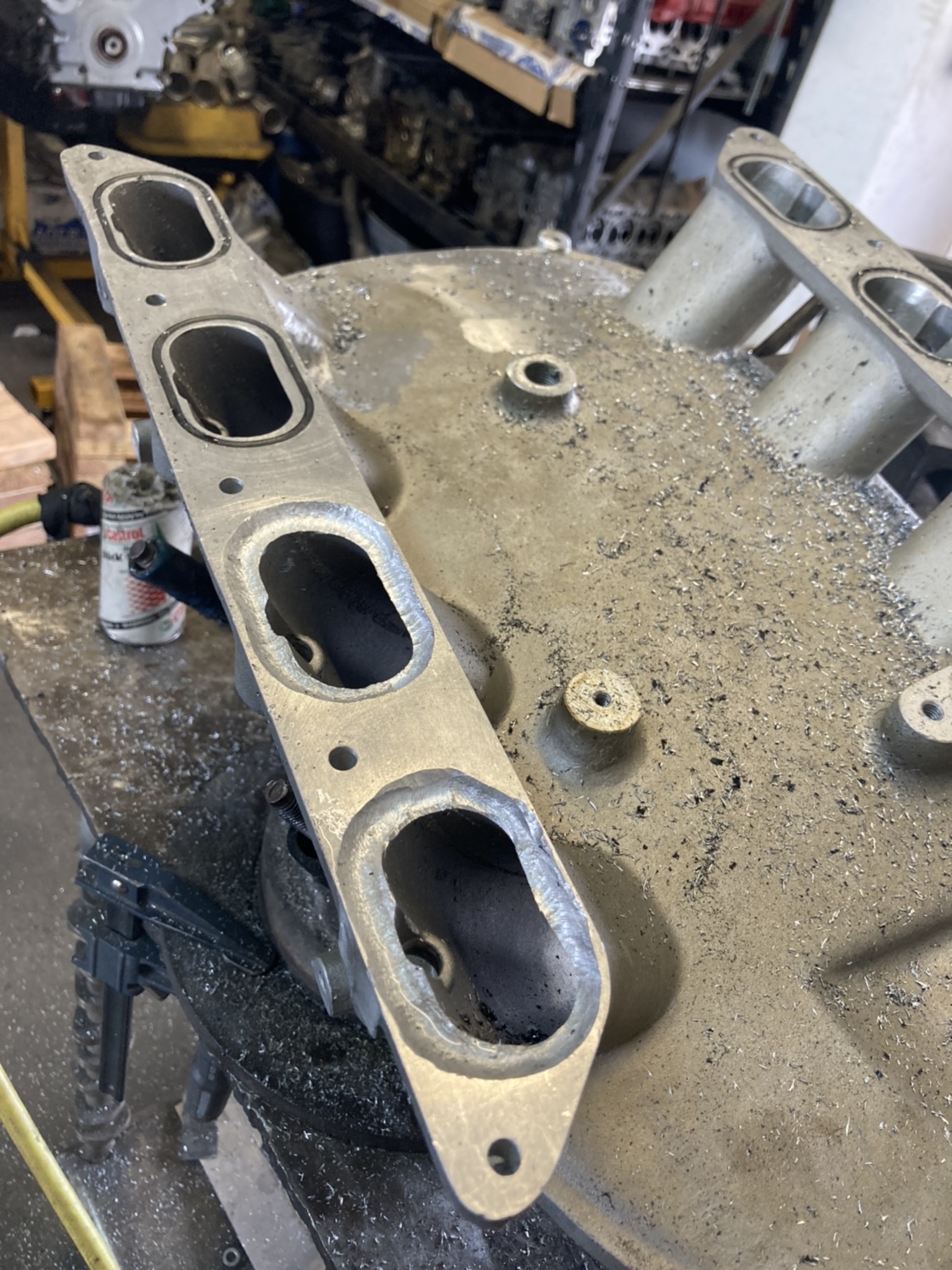

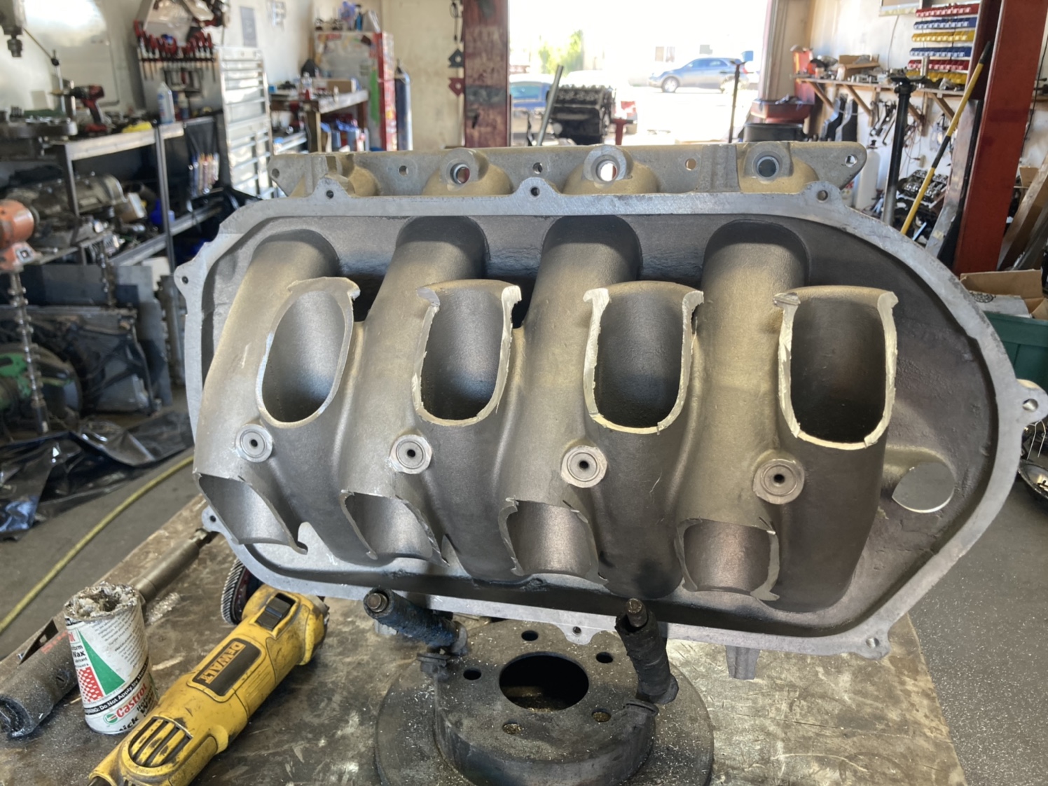

      Matt got through the first half of the runners. The photo is shavings from one half of one port. He will now get into the second half of the runners as they taper into the cylinder heads.
      He has already removed the o ring gasket sea areas and welded them in. He then port matched them to the CNC heads via a GT500 gasket. Next he will continue hog porting the intake then have it machined level.
      With 397” of custom billet stroker crank, custom rods and pistons. 13:1 compression and an intake manifold that flows way more than 330cfm. Factory GT Supercar followers and lifters. 510/500 lift cams 260* at .050. Taking a poll:

      Fuel injector ports opening back up. Matt Hayes Never Enough Performance for your porting and polishing needs. Great guy. Got skills. Great business.

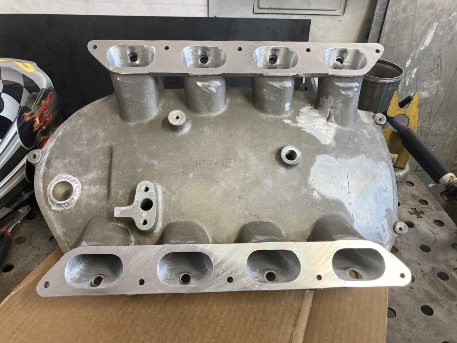

      Intake is done and on its way.
