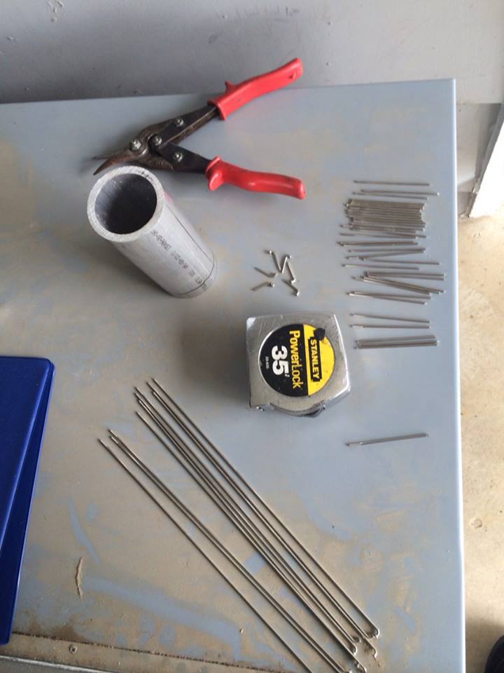

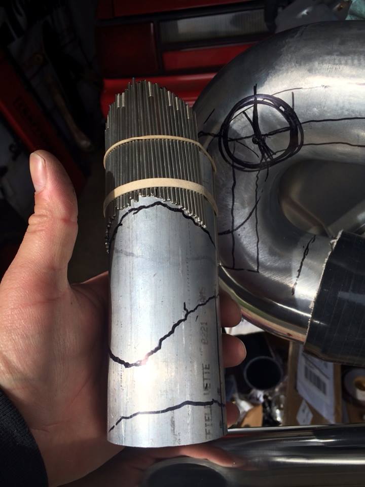

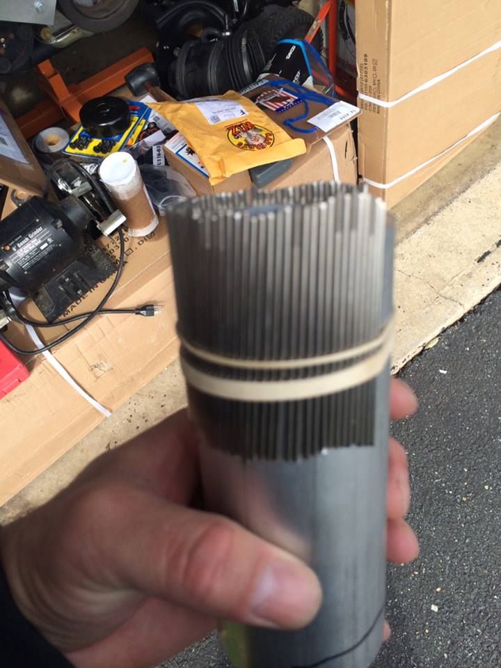

      I had to make a contour guage since I could not find one for sale. Made it out of 2.0 guage 296 mm bicycle spokes.
      Making progress on the intake tubing. Since I do not own a tig welder, I have to outsource the welding.
      Blow off valve, blow off valve to blower intake, 4 vacuum fittings and 2 methanol injector bungs will all be welded up. Once this is all done and test fitted, I can turn my attention to the billet timing chain gear swap and YSI oil pan return bung.
      Getting the replacement fenders bolted up, gas tank/ lines, T56 and 5.0 shortblock removed is next. Getting the grunt work done. Making room for the new parts. Posting pics as it goes.

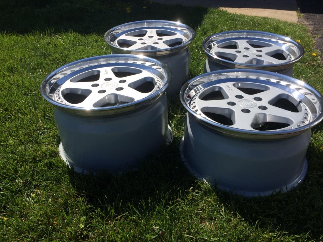

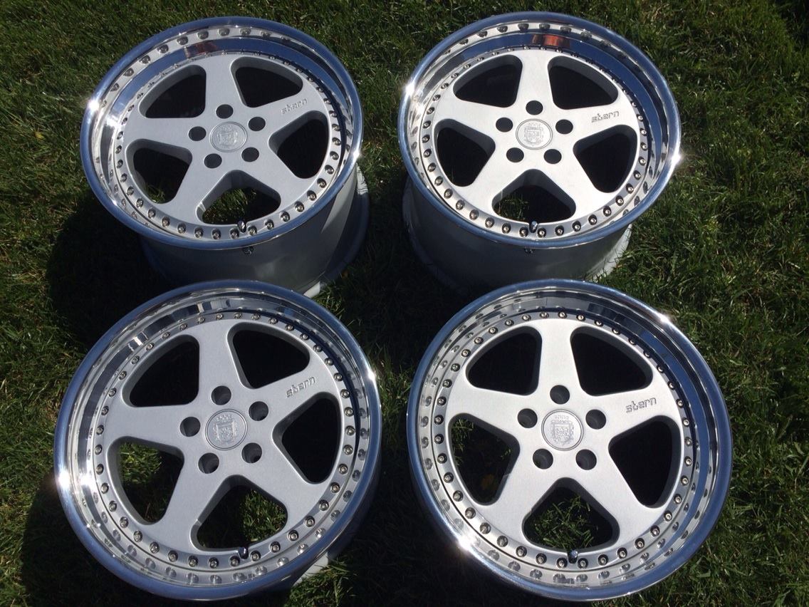

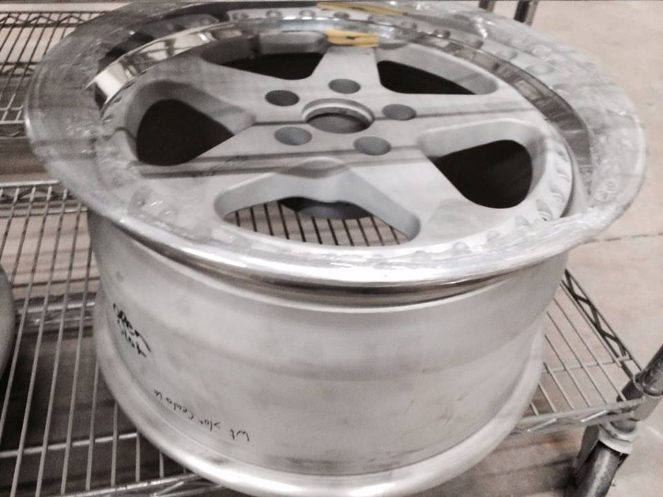

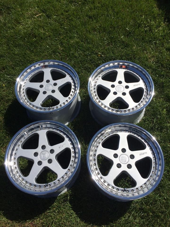

      Just picked up my wheels from the wheel shop. Cleaned up hardware, painted centers. New 18" lips and barrels.
      New sizes are 18 x 10.5" front and 18 x 12" rear. Still have to buy tires.

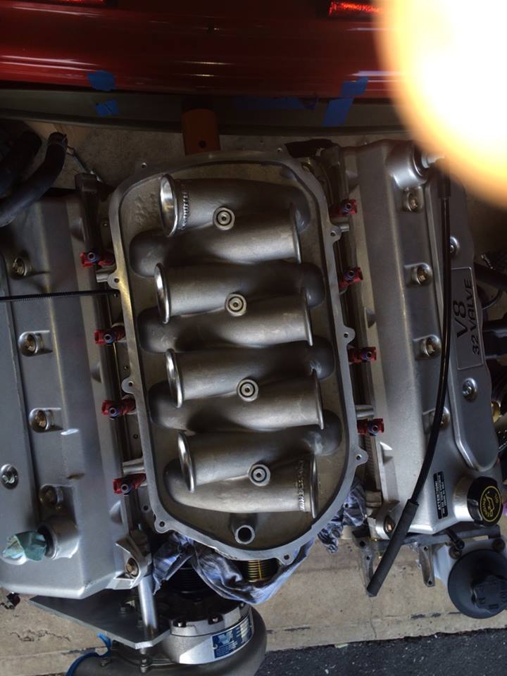

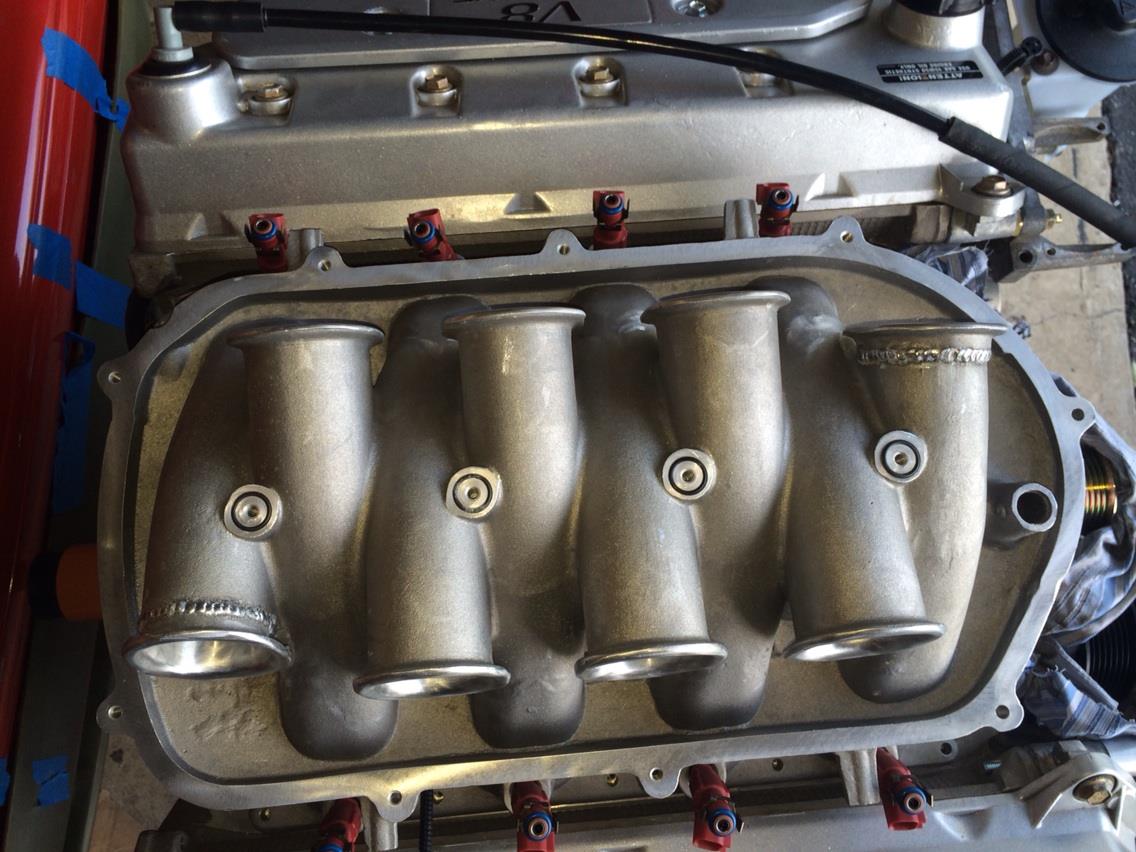

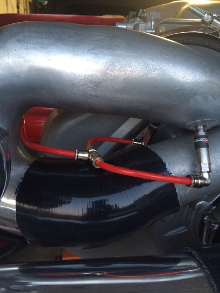

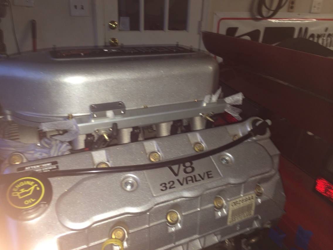

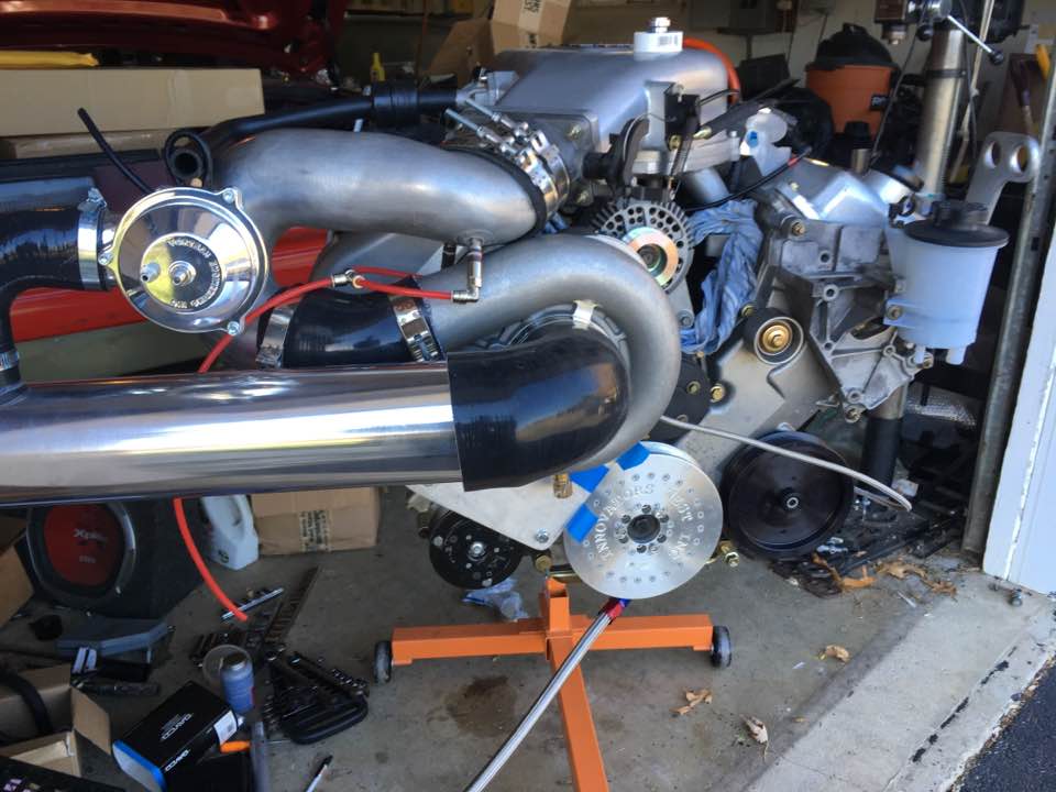

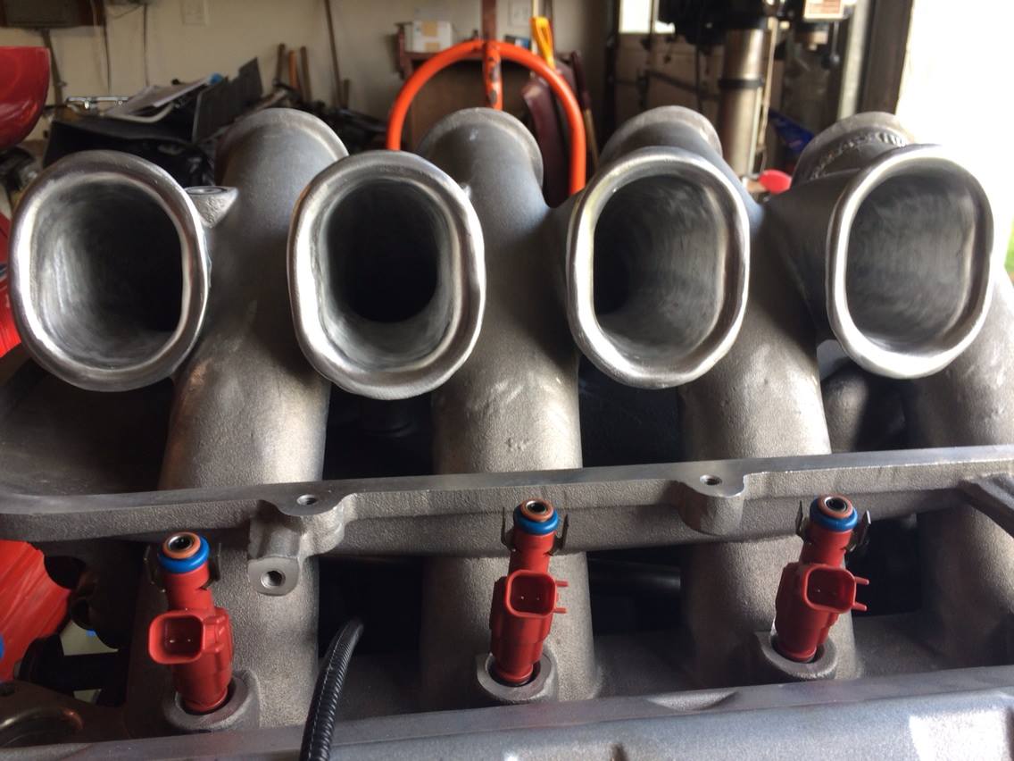

      Assembled the top end and blower with tubing to it's final state, dual snow methanol injectors, and missing a t-bolt blower clamp. Here is the end result. New rails too with 60# injectors. Should be able to support 800fwhp at least. Just have to final torque everything down. Blower drain tube in a new oil pan is next. Then I can final assemble the blower oil supply and return line.

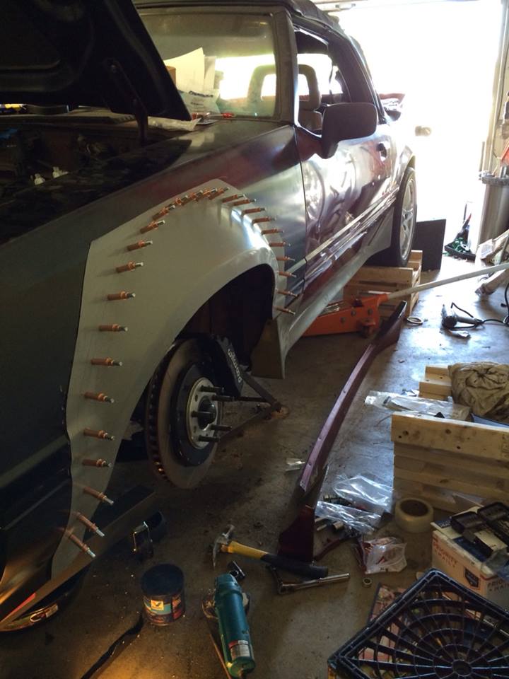

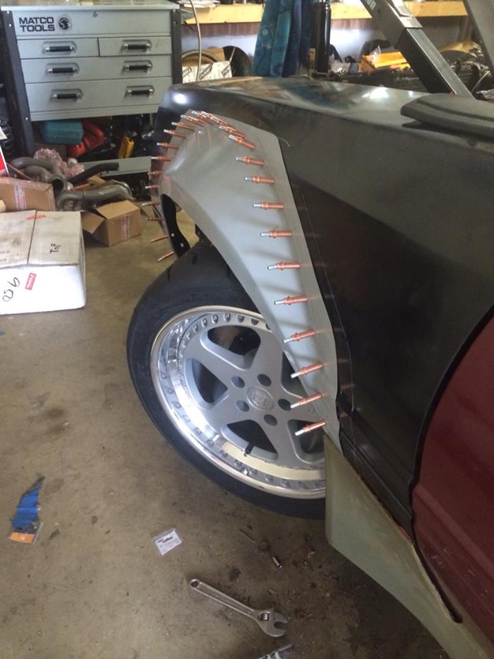

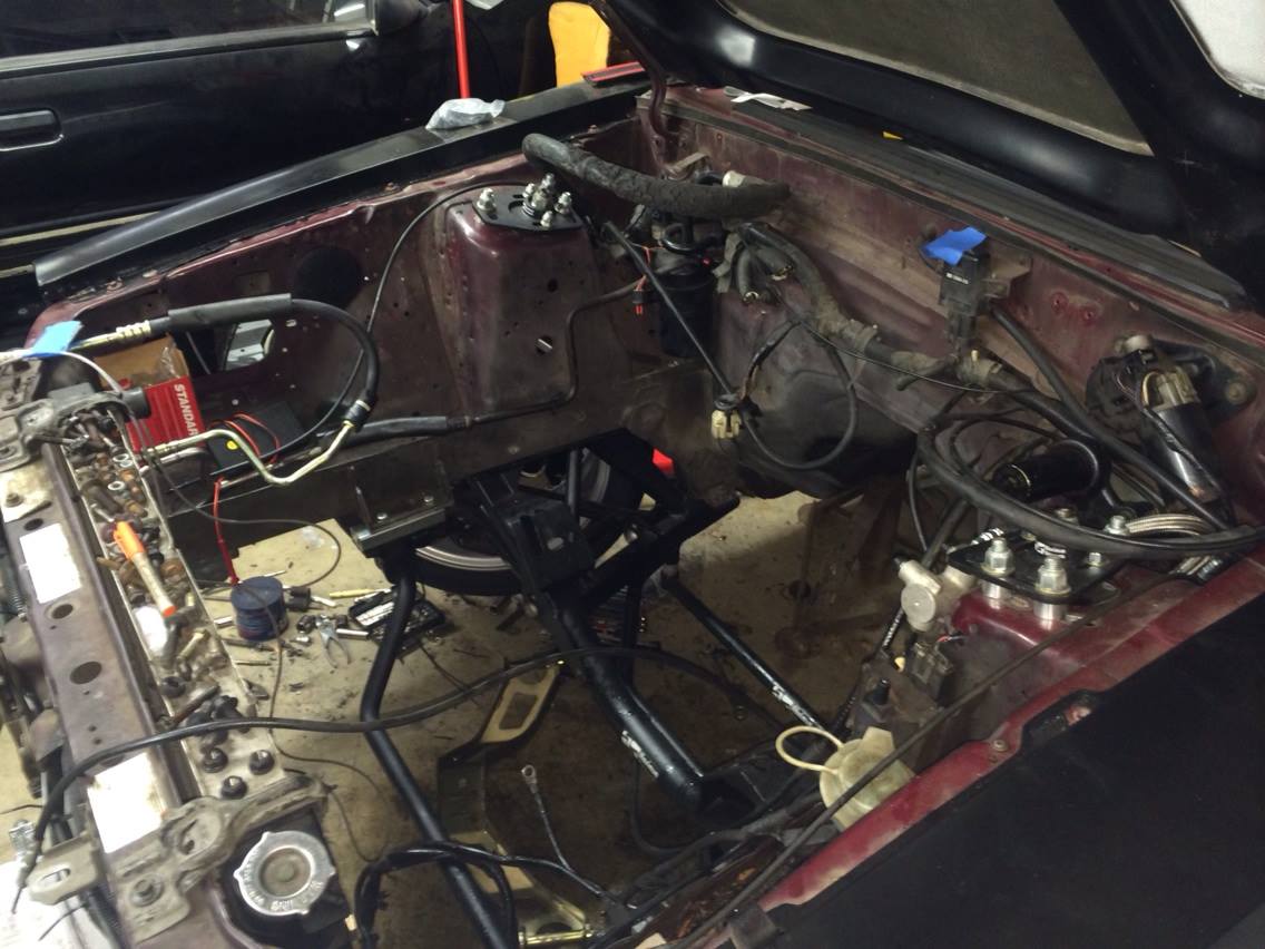

      Front flares roughed in, fenders cut and adjusted, ran out of cleco fasteners when I got to the passenger side. Saleen Side skirts, rear valence installed.
      All ABS lines and Saleen radar detector lines ran toward the ABS unit. Designed, (in my head) brackets to weld the ABS unit to the frame rails.
      Front Bilsteins adjusted. Front K member ready to drop, same as stock engine and T56. Kenny Brown front brake ducts look like the will require a 1/4" worth of material turned down on the lower strut bolt and MM front bolt in bumpsteer kit. They fit in the stock length but rubbed the intake tube on the cooling plates. Doing everything in two's for my drag car. Such as brake line flanges for front Wilwood brake lines as well as spindles for MM Bumpsteer kit.
      Removing the AC lines and accumulator as well as engine bay cleaning next. Looking like I will need to either cut and solder/heat shrink a few old cracked lines or locate a new harness. This might push me to rewire the car again from under the hood hiding, to installing everything inside the car for a better cleaner look. Going to see what the factory inner wheel plastic will look like now and how much to trim/add onto.
      Not using the factory ECU with the 00R engine due to standalone will make it easier to rewire things again. I might have to use a few wires for sensors and things which will make it a little easier. It is all falling into place now. Getting closer to resolving all the small stuff.

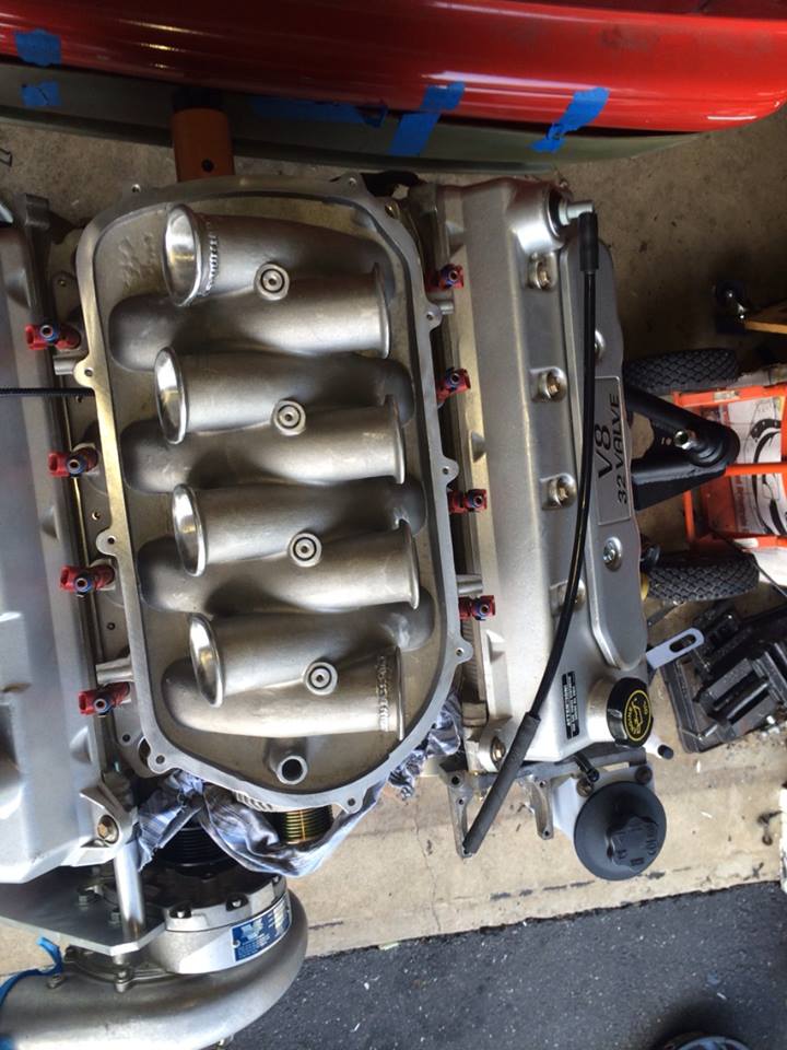

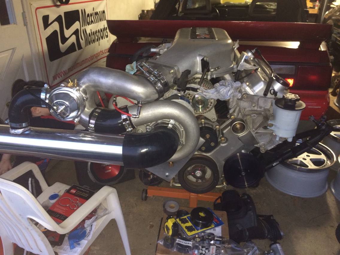

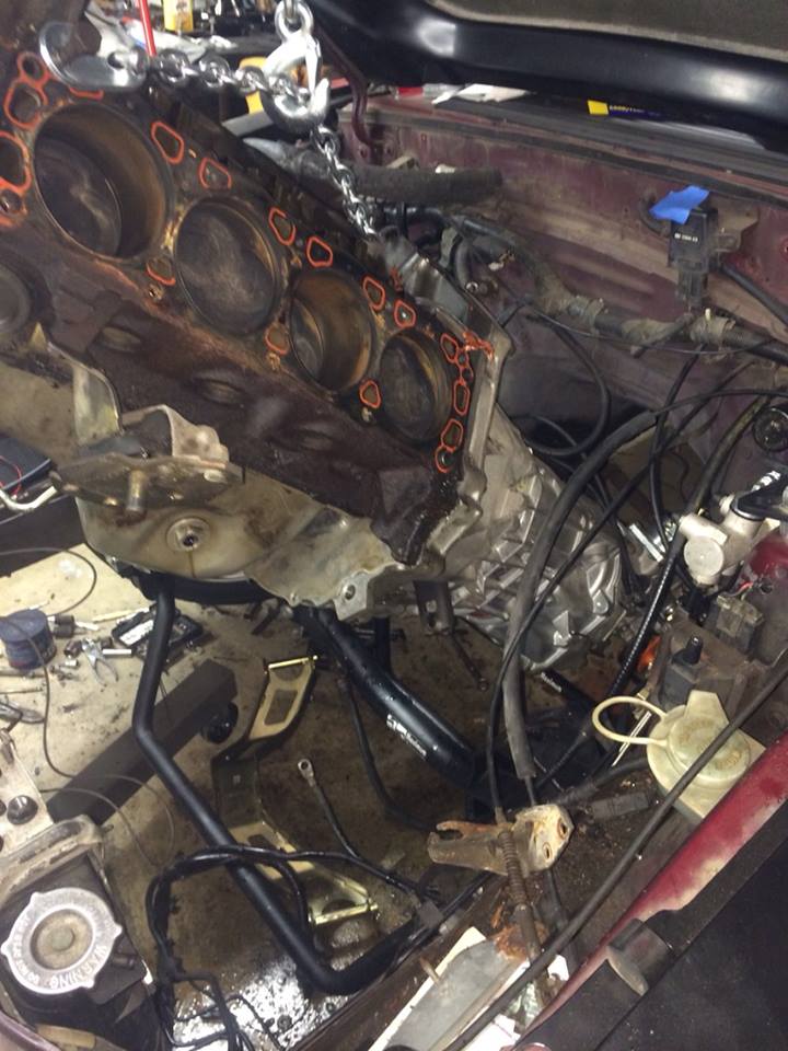

      So been a while since I updated this thread. A few things have happened since then. For one, I found RCI Headers in Rancho Cucamonga, who fixed a set of long tubes for my drag car. He is going to build two sets of long tubes for the 00R motor as well as the 2014 GT500/00R motor. I have since completed a bunch of little things and started on the path to drop the motor in the car. Here are some quick pics:

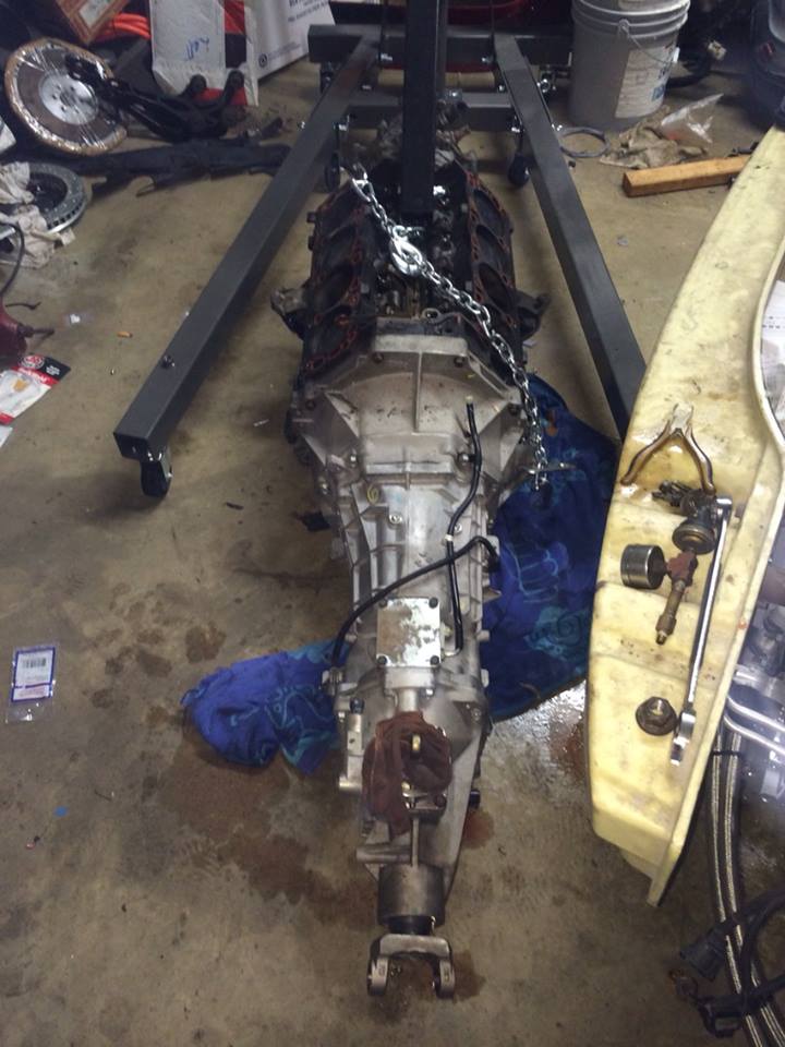

      Managed to pull the T56 and 5.0 shortblock out in one shot.

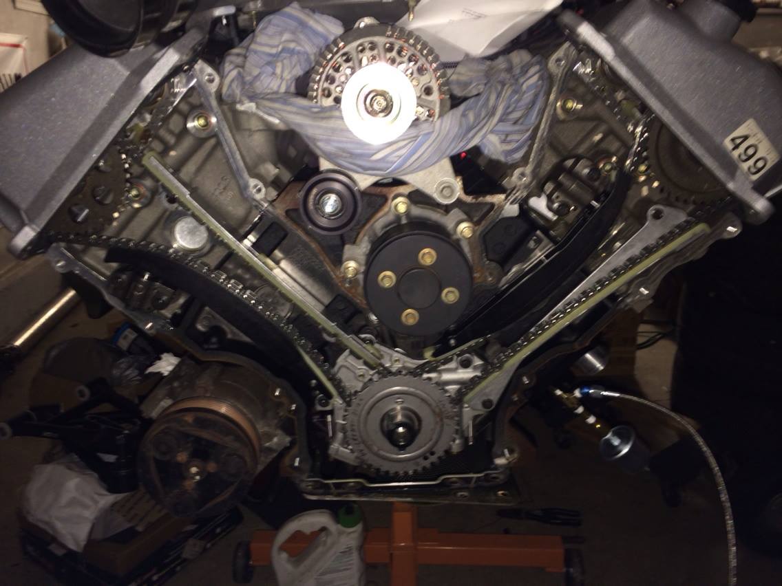

      Deconstructing the 00R factory seals. So the need to replace the DOHC crank chain gear from factory powdered steel to billet MMR was apparent with the YSI. Had an issue with the Left cam sprocket, and learning how to compress the tensioners, but managed to get it all done. I am not sure, but I believe that the number on the Right cylinder head is from the assembler or 00R car number. Took some pics after I broke the factory 237 mile seals. New NGK TR-6 plugs gapped at 0.28 are going in as well.

      2014 GT500 TVS, 2010 Super Cobra Jet Prototype/Testing lower, SCJ brackets. Started messing around with the other motor. 00R Prototype heads, 00R rods, Navi crank, 0.20 piston build. Building this for another car build down the road. Had to use an 07-08 PS pump, luckily a retired machinist friend made the supply line bracket, not pictured. Still needs a little effort to complete the front timing cover.

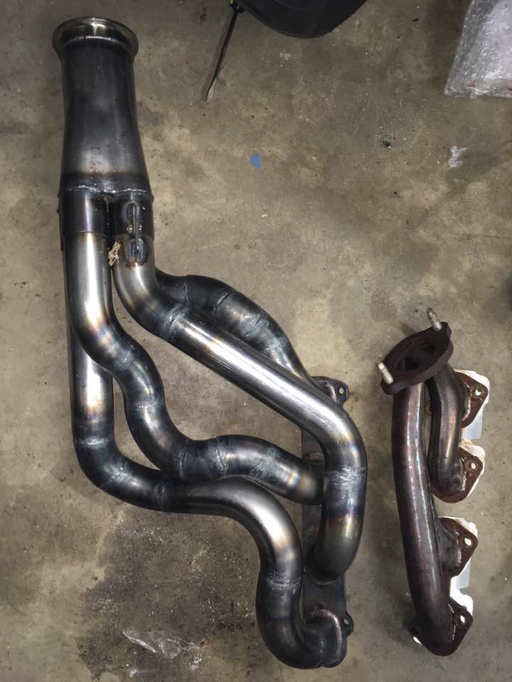

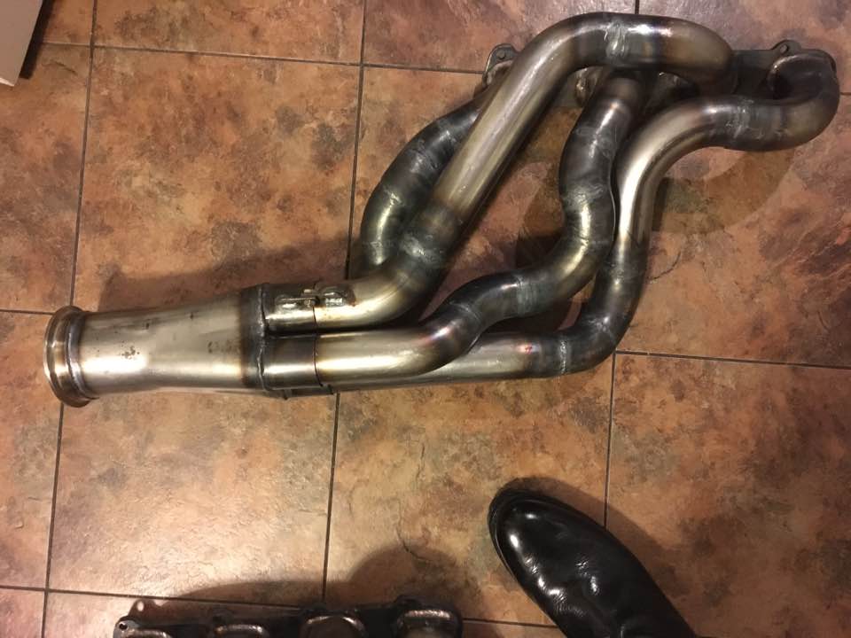

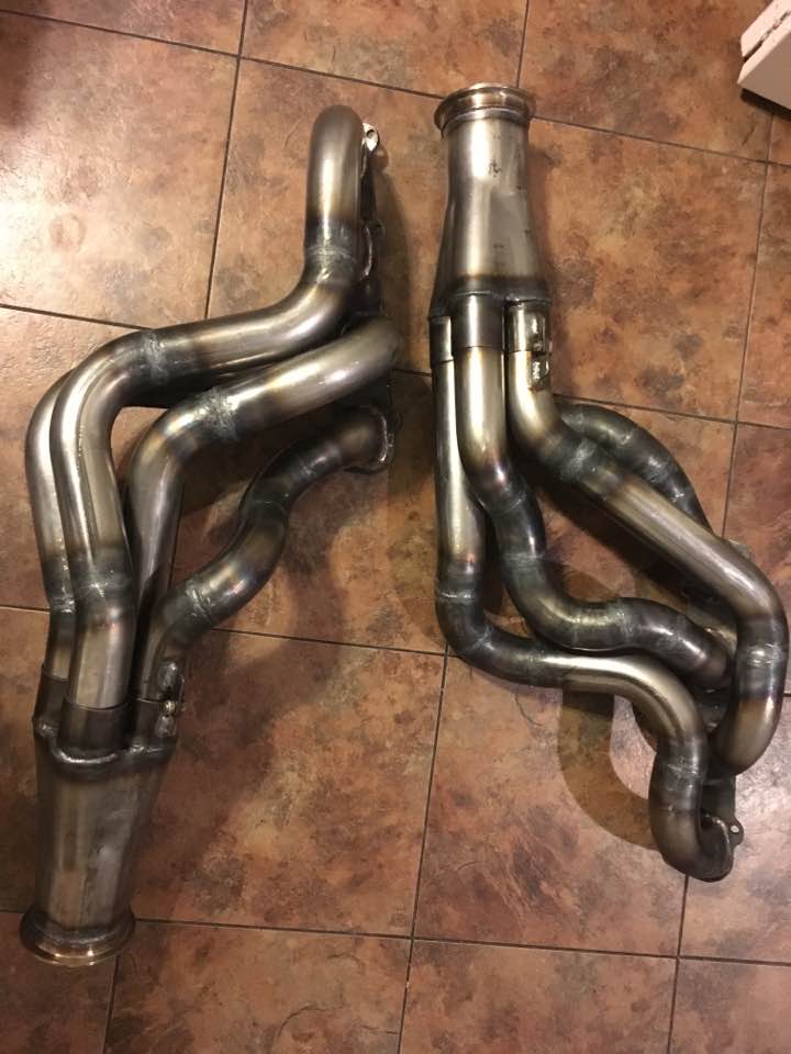

      Craig at RCI headers builds headers, at great prices. I sent him the MM K member with the 00R mounts to build out two sets of headers for both motors.

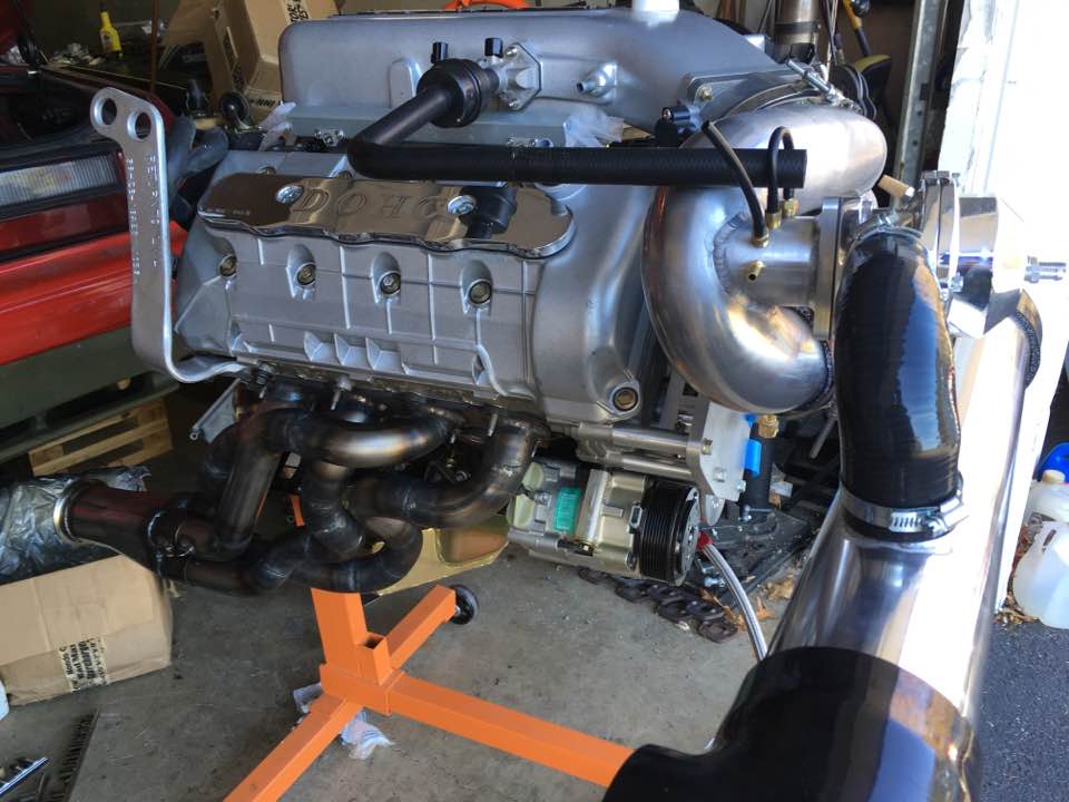

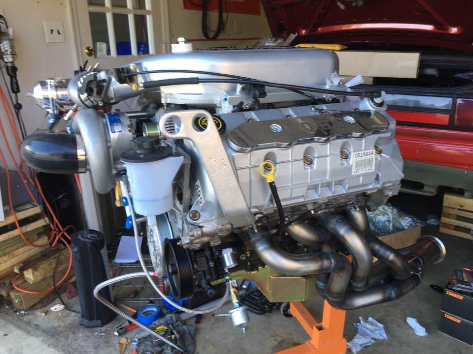

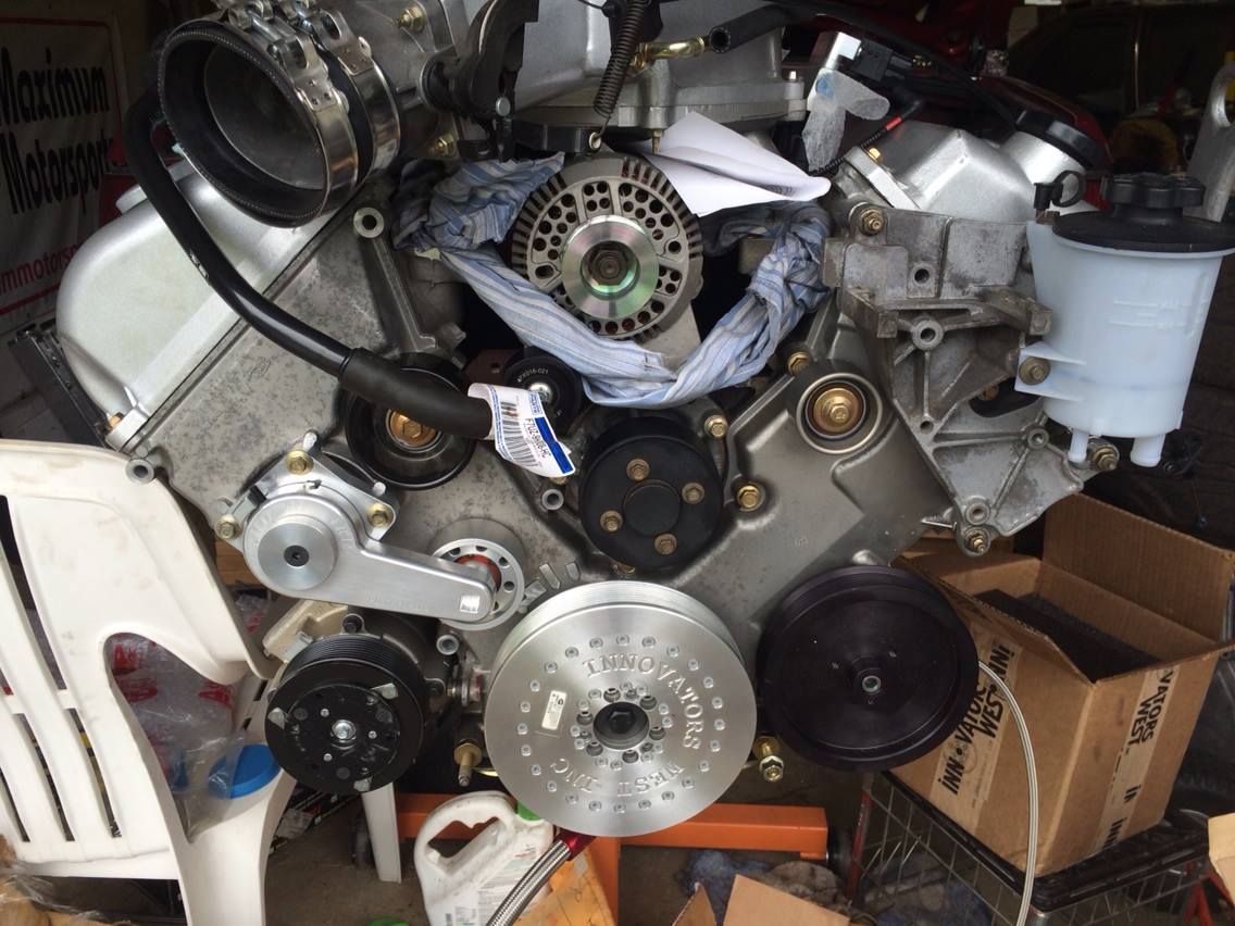

      00R motor with Thump RRR tensioner, 8 rib AC compressor, and the custom 8 rib water pump pulley, 00R size PS pulley and 18% overdrive Innovators West Balancer. Found that the front main seal had leaked a little so replaced it as well. Need to torque the balancer down. Been contemplating polishing it all up first.

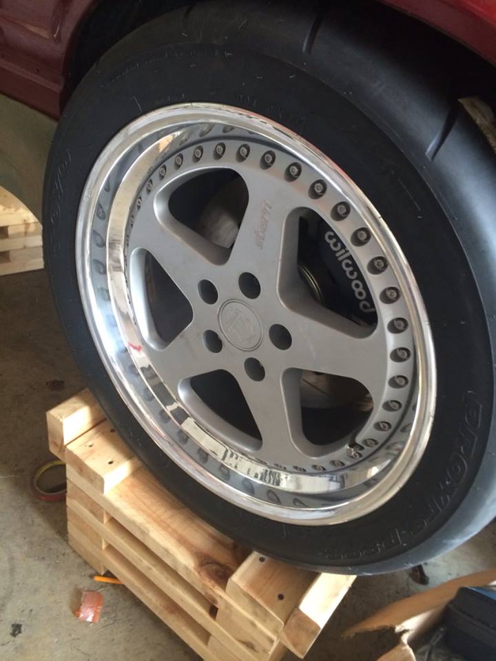

      Sterns are now installed, 10.5 front and 12" rears, 18". 275 R888 fronts and 305 R888 rears.

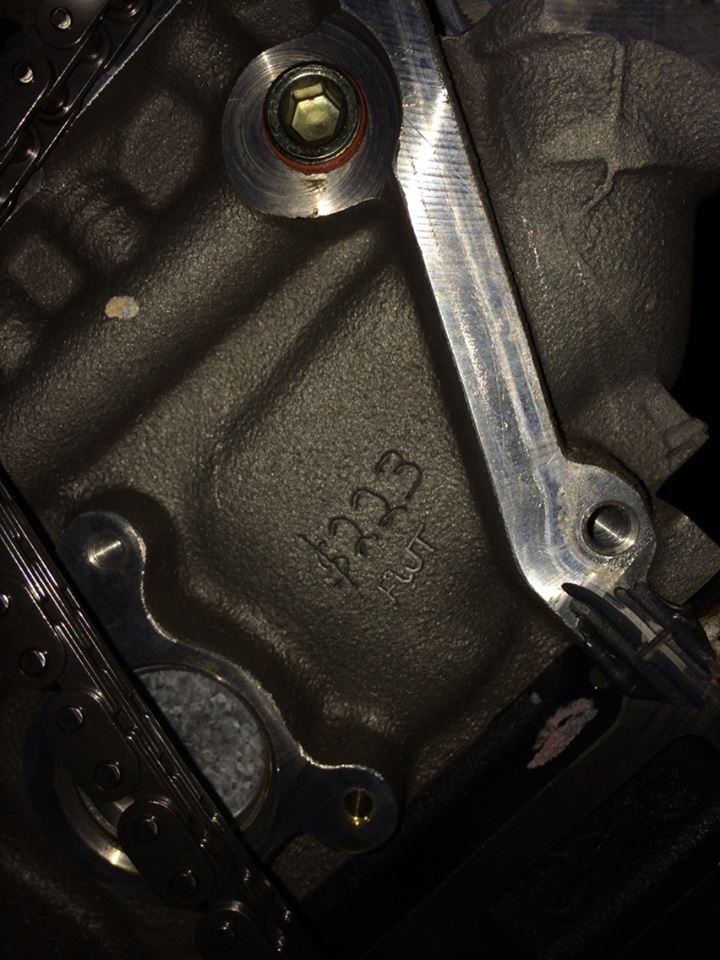

      I did not feel that the first blower bracket would support the YSI so Dick VanDusen fabricated a 1/2" version. Might polish it all up before reinstalling. Debating it as the timing cover polished would be nice too.
      Going to swap the MM k member to the drag car, and finish up the blower install as well. Cannot drop the motor in until the headers and K member show up.

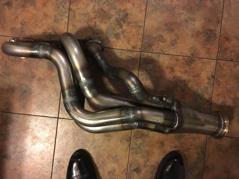

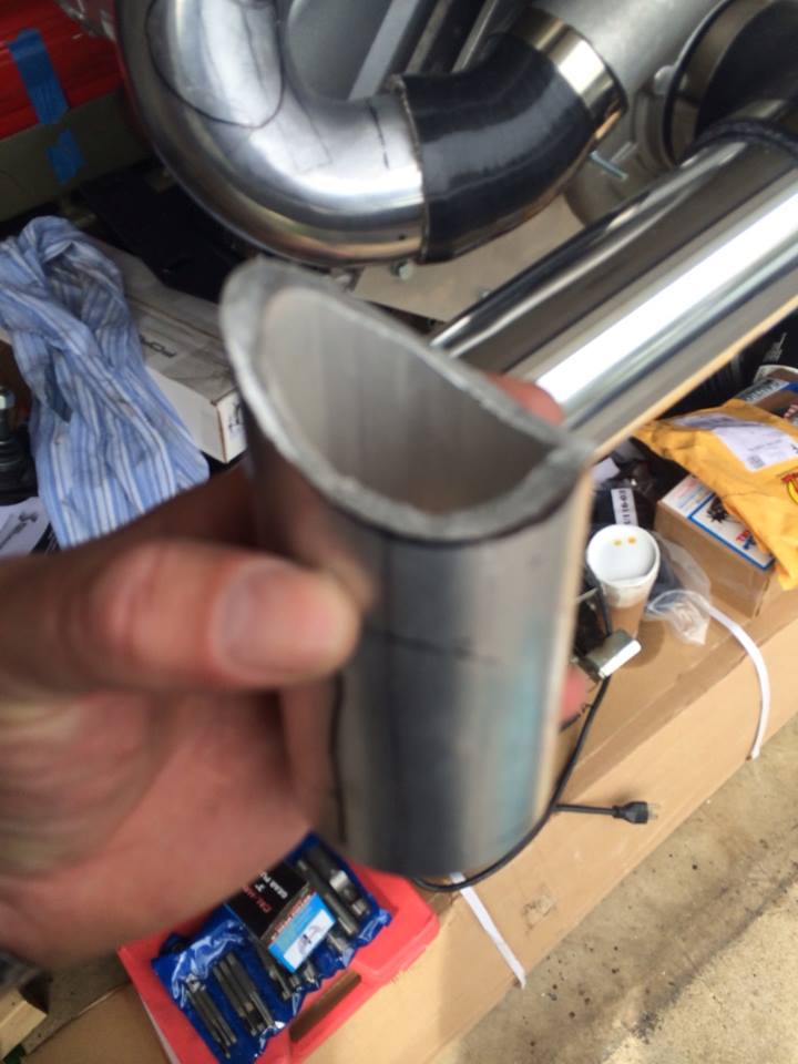

      Custom long tubes came in, 2" x 3.5" V band collectors. Swapped front k members. Aligned and tightened the k member. Probably going to have to cut out the sway bar mounts and drop the k member to get the engine in from the top. Drilled pilot holes to make sure it is still aligned. Pulled out the stock fuel system. Been having a hard time uploading pics.
