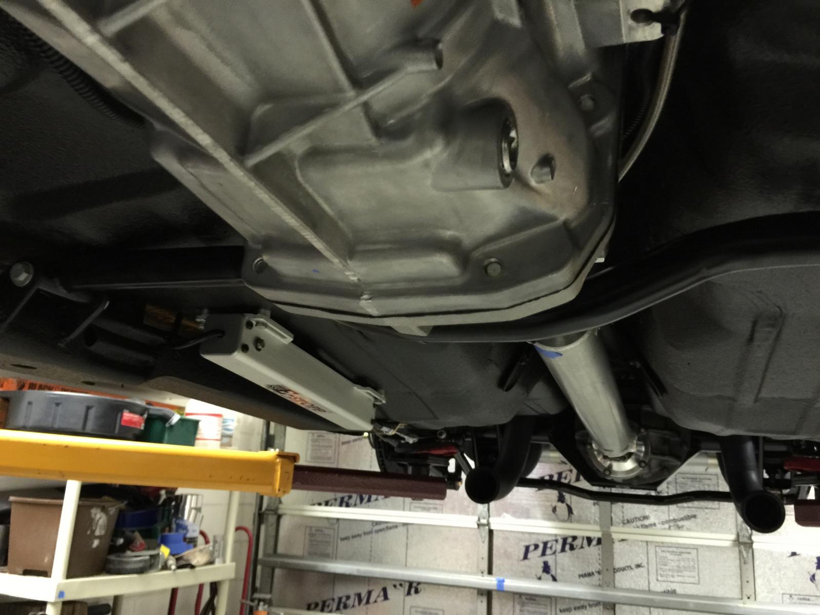

      Here's where I bolted it. The bolts go through the seat riser flanges, which are just the right dimension.

      Mounted behind the rear seat. Each Lokar parking brake cable comes from its respective side and is mounted to either end of the box tubing that is bolted to the package tray support structure. All of the force is contained within the confines of the brackets square tube. Mounted like this, when the Estopp is engaged it "pulls" both cables together, ensuring that the the force is equally distributed to each parking brake mechanism. It looks a little ghetto, I wasn't sure if it would work that way so this was a test run, but it worked out really well and made use of what was otherwise dead space.
      Standard kits ship with a green light up button. That can be corrected with a black sharpie and it is still transparent enough to know when it is on. There are other colors available.
      Clarification on operation in case it isn't clear in the picture.
      The Estopp cable housing is mounted to the brass block on the right.
      The Estopp cable is mounted to the brass block on the left.
      When engaged, the cable pulls into the housing and pulls the brass blocks closer together. When that happens it is pulling on the cable that is hooked to each caliper and setting the brakes....equally. That was really important as the IPSCO calipers are really sensitve to adjustment and I wanted to make sure we were getting all we could.

      That looks great Donny, very clever solution to get both brakes engaged. Think I have my answer!

      Donny, that's damned clever!

      The CTSV cars and equivalent use a similar concept, I borrowed it from GM because it made sense. The reason I wasn't sure is it takes a lot of travel to do it this way, twice as much compared to pulling both cables with a balance bar.
