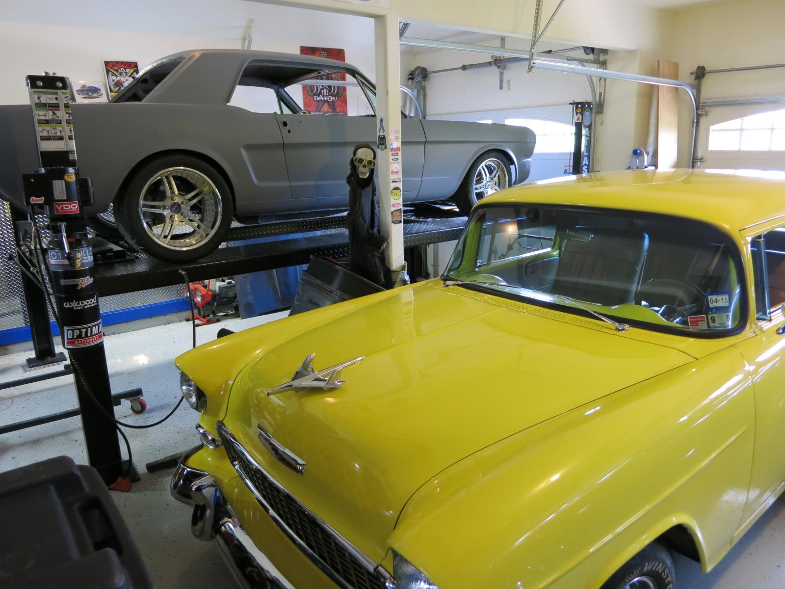

      I am building a '66 Mustang coupe and I am ready to purchase the rear coil-overs but would like some confirmation / help. I have somewhat decided on Ride Tech HQ series and have been told that this is what I need. I would like to get your thoughts before purchase.
      4.1 stroke 10.125 compressed 14.225 Extended 10" Spring length with either a 220lb or 225lb spring rate.
      The car will be mostly used for the street and some day the Power Tour. Currently the car sits as a roller with the following after a complete nut/ bolt rotisserie tear down:
      Custom 4 link
      Custom cut Currie 9"
      Custom sub-frame connectors
      Rear frame rails moved in
      Mini tubbed
      Boze 10.5" rears
      Rod and custom Mustang ll front coil-over
      Wilwood brakes
      Future 500 hp EFI motor.
      Thanks

      You may want to call Mike Maier Inc. (Not Maier Racing - different company and not the right one) in Livermore, CA. and ask him what would be best for your ride. Kool yellow double nickel. Do I see a Winston Tire on that 55? Wow, that is a name from the past.
