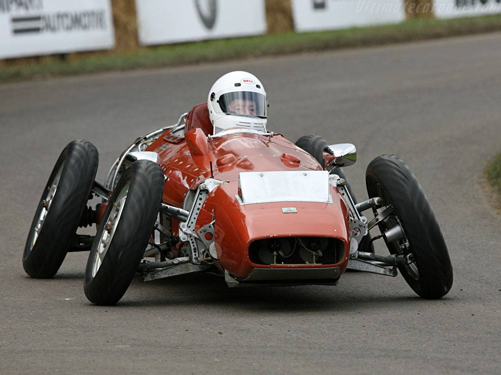

      Look at the tires if you don't think that there is some down force at play there in the second picture
