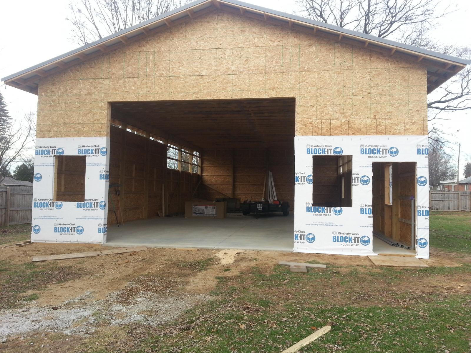

      More progress on the Garage this weekend. Back wall is wrapped and more sheeting on the front wall. Need to make another trip to the lumber yard for more OSB, Wrap, and some 2x6's to finish framing in the windows. Soffit and Fascia trim should be going up soon also.

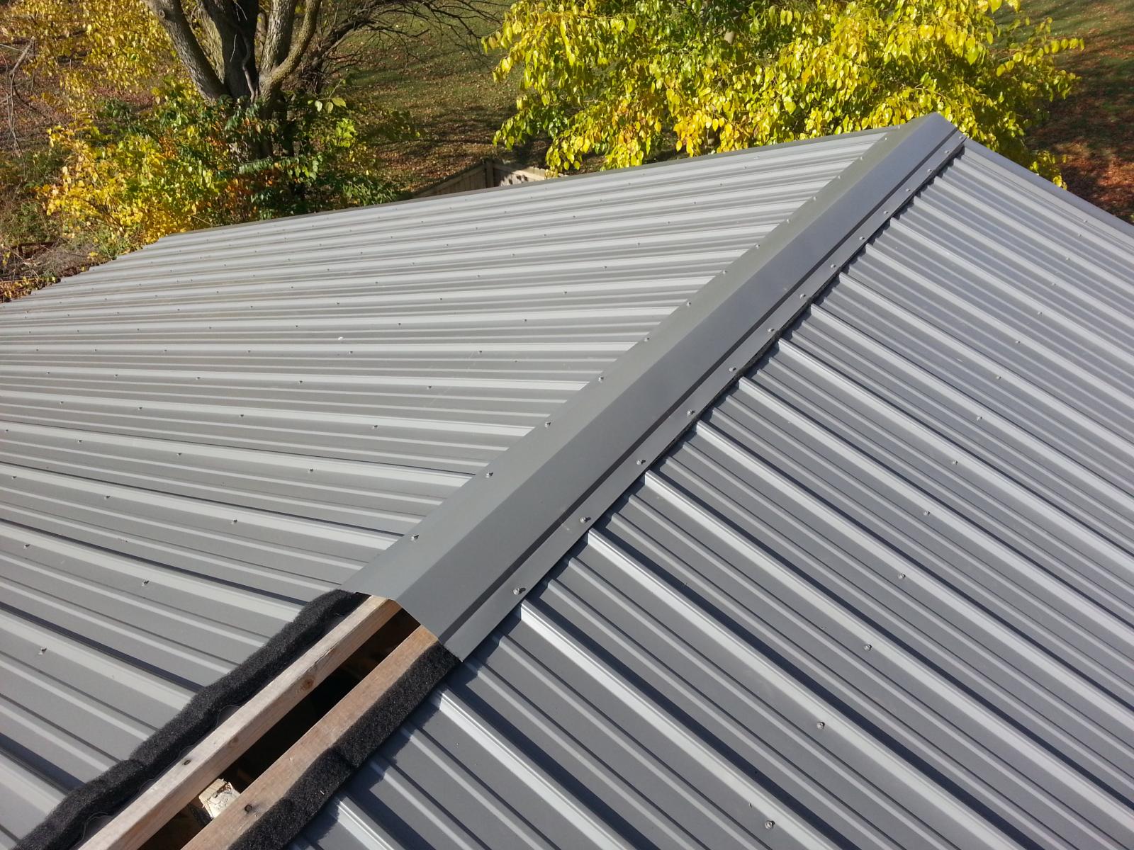

      Finishing up some trim work on the roof this weekend. Framing in windows and bought 20 more sheets of OSB to do more sheeting. The overhead door will be on order soon and have been researching lighting options. Also have been researching a little on air compressors and other shop needs. Stay tuned, more to come.

      Not much to report today. Finished up the roof trim and ridge cap and framed in the rest of the window openings. I'll most likely get those on order this week along with the doors. Skipped out on working on the Garage Sunday to go deer hunting... should have worked on the Garage.

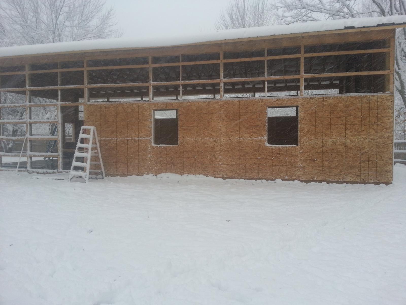

      Well this changes things a bit.... Early snow storm dumped 6" of snow on us.

      A few more shots of the sheeting going up. Waiting on the windows and entry doors to arrive.

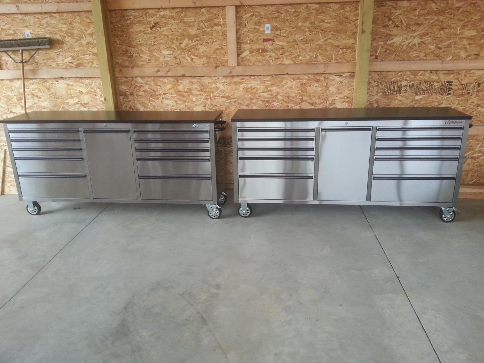

      So I may have gotten the cart in front of the horse a bit today, but couldn't pass up this Black Friday deal at Menards. They may not be Snop-On, but that's 144" of Stainless Steel tool storage! Saved $400 on each one, got them both for under $1K.

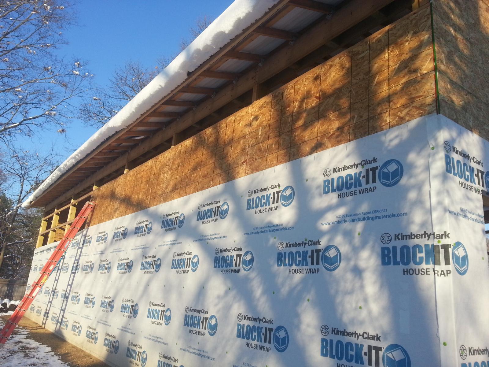

      Little more this weekend. 14 sheets to go and and the walls will be closed up. Windows should be arriving soon.
      -Mike

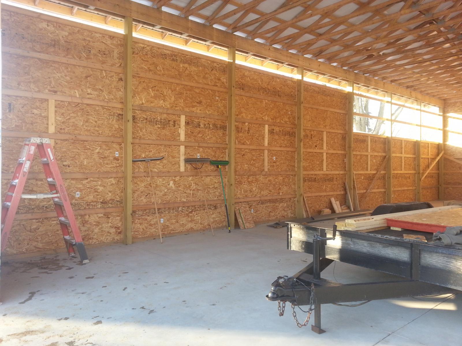

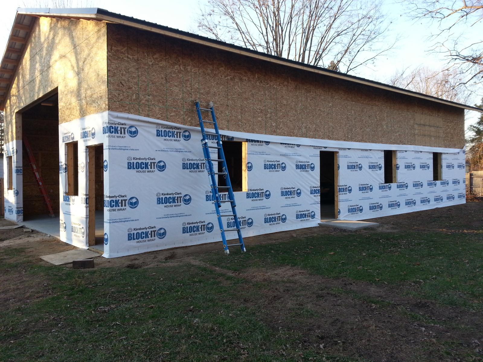

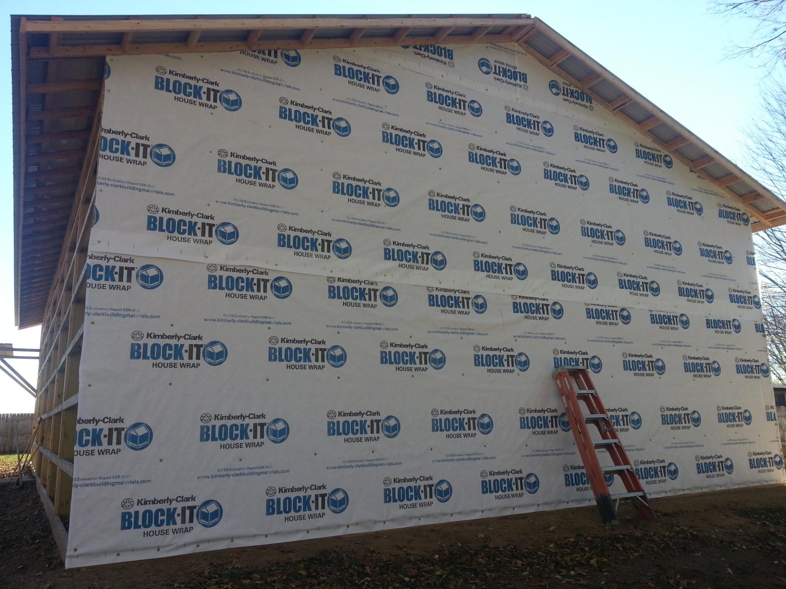

      Finished of the OSB sheeting this weekend and Sturgis Overhead Door came out to measure the opening for that. They should have it installed within the next 2 weeks. I believe the entry doors and windows will be arriving this week. The conduit is run for electrical and Ethernet. Minimal amount of house wrap to finish up and we'll move on to the electrical work inside. It's been a long haul this year, but I've always believed that you should never hire out a job that you are capable of doing yourself. It may take a little longer, but I've always taken pride in my accomplishments.

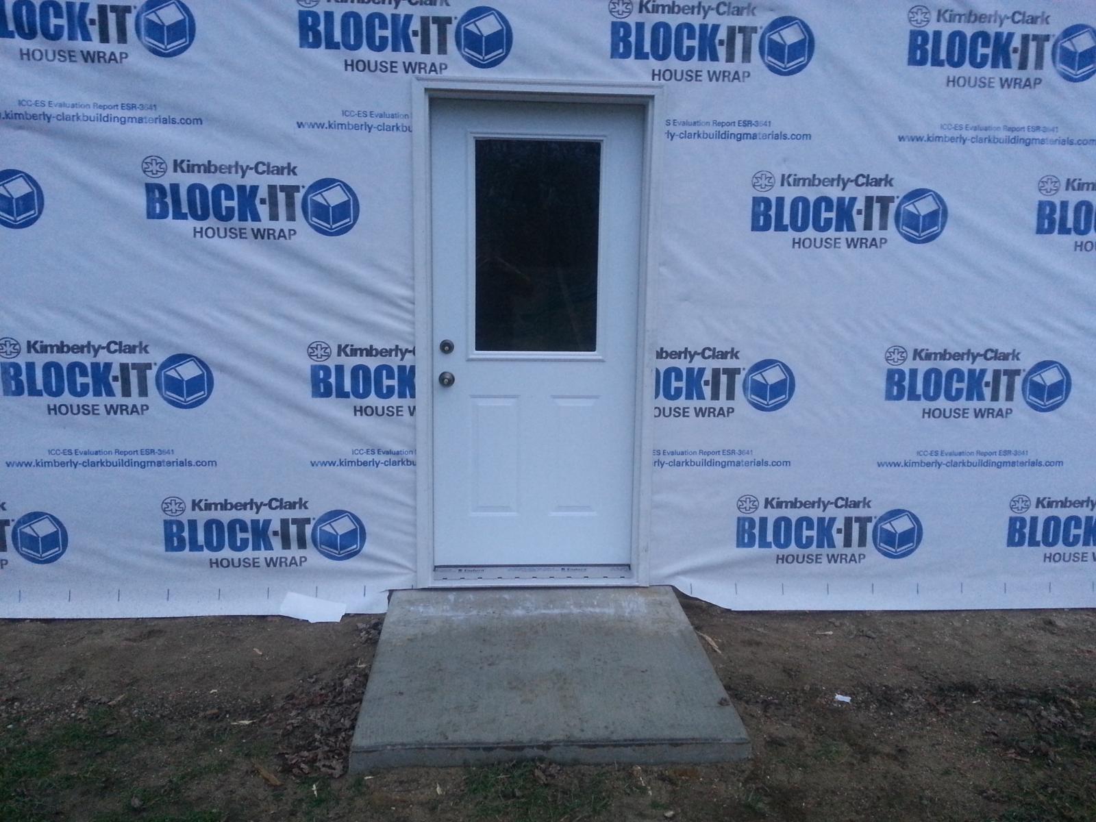

      Not much progress this weekend. Went to PRI in Indy, but did get the first entry door in.

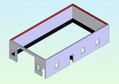

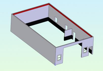

      Good to see you'll get it sealed up before winter really hits Mike. Are you going to put in a drop ceiling? How are you going to insulate the walls and the roof\ceiling?
      Mine is 36x50 so about the same size as yours. I started mine in 2001 and am pretty familiar with the process you are going through. It's hard and satisfying all at the same time.
      Lance
      Jun 2013
      Colon, Michigan
      217
      I'm going to do a steel panel ceiling, then do blow-in insulation up in the attic, about 14". They have 8 ft. wide R19 batted insulation specific for pole barns, with a nailer strip at the top. They install between the posts and hang in place, pretty quick and easy. The walls will have a 36" high black steel wainscot, then I'll use the T1-11 wood siding painted light gray for the rest of the wall coverage. I did a simple 3D model of it in SolidWorks for fun to get a rough idea of the color scheme.

      That should work out pretty nice...

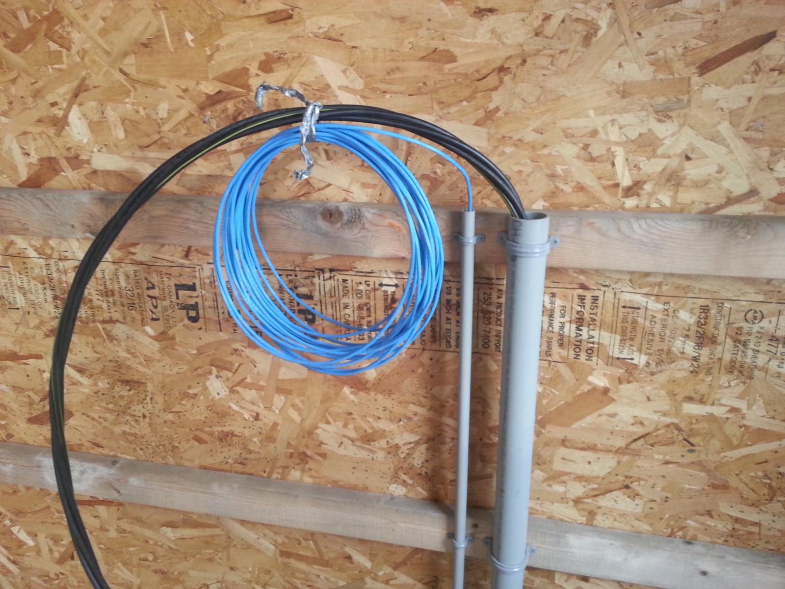

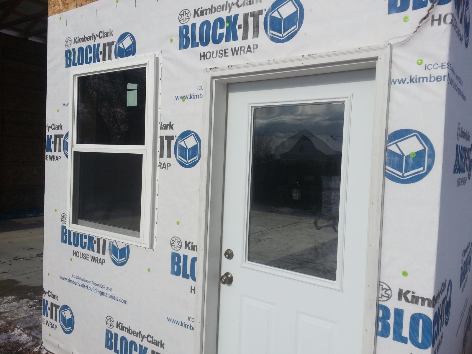

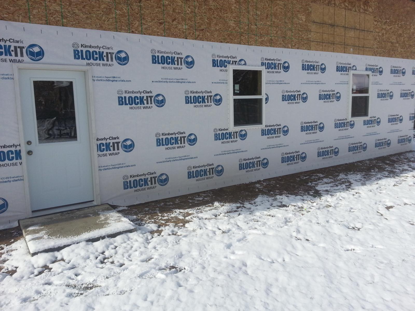

      We were able to get the windows and second entry door installed this weekend, as well as pull the electric and Ethernet cables through. Overhead door is scheduled for install today and should be able to get the rest of the wrap finished up this week.
