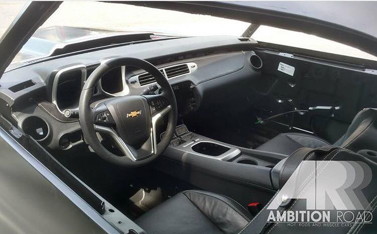

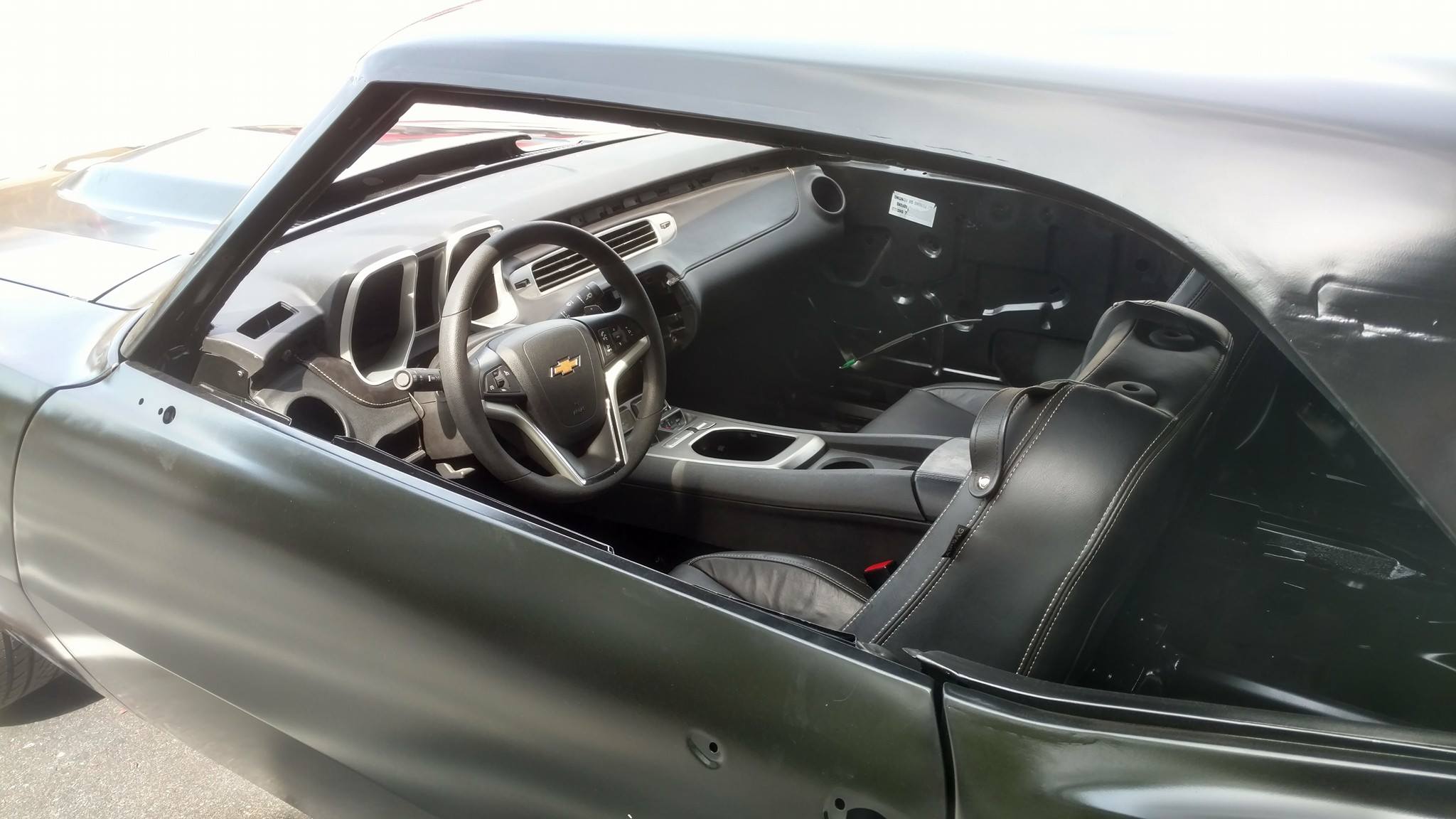

      This car is going to be beautiful, Great work! I have a question though, (well actually a lot of questions) but I won't bother you with all of them. Does the late model dash actually fit into the early Camaro, width wise? Meaning, the padded part of the dash does/doesn't have to be altered? Does it fit between the posts? I know there's a lot of work goes on in the fab part of this. Really cool how this is going to end up.

      Fire away, I'm always more than happy to help.

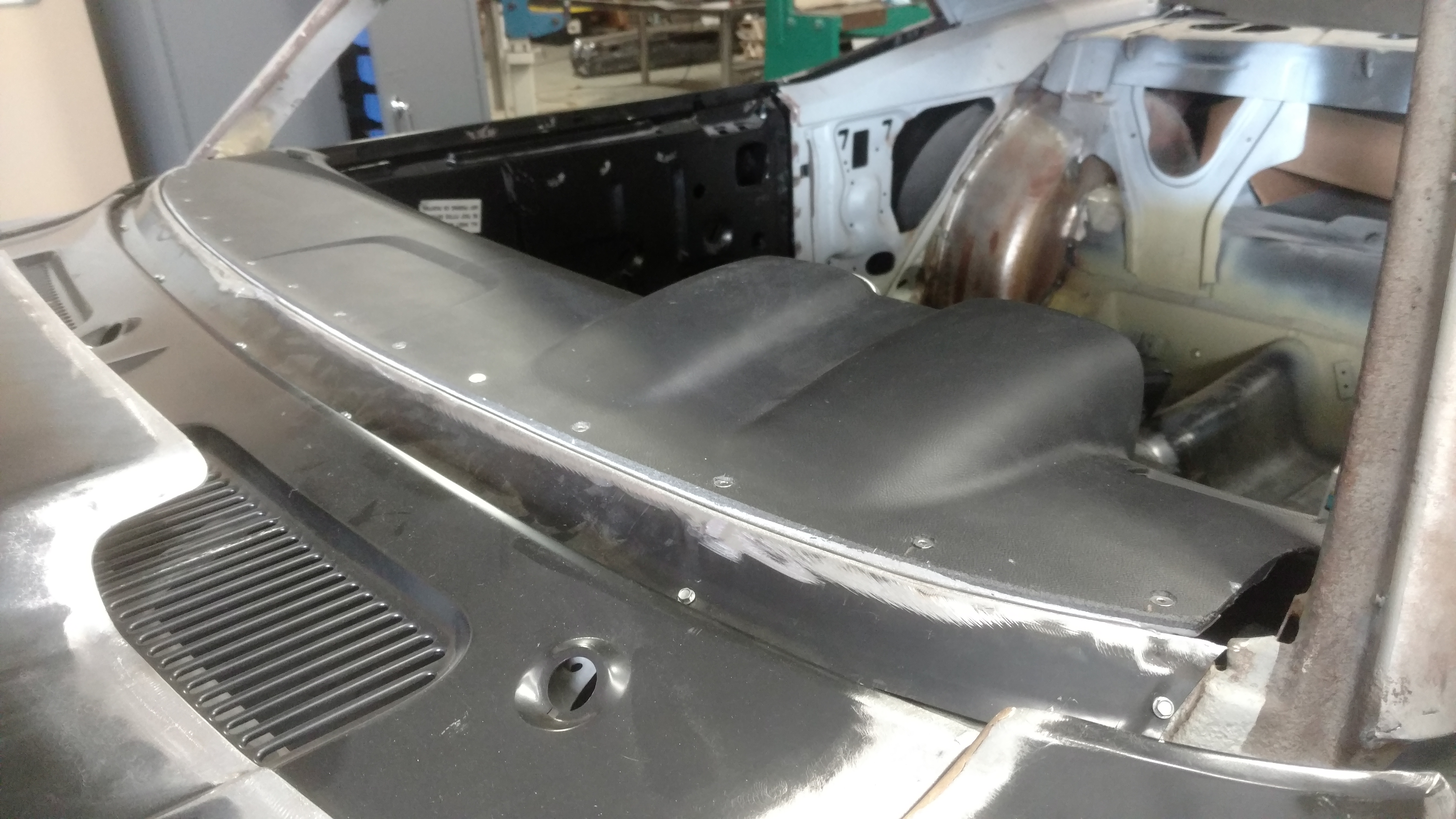

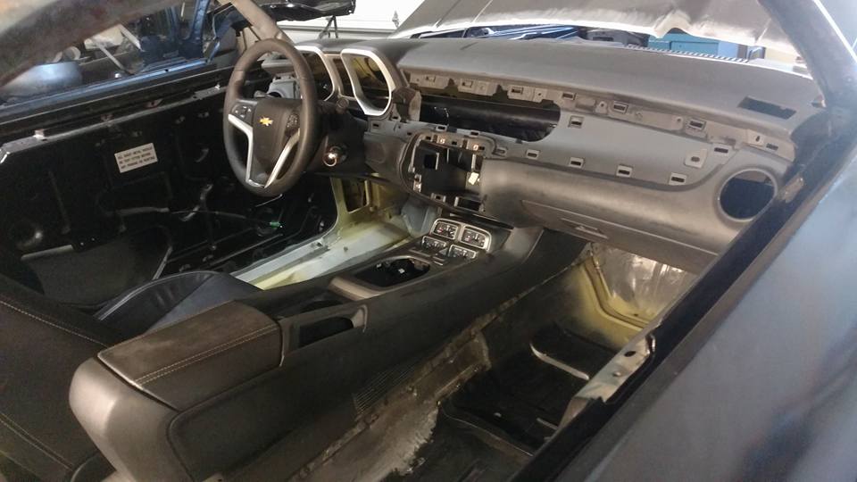

      Width wise, the dash fits surprisingly well, the pictures below will show it.
      But it is much, much deeper and needs to be trimmed back a lot! It's all in place now and looks quite at home, I'm really liking it. The dash actually isn't padded anywhere, it's just plastic and can be cut easily, but it fits in-between the posts no problem at all.

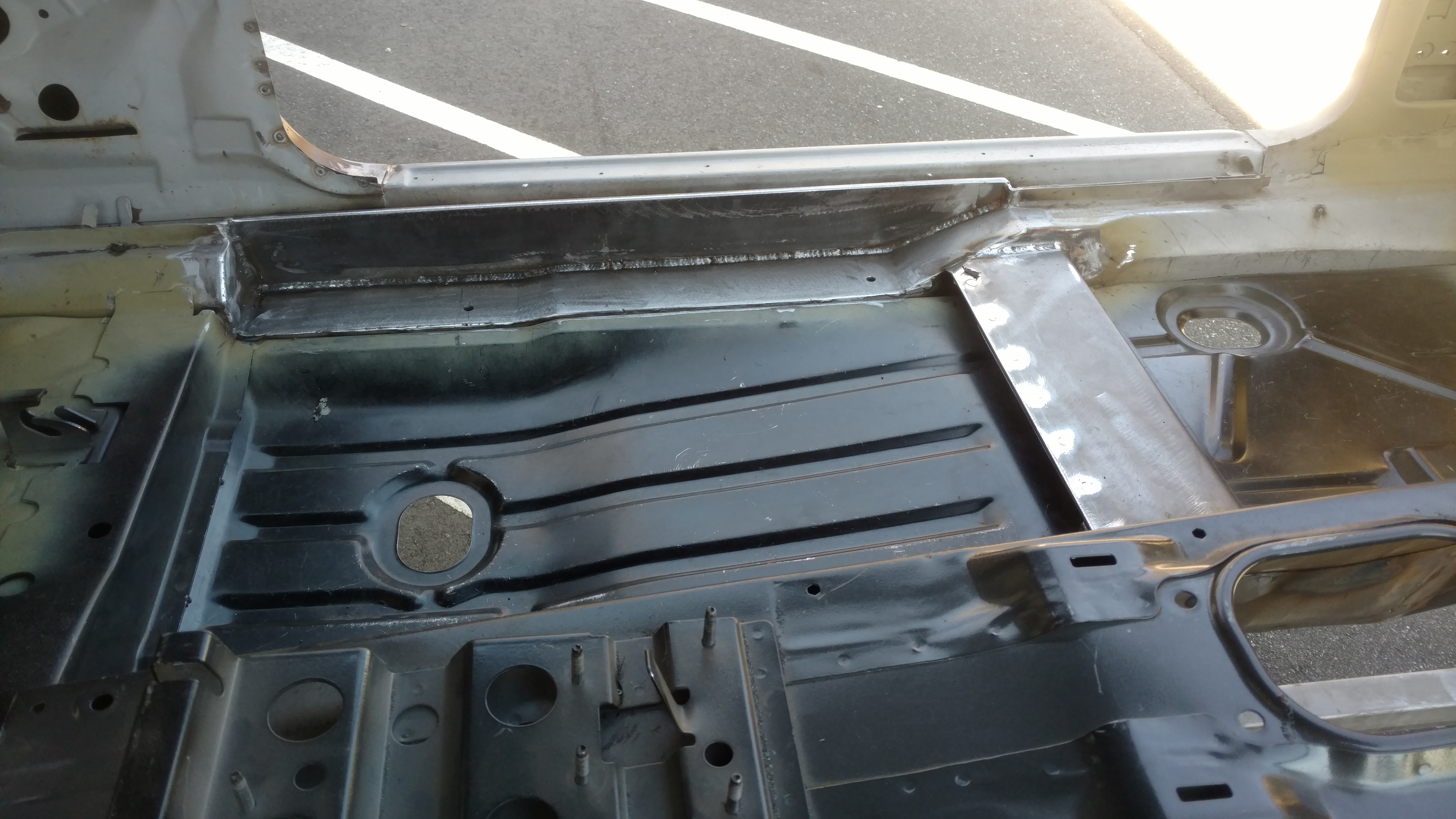

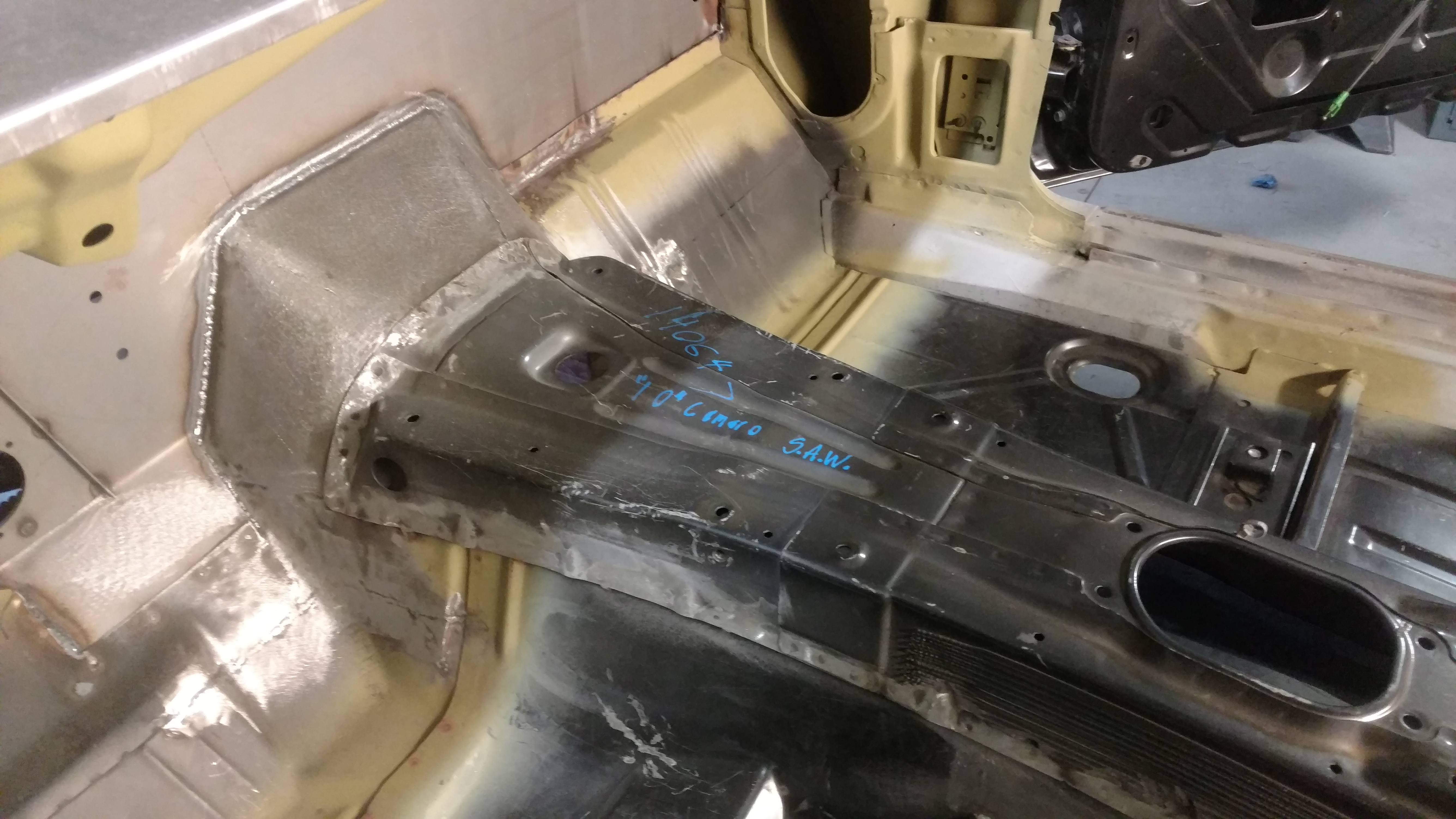

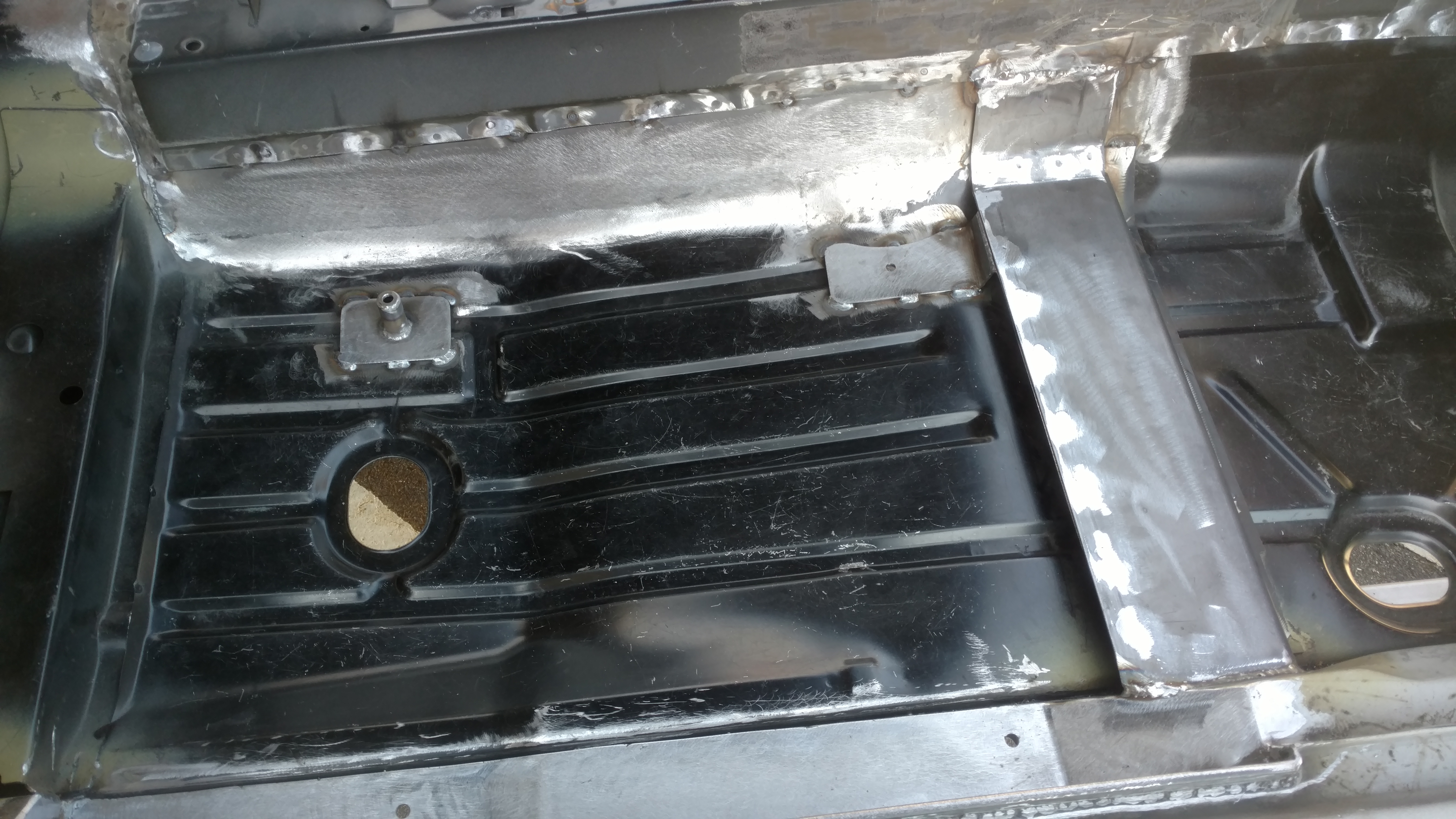

      we'll need to make some custom side panels to close it out and figure a way to tie it into the A-pillars, and then make custom door cards to bring it all together but that is future james's problem, for now I just want to wrap-up the fabrication, which is very close, I sat inside the car today so we could figure the best way to mount the seats, and custom seat brackets will be made as low as possible, also some further reinforcing of the floor now that it has been modified to allow for the wider seats.
      Then it'll all be removed in a couple weeks and we'll sand it back to bare metal before having the interior sand blasted a little and put it all back in epoxy.

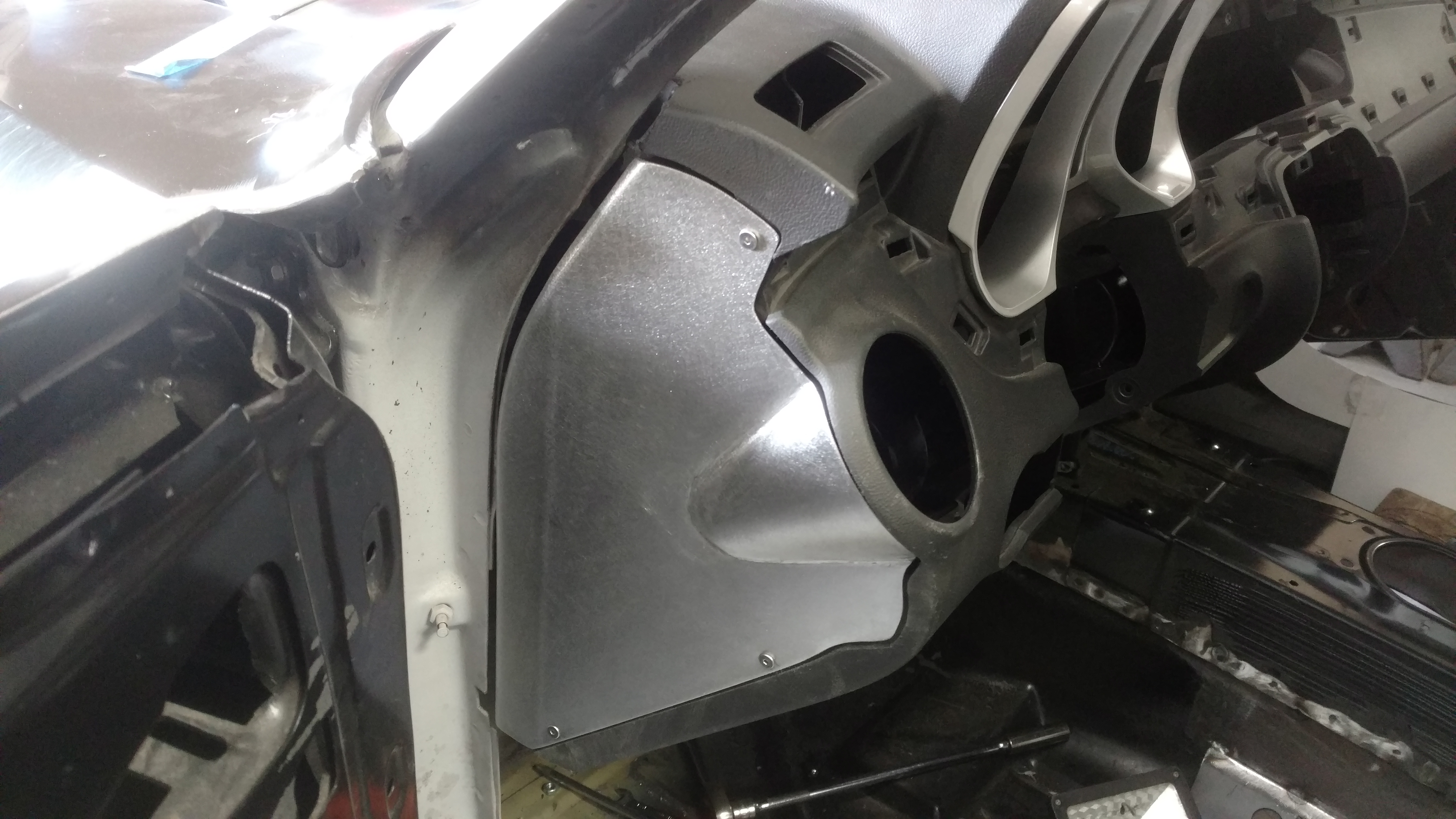

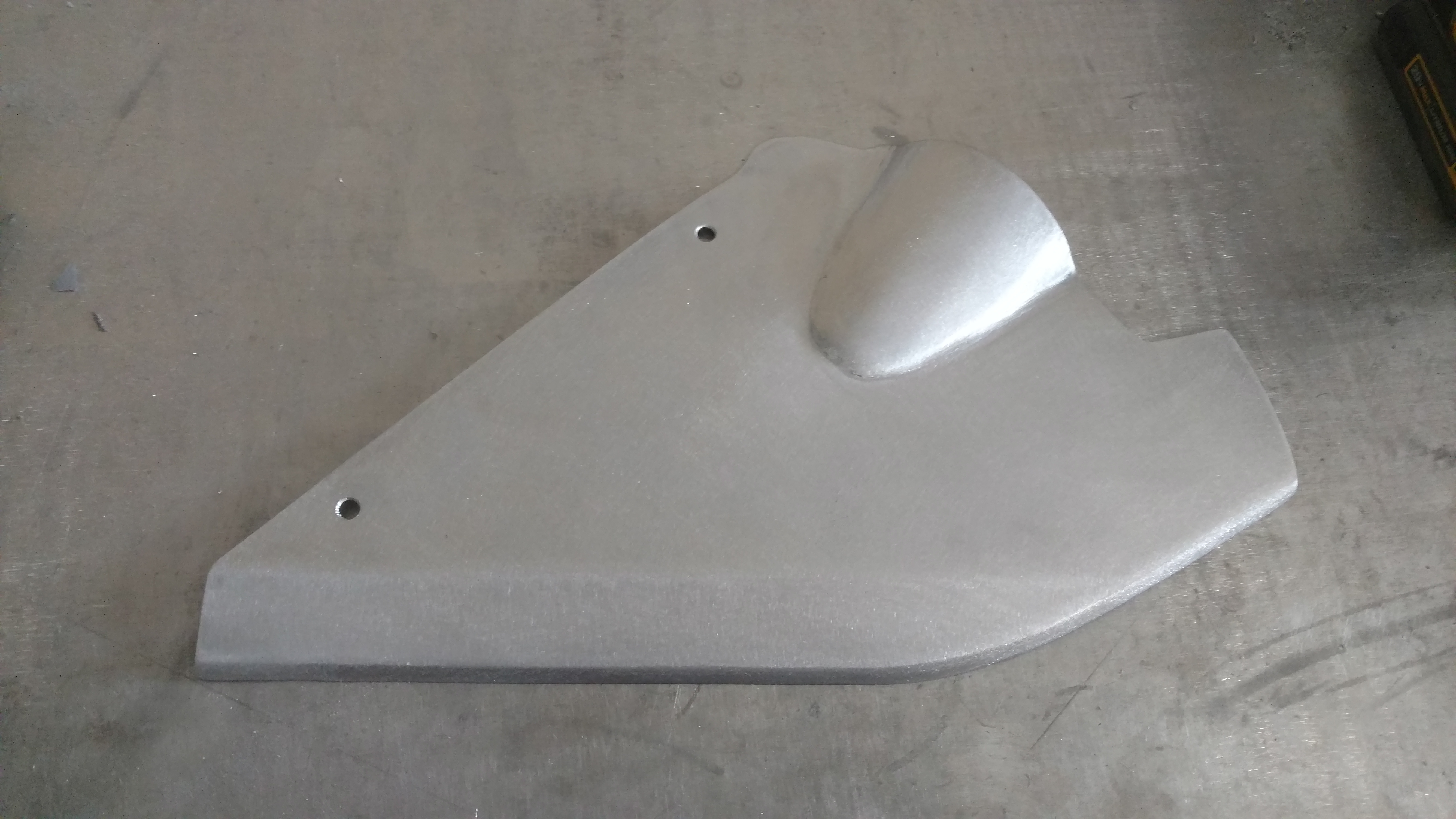

      Some more finishing touches on the dash should see it fitting perfect. The stock end caps to the dash just wouldn't work and they whipped these up relatively quick and they look great! Also, to fit the wider seat we removed the 68 setup and made all new mounting points and reinforced the floor to compensate.

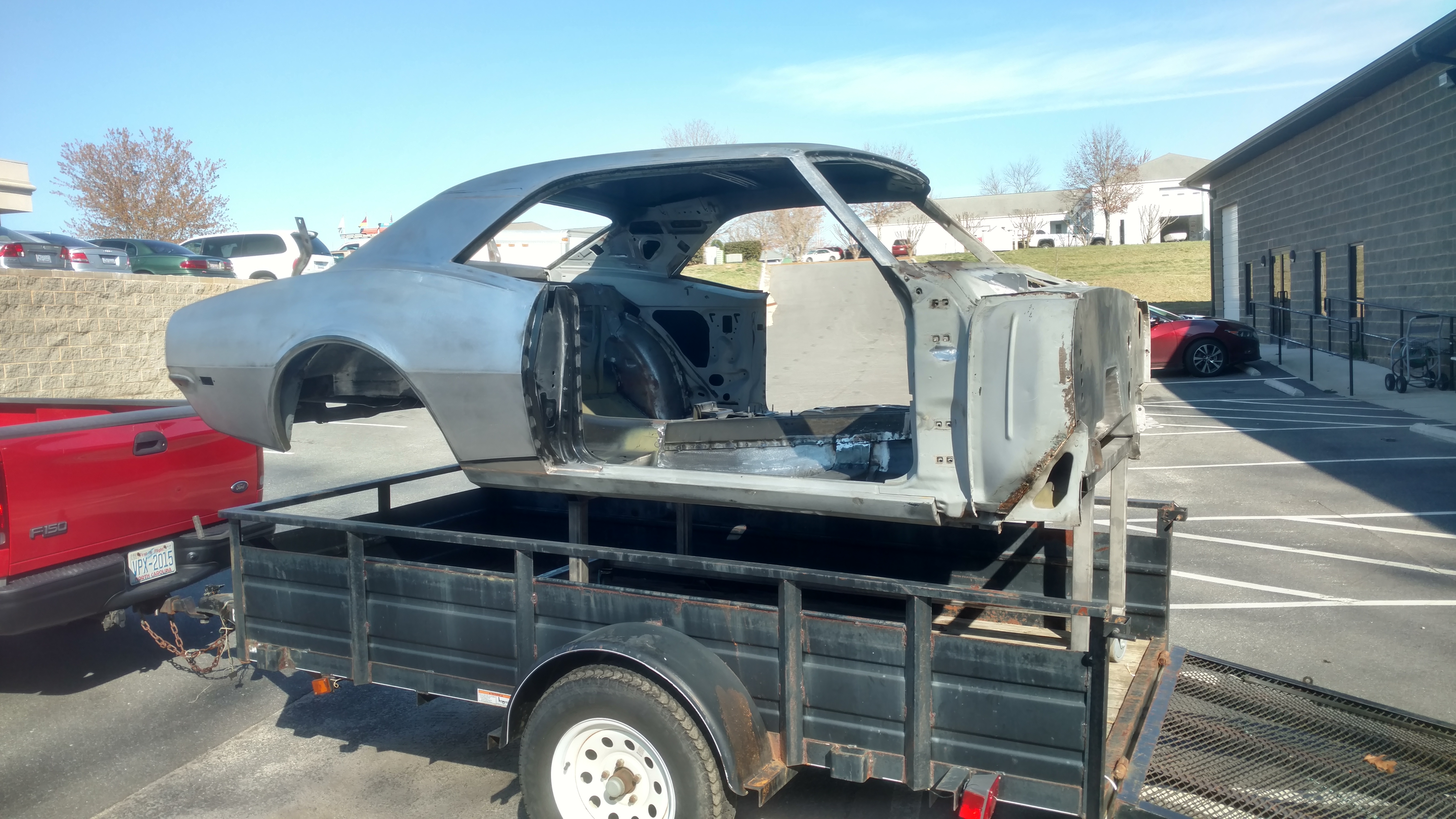

      And now the car has been completely disassembled again, sanded off all of the epoxy that comes on the replacement panels as occasionally it can hide some rusty defects from their manufacturing process(and it was). On monday we have her booked in for some sandblasting and perhaps we'll be reassembling her by the end of next week once it all receives another coat of SPI epoxy.

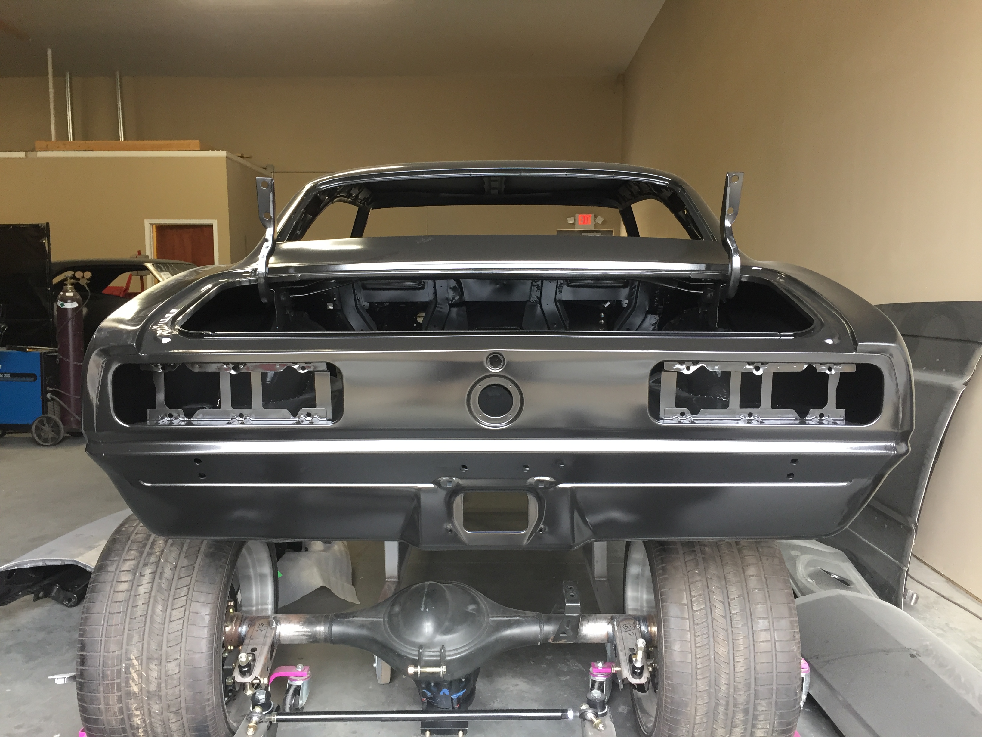

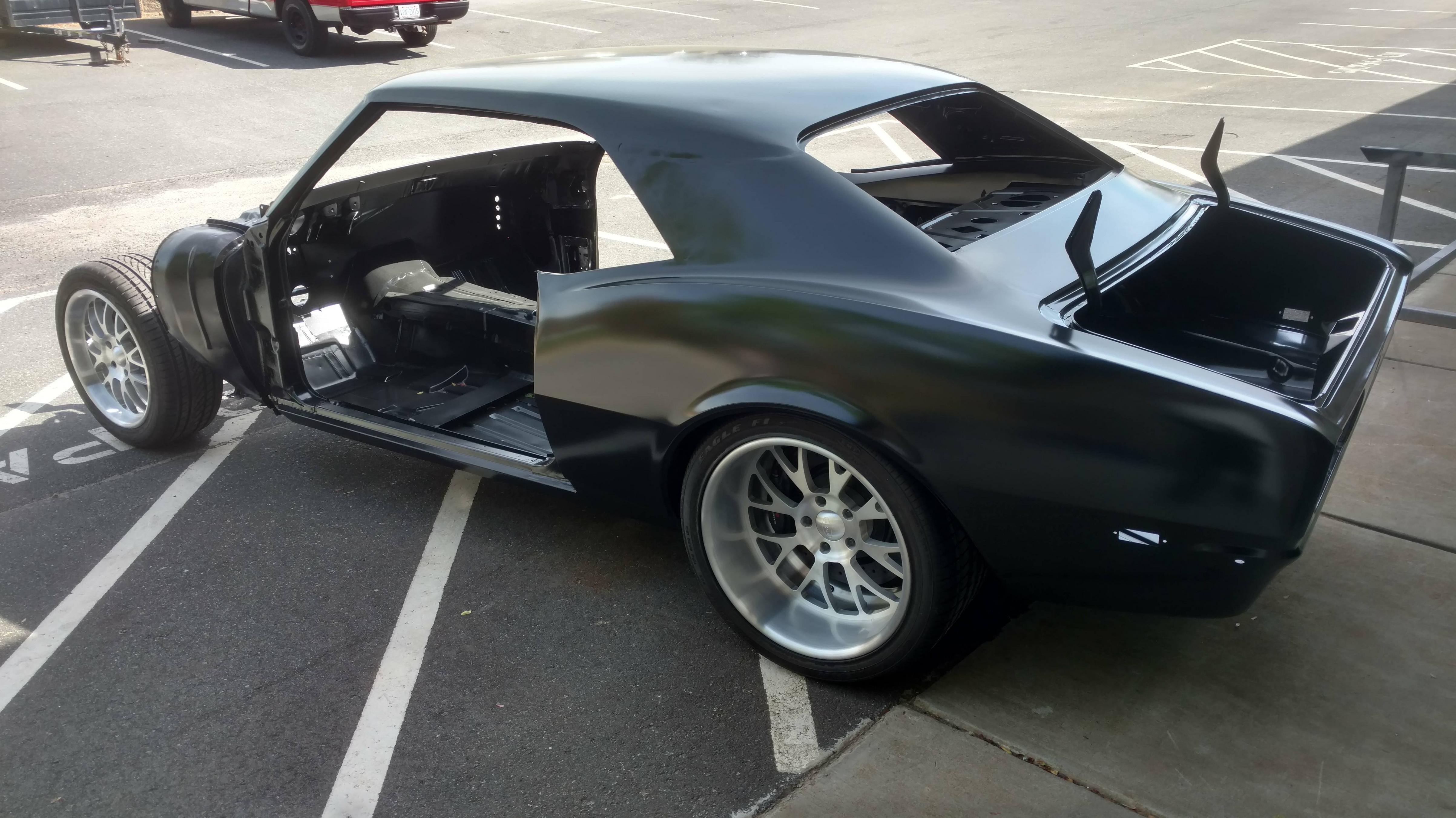

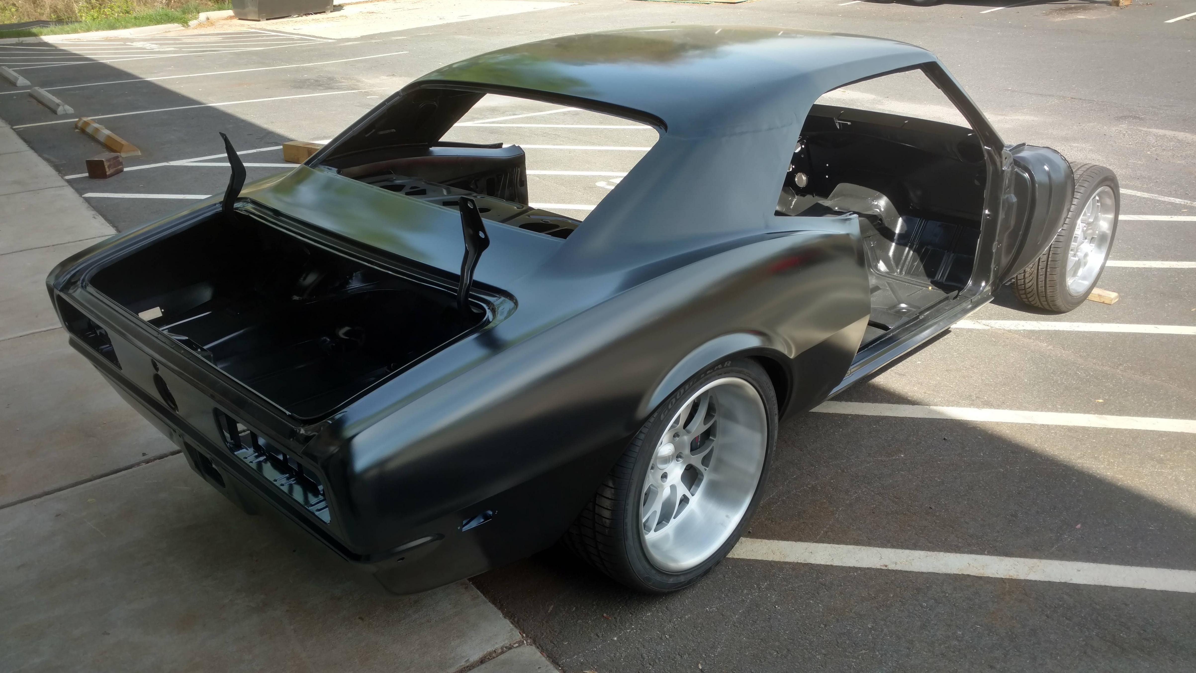

      The body came back in record time from the blaster so we got it in epoxy straight away. Fortunately there were no new surprises so now it is just finishing the other panels by removing of the old epoxy before applying the new. I'm very excited to see it all in one color finally.

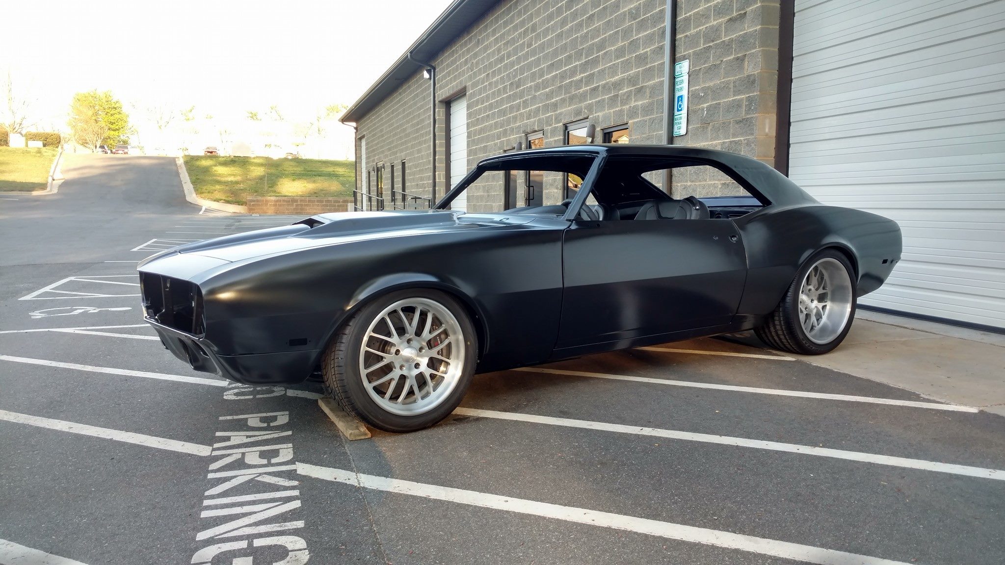

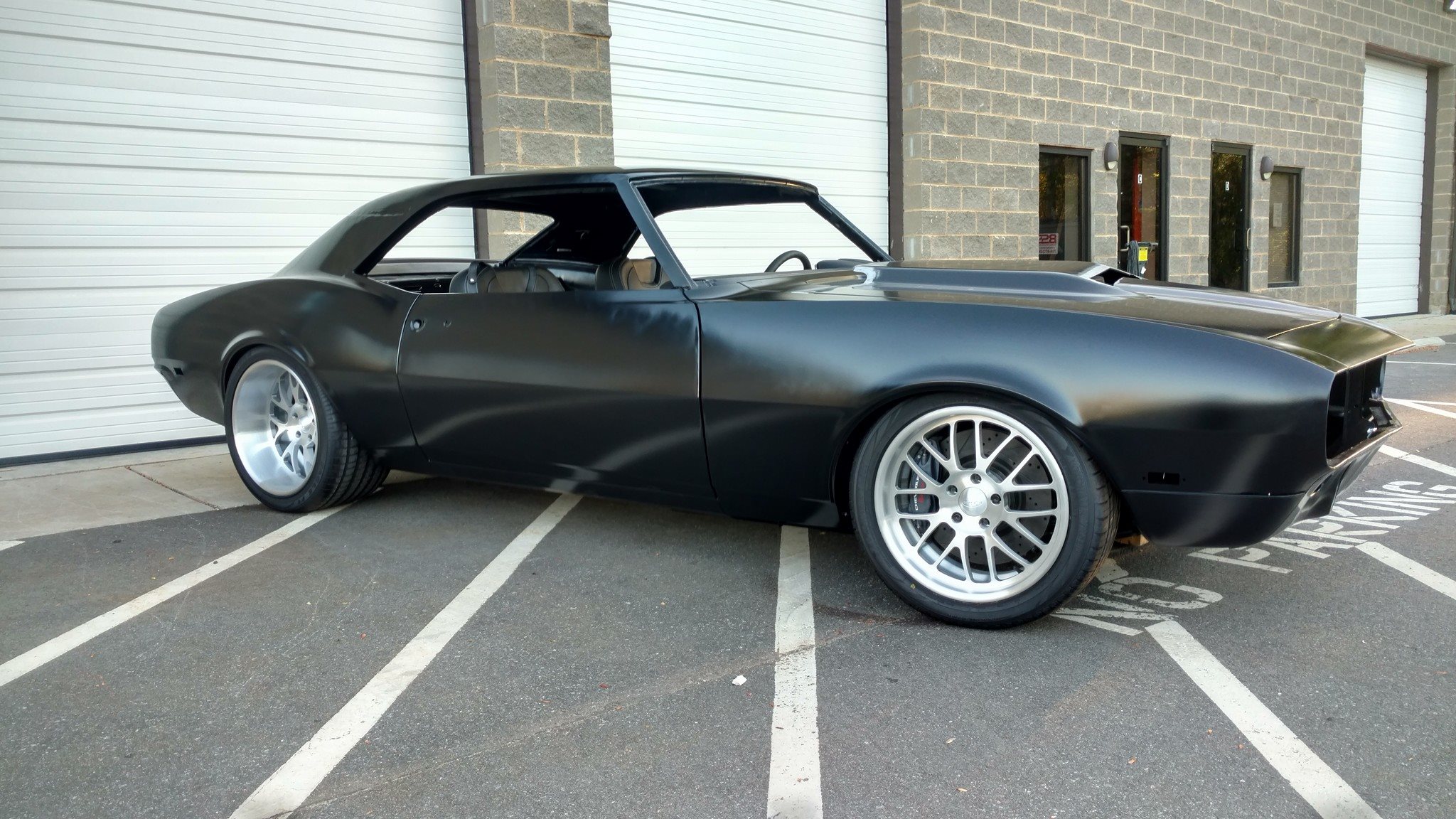

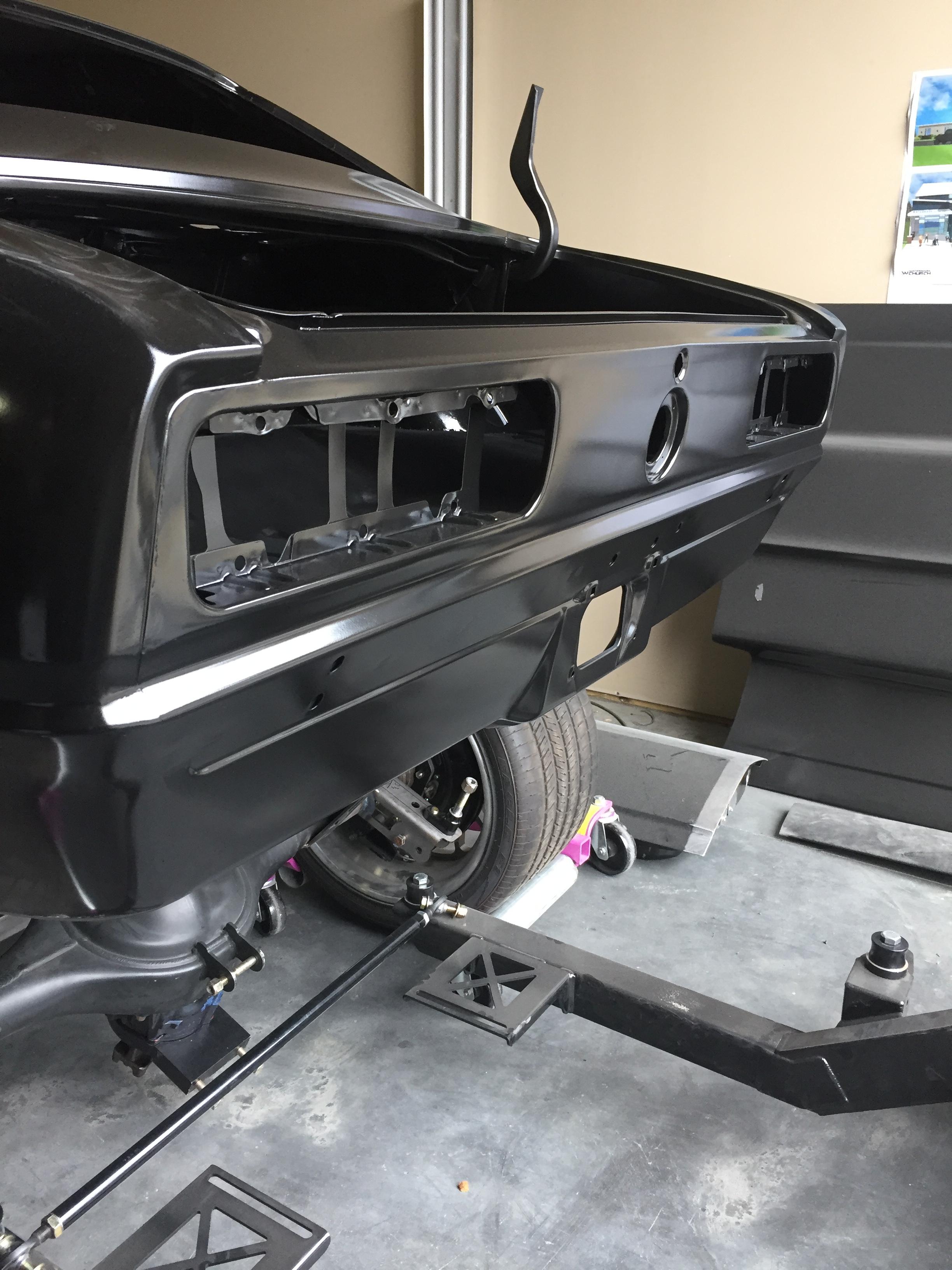

      one color at last!!
      A few little finishing touches like flush bumpers, some trimming on the hood intake, wiper test fitting etc, just to make sure everything fits right, and then I'm onto the next step.

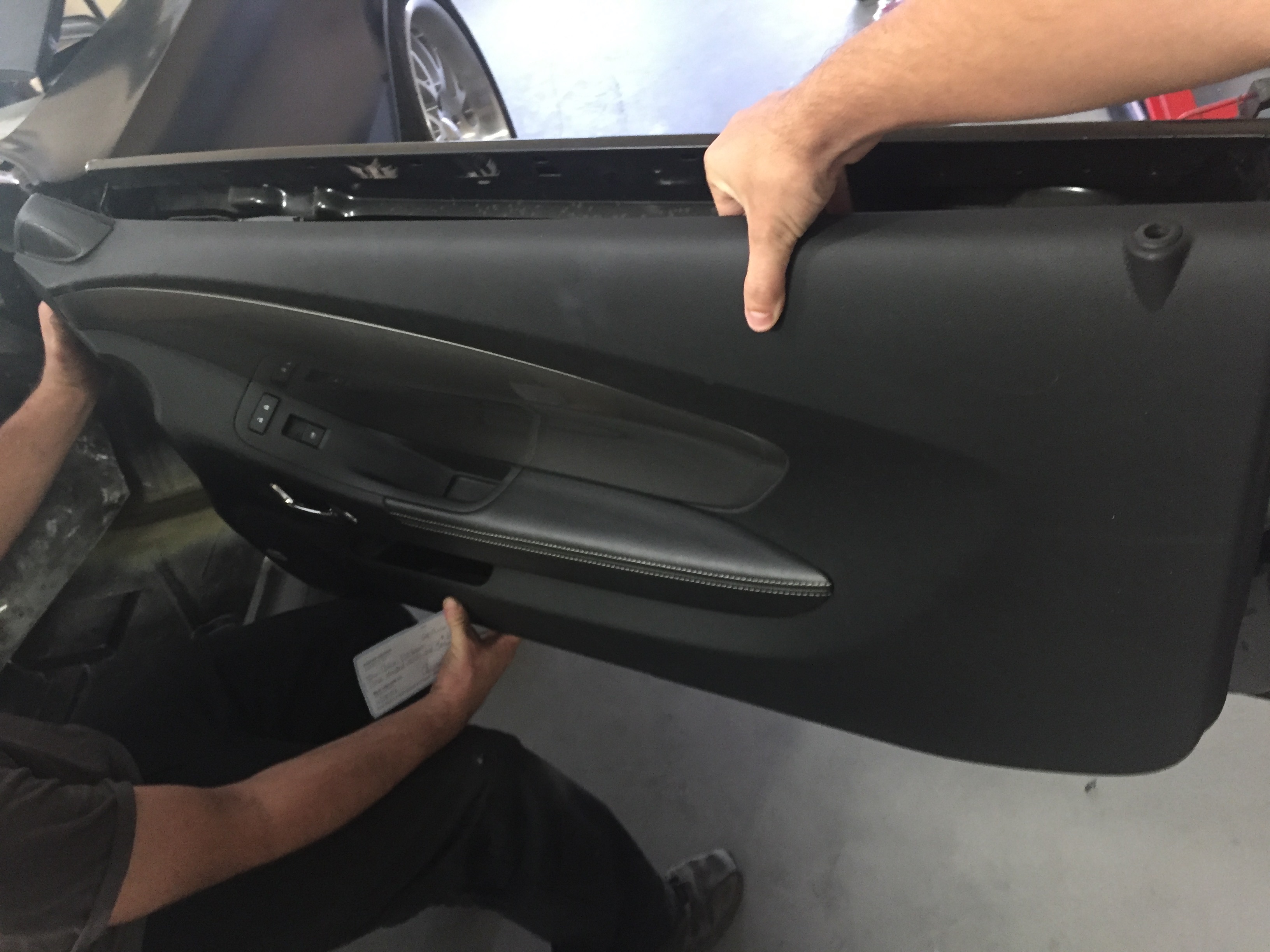

      Man, the dash and steering turned out very nice! Did you have any problems using the late model steering wheel assembly?
