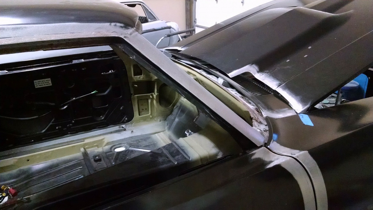

      Awesome build. How was the fit with the stinger hood ?? Gaps, quality etc. ? Thanks!
      Gaps were pretty good.
      but it's takes a bit of modifying, at least to get it how I like it, It will still function in the same way as a cowl hood however it has the appearance of ram air.
      the press of the actually scoop part is quite curved, not as sharp as a corvettes original hood, and took a day and half of fab to get it to where it is now.
      Also after removing a section underneath it was revealed it was even primered inside which is something I'm glad i found out before paint.

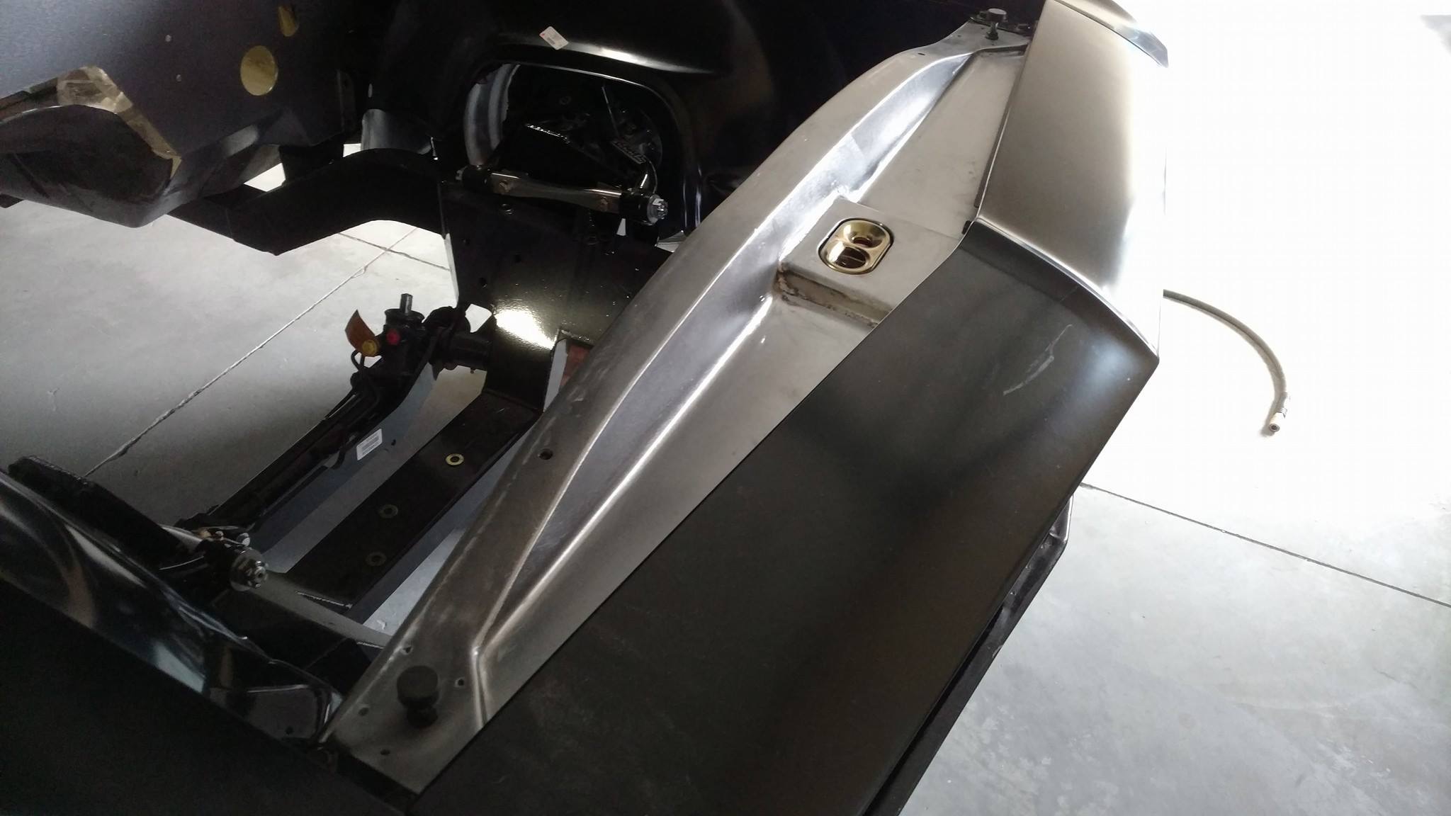

      gaps complete! just some finishing touches on the exterior and then the engine bay and interior work can begin.
      Also, I decided to copy the C10 that Ambition road built for Angelo Vespi and Aaron designed some gas strut style hood hinges, I like the simplicity of this and that I don't need to purchase another 'off the shelf' hood hinge like so many other, The hood sits a little low currently so we'll be installing larger struts to make things a little more functional.

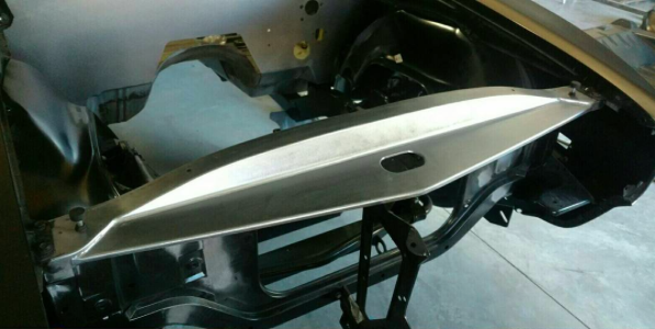

      A bit of progress on the radiator support and close out panel, incorporating VW hood latches of course.

      That close out looks great ! Nice job.
