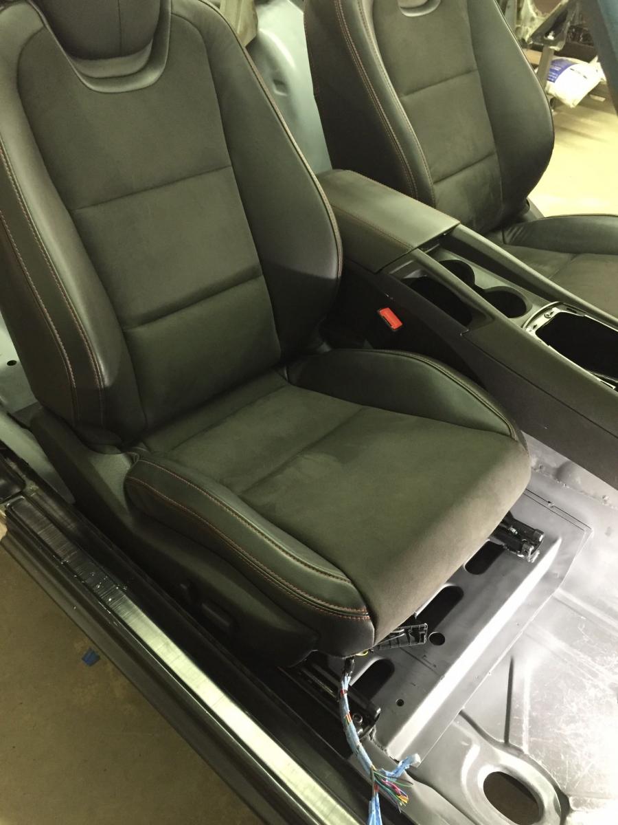

      Wait, the 5th gen seats will fit? I thought I had read that they were too wide and tall?
      A.K.A: That bald guy
      Find me on Facebook or my personal website.
      - 67 Camaro: Current Project Car
    3. #63
      Oct 2013
      Northern Virginia
      149
      They will with significant mods. Notice rockers and seat pan..
