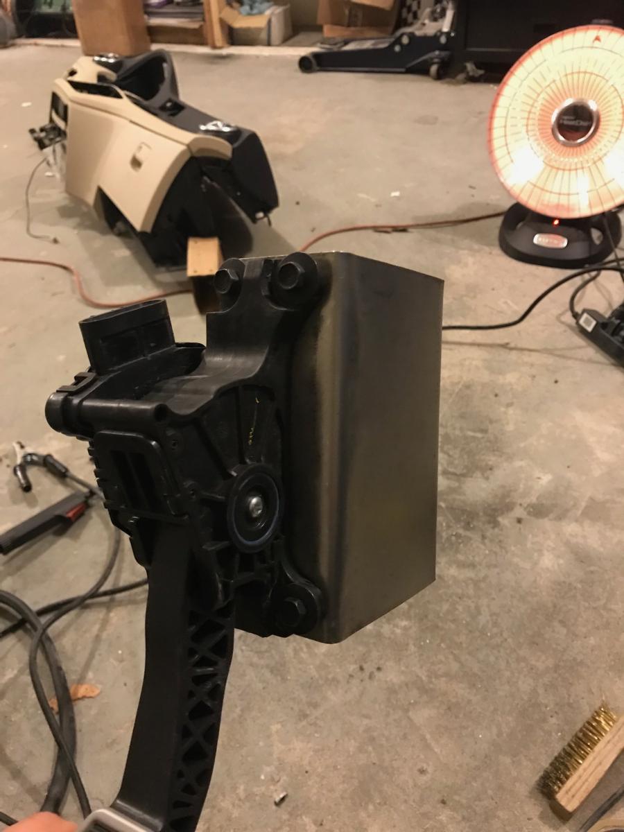

      Also for the pedals, if you want a budget friendly solution that looks custom go with stock Camaro pedals and buy zl1 pads along with zl1 gas peddle. PSI can make the harness to accept the zl1 pedal and programming pcm as well. It’s what I did. You will have to trim the pedal pads slightly but I’m sure you will figure it. Very easy. Here’s how it looks:

      Quote Originally Posted by joeko23 View Post
      Great build. How did you fill in all the holes in the inner wheel wells and the radiator support. In the pics it looks like you just bondo over them. Did you weld them in or use something else?
      Awesome advice, I actually have that same Accelerator pedal and was hoping to use it with a PSI harness so this info helps. Is it the "Camaro/corvette" peddle option on their site or is it something that needs to be called up to be changed? I was about to drop the hammer on it.
      The wheel wells and rad support were entirely welded up, so far there isn't a drop of filler in the whole car, just epoxied sheet metal
      Oct 2011
      721
      You would have to call PSI and tell them you will be using the ZL1 pedal. You also have to let your tuner or whoever programs ecu to program for your zl1 pedal. I also had to fab a bracket to bolt the gas pedal to so its further from the firewall. Here’s what it looks like.
      https://www.pro-touring.com/attachme...3&d=1518814897
      Aug 2015
      charlotte
      929
      fantastic, great help, my pedal is an auto SS model but looks identical to yours, I'll run it all by PSI.
