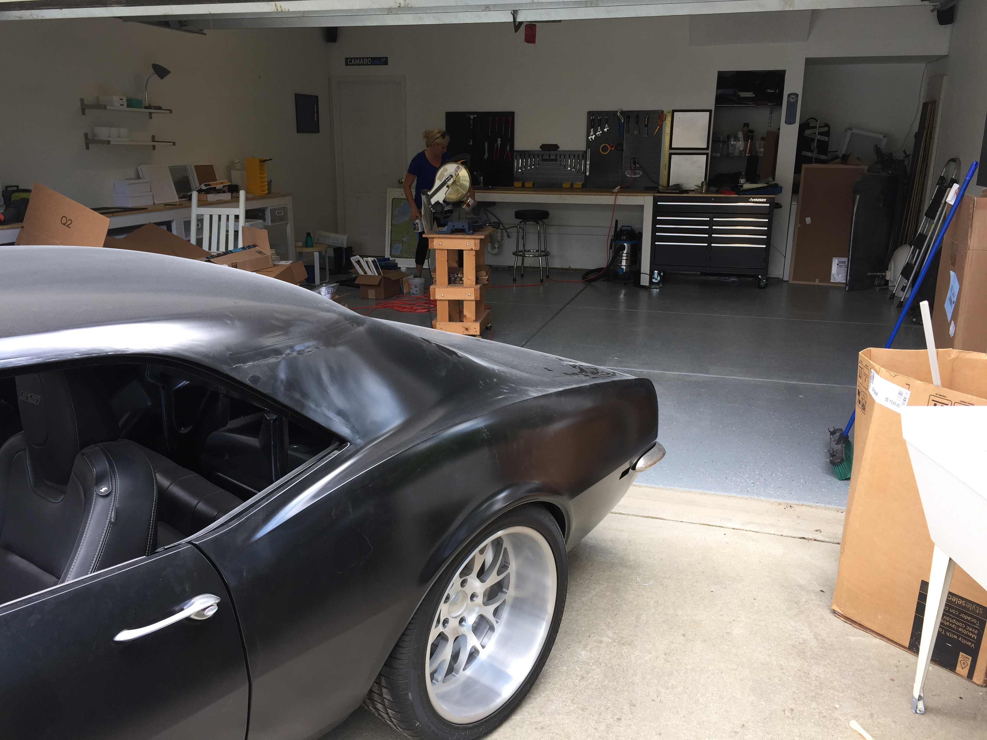

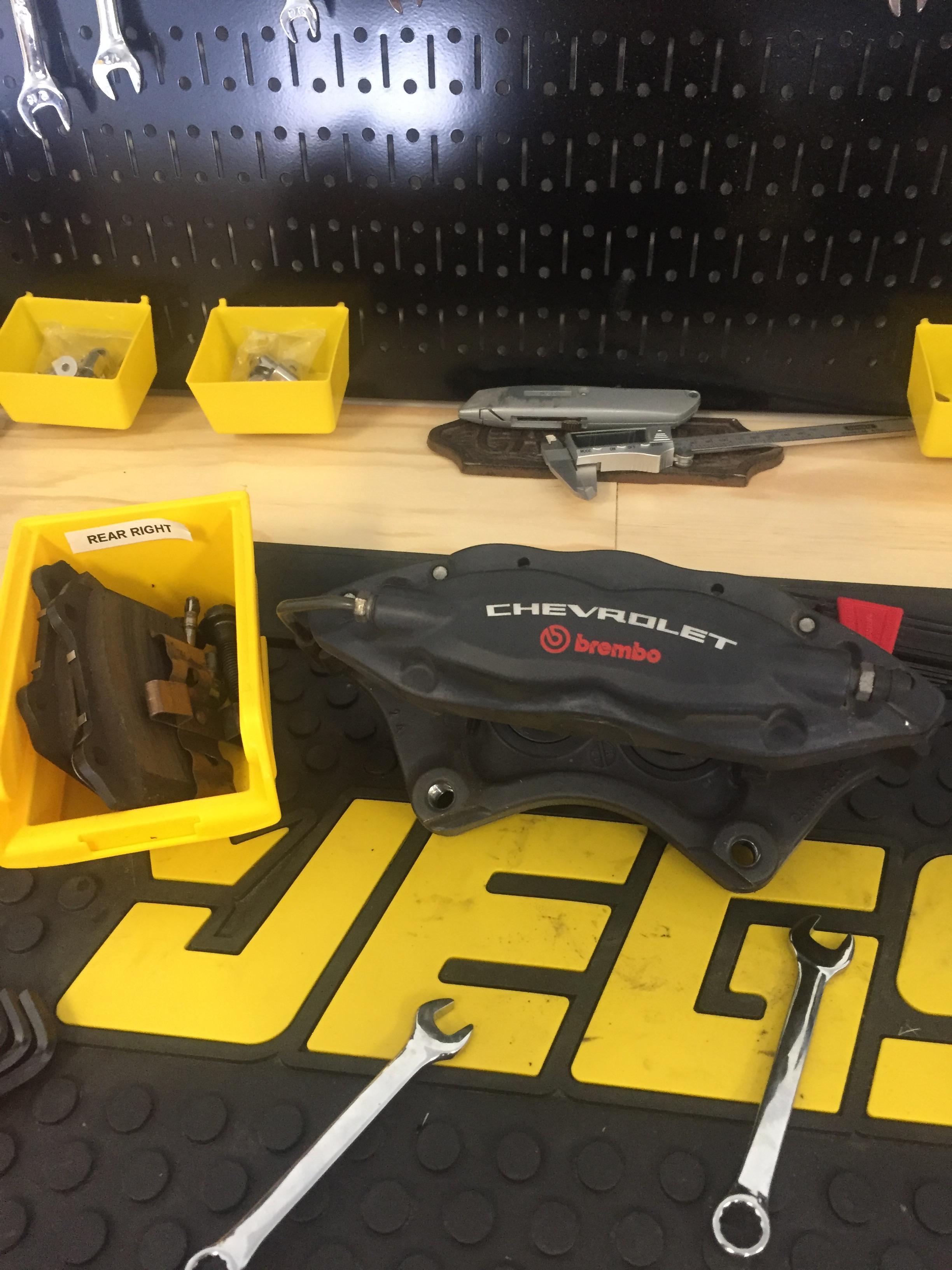

      updates are going slow at the moment, working in Singapore for weeks at a time also doesn't help, but I've finally got my garage setup to a point where I can now make progress on a bunch of small projects.
      I got the car up on stands so first thing I did was remove all of the calipers, I disassembled them so they are all off to be powder coated.

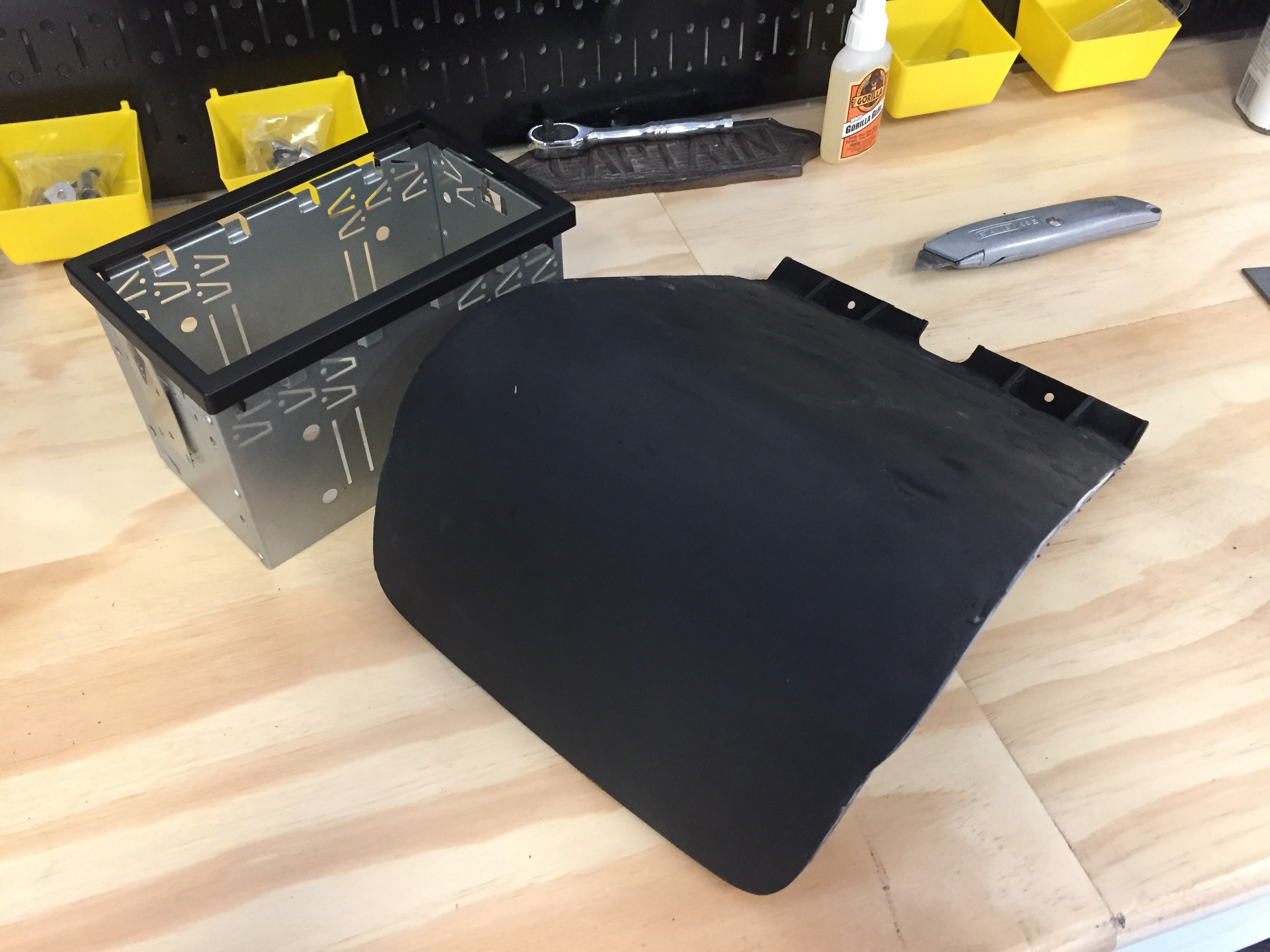

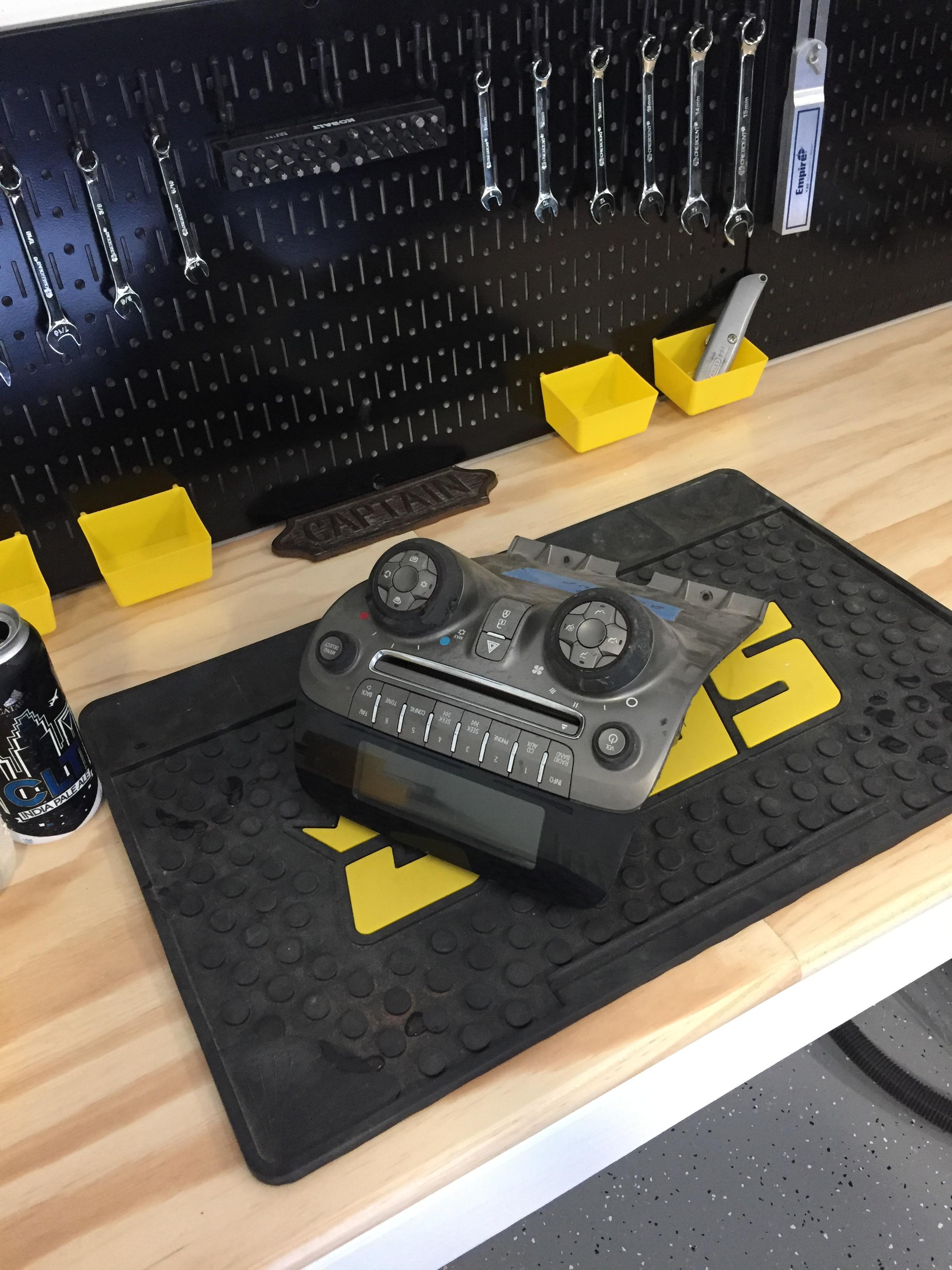

      I have also been trying to figure out what I'd do with the audio and A/C controls, I hate all of the aftermarket double din options for the 5th gen Camaro and since the factory controls won't be used, I decided to purchase a factory piece online, cut it down and modify it to suit my needs, It is still not complete but you can see what it may look like when wrapped or painted.

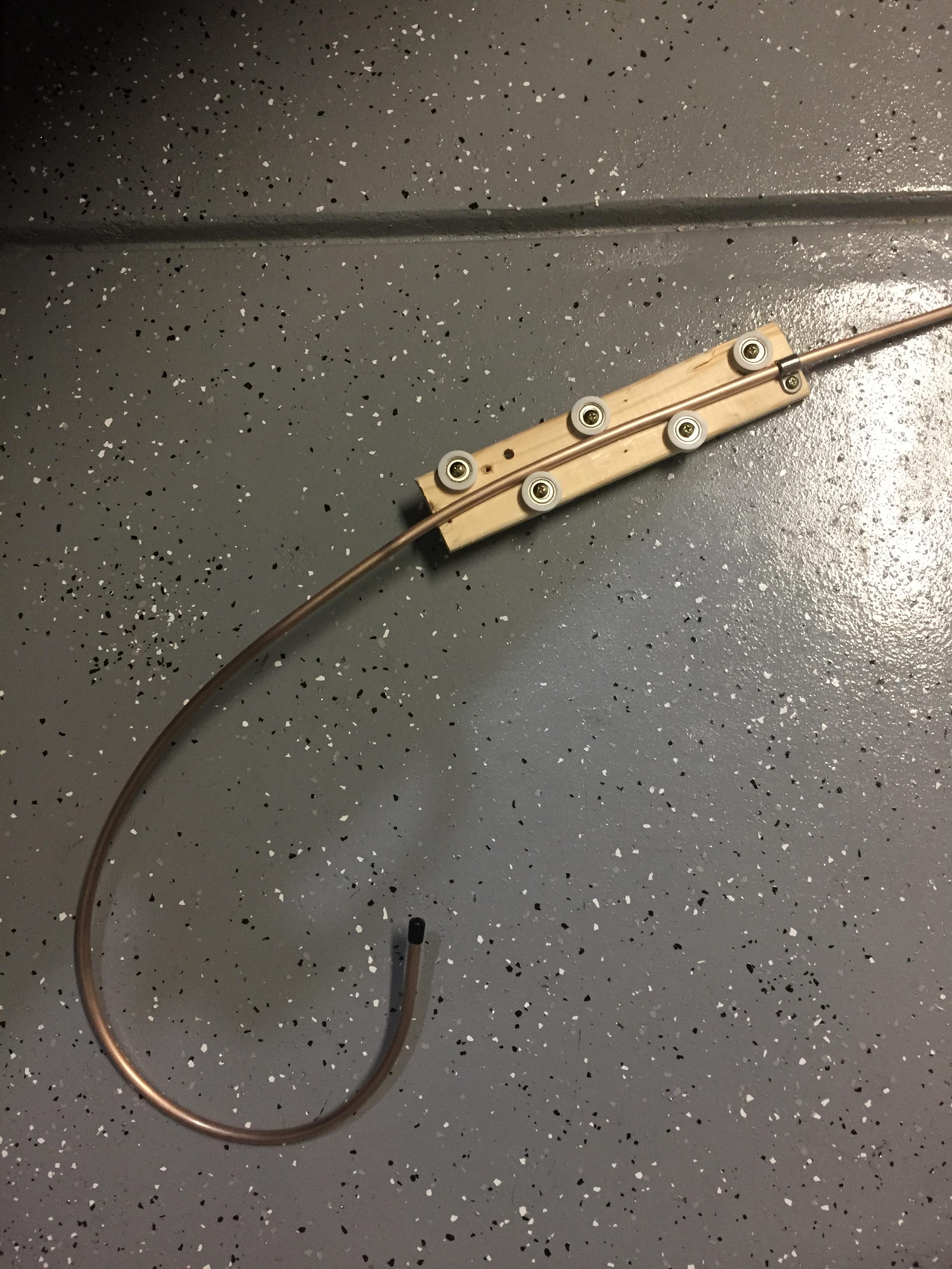

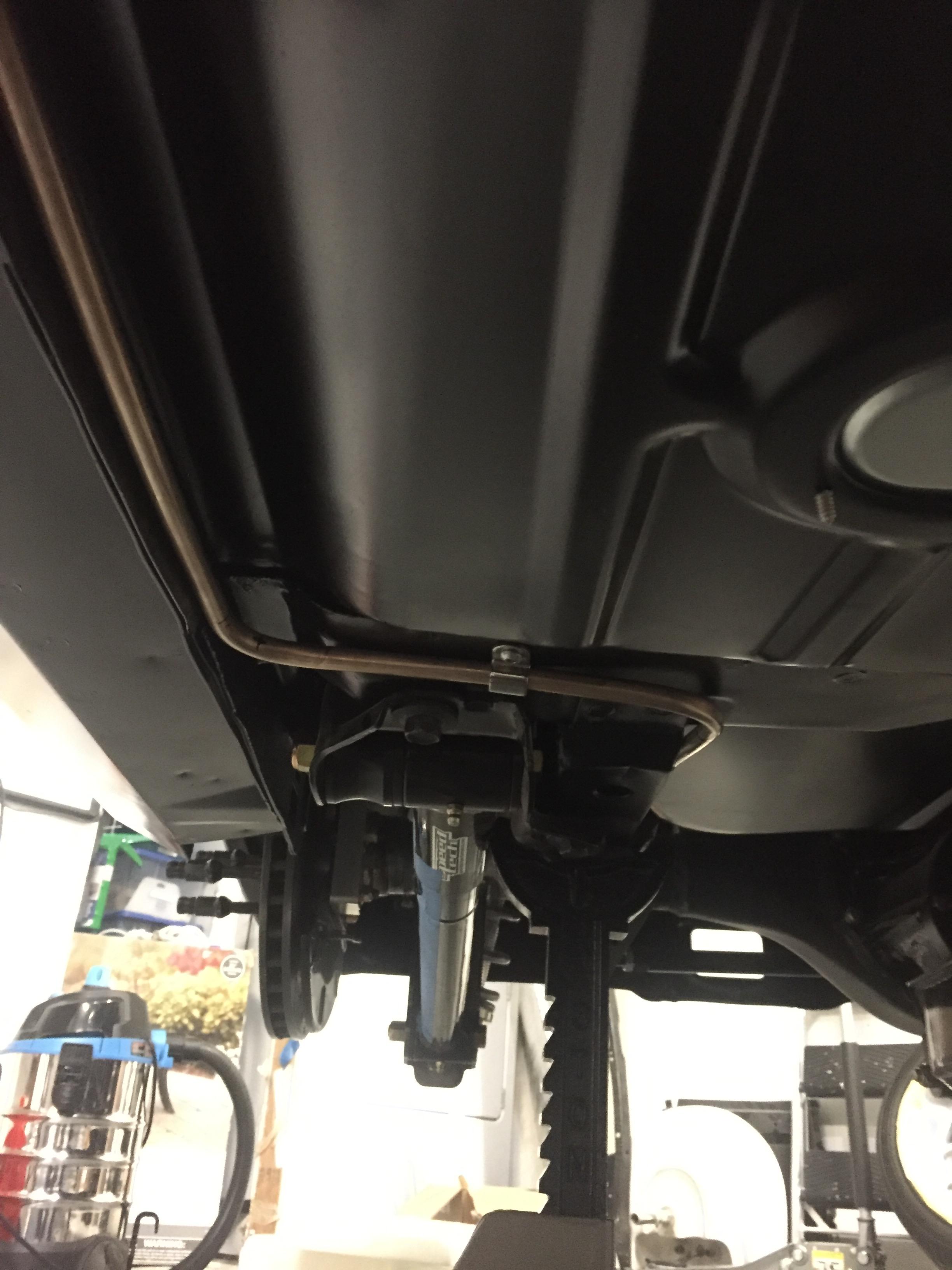

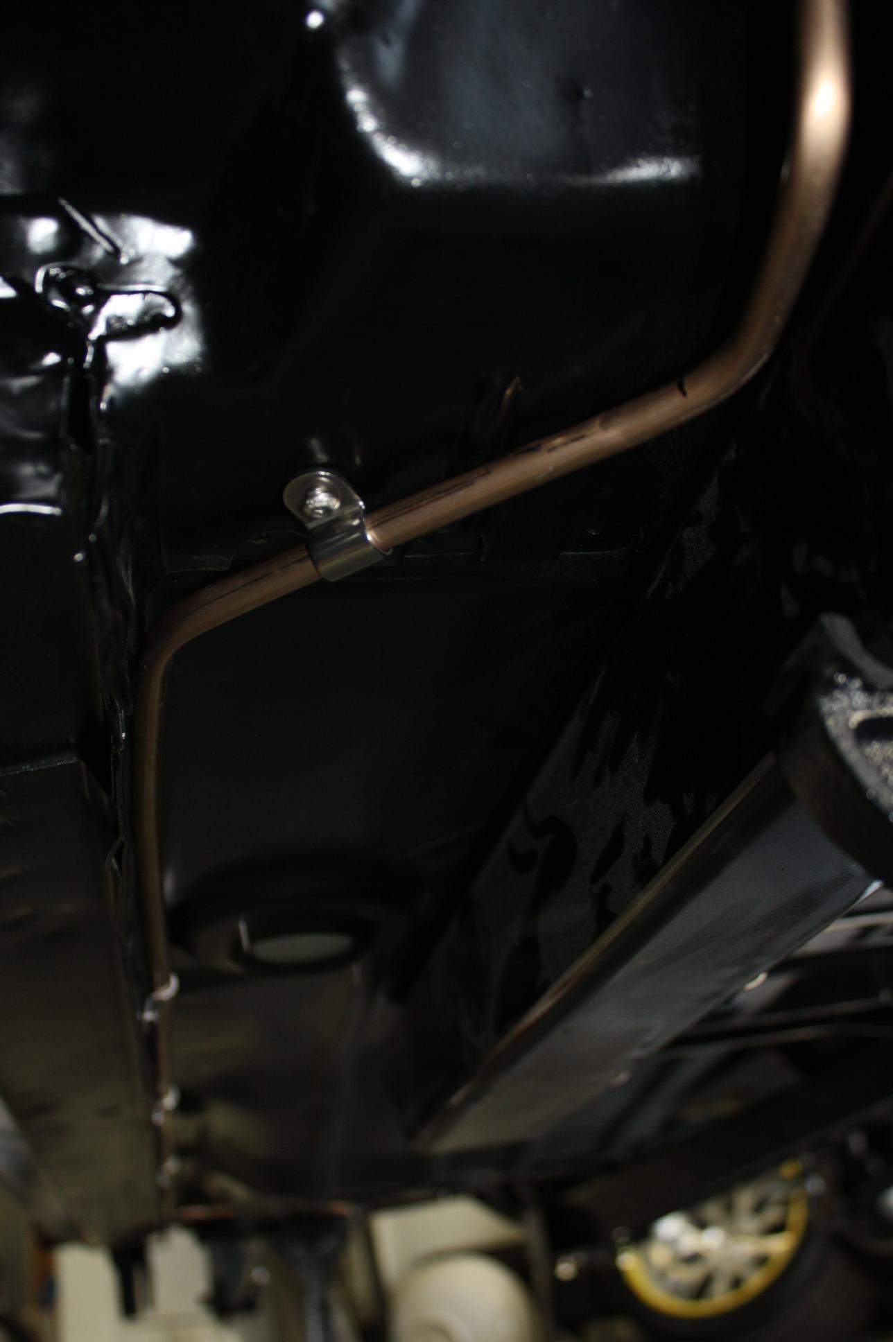

      I also am using this chance to start my fuel lines(brake lines will follow shortly after). I researched like crazy on the forums, NiCopp seemed the best option by far and seemed like a neat skill to learn, so after some practicing prior and making a $7 tube straightener I got to work and have mostly completed the fuel line, I will post better pictures when it is 100% but I wanted to post what I have. You can see I have it running behind the pinch welds then in the front it comes up between the subframe and firewall to be mostly hidden, in the back it travels on the inside or the suspension then over the axle. The stainless tabs will be spaced to almost exactly 12" apart and one complete I will use heat shrink at every tab.
      As for the line ends, I will hold off until I know exactly what is needed to run to the flex hose.

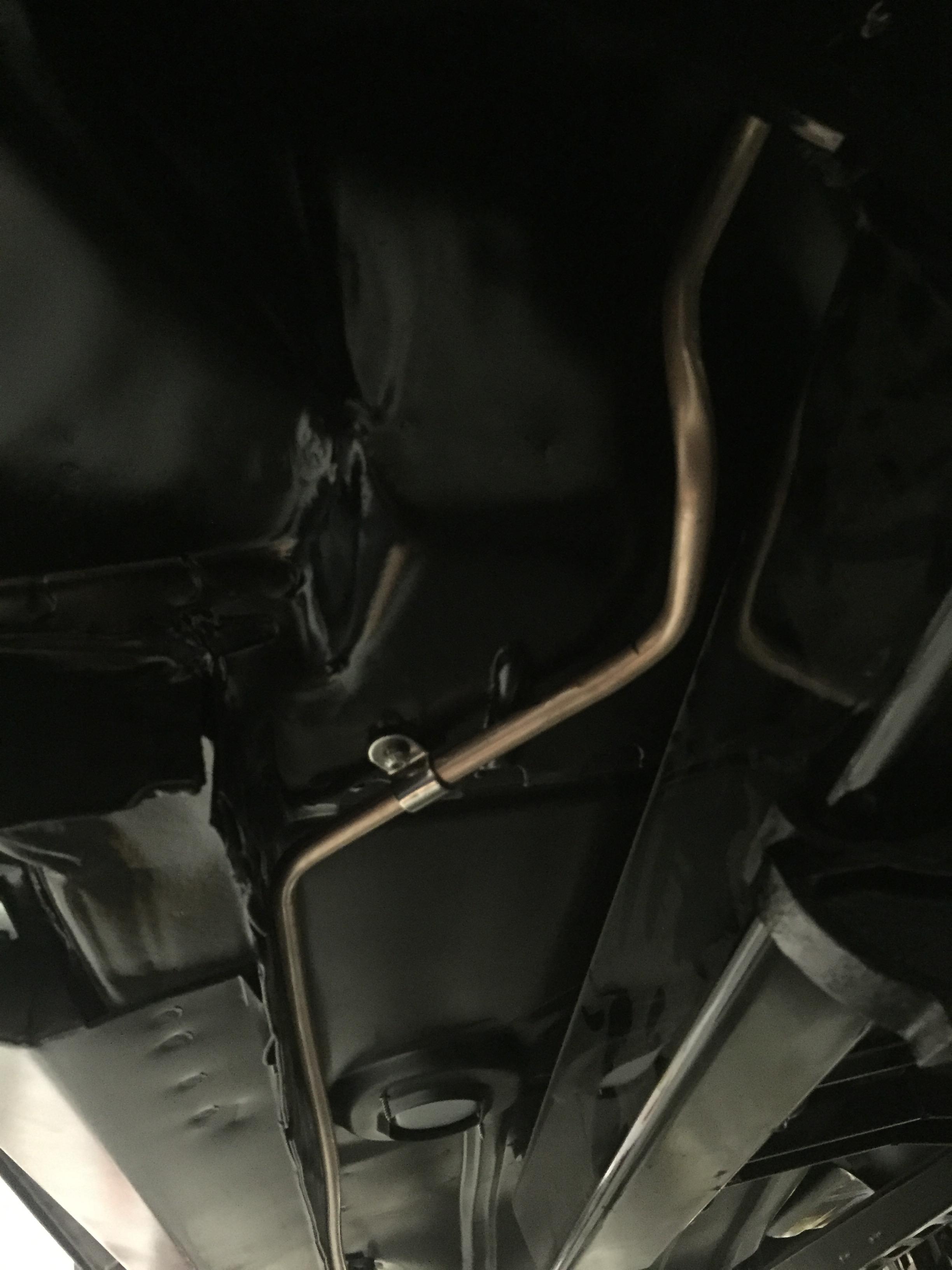

      A better shot of the fuel line and stainless clamps I chose looking down the car

      Nice work with the lines. Keep up the good work.

      Thanks, I finished up the fuel line today(without ends) and the 5/16" NiCopp should arrive tomorrow for the brake lines

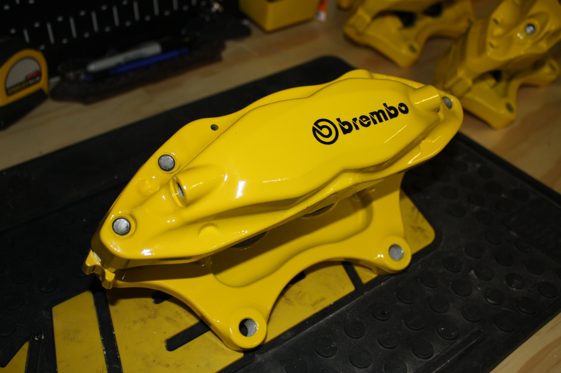

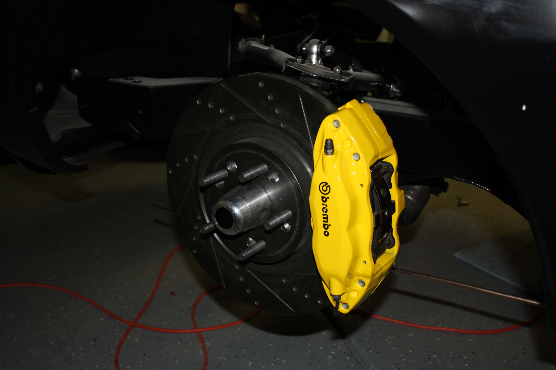

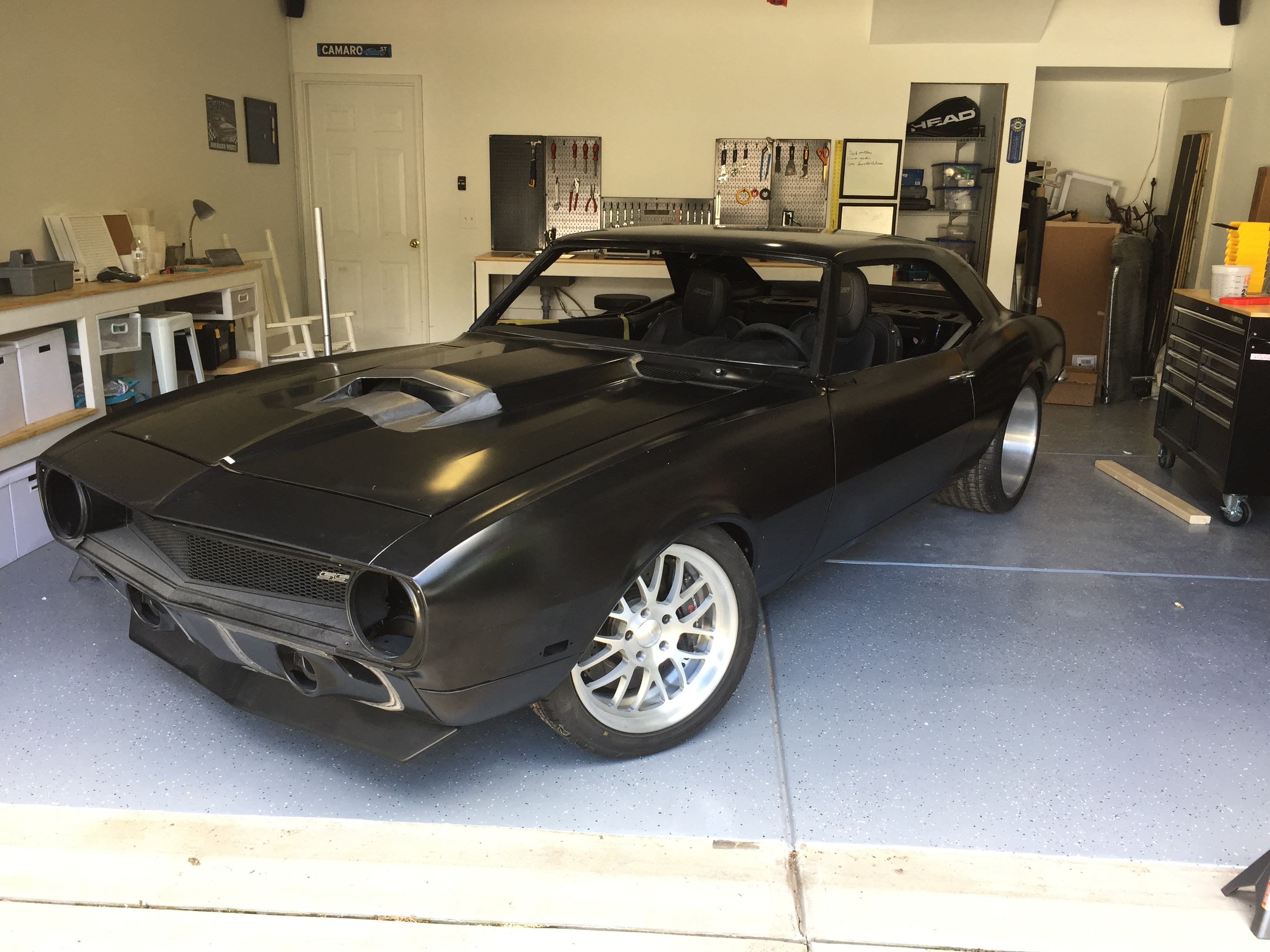

      I just got my calipers back from powder, I went with a hot yellow, a little bit Lambo style lol, I feel it's a necessary touch to break up the silver and black the car will end up in. I also got the Brembo logo offset from center, In my head I imagined them much smaller and I don't like them as much as I thought, but oh well, It's too late now and it's not very noticeable once mounted.
      The brake lines are also plumbed on the LHS but like the fuel lines on the RHS, neither end is complete as some crucial items are still missing before I finish it.

      Those brakes look awesome and love that you didn't go with red! That yellow really pops. Might need to look at something like that when my C5 brakes aren't enough.

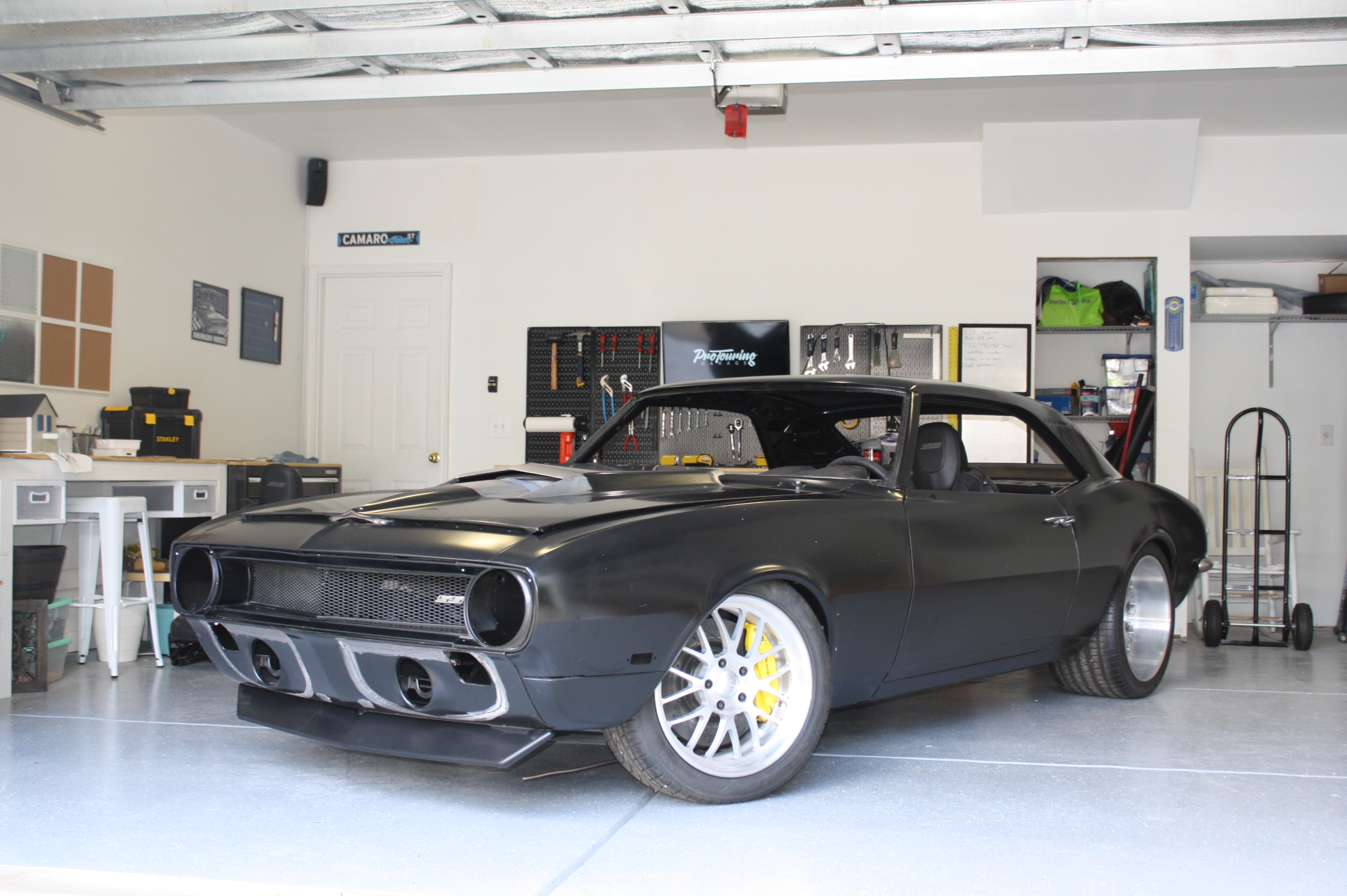

      I like the front grill. Where is that mesh from?

      straight from eBay
