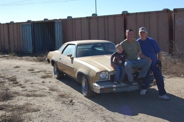

      I love your project. We need to get more of these forgotten A-Bodies on here. Keep in mind that these are hard to find replacement parts for but OPGI is getting better at getting us some stuff.
      I feel your attachment after owning a forgotten project for so long. I came home from the hospital in mine, my dad bought it brand new and my son thinks it is ugly. Go figure.
      Name:  73 Chevelle.jpg
      1973 Chevelle SS in the family since 73'

      Thanks for the message. Give your son time and I bet his feelings will change. Thanks for the OPGI tip.
