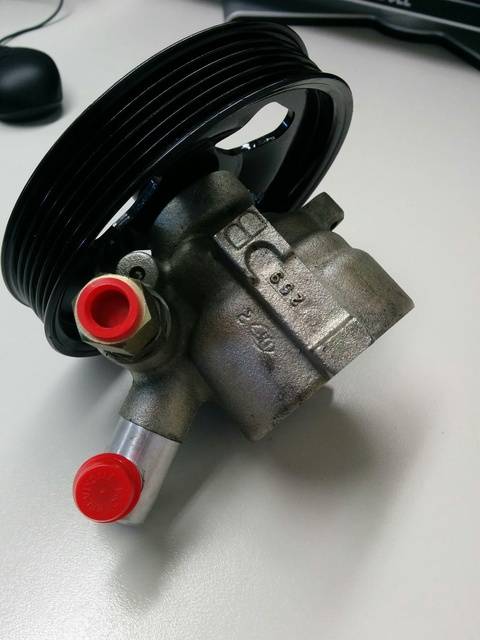

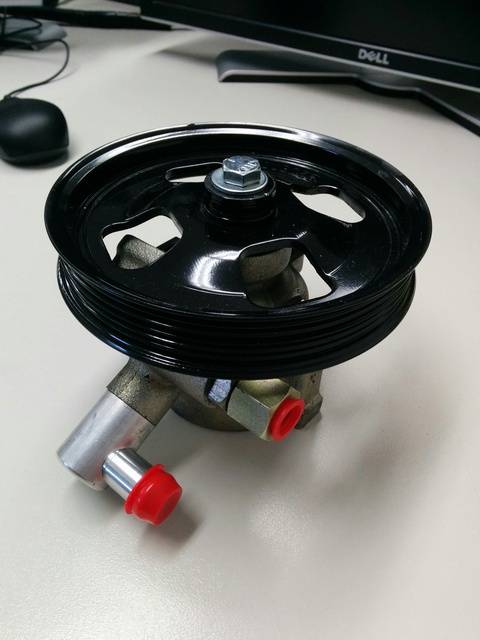

      Ok, since I'm so far into this project, I just ordered a new factory GM reservoir and feed hose to the pump. I just need to measure my pulley diameter and I will order a remanufactured Ford CB pump converted to suit a GM like this which supposedly is a more robust unit than the GM one.
      At least if it still ends up being the rack, it'll all be sorted and new and capable of whatever I want to throw at it.

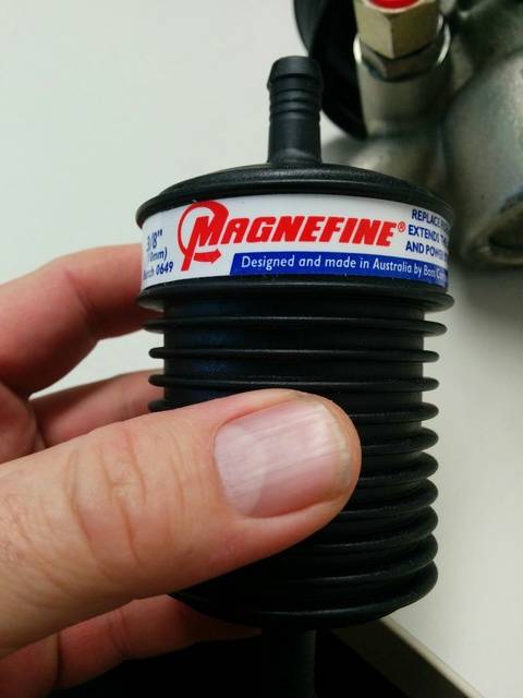

      Included this magnetic filter as well:
      Clayton

      So, Nick and I changed the pump, reservoir and the feed hose to the pump. Also changed the low pressure line and the high pressure connection to the rack.
      The good news is, power assistance has returned to expected levels. Then this happened:
      However, as the video indicates, the new pump is noisy as ****! It is ever so slightly bigger than the old one and just touches the Lexus ECU box which is probably contributing to the volume of noise. But, can drive with a bit more confidence now at least!

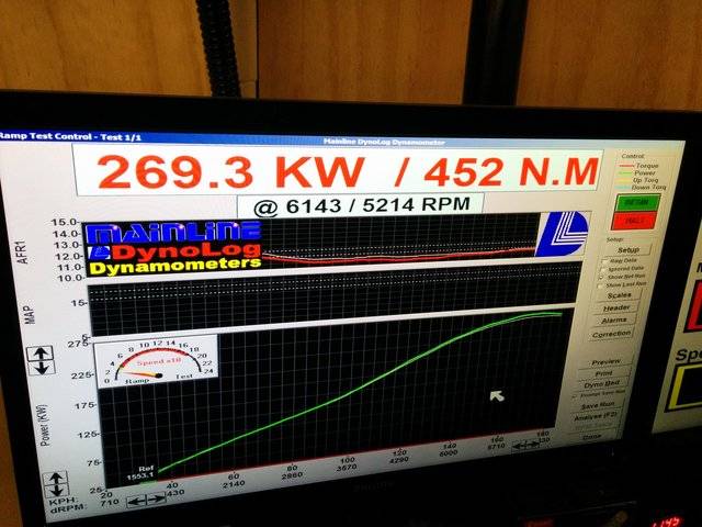

      Just about to hit the dyno for a baseline run.
      And then:
      Video:
      Sorry for the ****ty phone vid, but you'll get the idea

      Power steering pump is still noisy. Tried a treatment in it but that made no difference, nor was a I really expecting it too. I reckon for some reason I am getting air in the fluid still or some cavitation in the pump.

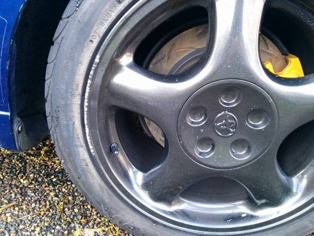

      Sometimes you go back and forth about whether to make a change. Like changing the wheels back to silver and the brake calipers to black. And then sometimes, on the first day she drives it, your wife helps make the decision for you.....
      And then when giving it a clean, the well known wheel cleaner you use stains your calipers and makes them more of an orange colour.
      And just like that, the decisions become easy!

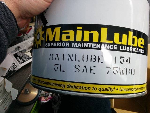

      So a couple of things that are ****ting me. There is a lot of general gear noise from the box and the shift is a bit ****, especially 2nd > 3rd at high revs. I hadn't done an oil change before I put it in, so I did a bit of research and apparently this is meant to be the **** for a T56:
      Not cheap by any stretch especially once you add in the flushing solution and the rare earth magnetic drain plug they recommend. So hopefully it does make a significant difference.

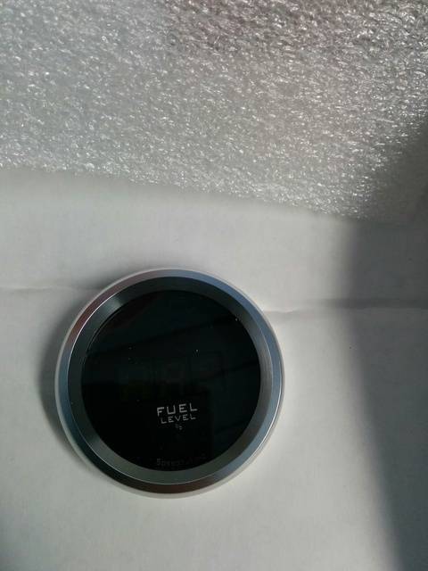

      One of the side effects of doing a conversion on an IS200 is that the fuel gauge goes down in 1/4 tank increments rather than smoothly. This is because the ECU drives the fuel gauge and it takes the intank float as well as injector pulse width measurements as inputs to output a reading to the gauge. You can't really easily tap into the signal to bypass the ECU stuff either because that is part of the multiplex from the ECU to the dash. So I bought a cheapish Speedhut digital gauge to stick somewhere and just use the float as the input. Hopefully that works.

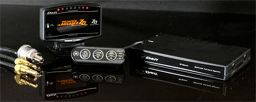

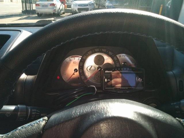

      Finally, I was looking at a way to properly monitor the oil pressure and temperature. Decent gauges were starting to get spendy and then I'd have to find a good way to mount them. So I ended up going with of these:
      It is a Defi Advance ZD and came in a Club Sport kit which included sensors for oil pressure, oil temp and water temp. Given the problems I had with fuel pressure, I added a fuel pressure sensor as well. Like all Defi gear, it is programmable with warning levels etc. This thing can also show speed, revs, shift light and has some built in lap timing and stuff. The display unit is actually pretty small. TO try and be a bit discreet, I'm mounting it on top of the steering column where it pretty much doesn't block any of the existing dash gauges but is still right in the line of sight.
      I just need to install all of the sensors and then get Nick back around for some more wiring duties!
