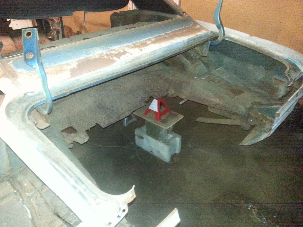

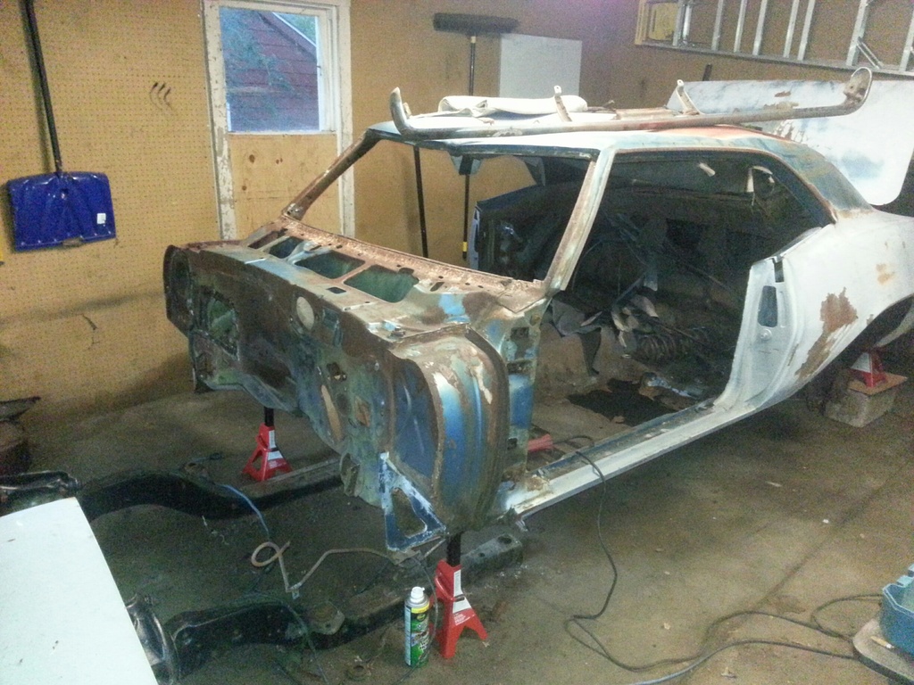

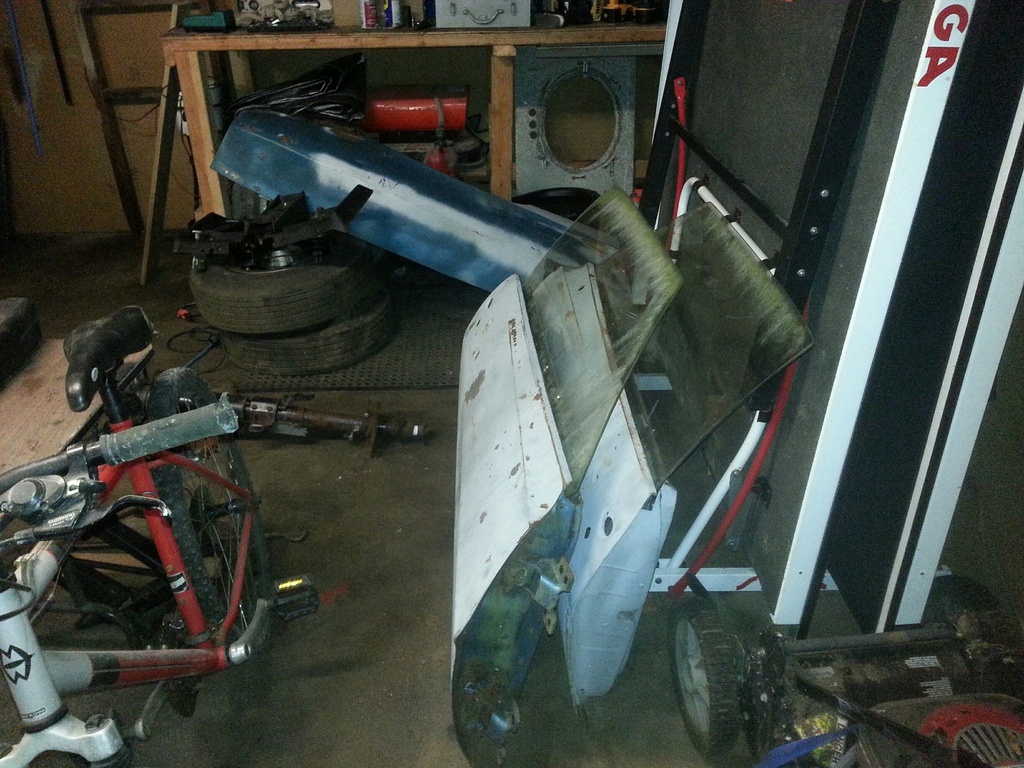

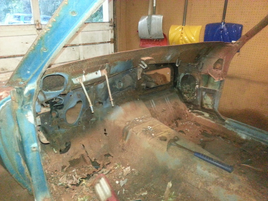

      Hey Folks, sorry for the wait! Been much to busy! Here are the photos, hopefully you can see them now.

      Meh. I have seen worse starting points
      Welcome to the site, looking forward to seeing your build progress!!
      Jeff
      Aug 2008
      Iowa
      304
      It's just like eating an elephant, one bite at a time. Break it down into phases so you can have those small moral victories and stay motivated. Good luck and I look forward to your progress!
      5,560
      There they are ! I've used that blue handled auto body tool on the transmission tunnel too. Keep them coming!

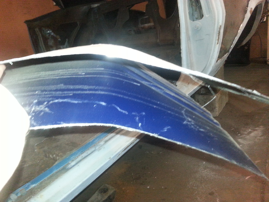

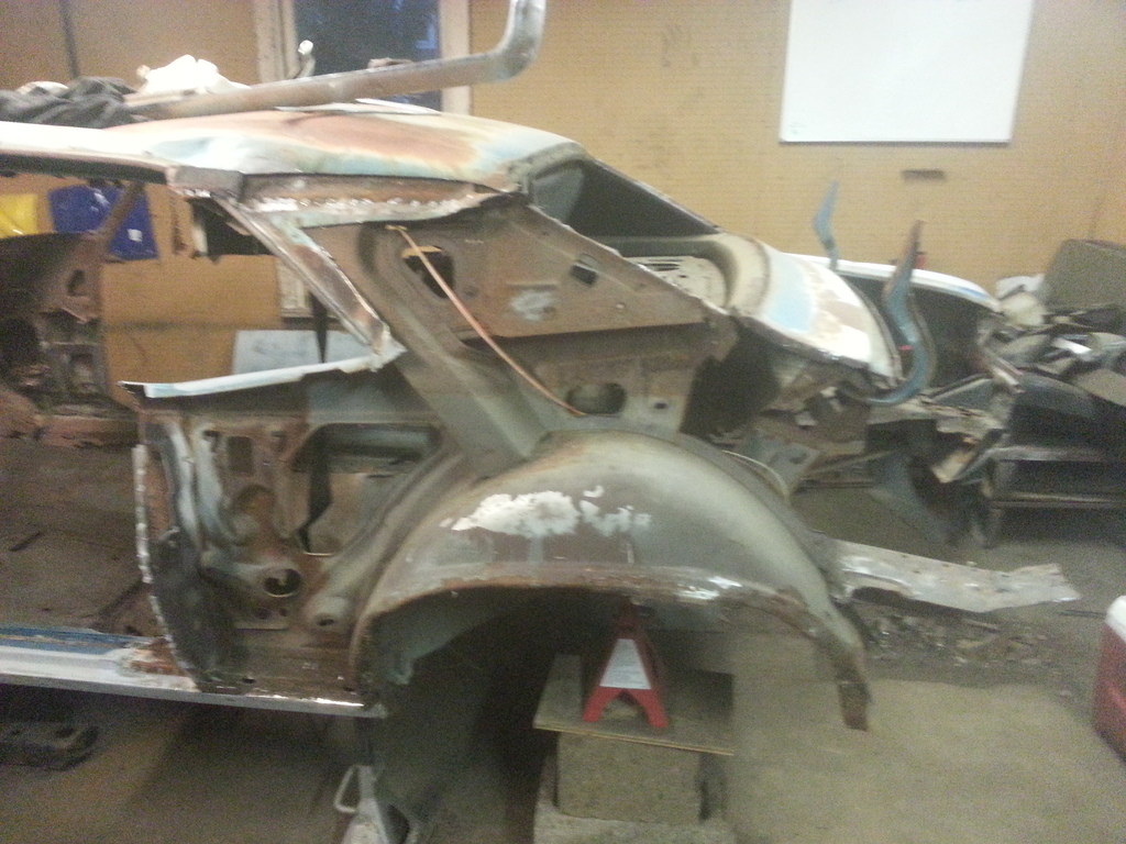

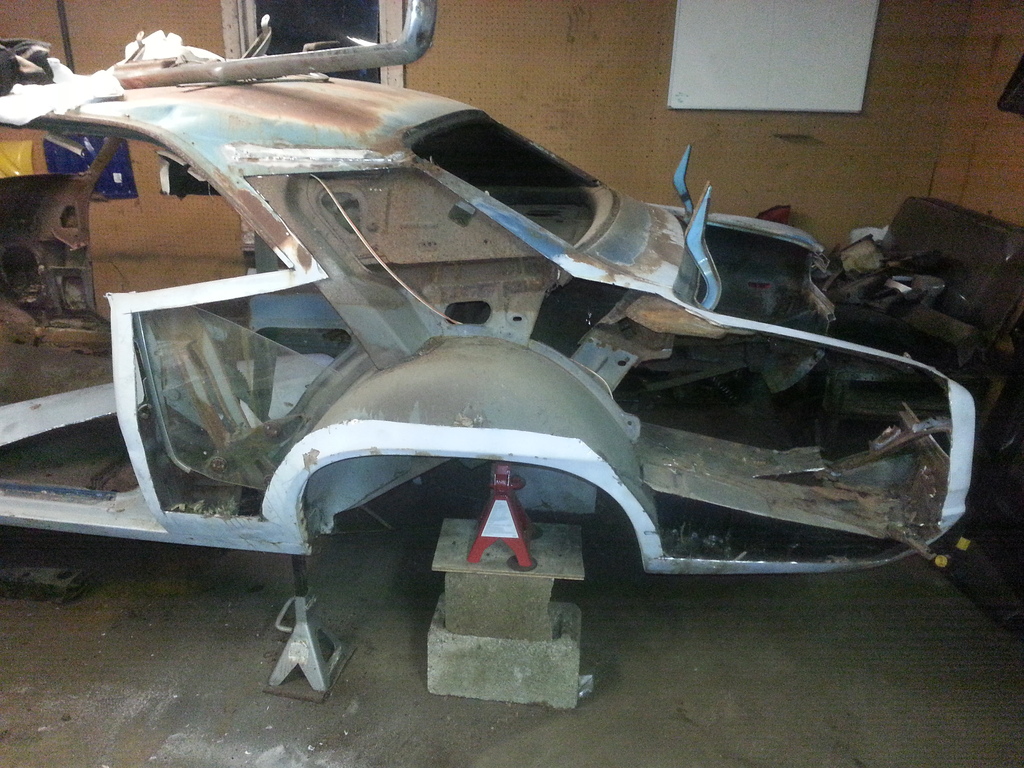

      Hey everyone,
      Been doing some more disassembly. Rough cuts in trunk and driver rear quarter to get at seams better. I am somewhat limited on tool selection...looking to pick up a large air compressor and some air tools soon. Been doing all the cutting with an electric die grinder. One thing of interest...when I cut out the rear quarter, I noticed there was two layers...so it has been skinned at one point in its life. I already picked up a new trunk pan...next on list is new quarters, roof, and tail panel. I plan to tackle floor pan when those are done.
      Pics!

      Looks great! The worst part is getting all those spot welds drilled out.
      One word of note: As you disassemble, I would recommend some form of support on the body. I put a bunch in my car as I did this, I have yet to find out if it works, but it starts to get loose the more body panels you take out. I put it at a point to keep the body from compressing on itself, so it doesnt have to be anything super structural. Door jambs are one spot, i also put one from the dash to the back tray.
      Just a thought, keep up the progress!
      Jeff

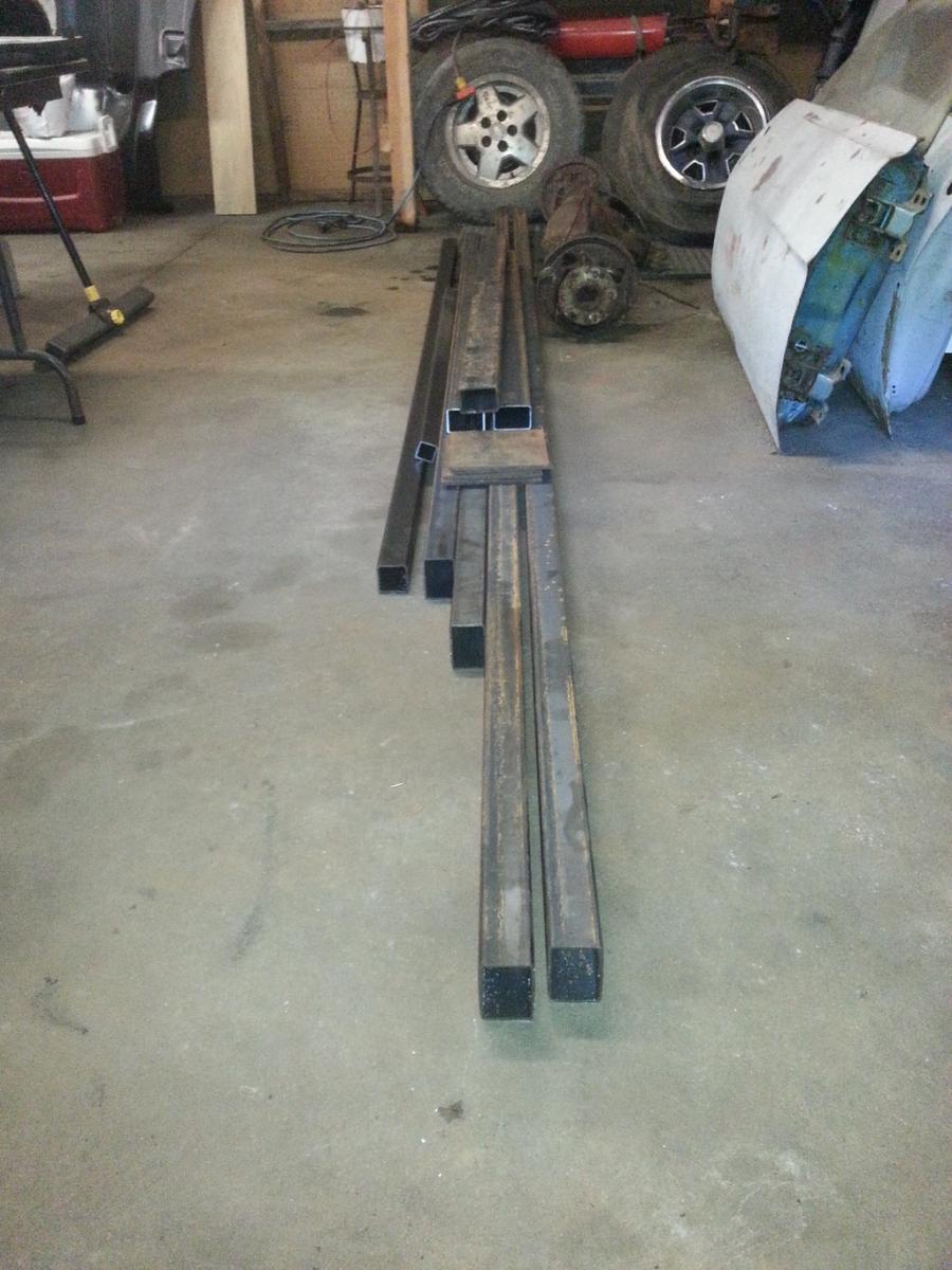

      With that said...I present to you the beginnings of the body jig!

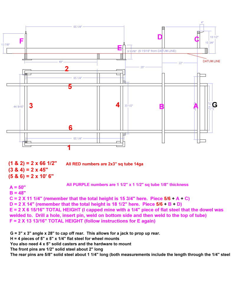

      Took this picture yesterday...since then I've done some cutting and prepping of the base structure. I am roughly following these plans: Name:  bodycart_measurements_zpsza7ucznl.jpg
      Courtesy from the folks at the camaros.net forum at this link: http://www.camaros.net/forums/showthread.php?t=163374
      I will be making a few modifications to this jig per Page 5 (post 61) of that link. I like moving the rear casters further towards the back to increase stability. As a side note, I would like to thank the folks at that forum for providing that information! Also, I have cross-referenced and double checked all measurements to the original Fisher Body Manual for a 1969 Camaro. Everything seems to be in check.
      I believe I'll have the jig welded up within the next 2 weeks. I will try to get pictures as I can. Looking forward to dropping the body onto the jig! My plan of attack after this will be floor pan, then fixing the very rear of frame rails (leaf spring mounts rotted), then trunk pan.

      I would recommend that you don't cut out any more of the body structure until you can get it properly supported to avoid distortion. Do you have a welder? If not take a look at some of the 110v MIG welders from Eastwood. Just make sure what ever MIG you buy can use shielding gas.
