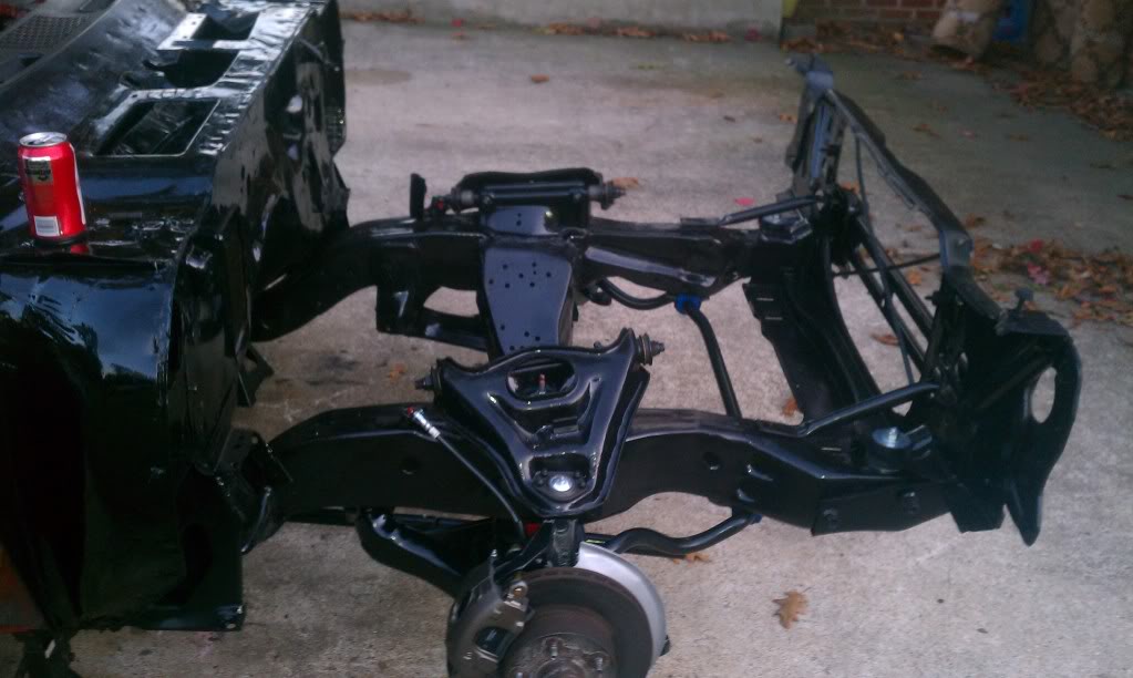

      Jun 2015
      Carlsbad
      87
      Actually just realized that there is no supports up front once the subframe is gone. Not sure why I was thinking the older fbodies was tied in another way. Looks like I will have to pull the front cap off no matter what since there will be nothing there to support it. Guess its option B then
      Cheers
      Dustin

      Jun 2015
      Carlsbad
      87
      After seeing some pictures like this one It seems like the fender/nose wouldnt have any support, only where they tie into the door area. Unless there's some trick to doing this.

      Dec 2010
      Fredericksburg, VA.
      3,164
      I did not remove the front clip (fenders, radiator support, grill and hood) when I replaced my subframe on Dust Off. As long as you are not using the radiator support on the 1st gen F-body to lift the car to remove the subframe the fenders will support themselves just fine. The best method is to use a two post lift and raise the body up off the subframe.

      Jun 2015
      Carlsbad
      87
      Quote Originally Posted by TheJDMan View Post
      Thanks, Good to know. So you didn't need to put any jackstands under the front clip to help support it so it wouldnt bend/warp without the subframe being in there?

      Dec 2010
      Fredericksburg, VA.
      3,164
      Quote Originally Posted by ddavisart View Post
      Nope! No jack stands necessary under the front clip, when the subframe is removed there is really not much weight up front. Remove items like the radiator and battery to reduce the weight as much as possible.

      Feb 2011
      dallas, tx
      1,731
      lift the front of the car slightly, sit on jack stands, use dollies like the blue car above under the subframe, Take out the core support bolts, then the front body bolts and take off the rear bolts, subframe will drop. With the weight off the car lift up the front of the car more and readjust the jack stands higher. Take the wheels of the subframe and roll it out from the dollies
