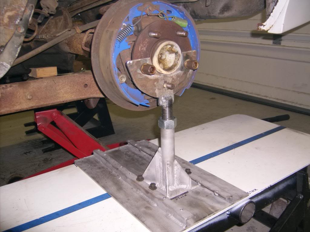

      brackets made to locate rear axle

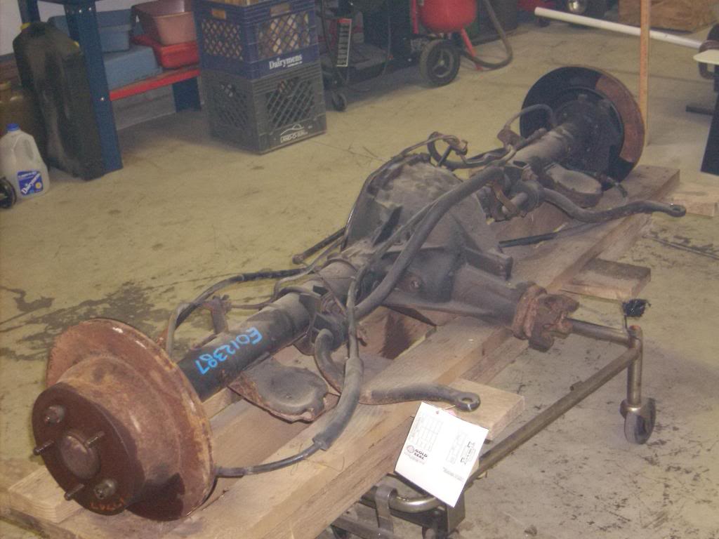

      ZR2 rear axle 8.6 chevy truck axle with 3.72 gears and a gov-loc posi, disc brakes and 30 spline axles.
      comparison to stock 7.5 axle
