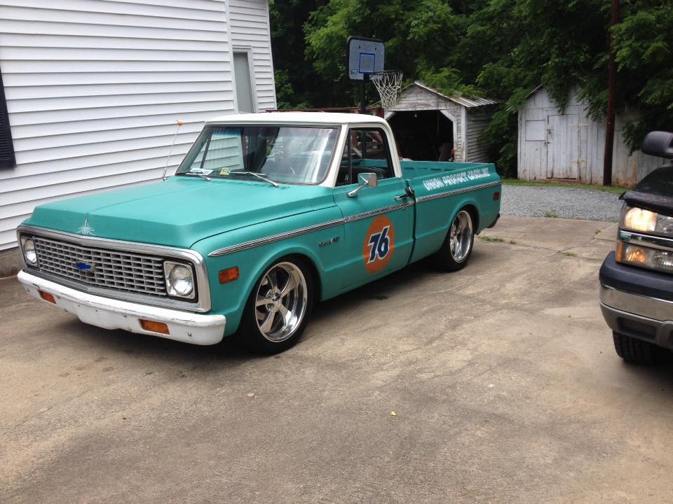

      I have a 72 Chevrolet C-10 truck low rider, it has a 2004 Chevy LS motor in her and they took off the fuel injection and replaced it with a Edlebrock Carb. When she heats up to running temp and you cut it off it won't crank back until it cools off.
      My friend is a drag racer and he suggested using a clothes pin and place it just before the fuel filter on the rubber fuel line and this should stop it from not cranking or running. He thinks it is causeing a vapor lock.
      Please help with any ideas or suggestions

      Nice looking truck. Shame they removed the fuel injection. The stock LS truck intakes flow very well.
      First make sure your fuel pressure is correct. Edelbrock recommends 5.5 to 6psi at idle.
      Next check the fuel line routing. Make sure it's away from sources of heat (headers, cylinderheads, EGR components, Coolant delivery components, etc.). There are also thermal wraps available, that you could put over the lines.
