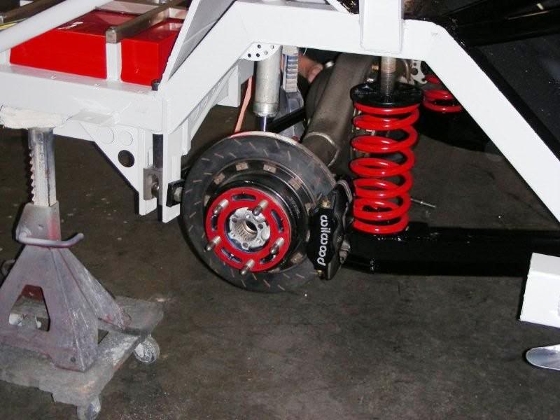

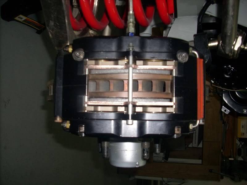

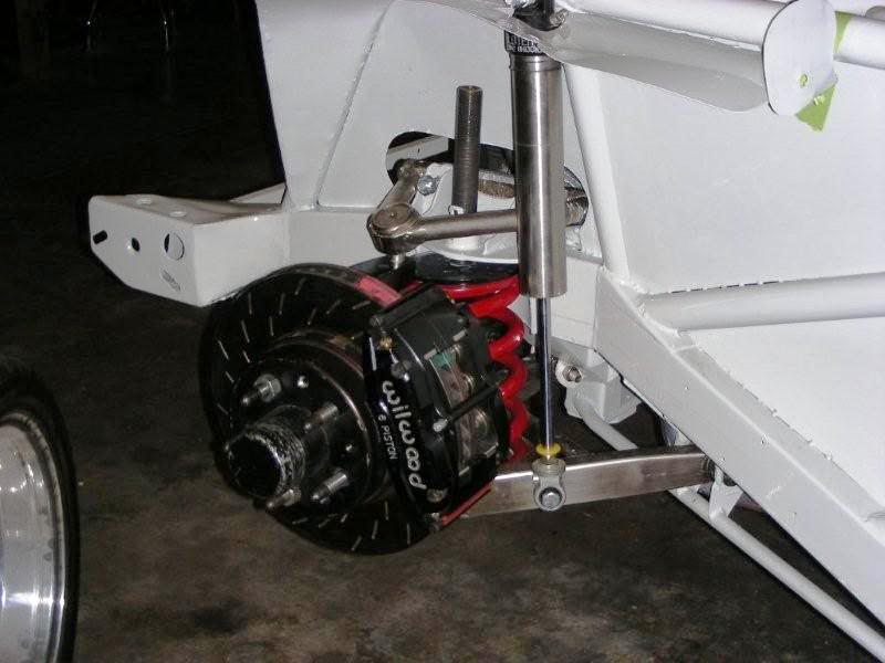

      My brakes are exactly what is run on the cup cars. As my chassis is all cup car, I had the Billet Wheels made custom with the 5 on 5 bolt pattern. Was one of the few sets of "new" wheels that would allow such a large center hub to go through the wheel center.
      You said it - the rotors are "wide"!!
      Here are a few pics of my brake setup:

      Nice pics of the brakes - another question what is the front lower control arm made out of? The ones I saw at the hall looked like they may have been aluminum.
      The Lower Control Arms are actually steel units that have been nickel plated. I sent a variety of parts off to Charlotte Plating to get plated. The finished color/hue varies from part to part. All of the NASCAR teams do this to key strength parts for the main reason that they can see any structural defects through the plating rather than paint that can hide a potential problem. The plating process was amazingly affordable. Example - entire rear end - $50, control arms - $25 each, etc., etc.. The plating is pretty durable but will chip if abused. Really not a big deal....if the part gets that bad after time I can always replate em'.
