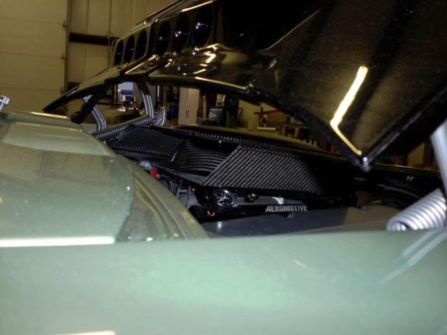

      The hood is my stock 67 SS that we customized. We extended the height making it closer in dimension to a Cowl Induction hood and laid in the gauge pods along the back side using plain ol' muffler tube.
      The funny thing is we have only about $25 in total materials in the custom hood but over 100 hours of work into it!!
      The gauges are your "old standards": oil pressure; water temp; fuel pressure; oil temp; volts; and one unused boost gauge.

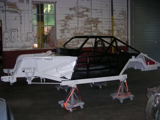

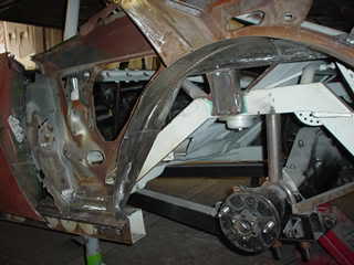

      Maybe I missed it, but how is the body attached to the frame? Pics would be nice, .
    3. #263
      394
      Quote Originally Posted by MarkM66 View Post
      Page 3 & 4 of the thread go into detail how we connected the chassis to the frame.
      In a nutshell, there is a "sub-structure" frame welded to the Body that provides support and mount points.
      The Chassis has gussetts in various key structural areas (rocker, axle, trunk) that bolt to the Body framework.
      Also we used the first 1' of the Camaro Subframe welded to the Cup Chassis to install the Camaro Rad Support.
      Here are some quick shots showing the mount points:
      You can just see the Body "Frame" coming up from the rocker and around the inner wheel house:
      You can see the Chassis mounts at the front frame rails, frame rocker area and over the rear axle area:

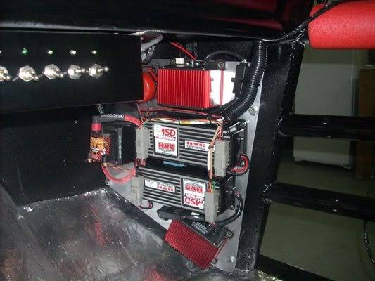

      So the Camaro is almost done. So, so close. The car was just delivered to the upholstery shop this week. The gentleman doing the interior is a seasoned veteran whose completed street rods consistently win awards at the top shows. I am not looking to be in any car shows and my interior is a no frills, all business approach. Simple and purposeful – no bells and whistles, just plain black all around. I am very excited to see the results. Scheduled to be done in 2-3 weeks.
      Before the current position at the upholstery shop, we have been aggressively knocking off all the to-do items form the punch list. Started at over 200 items several months ago. We are now under 25. All of the interior wiring, window tracks power windows assemblies, electric door poppers & switches, interior lighting, weather stripping, re-chromed vent window frames & glass install have been complete. Once back from the upholstery shop the only thing needed to be done on the inside is the plumbing and install of the fire system and install of the safety harnesses.

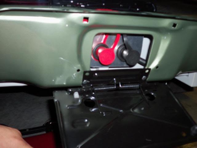

      The entire hood gauge wiring and plumbing is done and functional as well as the rest of the smaller electrical items on the list. One cool feature is that we fabricated electrical posts behind the license plate frame so if the batteries ever go dead we can boost the system from outside the car. We needed to do this as we have door and trunk popper systems. We went with a 1969 Camaro license plate frame that hinges down to access the posts. The carbon fiber air cleaner has been modified, cleared and installed. We had extra spoiler support braces and used them to lock down the radiator.

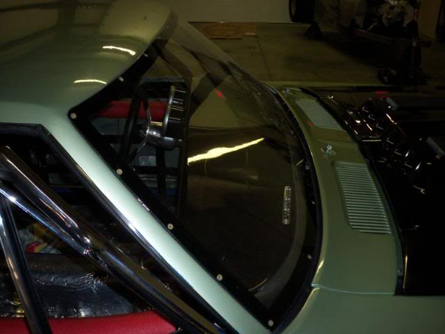

      My builder and I set a date of February 1st to knock off the remaining punch list items once the car is back from upholstery. We are going to re-do the front Lexan with a thicker and longer piece that goes deeper into the cowl and will look better. Also re-doing the hood pins so the cables come out of the hood plate rather than having all that slacked cable bouncing around the nose of the car. Still need to do the rear spoiler install, front spoiler support brackets, front anti roll bar, horn install and a host of other small tasks. After February 1st, the car needs to go back my body guy for several small touch ups and to be fully buffed and polished. Hope to be doing road tests and shake downs in early March.
