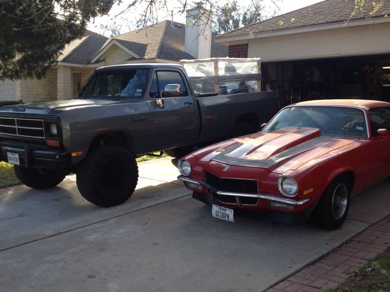

      Hey everybody been reading through the forum for a long time but I just registered, lots of great information. My father and I picked up our 70 Camaro out of an old movie theatre in a small Texas town about 8 years ago. Car was a 307, 3 speed car that was in decent shape with no rust. Other than the interior being completely shot, the car was pretty close to being too good to be true. Over the years this has been the car that has taught me most of the basic garage mechanic skills i have today. Since buying the car 8 years ago we have had a few different motors (two 383 stokers). Recently we dropped a very well built 377 de-stroker with trickflow heads and a Holley 750 cfm carb. We are running the same muncie 4 speed we have had since we pulled the 3 speed out. I have some free time and money now and would like to start working on the car again and today bought a 3.73 posi 12 bolt rear end with disk brakes on each side, hopefully i can throw it in with no problems. Since I'm going to be tearing into the rear suspension i was thinking about upgrading. What are Yall's suggestions? I want to run a 315/35R/17 with 7 1/2 inch back spacing and am hoping i won't have to mini-tub the car or relocate the leaf springs. Will add pics tomorrow and thank you guys for all of the help.
      Before some decent paint ^
