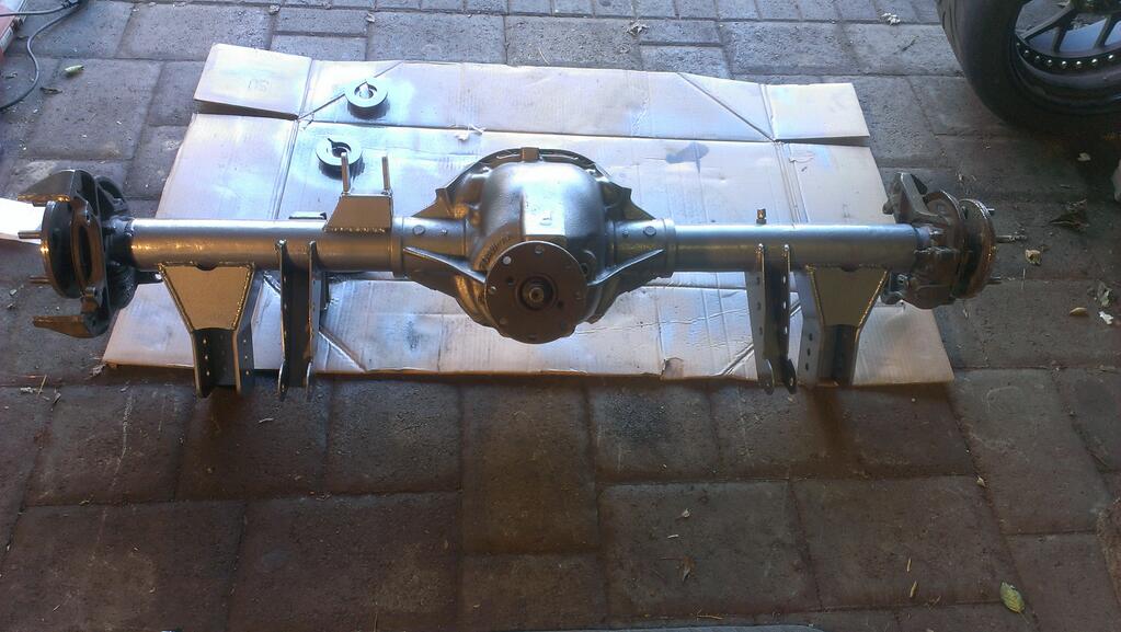

      It looks like if you offset the upper link you'd have room. I did it and I couldn't be happier.
      My 3 link thread is here: http://community.ratsun.net/topic/58...gets-a-3-link/Name:  19031467.jpg
