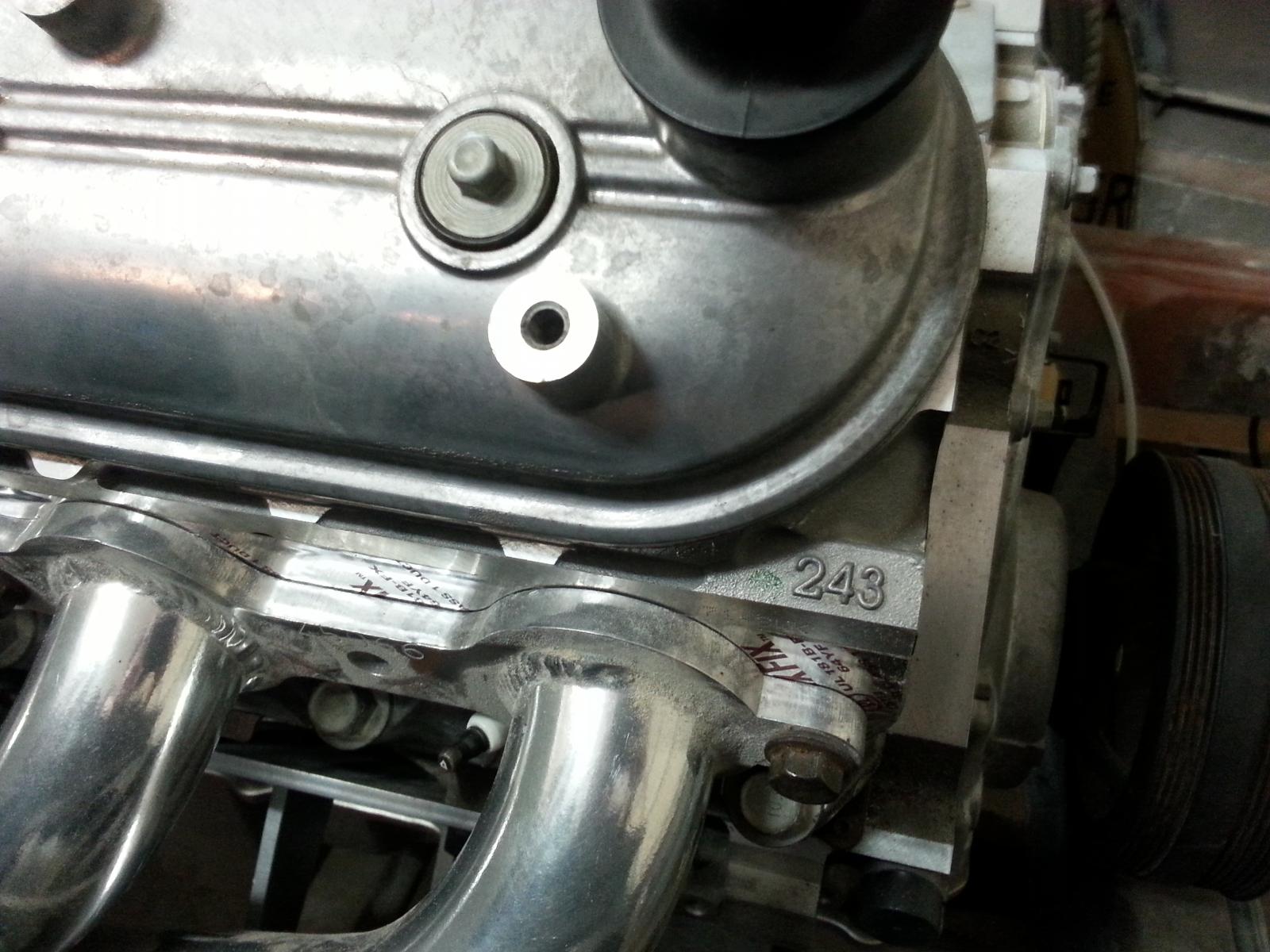

      Yes, I saw the donor Trailblazer with SS badges. Unfortunately I did not protect the ID tag on the transmission, it got rained on and sun beat. The cylinder heads have the 243 casting numbers with the yellow valve springs which I understand are on the SS Trailblazer.

      I hope it is what you say Revmax, that would be awesome. I would like to start breaking down the transmission but right now I'm in mockup stages, once mock up is complete I'll start on tearing down the trans. Now that there is a chance this is a 4L70E I will start looking into more backup info on it. Thanks Revmax.
