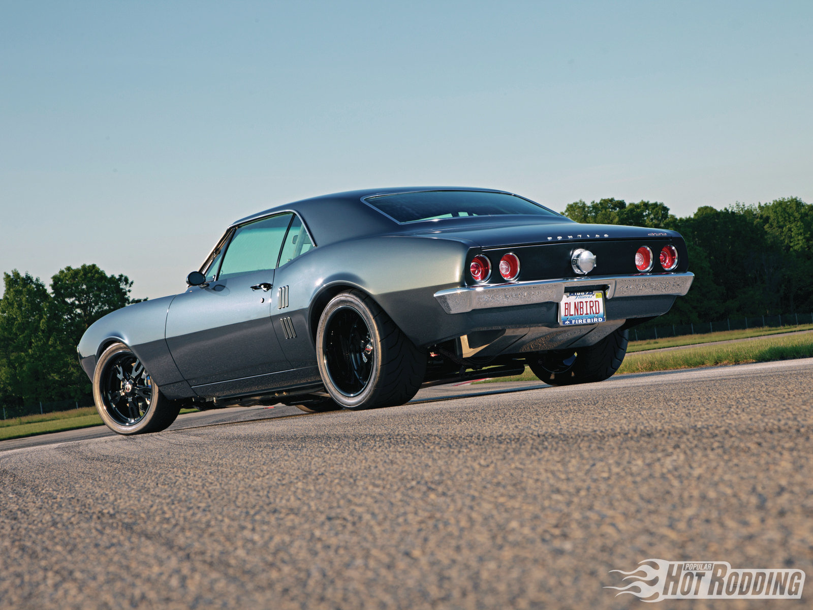

      Just about to order up my full ridetech Level 2 suspension package for my 1967 Pontiac Firebird. I am just wondering if people have any pictures of their cars equipped with this package. I have looked up plenty of ridetech cars, just wondering what the ride height the average consumer sets it at. Just don't want the stance to be too TOO low.
      I know the coil overs are adjustable, but will they affect the ride height at all?
      Lastly, I have a Pontiac 400ci with iron heads in it. Do I have to change the spring that I go with or will the coilovers be fine with that much weight? I know with the Hotchkis kits you can choose big block vs. small block springs.
      I have attached a picture of my car (black) and a picture of the stance I am looking to achieve with the RideTech system. Any comments/advice is appreciated.
      Thanks, Jake.
