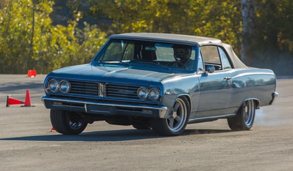

      Before embarking on any suspension or brake upgrades, I entered an autocross to get a baseline on how it performed. It handled like Noah's Arc.

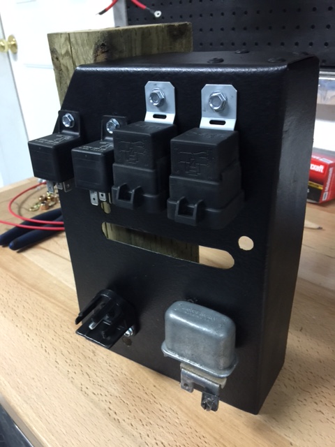

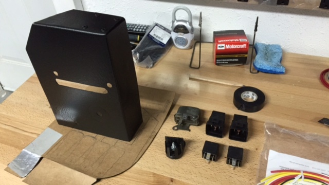

      I also updated the electrical system to MAD Electrical's New System, with a Ford Style starter solenoid and headlight relays, fan relays, starter relay. For anyone that has a factory wired 60's GM, you should look into what MAD Electical has to offer. Mark is a wealth of knowledge and his system is a great upgrade. http://www.madelectrical.com/
      After much consideration I ended up fabricating a panel to mount the relays on, that sits behind the drivers side headlight and is not visible (unless you poke your head in beside where the horn goes and look for it). I wont waste too much time talking about Mark's MAD Electrical NEW System, other than saying that it is great and I am 100% glad I did this. No more haet soaked starter leaving me stranded

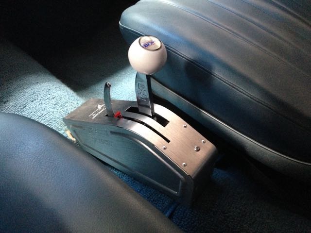

      I also updated the 70's B&M Quick Click to a more modern version of the same style shifter, went with a B&M Pro Ratchet, because I love the ratchet shifter and wanted keep it nostalgic.

      The Autocross went really well... The car handles so much better than it did with the stock 50 year old suspension. I had people coming up to me all day asking me if they could go for a ride in it. I didn't get the fastest time but I'm pretty sure I had the most fun, the other entries were a bunch of Subaru's, Mustangs and other FWD garbage. The old 15" wheels and BFG 225s helped make sure the crowd was entertained.
