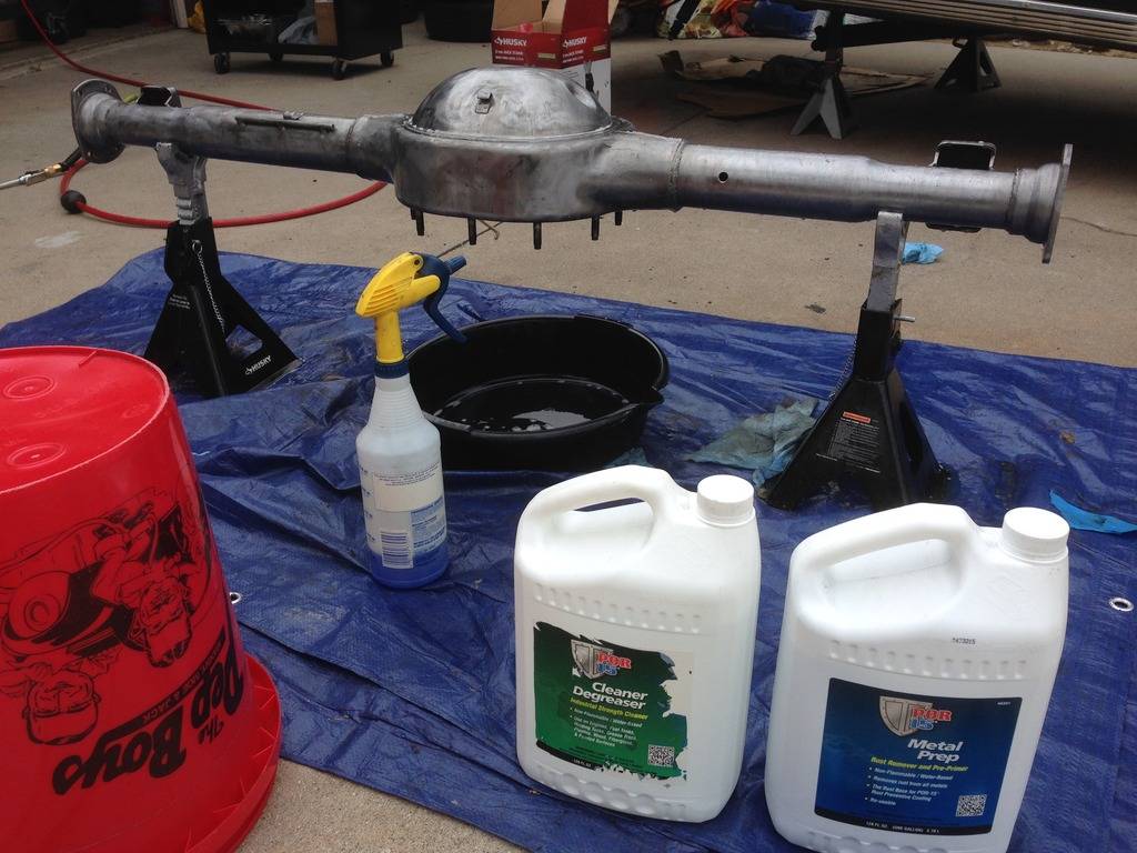

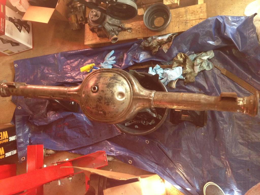

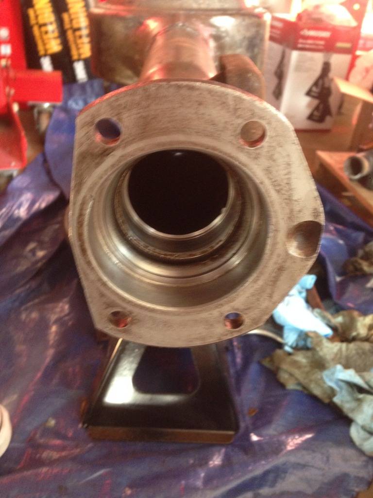

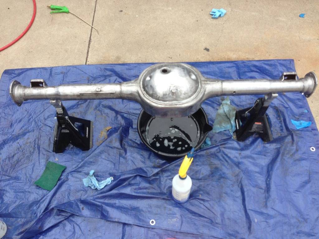

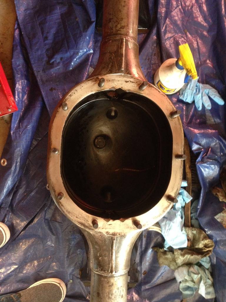

      I started cleaning the housing, I scraped all the crud and grime off, then took it to my local self wash and degreased it with a pressure washer. I also started filing off weld splatter and cleaning up the mating surfaces and I used a 3M green scrub pad with WD40 to clean up the bearing and seal surface. I still have to sand/wire wheel the complete housing, so I hope to get it done by this weekend.

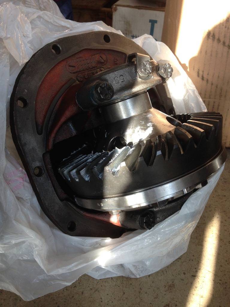

      I got the 3rd member back from the shop. I'm not to happy with the end result, I was told the 3rd member was going to be cleaned and painted black. We had a discussion on the color of black and we ended up with a matte/flat black. In the end the housing was not painted and the housing was just wiped down/cleaned. I mentioned it to him upon inspection when picking it up and he said I don't paint the housing.... Come on now.... I hate conflict so I just shook my head and took it as is. It's not a huge deal but if you say you're going to do something, do it. I think he just wanted to get me in and out the door. So with that said, The diff is setup nice as far as I can tell (I'm not an expert) the pattern looks great. I feel they have the knowledge and experience and If you are local I'm not going to steer you away just because of this. Just have them write down everything they will do on paper, so you don't end up a bit unsatisfied with the outcome, like I did.

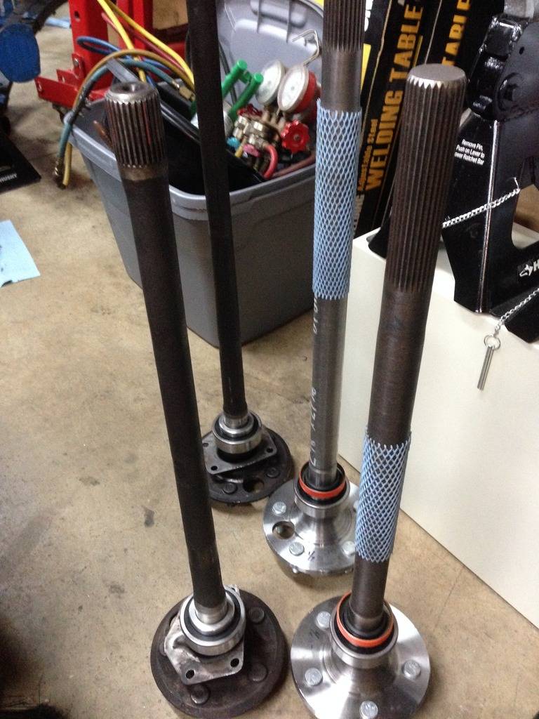

      Looks like my stock axles maybe bent, I slid them into the empty housing and found out when I spin them there is a slight visual wobble. So unless this is normal I will have to get these fixed or buy new axles. The part I'm upset about is the new bearing were installed on them. I thought the guys at sutton checked them, since I asked. Thinking they would was my issue here, another chalk up to getting me in and out the door. I will shoot a short video to display the issue and test procedure. If you have any thoughts on this please feel free to comment. Seems I can get a new pair of axles for 300.00 - 350.00. Can I uninstall the new bearings and reuse them? I have a press and I was looking into buying a bearing splitter, will this work? or do I need to get new bearings?

      If the center section isn't installed, the axles will wobble all over the place. You have to have something to center the spline end for that method. The real way of checking axles is to put them in a lathe on centers. I think you're ok .

      Here is a video of the wobble. I will take them to a shop today to get them checked out.

      That video sure makes it look like a bent axle. That wasn't what I was suspecting.

      I took them to a local shop and just had them check them. The shorter axles has about .050 of run out on the spline side, on the bearing side its about .003 and the face has .030 of run out. The longer axles has .030 at the spline .003 and the bearing surface and .030 at the face. The tech told me I could try them out that it would not leak but I would have some tire movement. He did say if you can afford it buy new axles. What do you guys think? Am I worrying to much? should i just dish out the money for axles and could I reuse my new installed bearing from the old ones?

      definitely looks bent and those measurements sound bad. the test in the video does look like the axle is bent. when checking axles, i will have them installed in the housing with the thirdmember installed. then ill take a dial indicator and measure the runout at the outer edge of the flange. this way every thing is set up the way it will run going down the street.
      i do suspect that you need at least 1 new axle with those crazy measurements, but i would like to see what the run out is with them properly installed in the housing with a thirdmember.

      After searching over the web it looks like I will not be reusing my bearings and buying new ones with new axles. I am irritated I drop 140.00 (new bearing plus labor) at the shop that was suppose to check them and tell me if they were good. I cannot recommend the shop I went to to rebuild and check my axles, very sad as I prefer to deal with local small shops.
      I will be ordering new axles, my choices so far are KA axles "Tom's Axles" 430 with new bearings or Currie Axles 480.00 with new bearings. Any other options you guys recommend I check out? These shops are local and get the axles in a day. Can someone get me new good axles cheaper and drop ship?

      Picked up a pressure washer from Harbor freight, not bad for a cheaper unit. Worked really well for this project and I'm looking forward to using it again when cleaning up the underside of the car.
      Pressure washer - 80.00 on sale

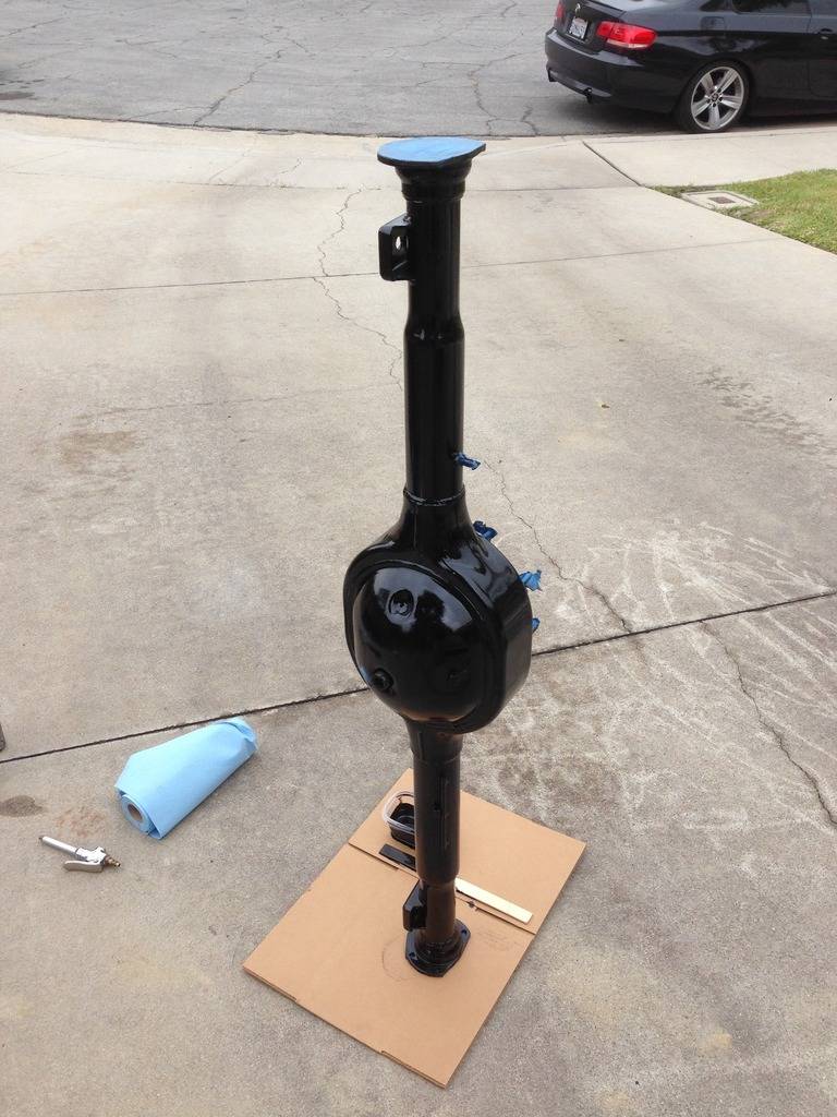

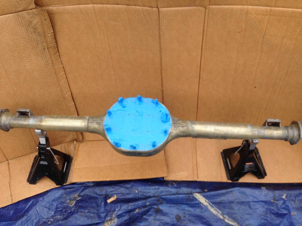

      Started cleaning and paint process on the rearend.
      I used a wire wheel and sanding disc to get it stripped.
      After the grinding and wire wheel cleanup I started on the prepping for Por15.
      Prepping for paint
      Once the housing dries I will apply a Eastwood's chassis black as a top coat. I think overall it's coming out great, not show quality but perfect for a driver/weekend cruiser.

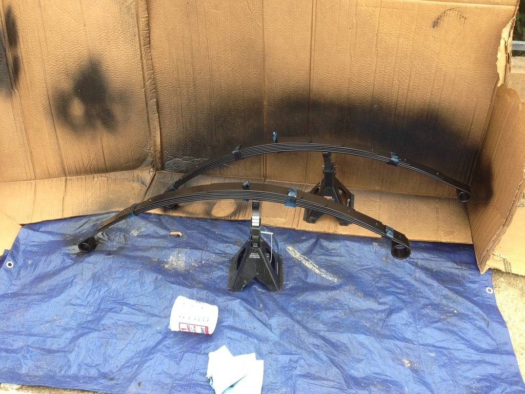

      Painted the new leaf springs as well.

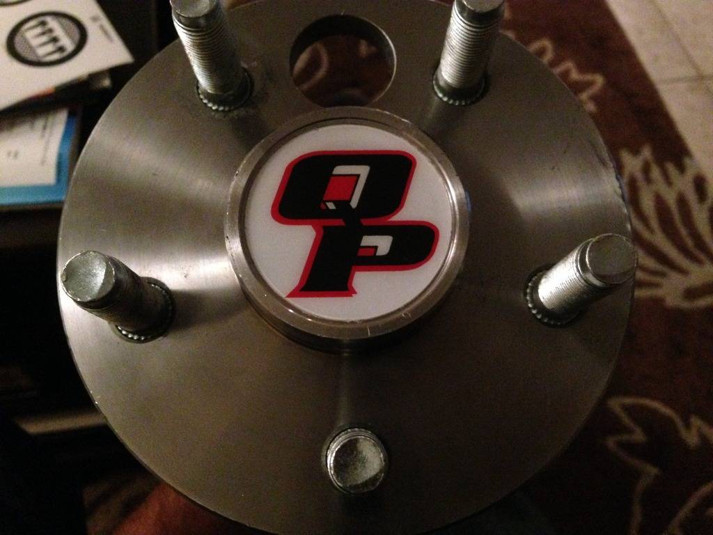

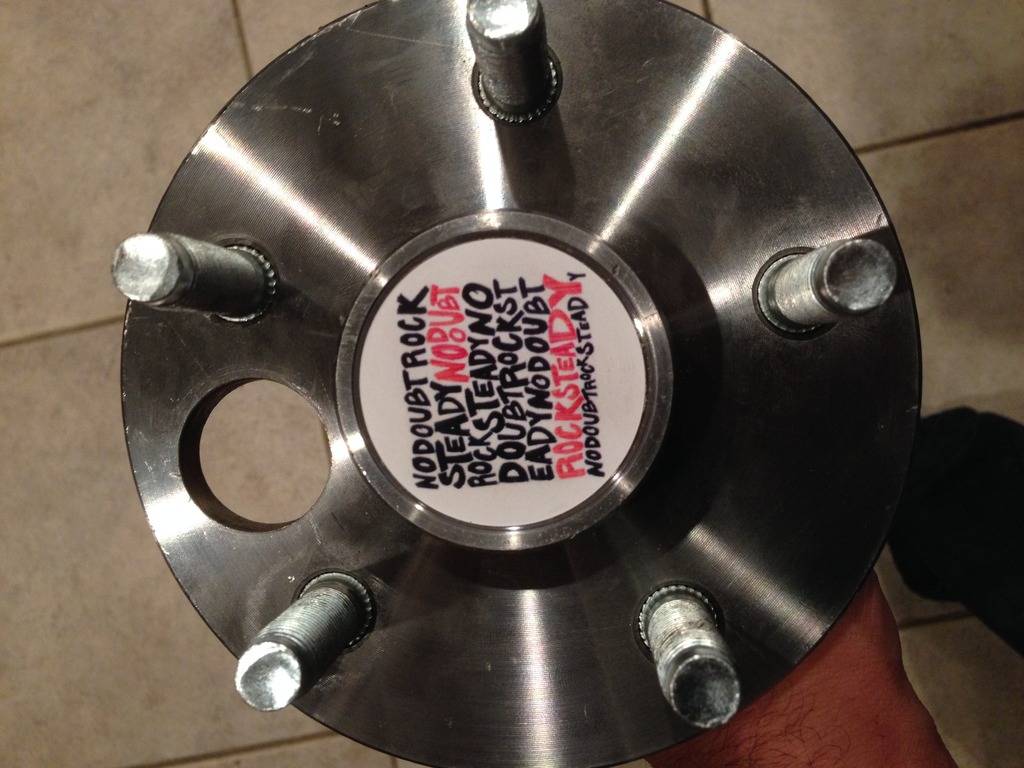

      I just received the new axles. I ordered the Axles from a local shop that was getting me Tom's axles, but in the end they did not have something that would work and recommended custom ordering a set. Since I was now going to custom order them I decided to do this myself. I contacted Quick Performance (the company I bought my tru trac and gear set from) and provided them all the measurements for the axles. I feel I got a good deal, 300 shipped for a set of Axles, bearings, retainers and seals. The axles are Yukon custom axles machined in house by Quick Performance. For the power this car will be making these will work great.
    17. #37
      261
      Quick Performance Custom Rear Ends & Differential Parts
      Yukon Axles - 300 shipped.
      I made a slight modification to customize them for my wife.
      My wife's favorite band is No Doubt, so I made a few different versions of stickers for her and she ended up choosing her favorite album's front cover artwork.
      I will start assembly this weekend and post pics.
