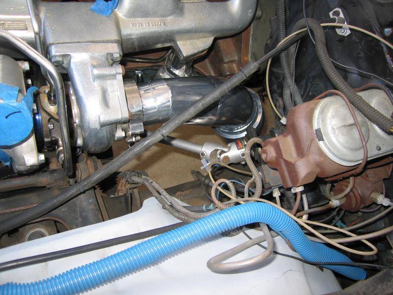

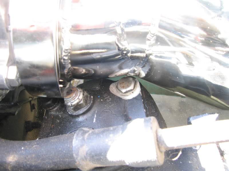

      I wanted more room in my engine compartment, turbo & downpipe was too close to the steering box.
      Stock box
      Rack installed:
      Plus I wanted to loose some weight.
