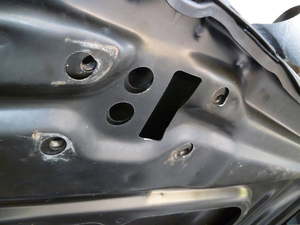

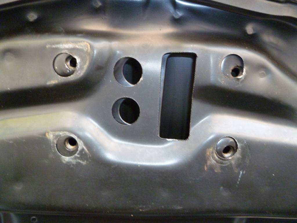

      We purchased a 2" cowl hood for our 1969 Chevelle from RPC, a restoration and parts shop here in the valley. We bought the hood around a year and a half ago, and we've occasionally had it on the car for alignment and other things. Recently, we were putting the front of the car together and we ran into a problem. When we were trying to line the hood up with the fenders, the front end of the hood kept getting shoved to the passenger side of the car hitting the front fender. We started looking for the problem, and the nut plate built into the hood for the latch is not where it is supposed to be. The plate is so far off that only 3 of the 4 bolts will start, and as stated earlier it wont let the hood close properly.
      Here's the problem, clearly it was built wrong:
      RPC won't replace the hood because it's a manufacturer's defect, so they told us to talk to Dynacorn. My dad has been talking to them for two weeks and we've come to a stand still. First they told us it's been too long too return, but then they stopped saying that. Now they're telling us they won't replace it because the hood is damaged. Because the primer which is on the hood (which we're going to sand off) is faded, they say the hood is "damaged". There is nothing wrong with the hood except for what they messed up when building it, we've actually been impressed with how solid the hood is.
      My dad has been trying to talk to them about it, but now they will no longer answer calls or return messages from him. This is completely unacceptable from a customer service department. I'm telling everybody this as a buyer beware that you need to check EVERYTHING on a part if you order it from Dynacorn. If anyone has a contact that could help us, it would be greatly appreciated.

      I've heard of this sort of problem before from this same mfr... No first hand experience though.
      Something to consider: why not put some bolts with large washers in the locations that will start, then drill out the spot welds, relocate the insert plates where you need them, then reweld them in with rosette welds?
      In this hobby I've found it necessary to do that sort of repair on reproduction parts more often then not.

      That's what we're going to do if they refuse to replace the hood, but we wanted to try to get them to own up to their mistake and replace it first.

      I would just fix it, I have seen so many aftermarket parts that need finessed to fit right. Including dynacorn parts. At least someone is making parts, there are bound to be some production issues.
      As stated inspection of all parts before storing as soon as received is paramount.

      Yes there is a definite manufacturing defect in the hood that is clearly shown in the picture. Yes the vendor must take care of this type of problem for an item they sell/manufacture when brought to their attention within a "Reasonable" time frame. Yes you the CUSTOMER also have a responsibility to inspect the item immediately after your purchase and bring forth any issues with the item within a "Reasonable" time frame after YOUR purchase. 1 1/2 years LATER is NOT a "Reasonable" time frame! This is especially true when the customer has already "Occasionally" mounted and removed that item during that 1 1/2 year time frame.

      The defect was never noticed because up until a week ago we had never had the hood latch installed in the car. We've been trying to sort out all of the bent and broken parts (this car had a front end collision at some point) and other various issues. We finally had all of those issues sorted out and were ready to put the hood on the car and give it a good alignment. This is when we found the issue. For comparison, we put the stock hood on and without changing anything it closed and latched perfectly.
