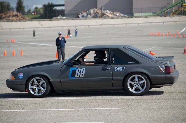

      I went and raced the SCCA CAM Challenge event in Fontana. Outstanding time. The course was super fun. I got the equivilant of 4 "regular" events worth of track time in one weekend. Met great people, and enjoyed the company of those I already knew.
      That said, I got my ass whooped.
      I ended up WELL outside the top 10 in my class (which was my goal.)
      Reasons why:
      1.Driver. (Proof was in a friend jumping in the car after he had a mild part failure, and stomping on my best of 8 runs on his SECOND TIME DRIVING THE CAR EVER by a full second)
      2. Tires. NT05's (which i'm running) are head and shoulders above the junk that my car came with. That said, It seems that the "new and improved 200tw tires" from Bridgestone and BFG are much better
      3. General Setup. There is a laundry list of things that are not perfect on this $3500 race car. Tall gears, brakes locking up, "grab bag" selection of springs, shocks and sway bars... etc...
      Solutions:
      1. Driver- I learned a LOT at the CAM Challenge... but bottom line is more seat time. Good news there is that seat time is the fun part. I'm also going to try to line my schedule up with a novice school or something similar.
      2. Tires- Well... i'm working on killing my NT05s. I have collected rims that will fit the biggest tire that BFG offers in a 200tw... but i'm thinking that a "stepping stone sticky tire" size 255/40/17 is in order. I don't want to be the guy with mile wide tires getting whooped by smaller tires driven by people that have figured out solution #1. Plus, I don't have time to make the body mods required to fit big steam roller tires right now anyway....
      3.General Setup. This will also be ongoing. At CAM Challenge, the stand out set up items to me were brake lock up and gearing. It just so happend that I stumbled upon a complete rear axle assembly that had the potential to fix both those. Complete 8.8 with 4.10's, fresh trac-loc, and Cobra brakes.
      "89" for CAM Challenge cause' for some reason keeping the SCCA numbers made too much sense...

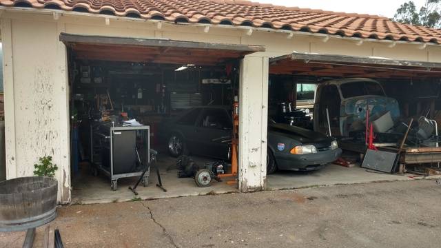

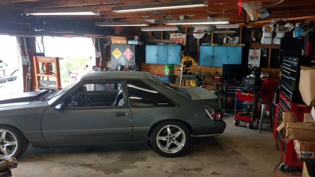

      Looks too much like it runs... lets take it apart again:
      Poor beat up shop and the pickup atop the frame table BEGGIN me to leave the turd race car alone...
      So, after the friction modifier stink settled, the car went from 3.08's to 4.10 and from gt brakes to Cobra spec rotors and calipers. I still haven't driven it with the 4.10s yet as my supply of crush washers was depleted. (yes... I shamefully tried the used ones only to find a serious leak... new crush washers tomorrow.)

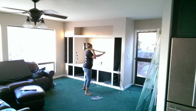

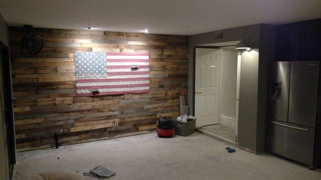

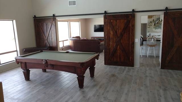

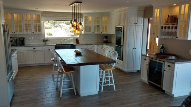

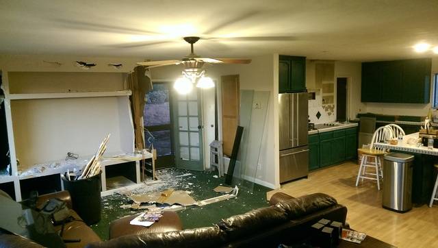

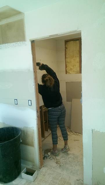

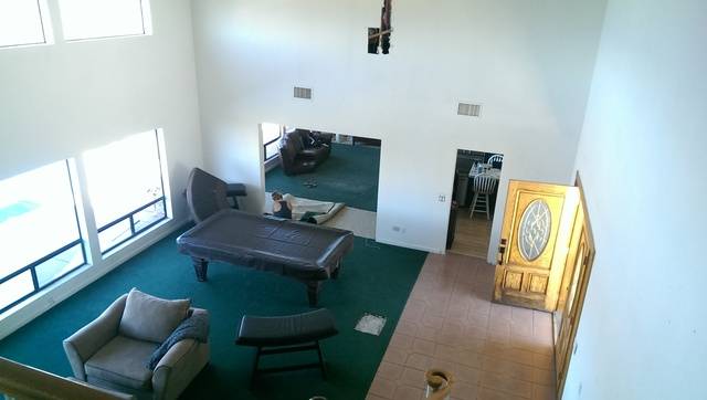

      House progress? (you asked for it, i'll keep it as short as possible... well... almost.)
      Super short version: FU@#! Slab leak!> replumb>new kitchen>"some" fun entertainment/electrical changes> redrywall/texture everything but bedrooms and baths> floors throughout + just a few extras....
      Pics version:
      We're making awesome progress, but theres still plenty of green carpet in the bedrooms, the bathrooms are functional but dated, and our landscaping is best described as a dirt farm.

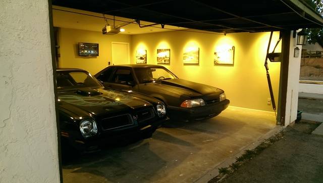

      I've been given an extended paid leave from the house progress to get some progress on the go-fast toys... We'll see how long it lasts...

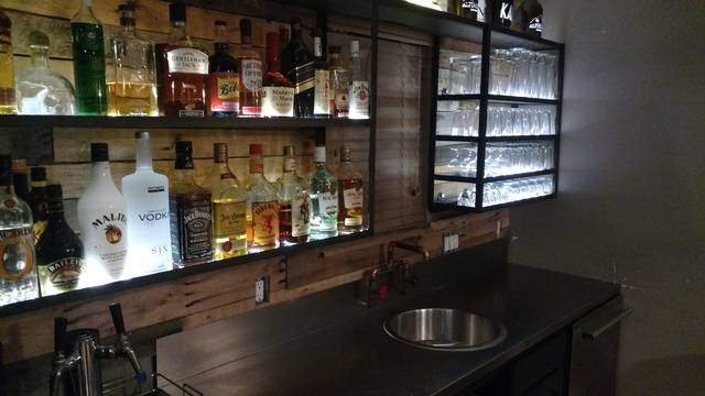

      Bar renovation

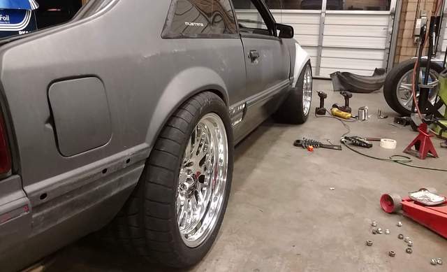

      But... I scored some fender flares... and the temptation is far too great. The mock up pics were taken at El Torro while killing time waiting for our turn at the cones. These will be going into service as soon as the necessary hardware/adhesives/materials make it to my doorstep.
      Some random cool shots...

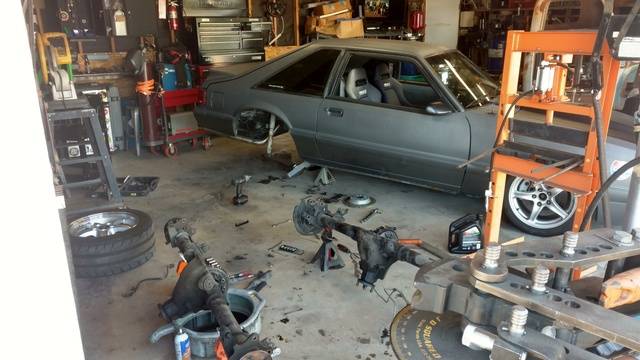

      turd racecar at speed... The GT bumper found its way onto the car a couple weeks back. I think the flares will make a total of 6 different colors on the car. When the flares are finished, I am looking forward to a proper single color paintjob. I'm thinking something WILD.... like white. Crazy right?
      Not exciting to most, but this is what your morning looks like once every two years when you love a post-74' go fast car in CA... (Hell yea it passed. 100% legit on its own passed. Suck it C.A.R.B.)

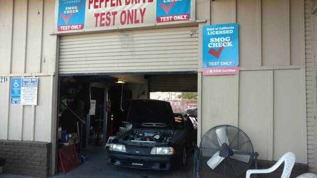

      1. Kudos on passing CA smog. Had you chosen an 83 with a carb, it would feel even more like winning the lottery, which I have never won.

      1.It was liberating, and irritating at the same time. I have a 302 based stroker in the corner of my shop that made 380whp in my last mustang. It'd sure be nice to have it freshened up and plugged in place of my current motor... but its got quite the cam in it and I doubt it'd pass smog. Even with a very lenient smog rep...

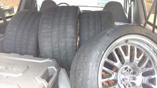

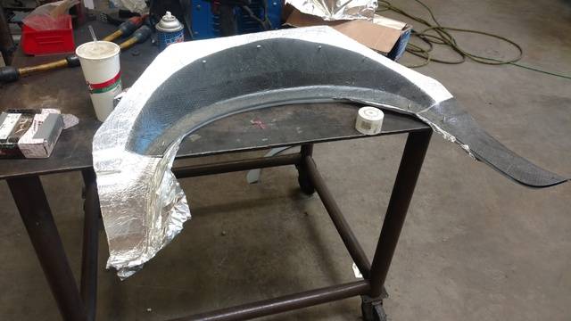

      So, I scored tiger racing flares for dirt cheap, but only because one of them had been cut up. The two dark pieces are all that was usable. I had always wondered how foil would work as a mold release. I covered one of the good fenders in foil to use as a mold. It seems to have worked well... Cross your fingers for me!
      Started mocking up... And found that 315s on 18x11s don't want to be on the front of a fox mustang... AT ALL. It's going to take some fender pulling and swear words, but I think I can convince them...
