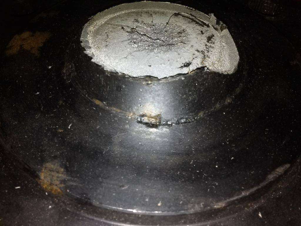

      Need advise....my axle broke right at the bearing race i have many hard races and willow track times on these but not sure what brand they are as i had someone replace them a few years ago.
      I would love to convert this 12 bolt to a floater but funds are not there. and as you can see this was probably the best place for this to have broke. Need replace wilwood backing plate as that got chewed up, as for the rotor aluminum from the caliper got on the surface could probably remove that.
      what are some good axles that i could use to get his on the road again?

      I had the same thing happen last spring at my first autocross with my newly rebuilt 12 bolt rear. I raced for about 4 years (about 4 races a year) with the stock 10 bolt one legger with 3.08's>>>>>never a problem. I built the 12 bolt with new 3.73's Eaton posi and ALLOY USA axles. I had maybe 300 miles on them and it snapped at the flange like yours on my second lap.
      Turned out to be faulty axles. I would not take a replacement from them (bought them thru Summit). I wanted better this time and got Moser's (Summit swapped them out at no extra cost). Looks like yours were not heat treated correctly, just like mine. See how porous the metal is? Like it was only holding together by the size of a nickel, maybe a quarter?

      Note the rusty area of the break, that axle has been cracked for awhile maybe even since it was new.
