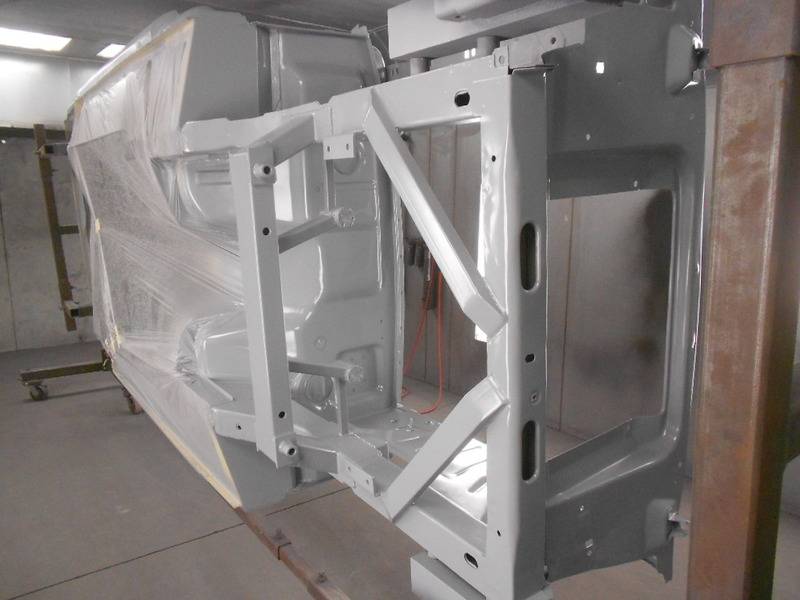

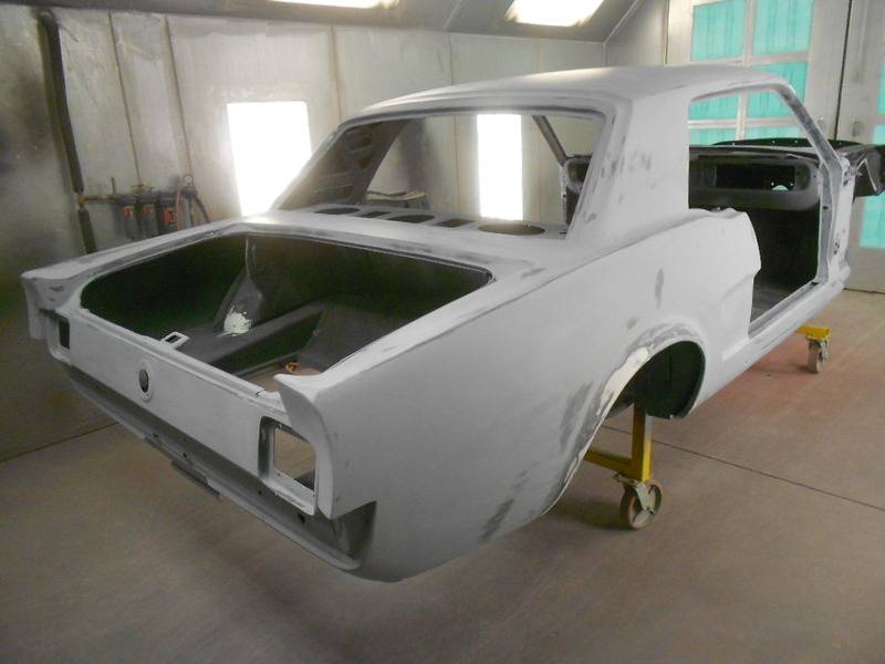

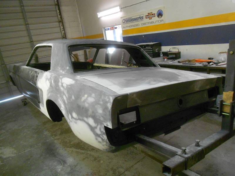

      I epoxy primed the body
      Block sanded and a little more bodywork
      One coat of SPI epoxy primer
      Two coats of SPI Turbo primer

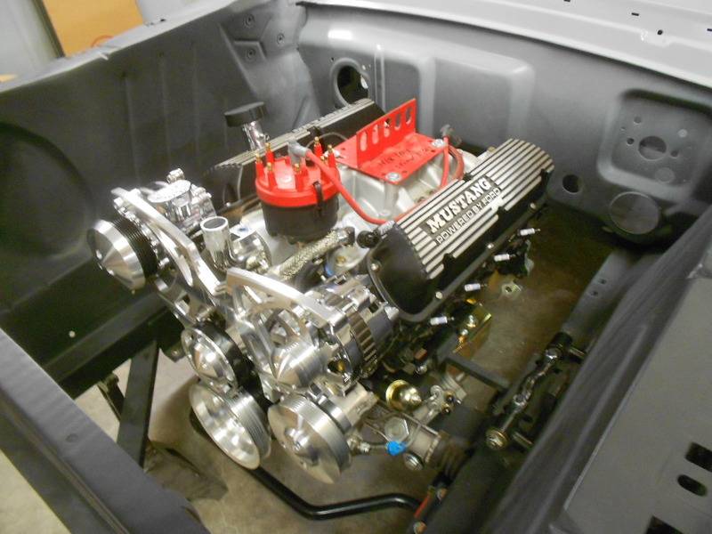

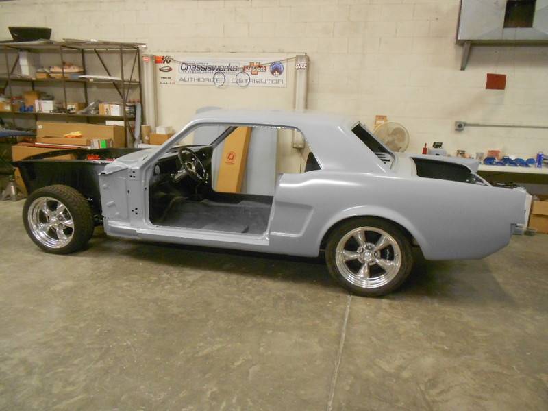

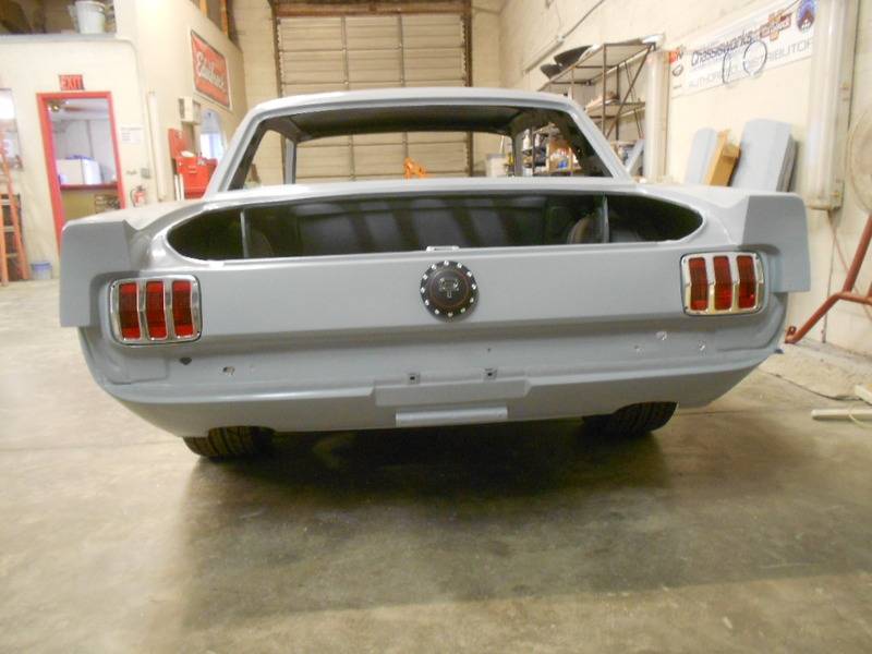

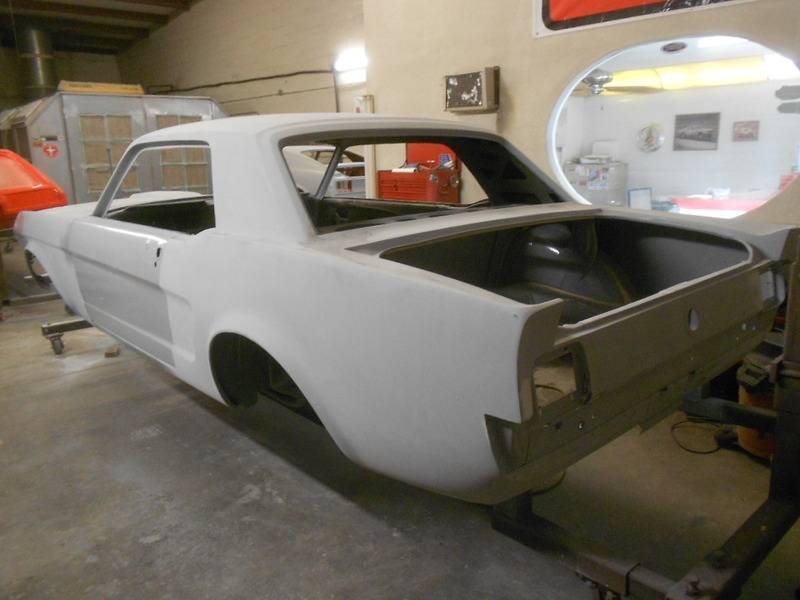

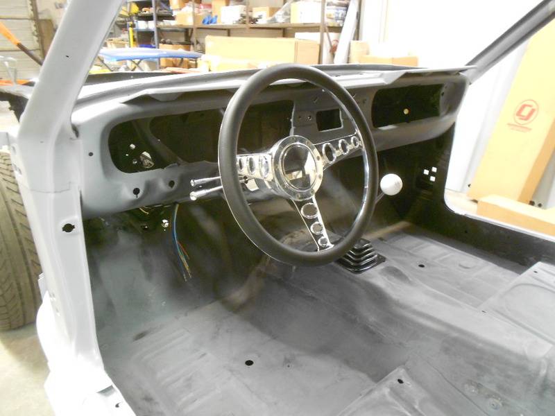

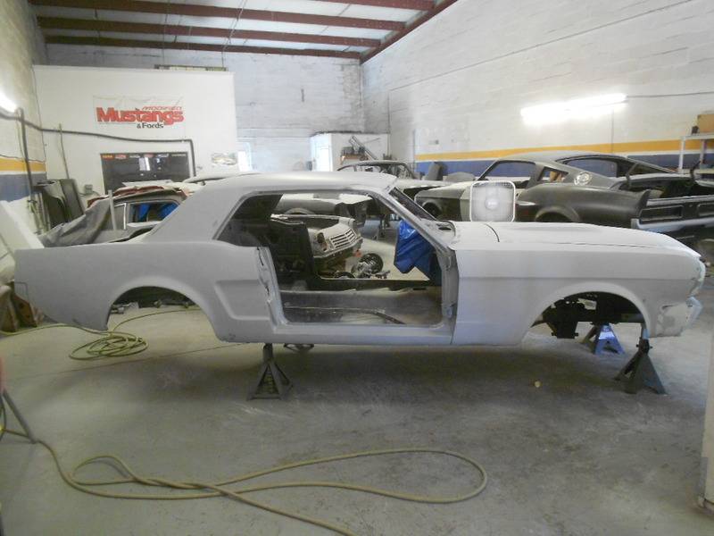

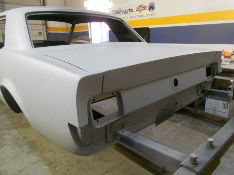

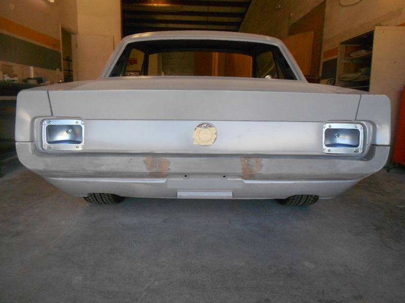

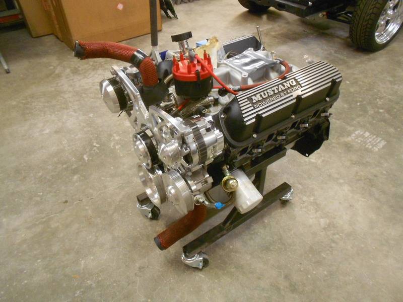

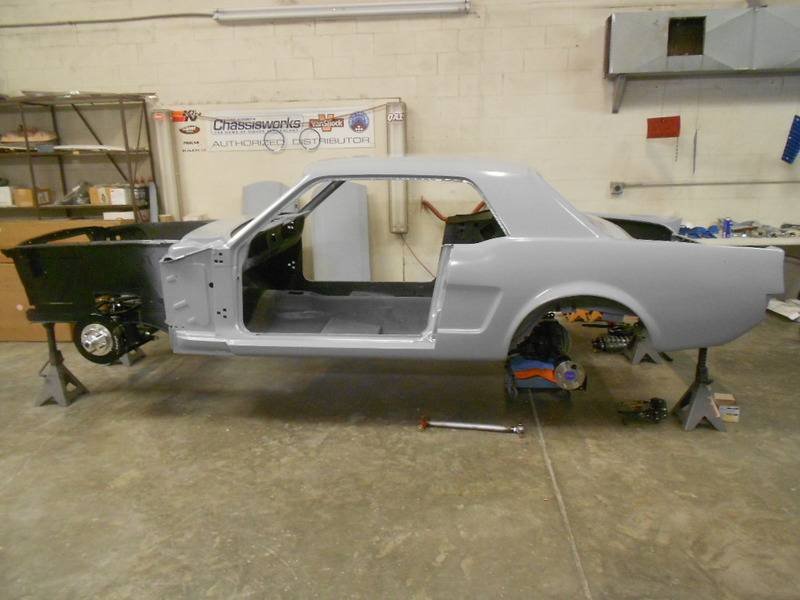

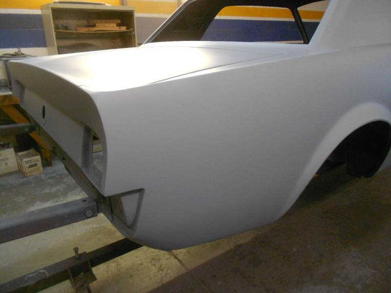

      We took the body off the rotisserie and mounted it on a cart so I could finish the taillight panel and rear valance. I block sanded one more time
      Epoxy primed

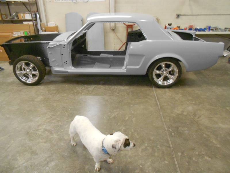

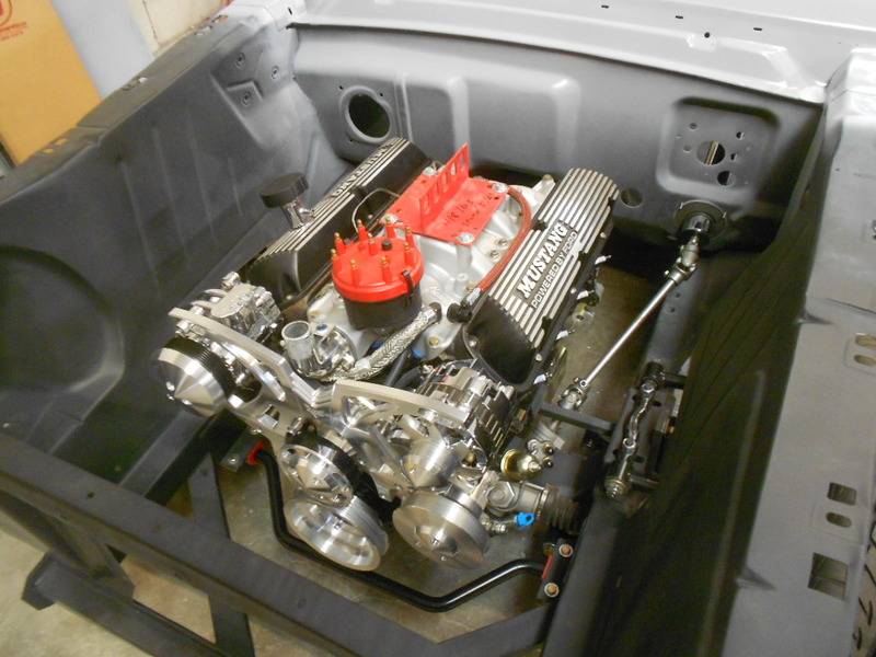

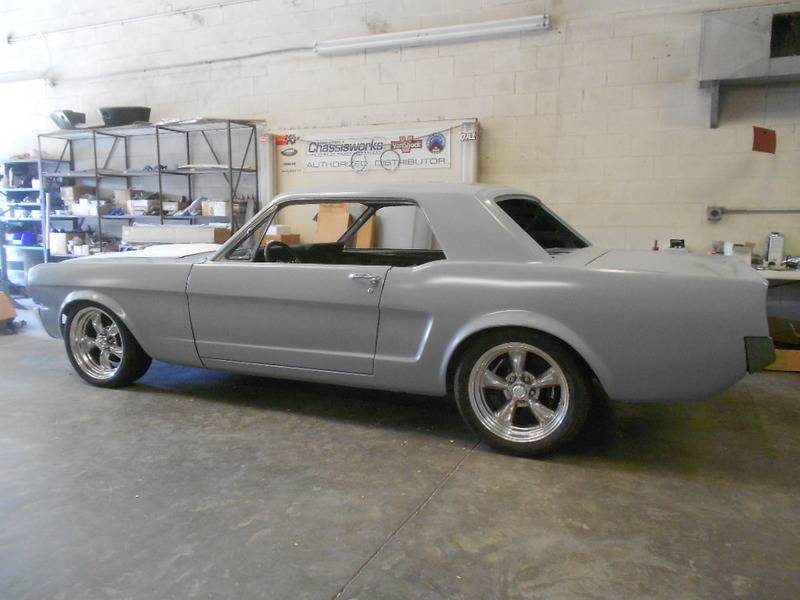

      We want to test fit everything before paint. Starting installing the Rod & Custom suspension
      Back on the ground

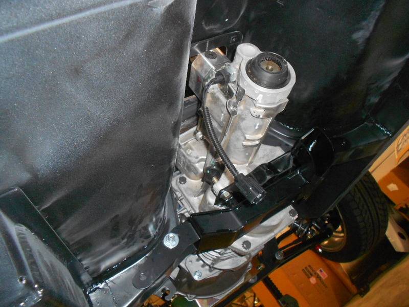

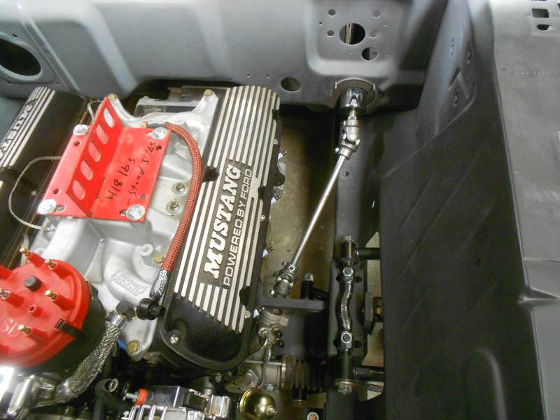

      Getting ready to install the 347 engine and TKO transmission. Those hoses got to go.
      Engine and trans installed
      Ididit steering column with a Billet Specialties wheel
      A few more photos

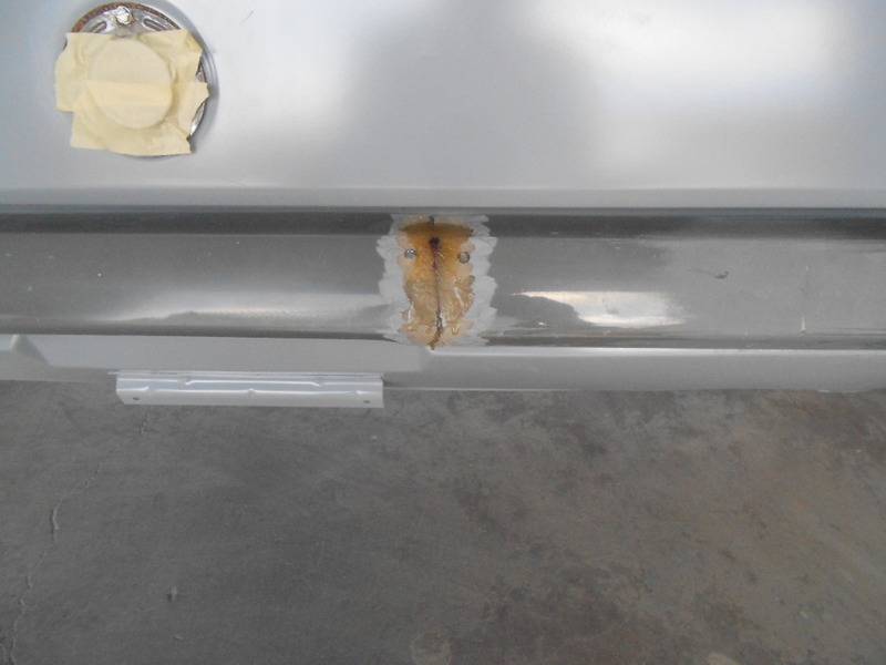

      The gas filler will have to be moved down a little because the cap hits the deck lid.

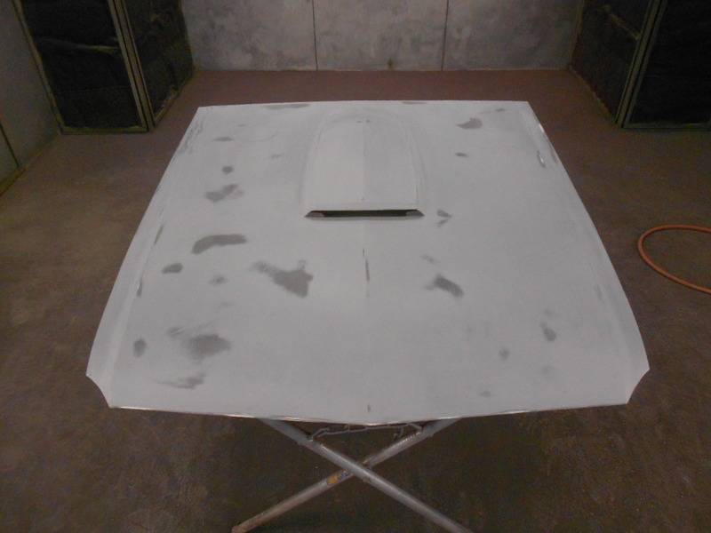

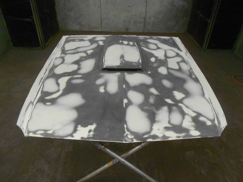

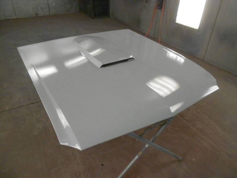

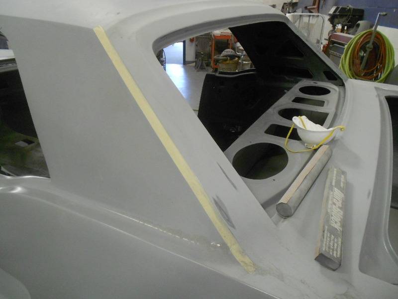

      I have been busy working in the shop and I need to update

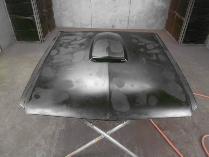

      I block sanded the fiberglass hood
      Sprayed one coat of SPI black epoxy
      Two Coats of SPI Turbo primer
      Block sanded again
      Two coats of SPI epoxy

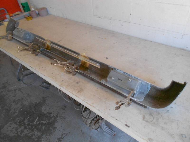

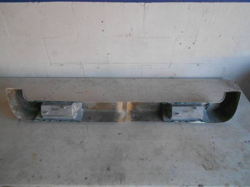

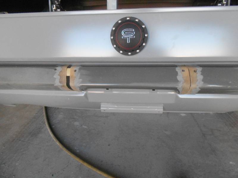

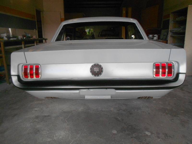

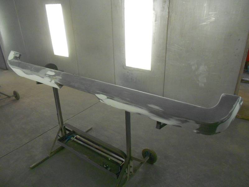

      The fiberglass bumper did not fit our car. The center section did not line up with the lower valance and the bumper was to narrow.
      I cut the center out of the bumper and had to modify the holes in the taillight panel to get the bumper lowered.
      I used Duraglass to attach the brackets to the bumper. Later I added a couple layers of fiberglass to hold them in place
      This shows you have much I need to add to the left side
      I added fiberglass to the top to hold it in place
      I clamped it to a long piece of angle and added fiberglass on the back side.
      I removed the braces and clamps and finished adding fiberglass to both sides and this is how it looks now. I still have to work on the gaps.

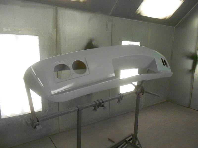

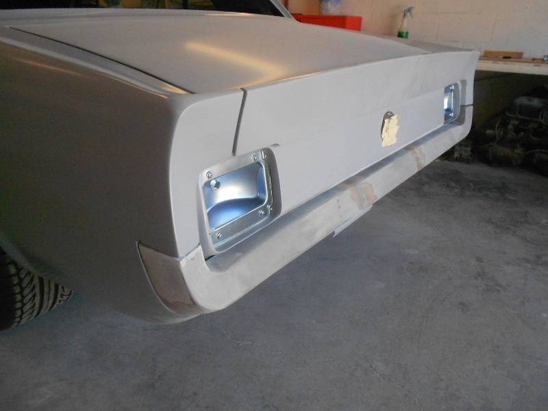

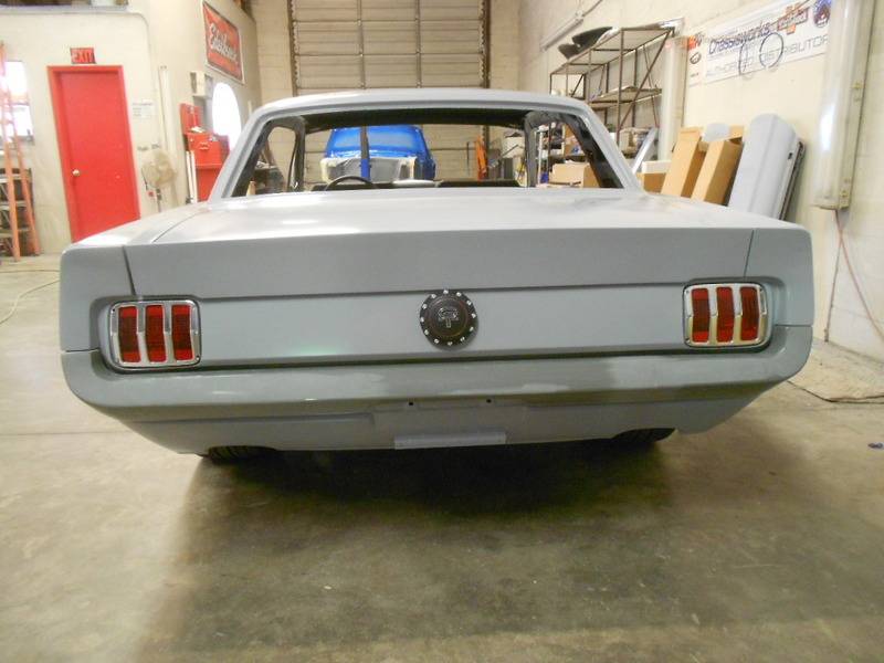

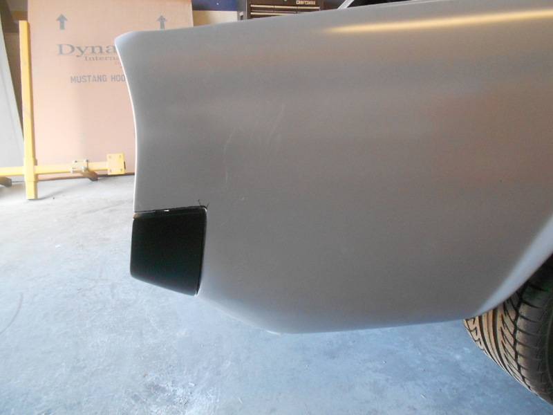

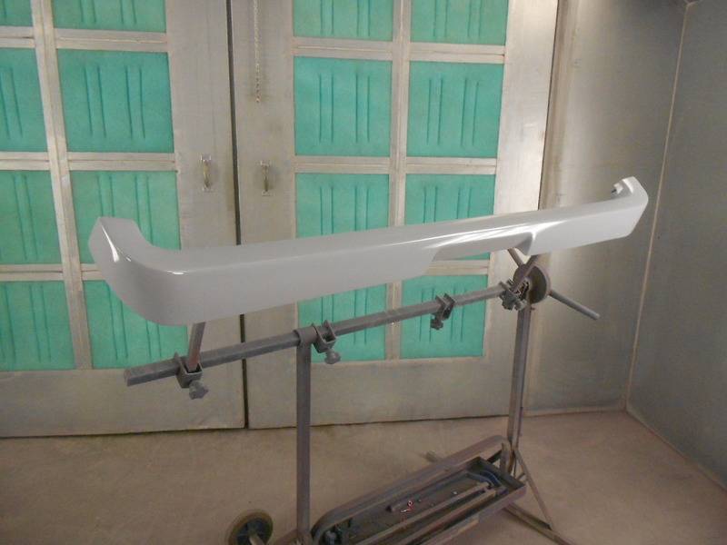

      I epoxy primed the bumper and test fit
      It still needed a little bodywork
      Epoxy primed again

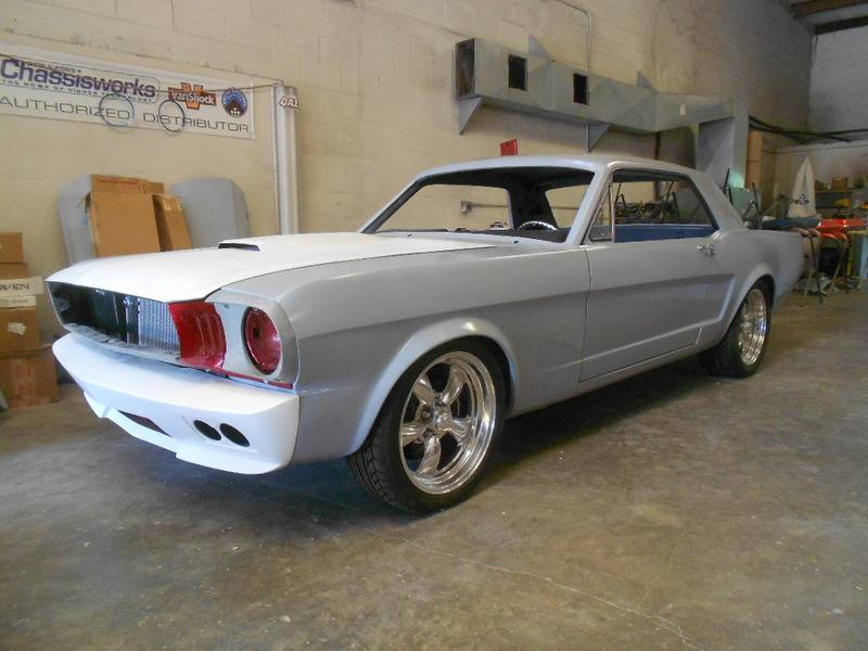

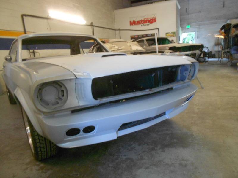

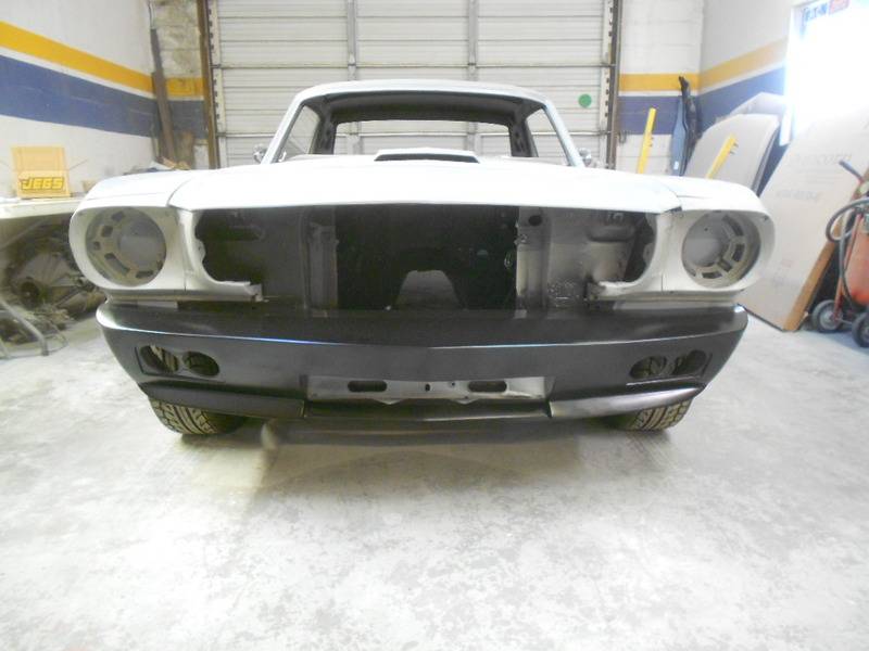

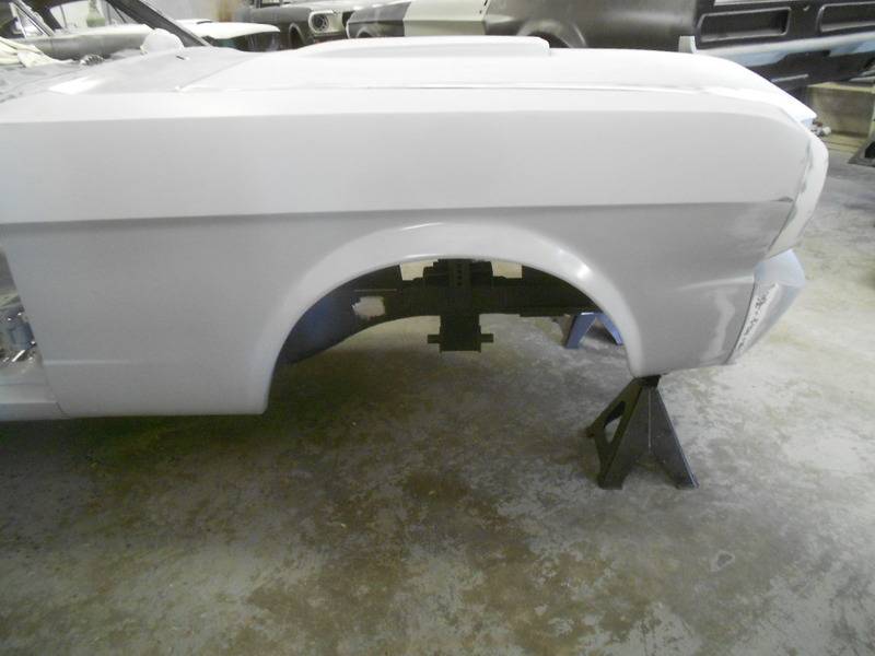

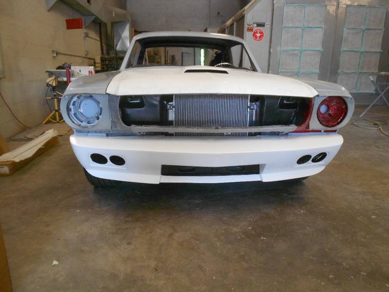

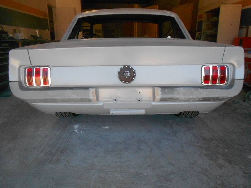

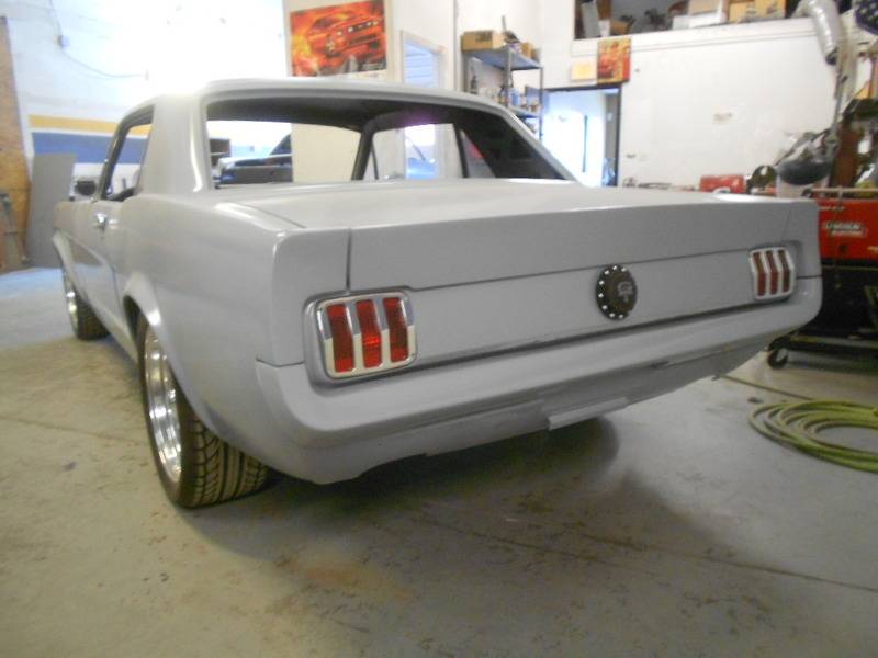

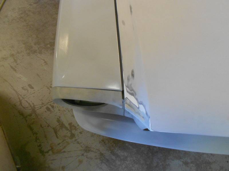

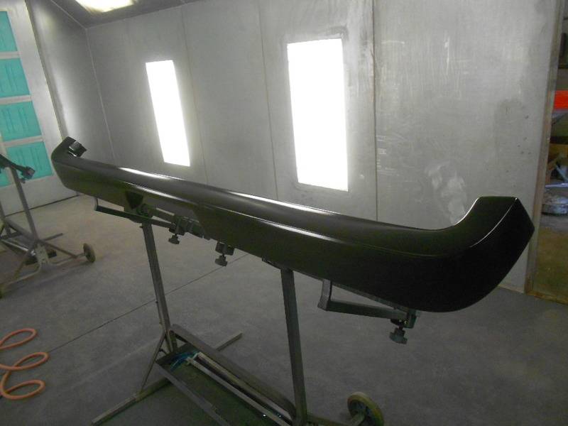

      We are back working on this project. I had to do a little bodywork on the front of the fenders to get them to line up to the new front valance and epoxy primed.

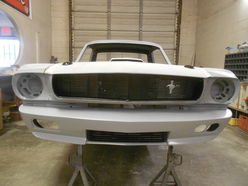

      Front valance and rear bumper block sanded and epoxy primed
      Test fitting one more time

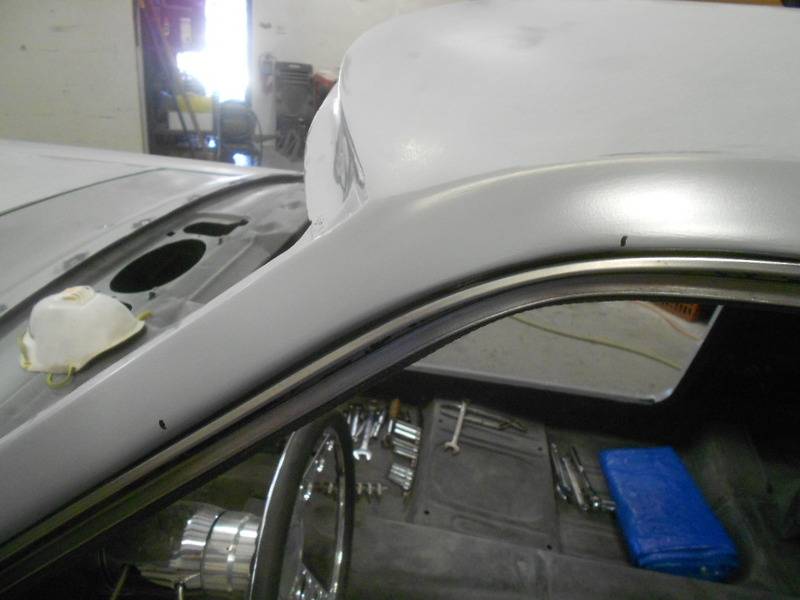

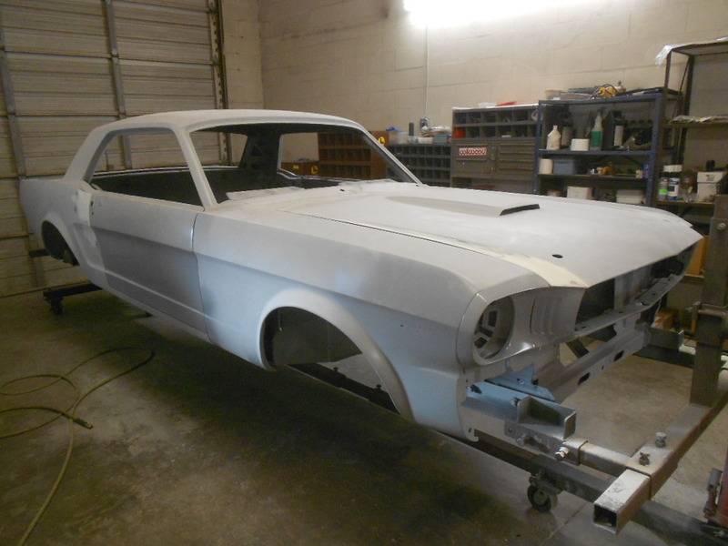

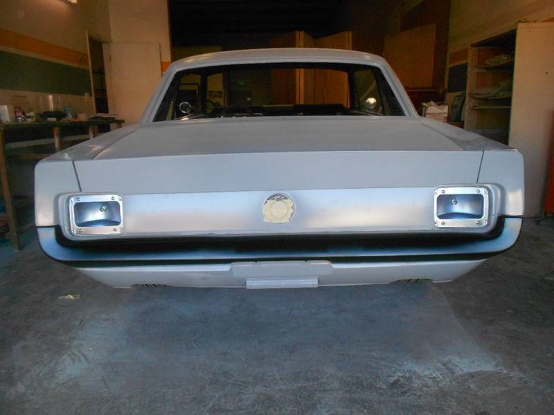

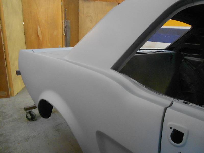

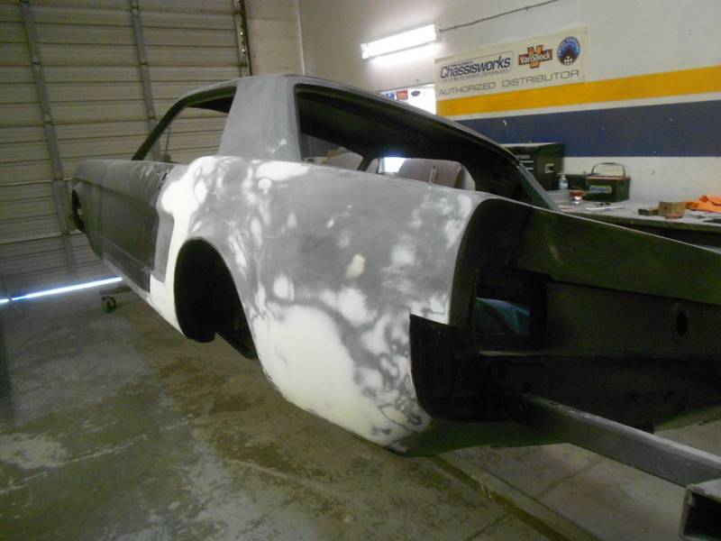

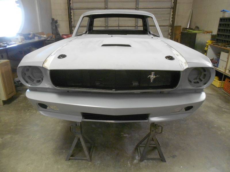

      We have been working on this doing a lot of little things to make it look right. The hood did not line up with the headlight buckets so I had to add fiberglass to the end of the hood.
      Brian test fit all the door glass, vent windows, quarter windows, windshield and back glass moldings
      This area needed a little work
      I worked on the body lines

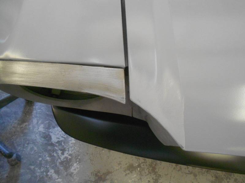

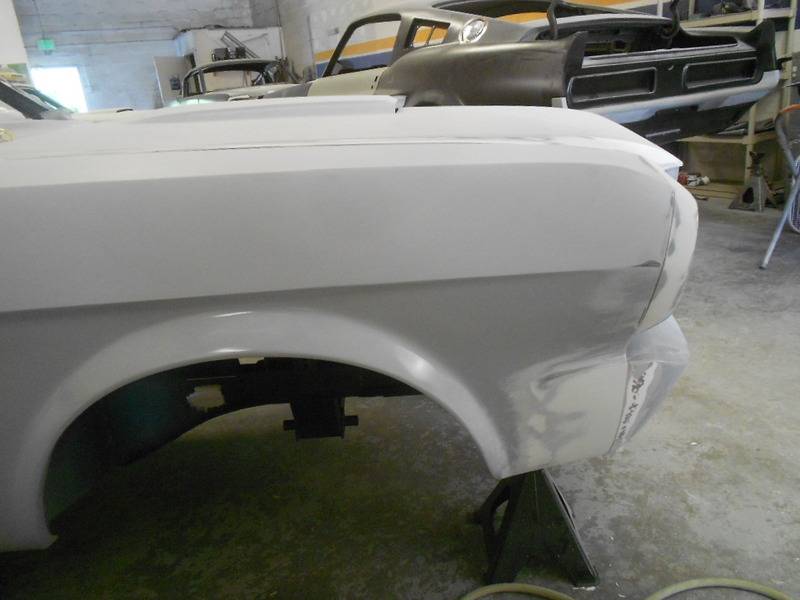

      As you can see in this photo the front valance was a little high and the fender had a low spot that needed bodywork

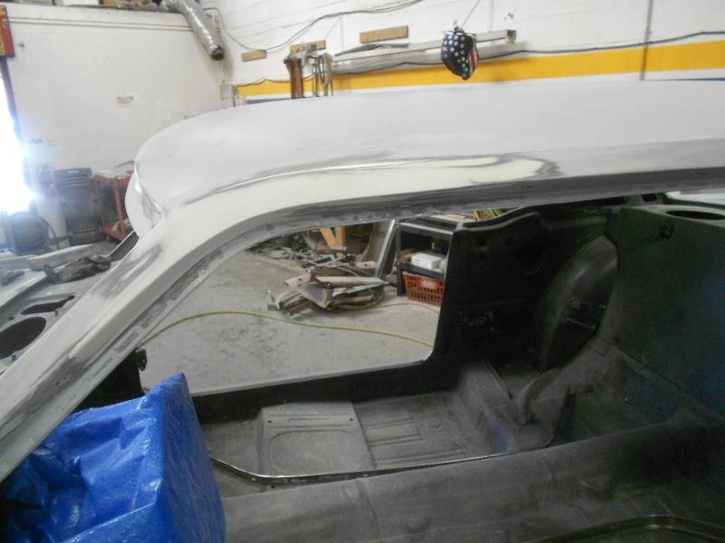

      In the middle of a lot of block sanding and looking for any imperfections

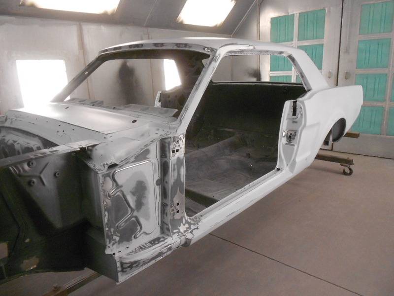

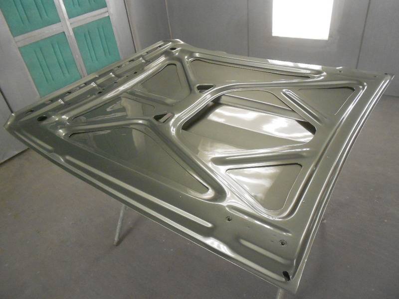

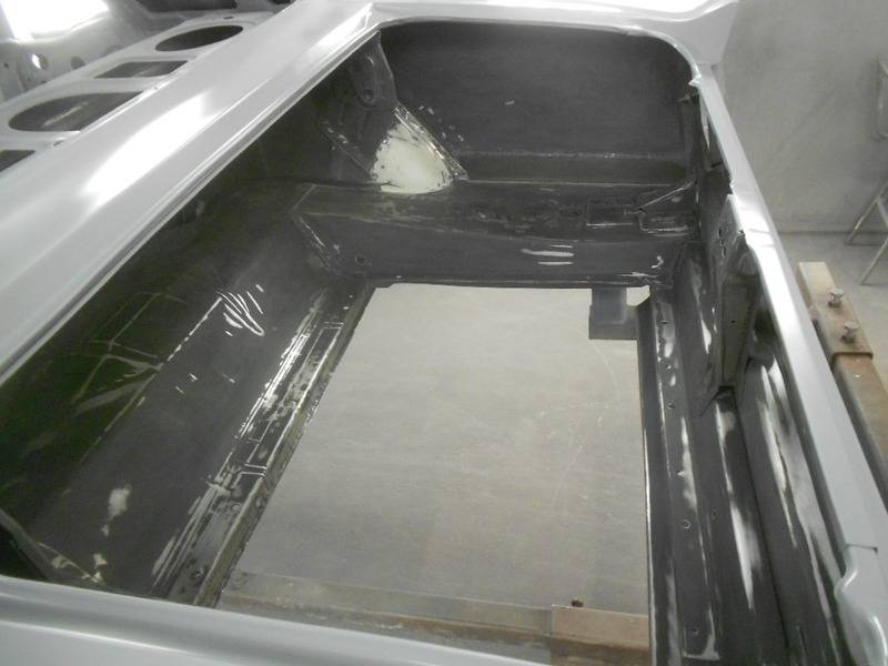

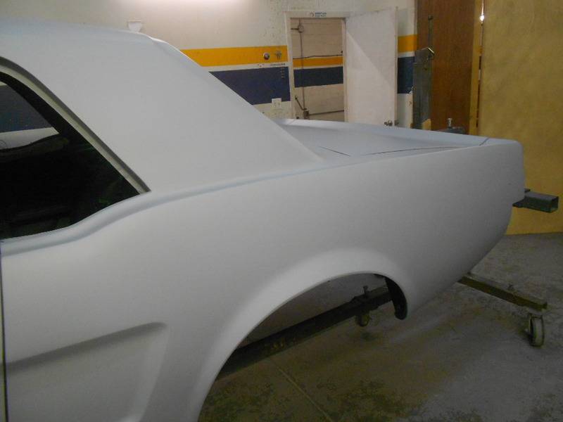

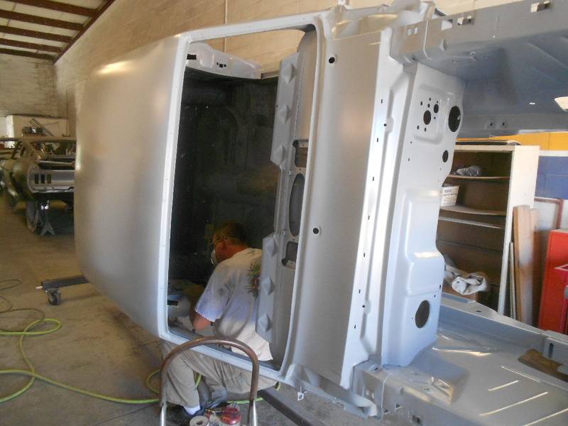

      The back of the hood was sanded and epoxy primed
      Block sanded the body and epoxy primed
      The trunk was sanded and epoxy primed

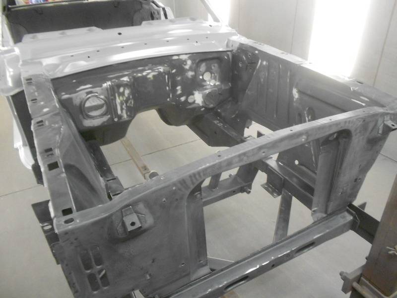

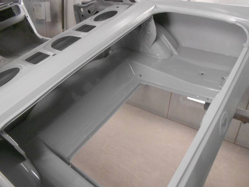

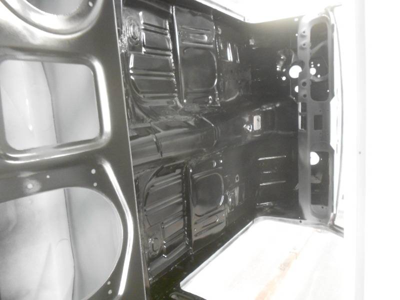

      The engine compartment was sanded and epoxy primed

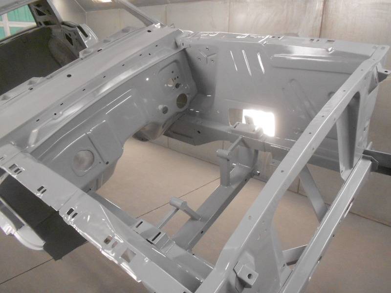

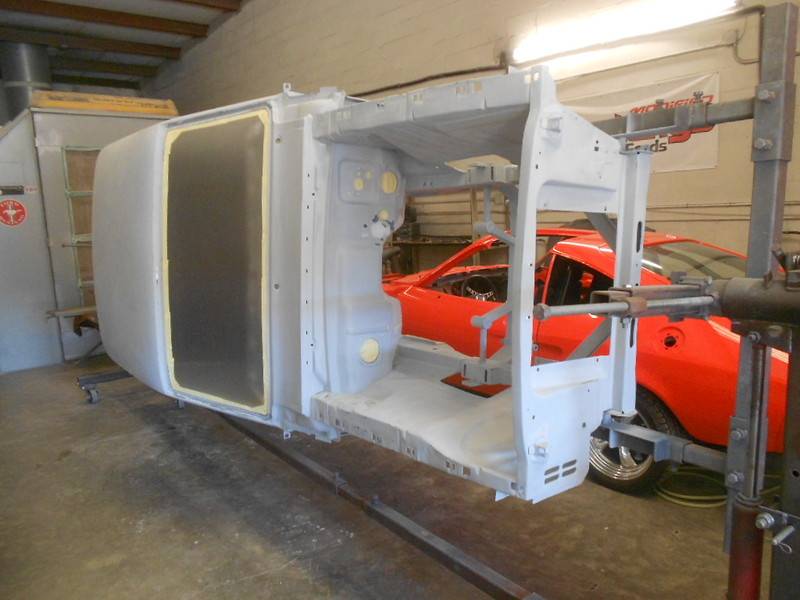

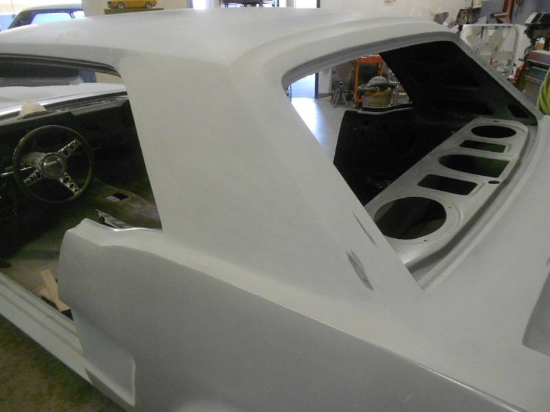

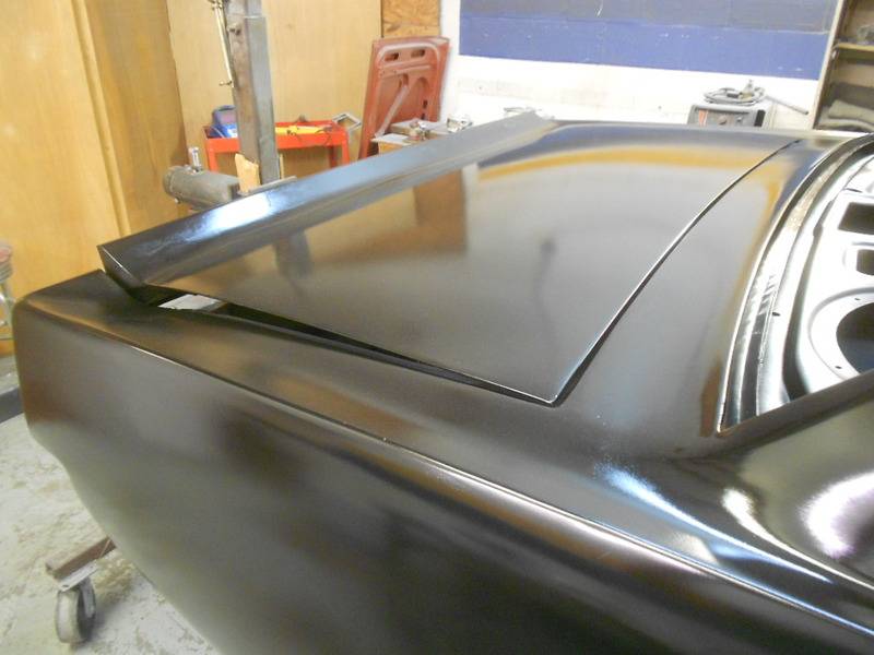

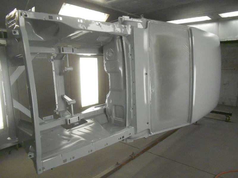

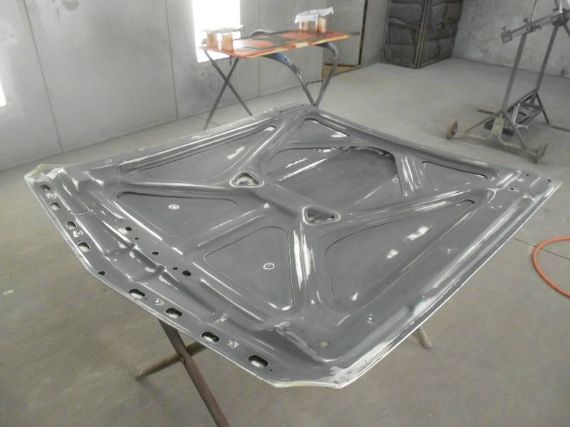

      I need to get you caught up on the progress we have made. The body is back on the rotisserie getting ready for paint.

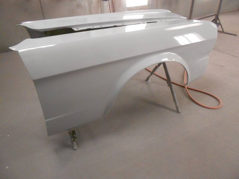

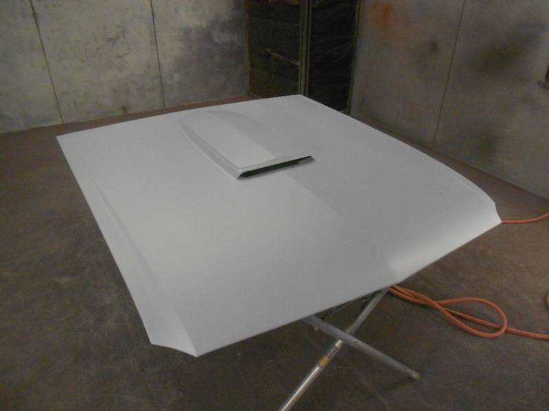

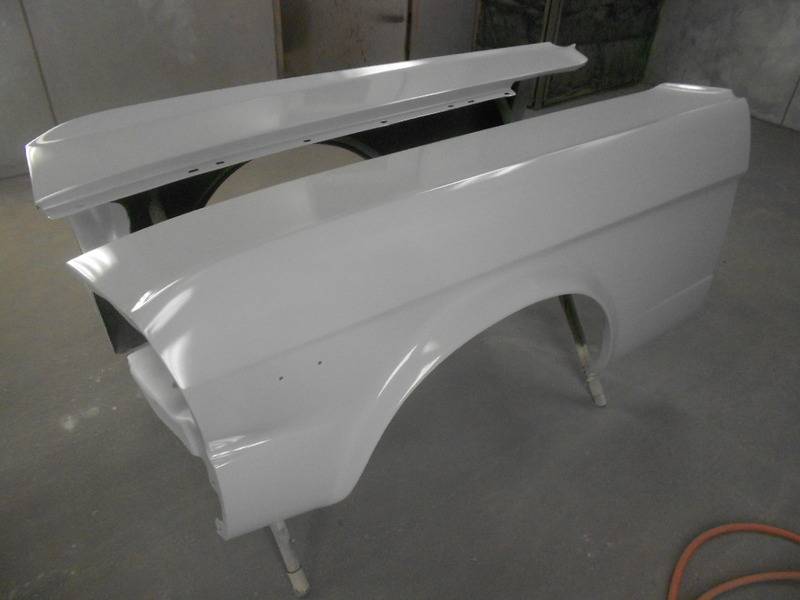

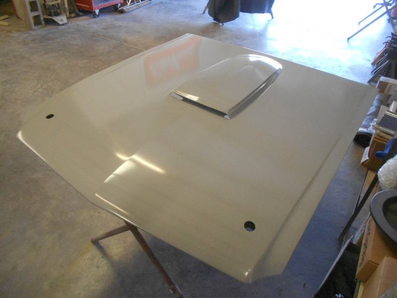

      Epoxy primed the fenders and hood
      Sanding the interior getting it ready for Lizard Skin
      Epoxy primed

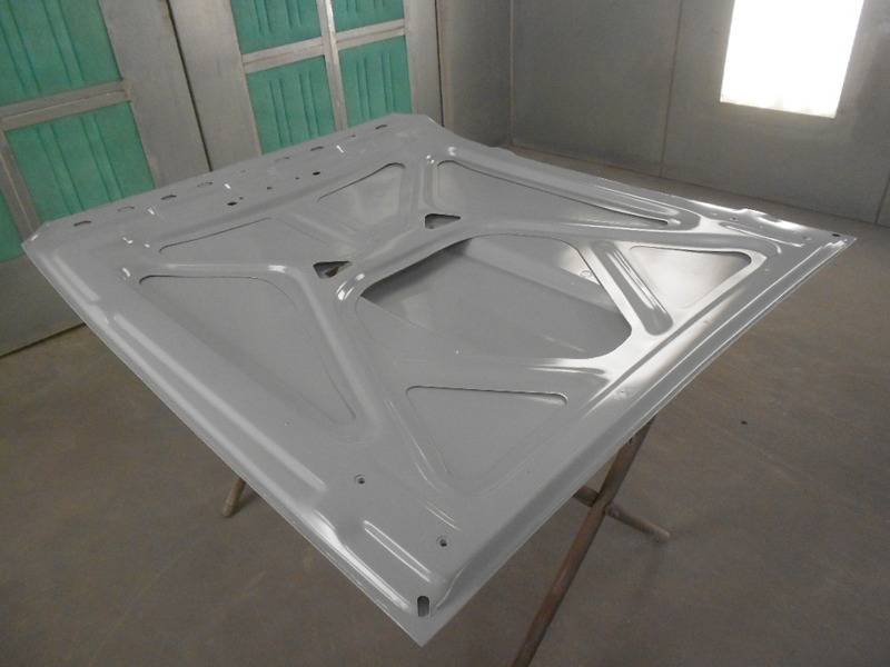

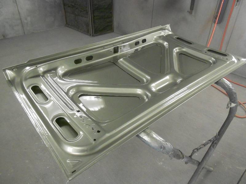

      Sanded the back of the hood and deck lid, epoxy primed, sprayed 3 coats of Pepper Gray and the next day 3 coats of SPI Universal Clear

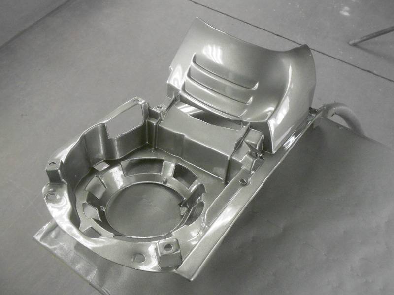

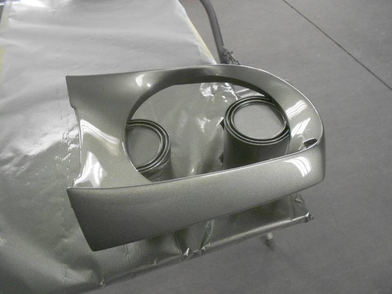

      I painted the headlight buckets

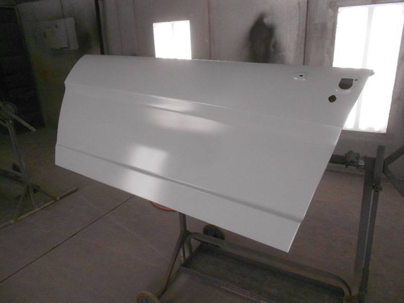

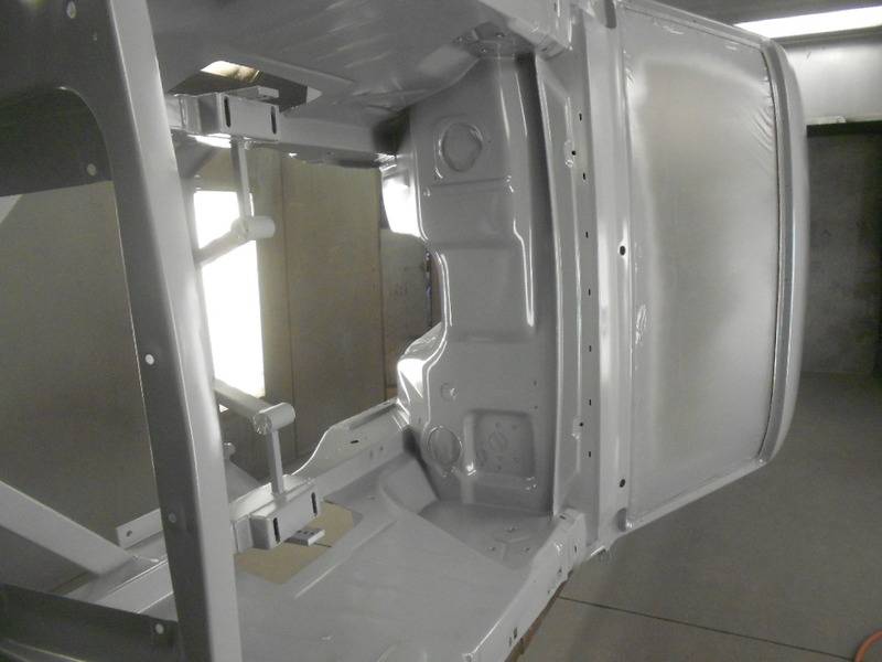

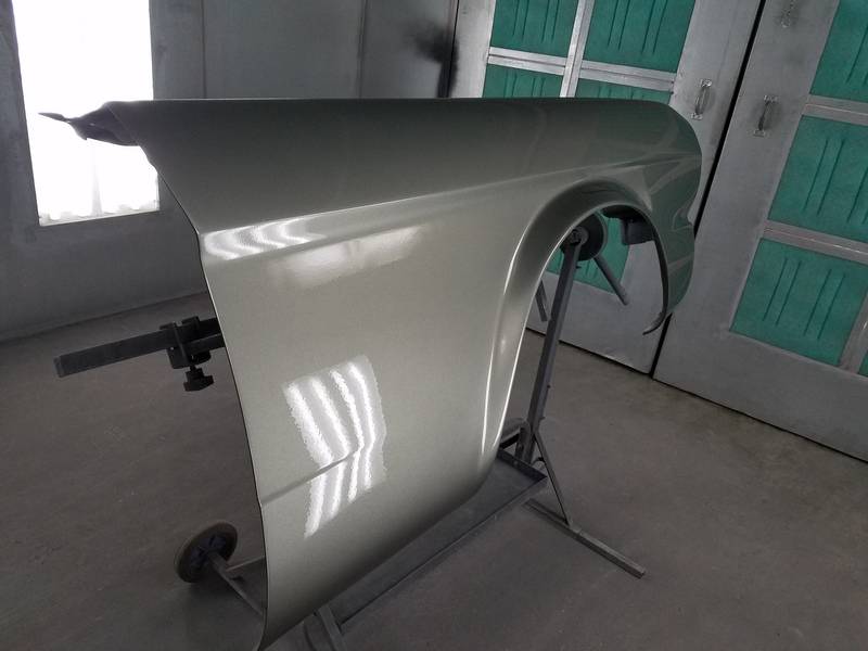

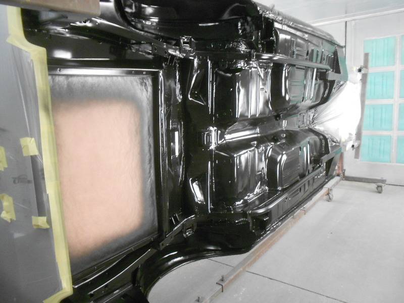

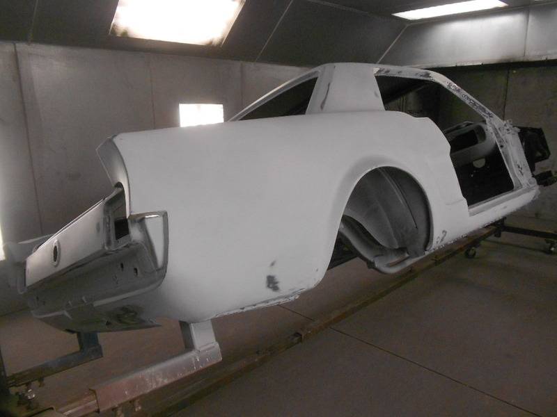

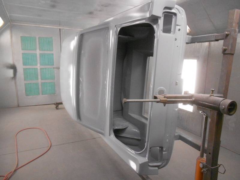

      Undercarriage sanded and epoxy primed

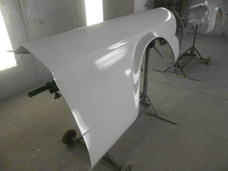

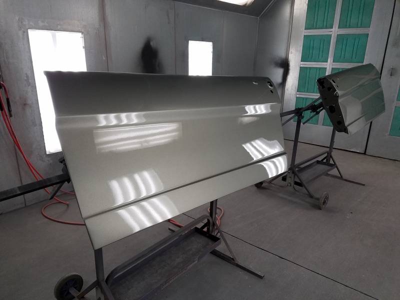

      Doors and fenders epoxy primed wet sanded and painted pepper gray

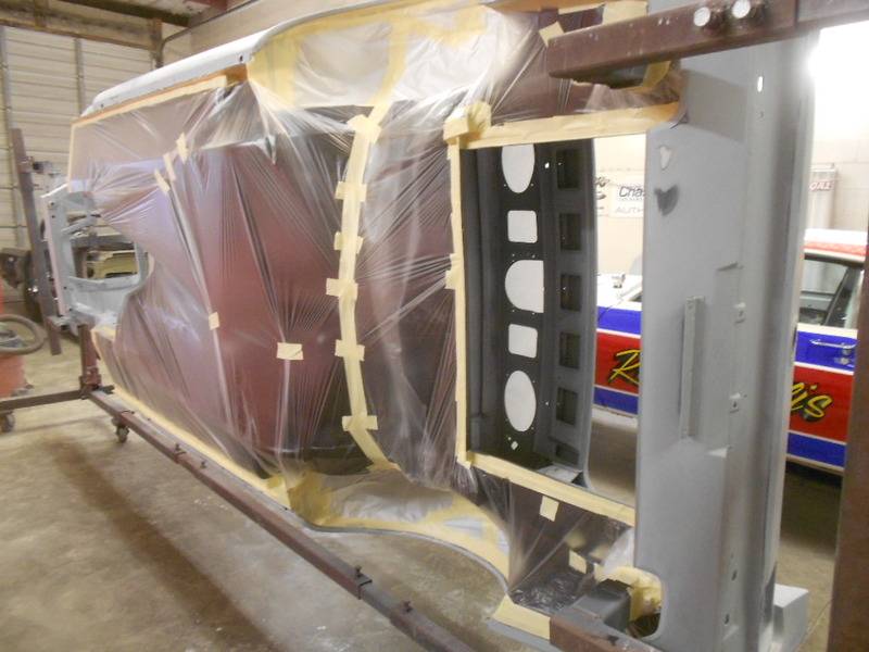

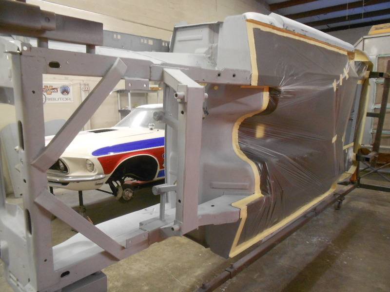

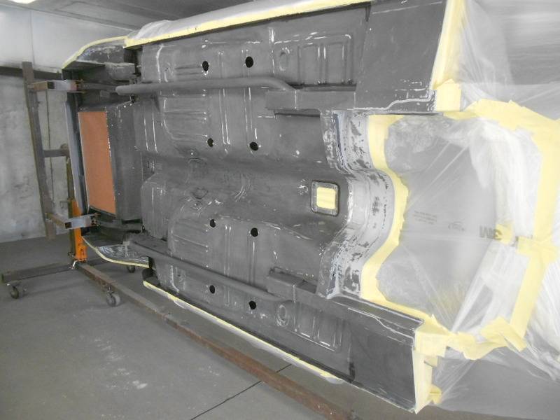

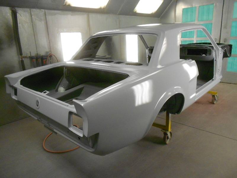

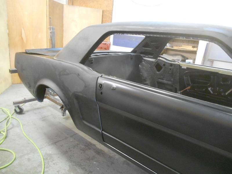

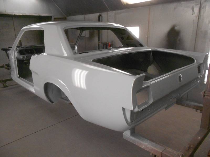

      Final taping before paint
      Epoxy primed
